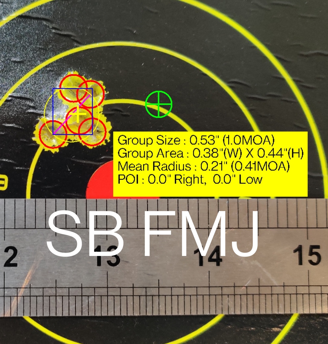

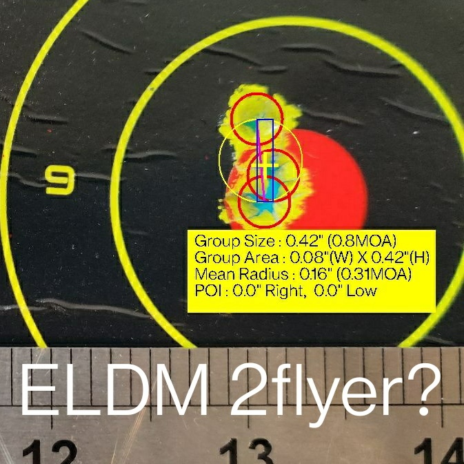

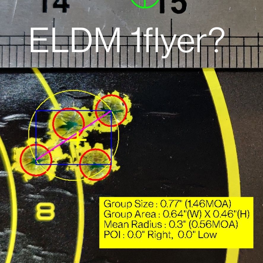

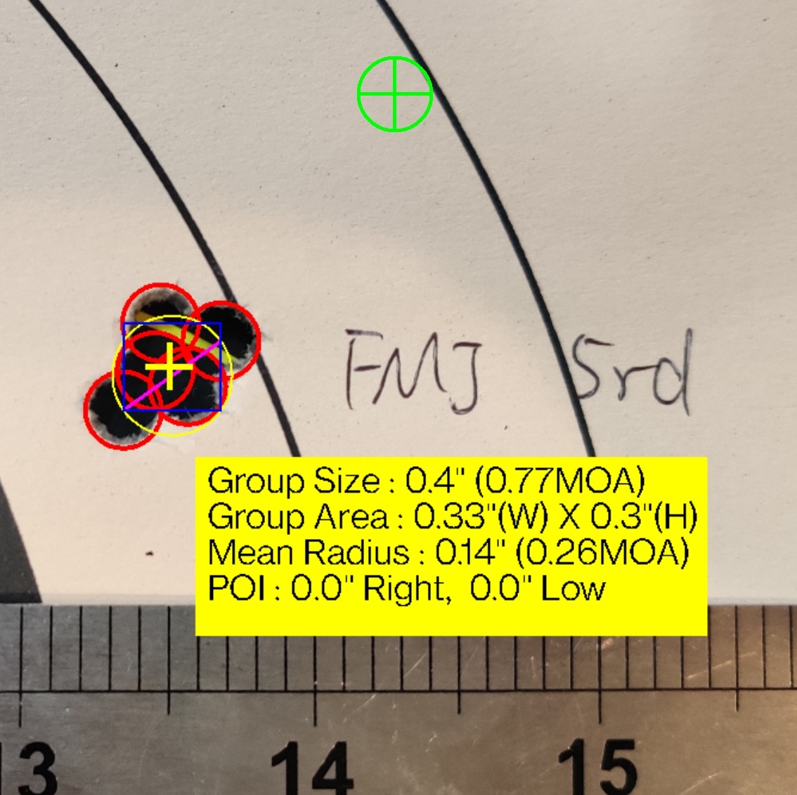

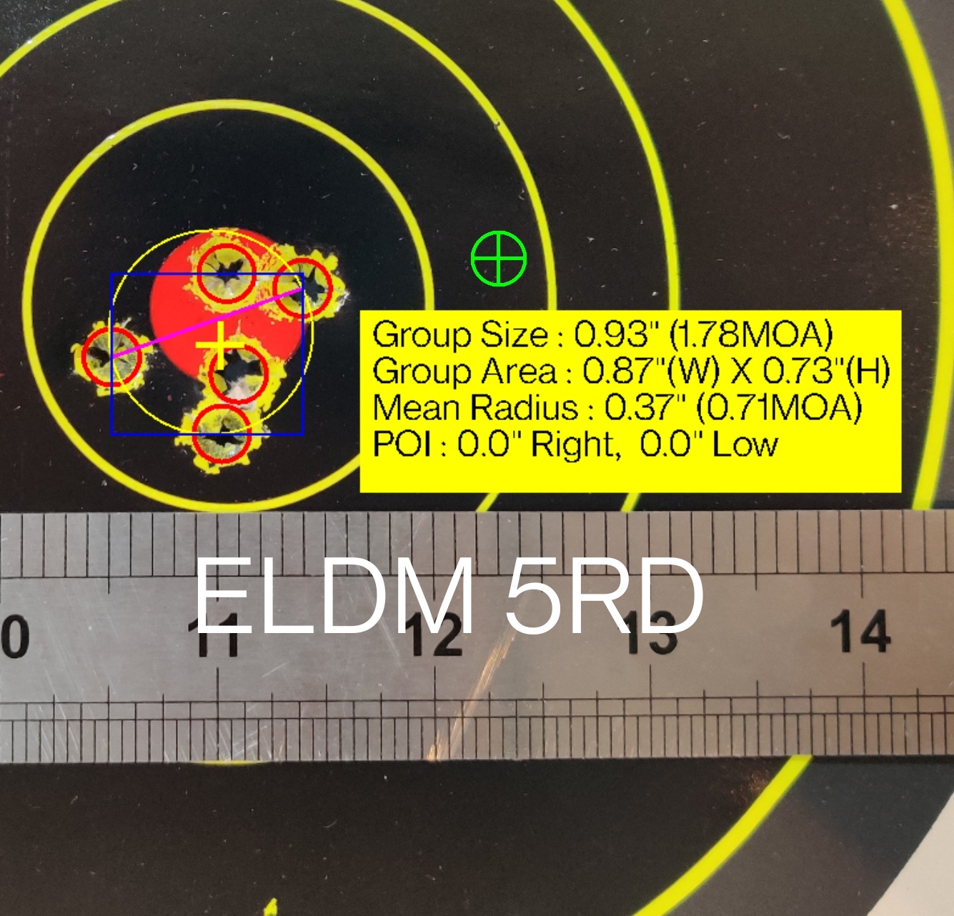

Hi Folks,
It's been a while since I lastly posted about my MPR, worrying that it might not be worth the price, etc. Thanks to everyone who offered advice there!
Now I finally get to shoot the rifle, so here are some updates. There is a somewhat bizarre pattern: cheap ammo "outperformed" expensive ones.
It performed fairly okay at around 0.8MOA with the cheap Sellier & Bellot FMJ rounds($1.2/rd) yet it really sucks at almost 2MOA when shooting the much more costly Hornady ELD Match 140gr($2.7/rd). Both are unmodified factory ammo as I wanted to find a benchmark before trying my reload (and ELDM factory ammo is terrifying me bc my bullets are going to be ELDM too)
Please see attached pictures for the groups, here below are the session info:
  • Very slight wind, 62F weather (unlikely wind causing the issue, and it's not .22 after all)
  • I did 3 groups of FMJ, and then 3 groups of Hornady ELD-Match. All at 50yds. No scope mounting adjustments, but I did turn the turrets for 20 clicks (1/4 moa per clk)
  • All are 5rd groups, with short break in between as I load magazine (so unlikely overheating barrel)
  • Was using a bipod and rear bag, so not as steady as bench rest, but wasn't unstable either
As you can see, the FMJs were giving 0.8moa groups, quite repeatable, and the ELDM just went everywhere. In two of the groups, there were even fliers that did not land on the 8'' target at all (I mean, it's 50 yds, not 500 yds, why....)
I did a little bit of research and it seems like a rifle might be picky about seating depths, but I didn't expect ELDM to be so bad. What else might be the possible reason for the ELDM's atrocious performance? Should I contact Christensen to examine the rifle?
