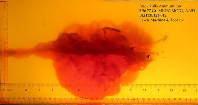

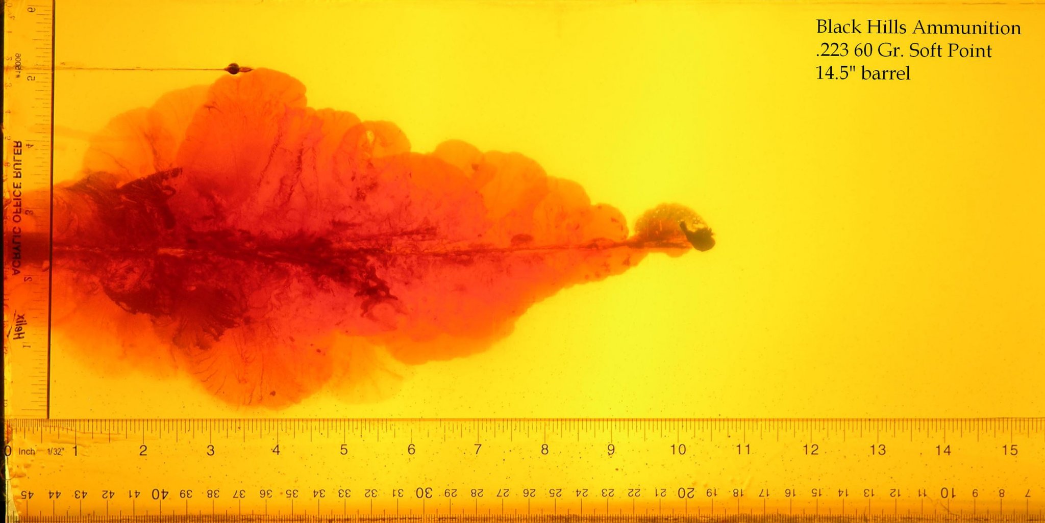

    What started this was I was reading these (sorry, somehow I put expansion in the OP when I'm basically after terminal ballistics on a 2 legged creature):
    http://www.ar15.com/ammo/project/Ballistic_Gel_Experiments/BTAmmoLabsTest6/Test6.htm
    https://www.ar15.com/forums/ar-15/N...__Accuracy_and_Terminal_Ballistics/16-688776/

    Here are some selected photos I quickly pulled off the net that some may find enlightening. Notice the differences in neck length (distance between impact and serious damage) between bullet designs.
    With that in mind, here is the 50gr Black Hills load.
    Expansion velocity floor is like 2200fps with the 50gr TSX optimized, but it’s fast enough you get great performance from short barrels.
    Hornady went the other direction in concept with the 75gr TAP SBR load. Slower bullet with a 1600fps expansion velocity floor according to a poster here. Bullet not available as a component to my knowledge.
    Point being, lots of ways to skin a cat and a hand-loader can do some cool stuff. @redneckbmxer24 is spot on IME with H335 and 4198, BLC(2) is nearly identical to H335, Benchmark is another good one with great accuracy.
