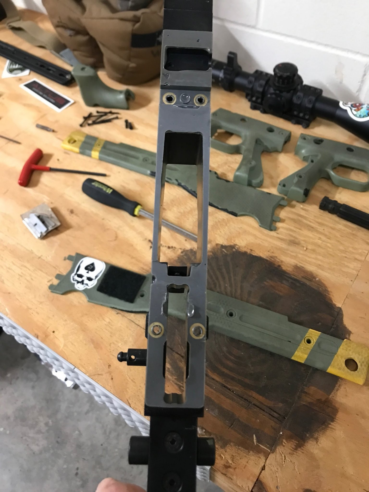

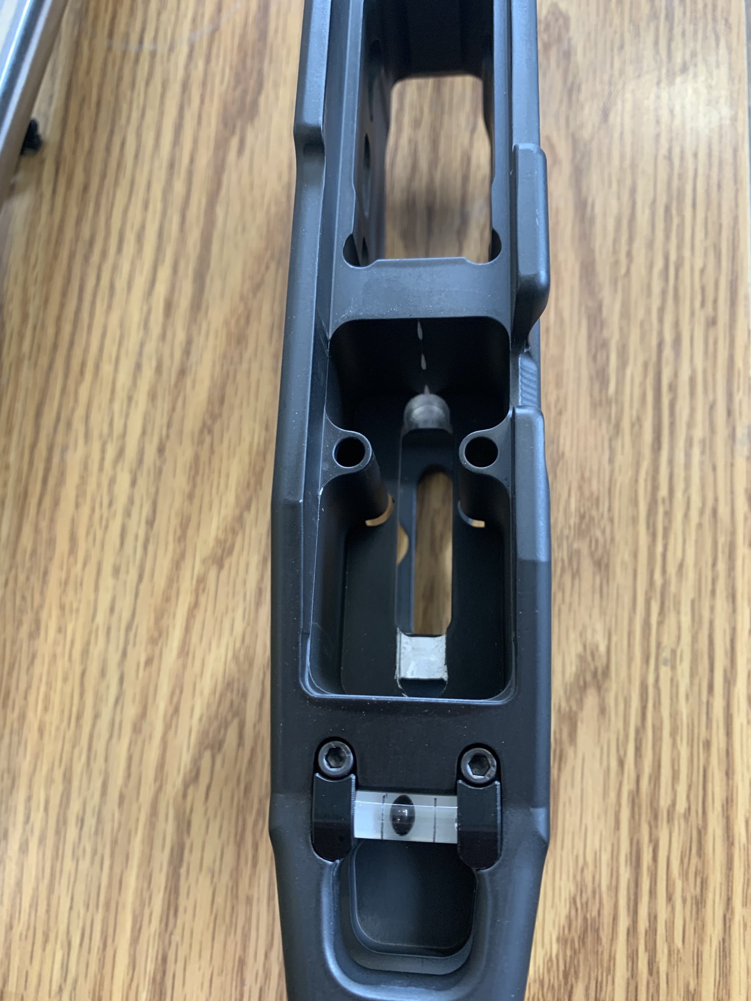

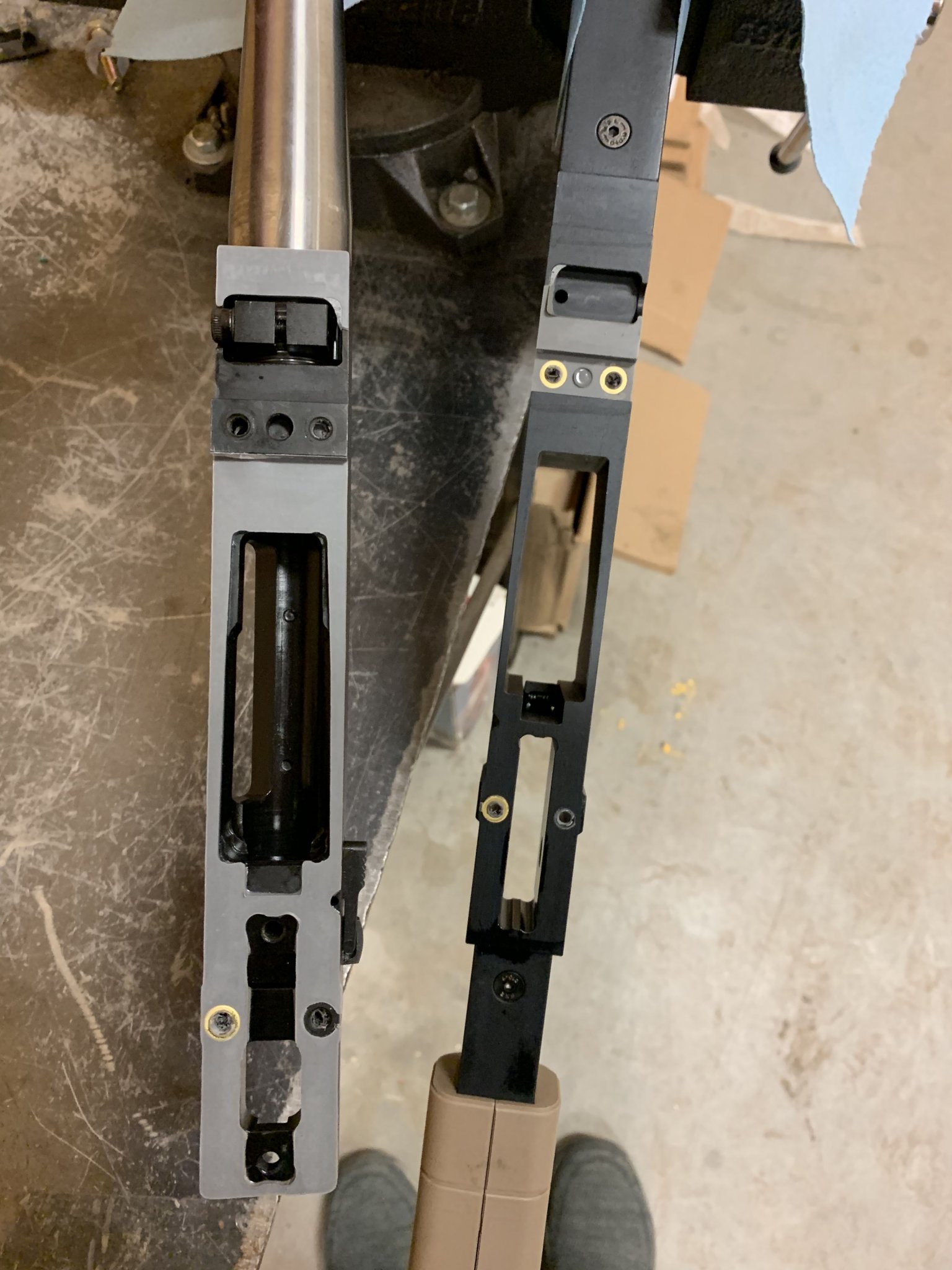

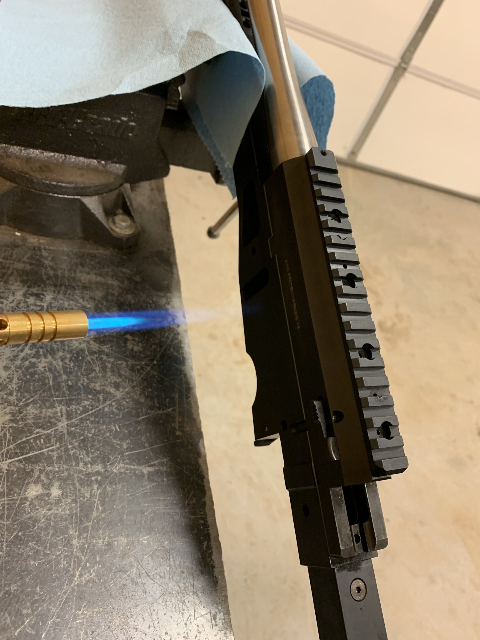

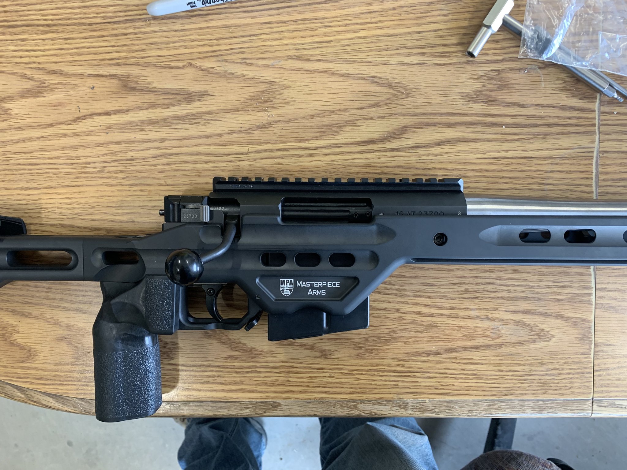

If you’re a hardcore AI fan hit the back button now!!!

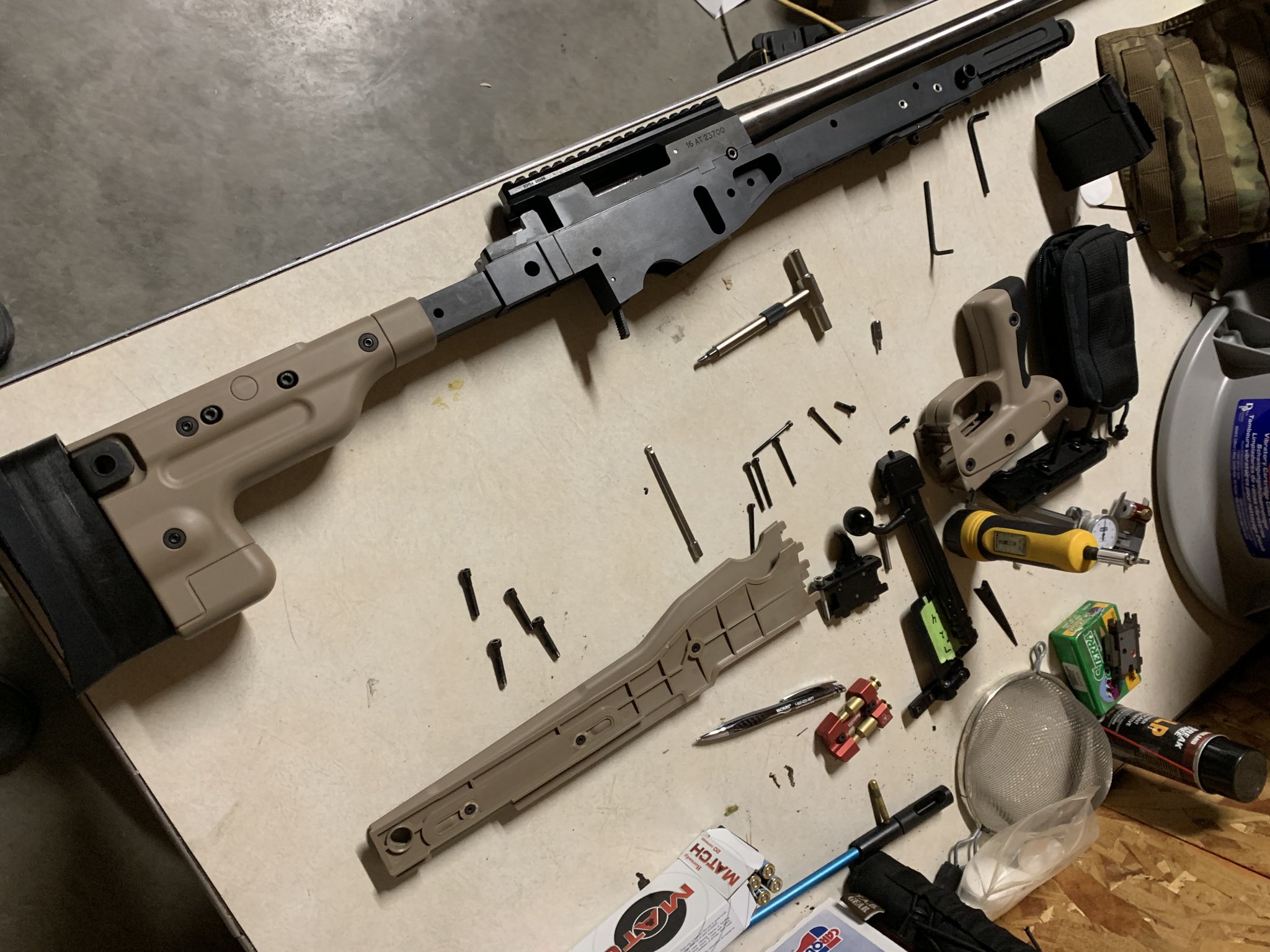

I owned an AX short action for a year or so and was pretty much my main go to rifle for everything except ELR work. However I always wanted a different feel more like my GAP 243 I dropped into an MPA. So a few months back I saw a thread with an AI in an MPA chassis and couldn’t shake the idea. So I ordered an AI inlet MPA and started shopping for a used AT rifle. After some searching and offers that were rejected I ended up buying a new in box AT. (Yes this makes this even more insane!)

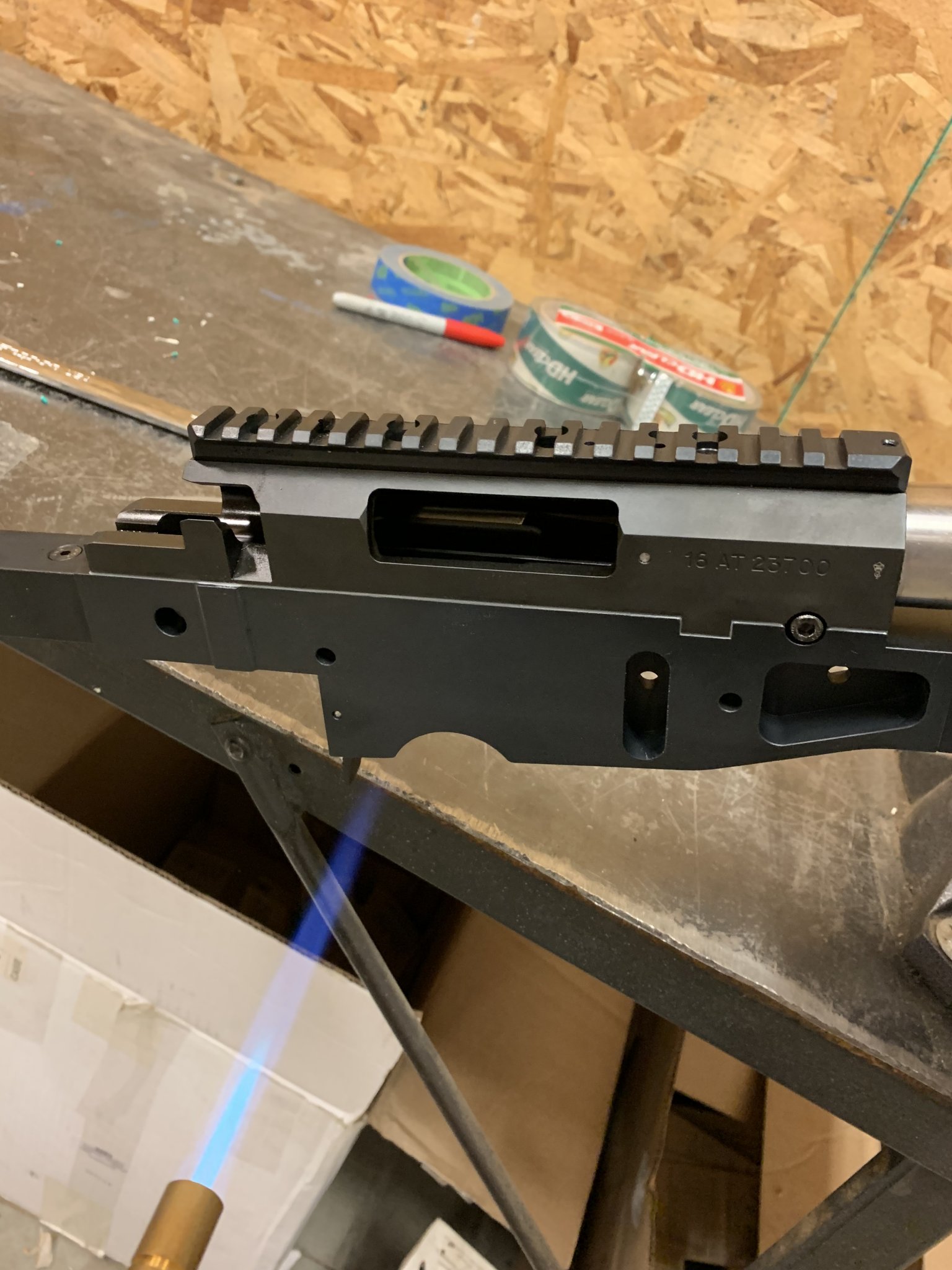

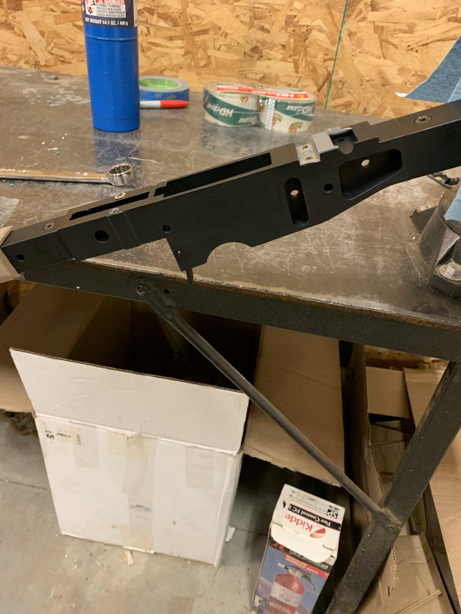

MPA was a few weeks over estimated lead time but really not too bad. Chassis showed up a couple weeks back and I finally had time and built up courage to debond my AI and get this rifle done. I had in the meantime sold my AX so it was time to get an AI back up and running.
The debonding process was really much easier and simple than I imagined and really it’s not irreversible after seeing what is under the hood. Although heating a new AI with a torch is slightly nutty.

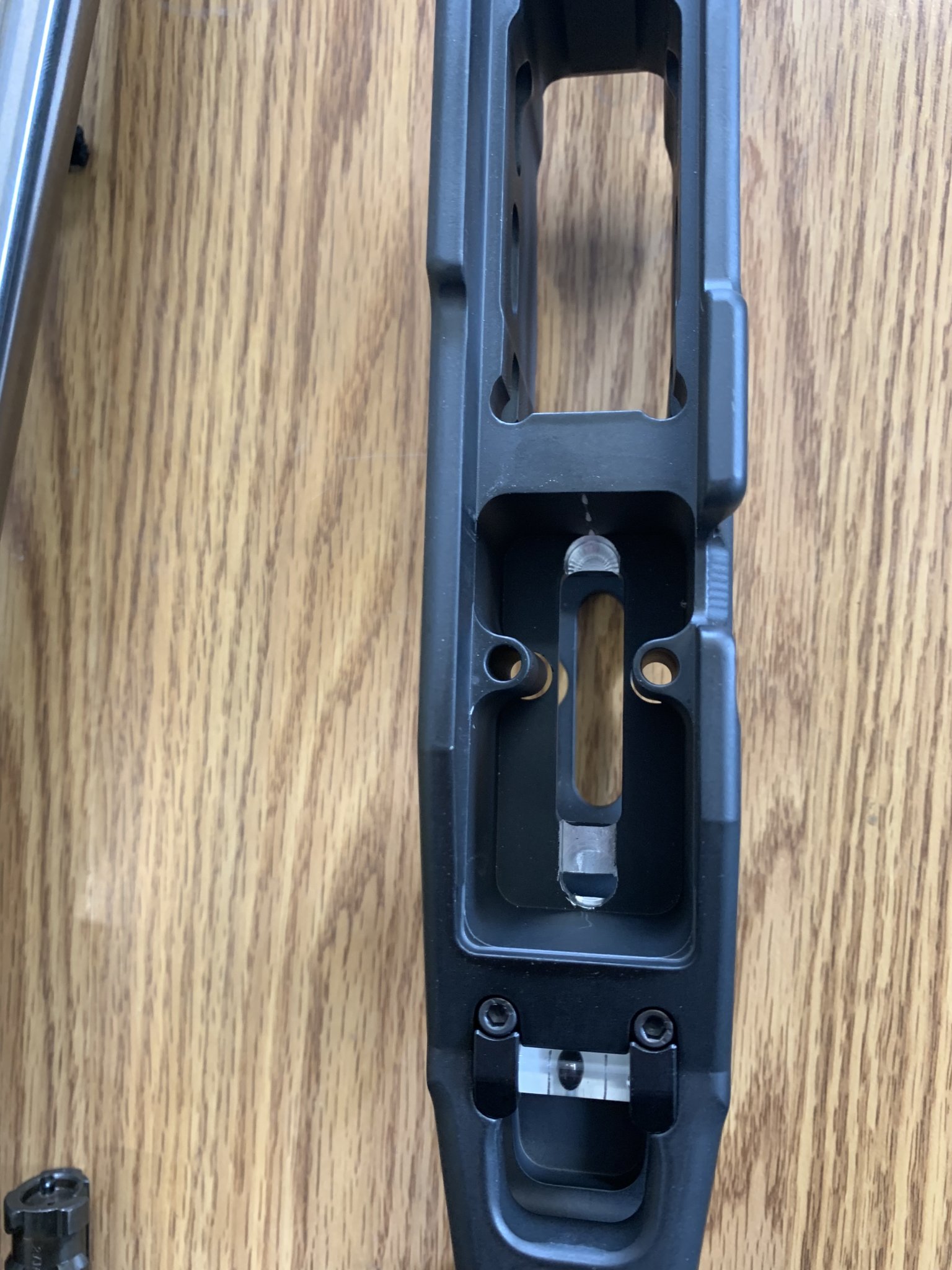

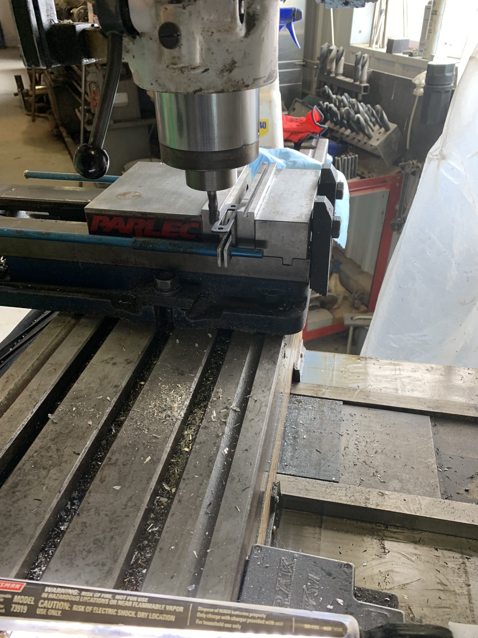

The MPA isn’t exactly drop in ready. A dremel would do but a buddy with a lathe and a mill made it much cleaner to clearance the chassis for the trigger and trigger screws that otherwise bound up or would not let action completely drop in freely. Pictures hopefully will tell most of the story.

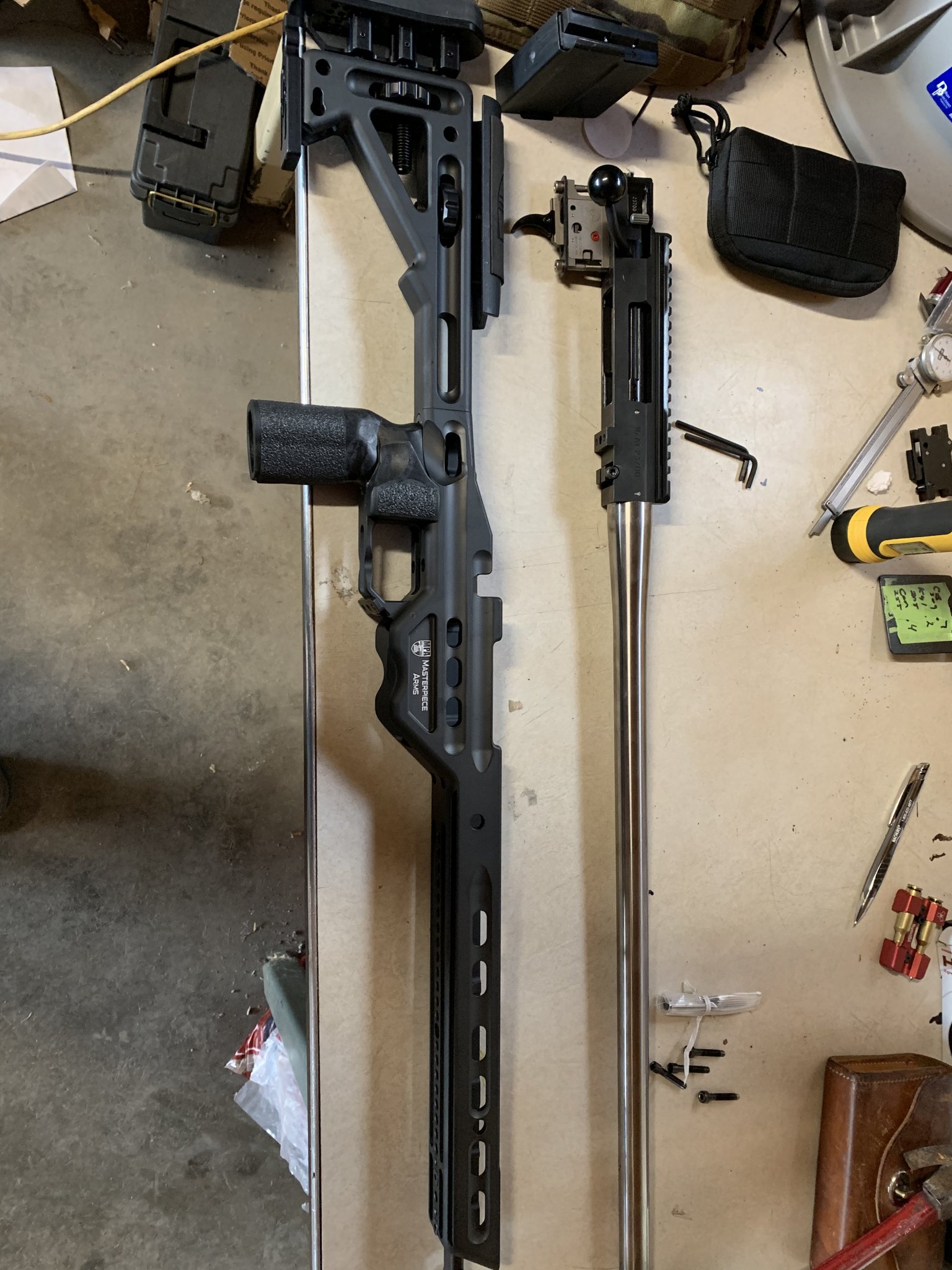

Final product is awesome! AI action and quick change barrel with comp trigger and a chaasis that has all the features and ergonomics I wanted. Rifle still shoots lights out with same barrel and load off my AX.

@Gilly when you assemble/torque the action into the chassis, is it machined to have metal-on-metal contact on the recoil lug? I wonder if MPA did this or not (I would assume they did).
The factory AI interface has clearance around the recoil lug as space for the epoxy, so I am curious how MPA tackled it seeing as it is not bonded.

I don't think it'll have that YUGE of an impact on people's decision. You either want to de-bond it for something else or you don't. XLR couldn't even get the minimum 10 for a group buy on the Envy JV Heavy Fill
I only know of 5 MPA AI's, there are probably more.
The option has always existed to send it back to AINA to have it re-bonded for a small fee.
I think it is great that there are options for guys that want to run an AI but aren't crazy about the AI chassis. It is a love or hate kind of thing with them but their actions are awesome.

OP I’m curious what it weighs. For someone looking for the increased adjustability closer to the AX but not as heavy I don’t see this as a bad option.
The MPA non-folder chassis is 4oz lighter than the AT folder chassis with skins and Sawtooth rail attached. The AX is lighter than the AT.

Actually my AX was a badass rifle it doesn’t get any cooler IMO. But for my current shooting and what I wanted the MPA has more features and yes better ergonomics, this is subjective of course. I didn’t do it for weight savings either. I have an equally or more comfortable rifle with more utility for PRS type shooting with the benefits of AI quick change barrel and bulletproof action for 2 grand less than an AX. And yes it’s pretty cool too. It also makes going between it and my vector in an MPA less awkward.

Now on to the topic. I ran a AX for a couple years in comps and really liked it but I did find some down falls when it come to tight barricades. From top of scope bell to the bottom of the handguard it is really tall and didn’t fit well in those tight areas. The grip never felt really good, the @samb300 rest helped but still didn’t feel natural. Lastly I didn’t like not having one continuous arca rail on the bottom. So for my applications and needs a MPA Chassis fit the needs I had. Weight was not a deciding factor and if I’m not mistaken I don’t think anyone who has posted on the hide that swapped over to a MPA Chassis did it for weight savings. So for me my MPAT goes to comps and my AX goes hunting or for just plain ole’ shooting.

I put my AT in an MPA because:
1. I wanted to.
2. Lengthy discussions with a shooter who has put 1000s of rounds on AT convinced me with better balance, handling, lower CG, and built in modularity. All benefits for PRS style matches. I think an AI-MDT could even be better.
My only regret is not ordering the MPA folder, which would allow me to pull the bolt without lowering the cheekpiece. Although the only reason I’ve ever pulled the bolt out of my AT is to show it to people, or boresight.
