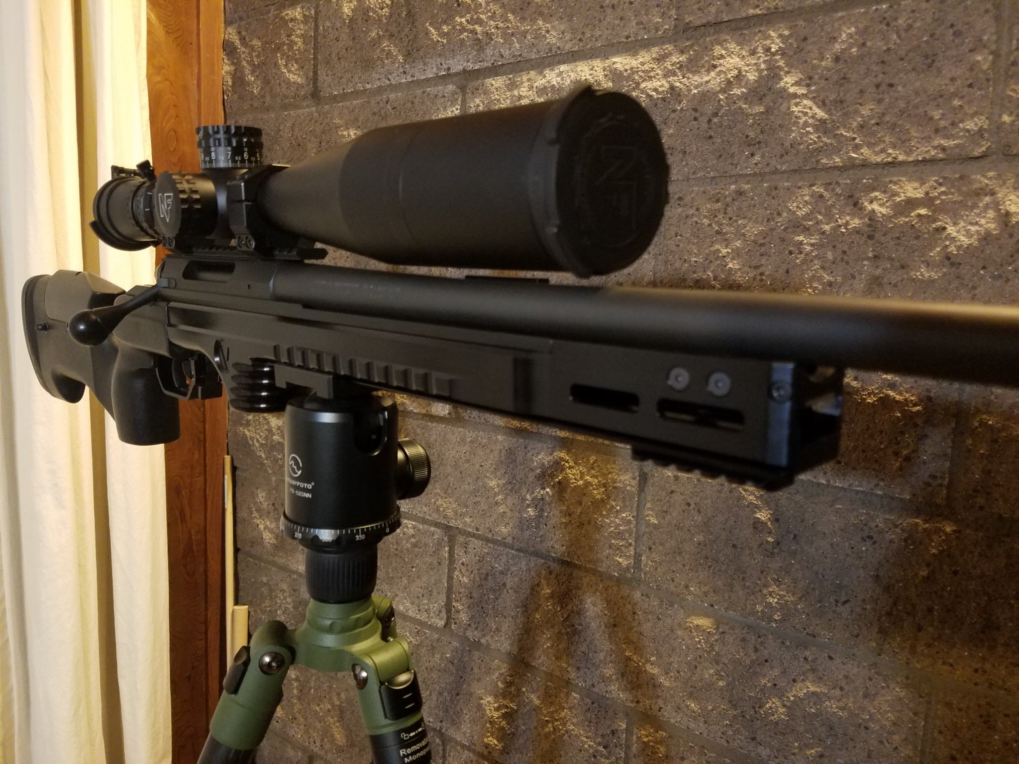

Hi Fellow TRG Shooters,
I have been looking for a way to add some ARCA compatibility to my TRG-22 for awhile. Initially, I had planned to buy a short ARCA rail and mount it with T-Nuts to the UIT/Anschutz rail on the bottom of the forearm. I randomly Googled "TRG-22 ARCA" or somesuch a few months ago, and found a Norwegian company called Vision and Design, who is producing not only a complete chassis system for the TRG, but an upgraded handguard with ARCA built into its full length, and a barricade stop.
Handguard specs:
Features:
  • Low CoG (center of gravity)
  • Integrated ARCA rail for the whole length
  • Barricade stopper integrated
  • Tikka CTR magazines will fit (does not apply for the TRG-42)
  • UIT rail along the bottom of the handguard
  • 2 x M-LOK slots on each side on the front for weights/accessories
  • 100mm extension of the front compared to original
  • No modification to the weapon what so ever – “Plug and play”
  • The hand guard is delivered in a black MIL-A-8625 Type III Hard Coat Anodizing surface.

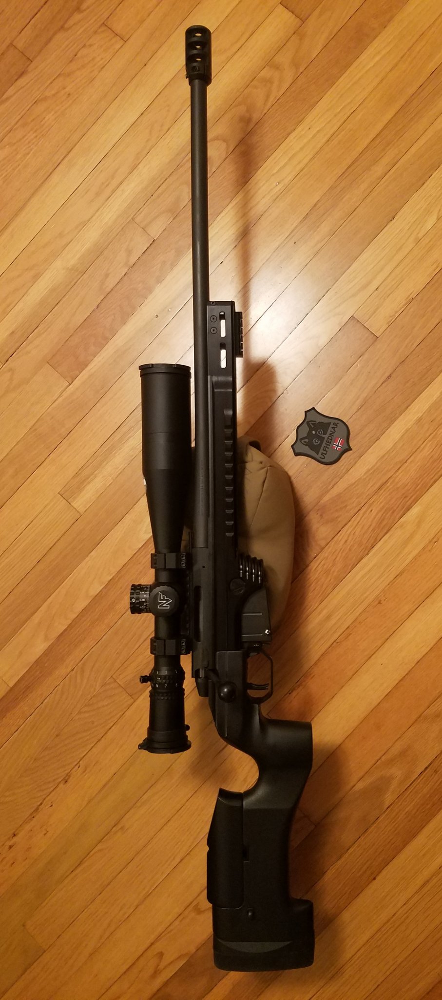

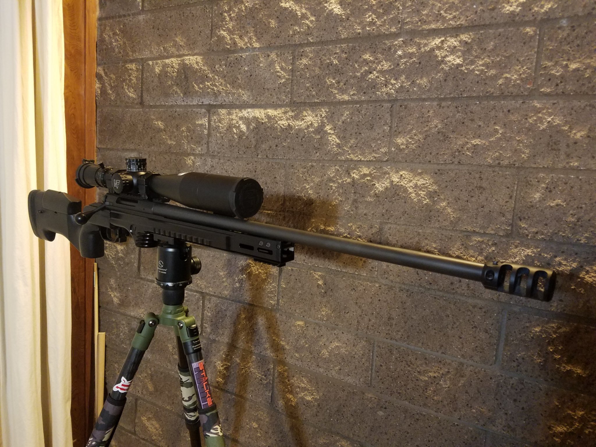

I ordered one of these handguards from their international sales company, Skytterlinken, who was more than happy to ship it to me in SoCal. It was a bit pricey - right around $600 after Euro-USD conversion, VAT taxes and shipping. I received the handguard yesterday and installed it on my rifle. Since my B&T atlas spigot does not work with this handguard, I mounted a piece of picatinny into its Anschutz rail using T-Nuts. It looks great, gives me a full integrated ARCA rail and moves the rifle's COG much lower when setting up on a barricade bag - it's totally flat along its entire length.
I don't have any Tikka mags to test their claim that CTR mags will fit, but my Sako mags snapped in just fine. I haven't tried cycling any rounds yet.
I don't work for the company, and am not affiliated with them in any way. I love my TRG-22 but have been bummed by the lack of options for ARCA, so wanted to share with my fellow TRG shooters.
I can't wait to get this out to the range!
- enichols

Looks very interesting. How much does it change the balance point, and does it move it forward or back?
@acourvil - I played with it a bit more today, and it seems to have moved the balance point just slightly backward. The balance point seems to be either right at the apex/downward point of the barricade stop (which forms the front of the magwell), or even directly underneath the magazine itself.

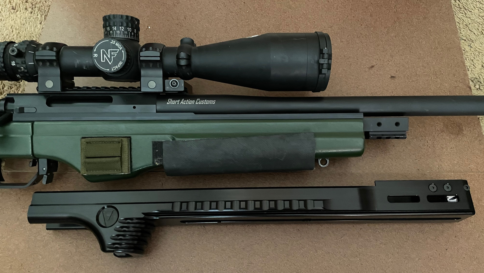

It is heavier than the OEM forearm. If you compare just the forearm, it is approx. 13oz v 30oz. If you compare the OEM forearm with a bipod spigot and a 6" ARCA rail addon, it is 23oz v. 30oz. I think the balance of my rifle is better with the Skytterlinken forearm, the balance point ends up just in front of the mag well (this is with a 28" barrel, but also with the terje338 adjustable cheek spacer in the butt). The Skytterlinken forearmis several inches longer than the OEM forearm (see pic below).
The Anschutz rail is narrower, the old sling loop I had in the OEM forearm does not fit the rail in the Skytterlinken forearm.
With dummy rounds, the CTR mags load just as well as the TRG mags.
My initial impression is very positive; I'm going to try to shoot with it a little tomorrow.
Wonder if the Vision forearm uses a freeland rail instead of the UIT(Anschutz) spec rail on the TRG...
Does the slot appear deeper on one or the other?
I did a quick measurement; the Sako OEM rail is .402 wide and .183 deep; the vision forearm rail is .387 wide and .200 deep. This was a quick measurement, so I could be off by a few thousandth, but they are definitely not the same. I’ve heard in the past that the TRG rail is not standard, so that’s not too surprising. FWIW, this is from a TRG from circa 2011.

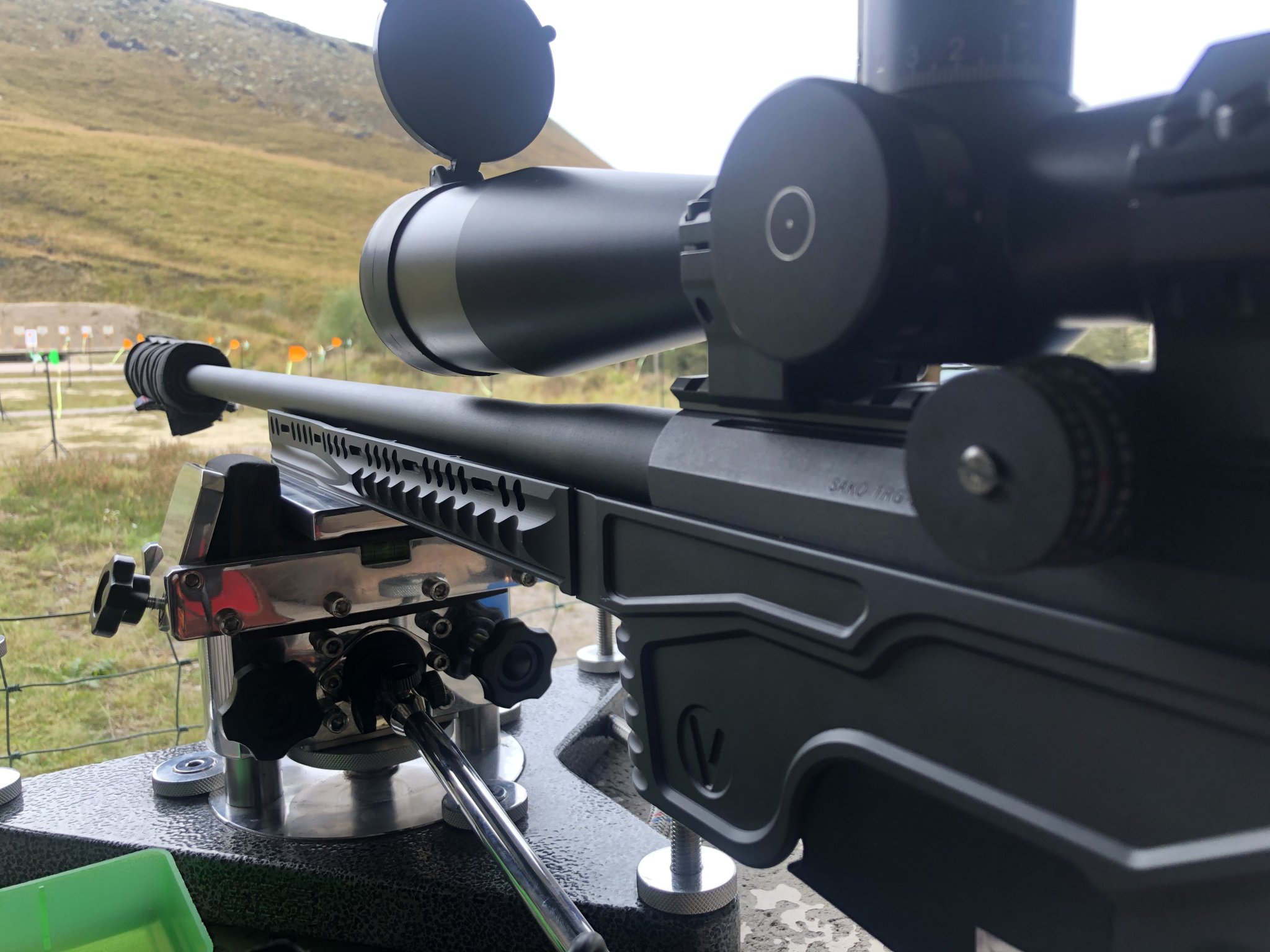

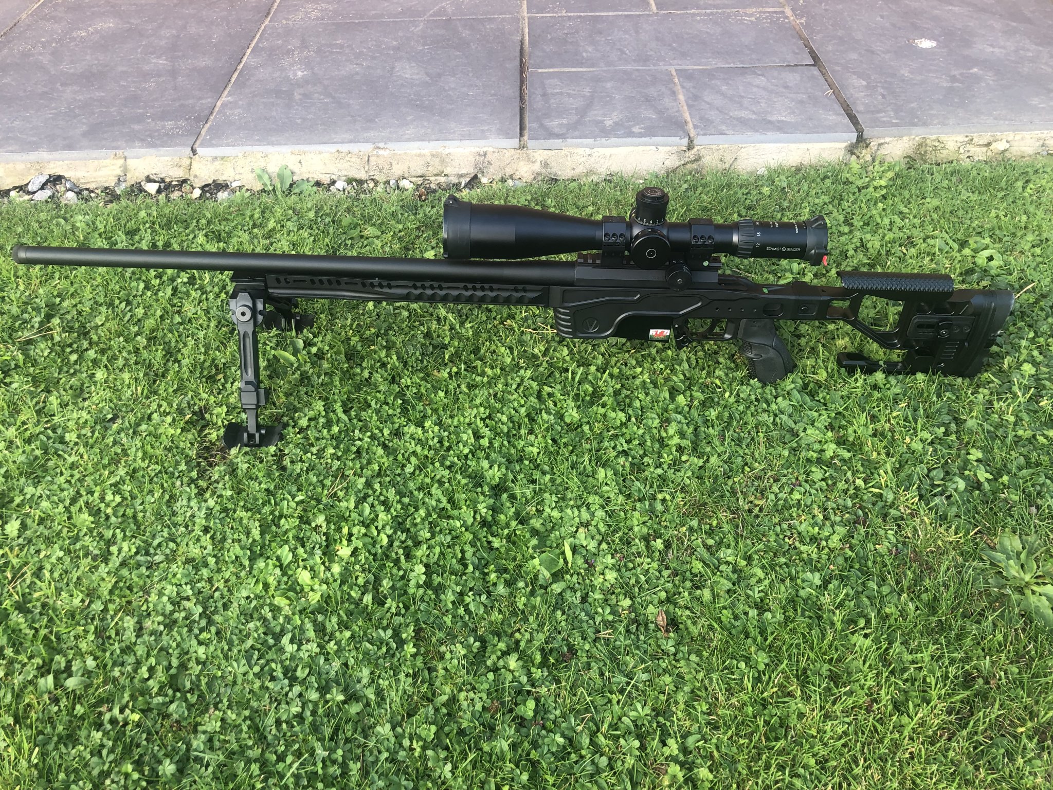

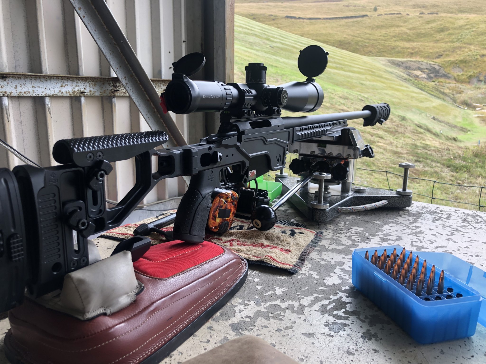

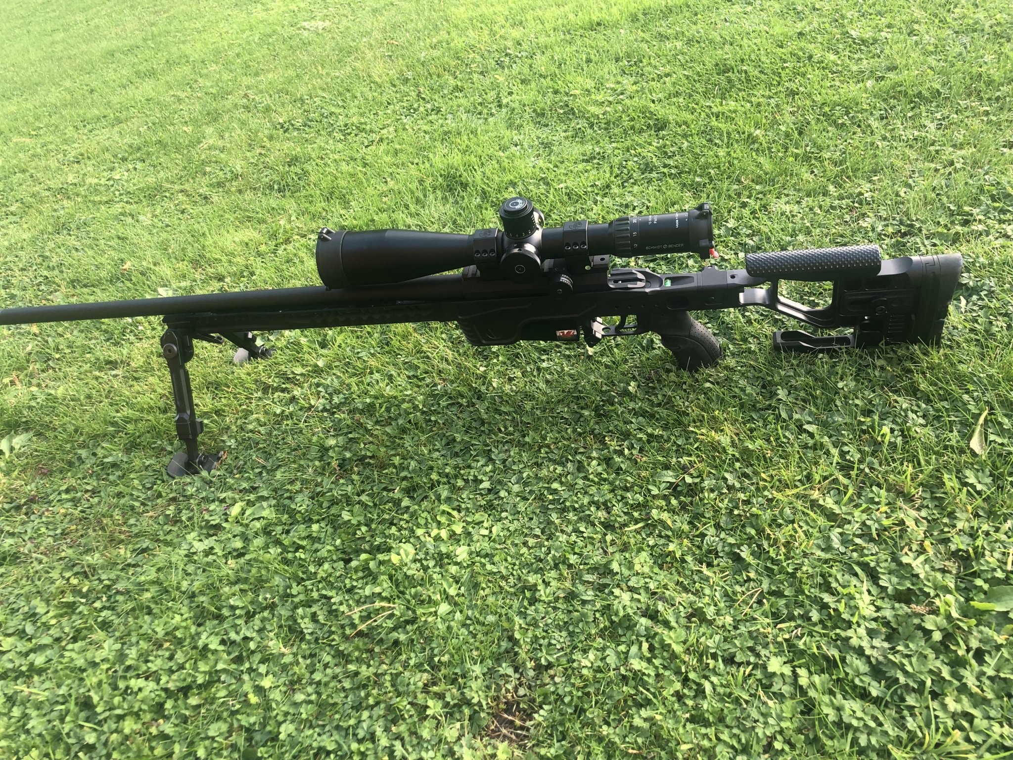

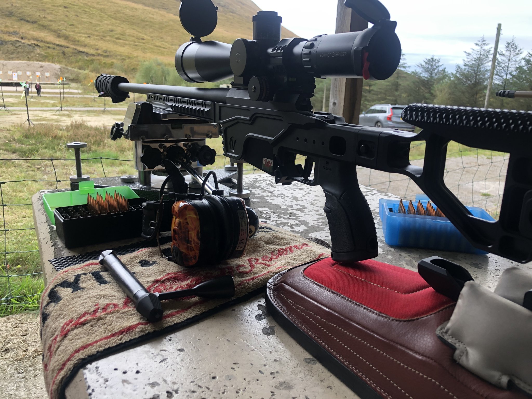

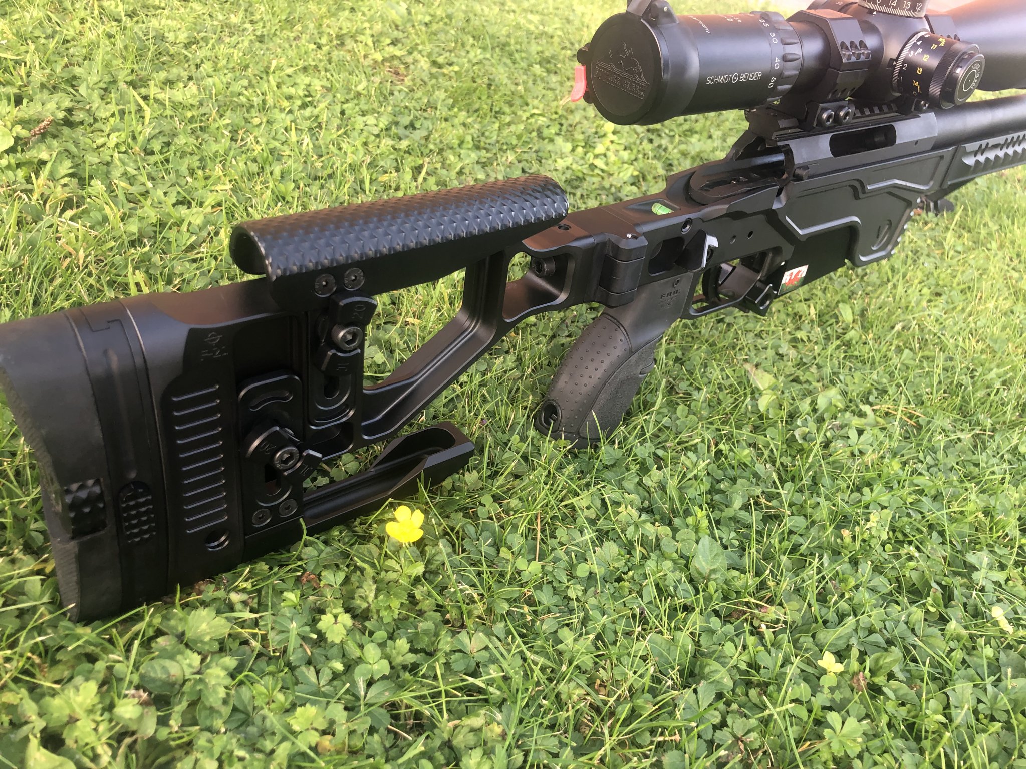

Great stock. Totally modernises the Trg
