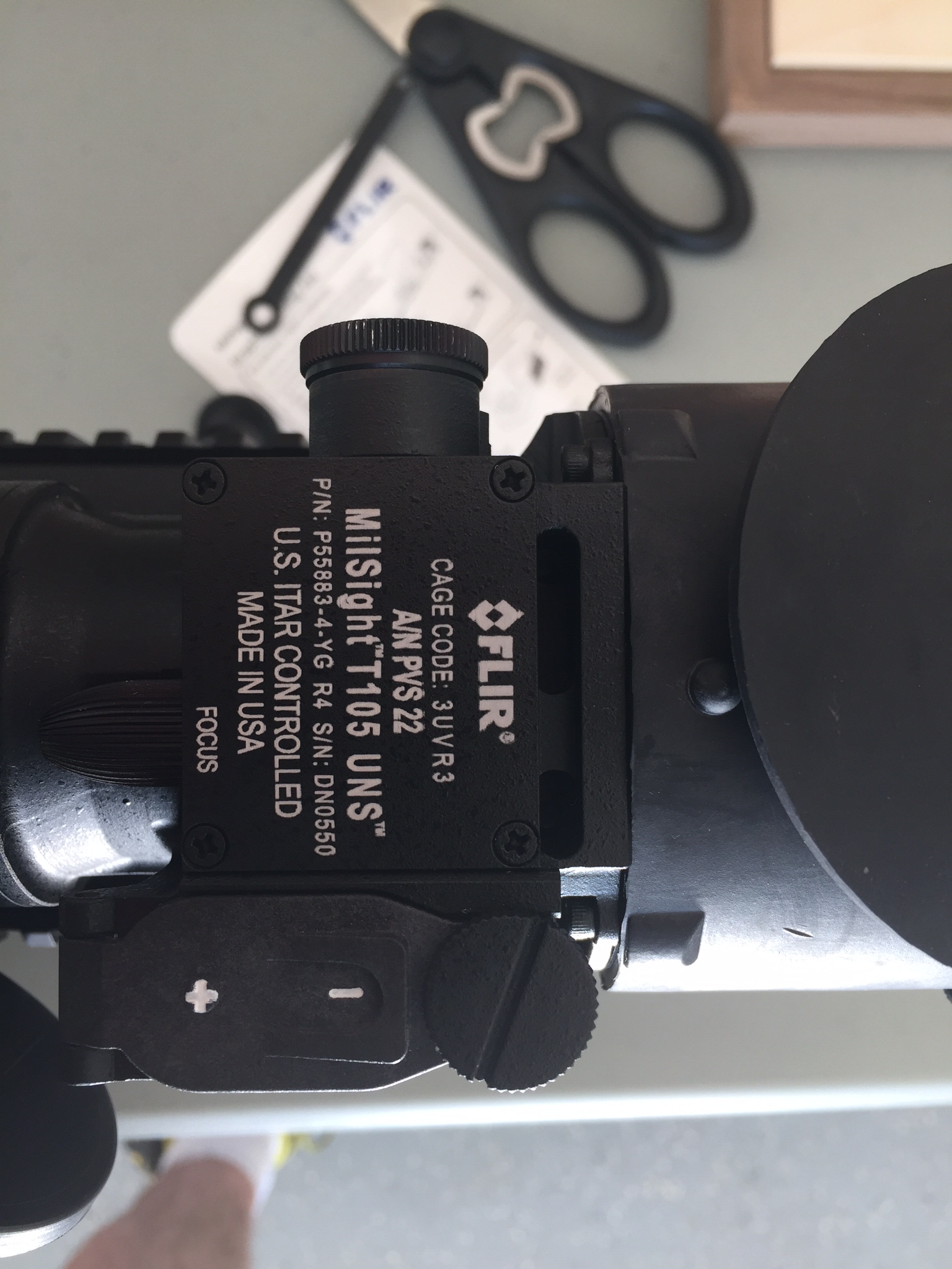

I ordered it from TNVC who got it direct from FLIR IIRC. Had to wait a few weeks for it to be built at the factory as they are assembled as ordered due to the cost of new or were at that time.
I’d have to dig out the literature on mine to find the specs. That’s not an option at this very moment.
The housing doesn’t state FOM like the pvs30 reviews I YouTubed.
It’s not a bad tube. Better than any d-series standard film dedicated scope I’ve messed with. As good if not better due to pinnacle and adjustable gain than the pvs-12 6x I used beside it one night last fall.

I'm sure that thing has a great tube in it if it's FLIR, I doubt you're going to see much if anything going to a PVS-30.
I'd first try running it in front of a day optic with higher resolution and also possibly a brighter illuminator.
All 30’s have pinnacle tubes in them. I’ve seen and used at least a dozen from this program and they’ve all been excellent in terms of tube quality and resolution no matter the fom.
That said I don’t believe the 30 is going to be a dramatic leap above your 22 and the 27 isn’t either. There are some gains from lens size/light gathering but it’s not huge.
I’m not sure why people feel the need to shoot at high mag in the dark with clip ons. It’s just not necessary. 6-10x is plenty even to 1k. Dark is an entirely different animal then daylight shooting. Almost anyone I put behind a night optic shoots better then they do in daylight in terms of groups and good wind calls etc. you focus on fundamentals and a solid cm hold rather then seeing your impact on steel and trying to force correct etc.
All clip ons do about the same thing when you start stacking on magnification and reducing the exit pupil so keep the mag in a the happy window and shoot

The fom isn’t listed because your clip on would have come with a spec sheet listing snr and lp/mm. That is the fom

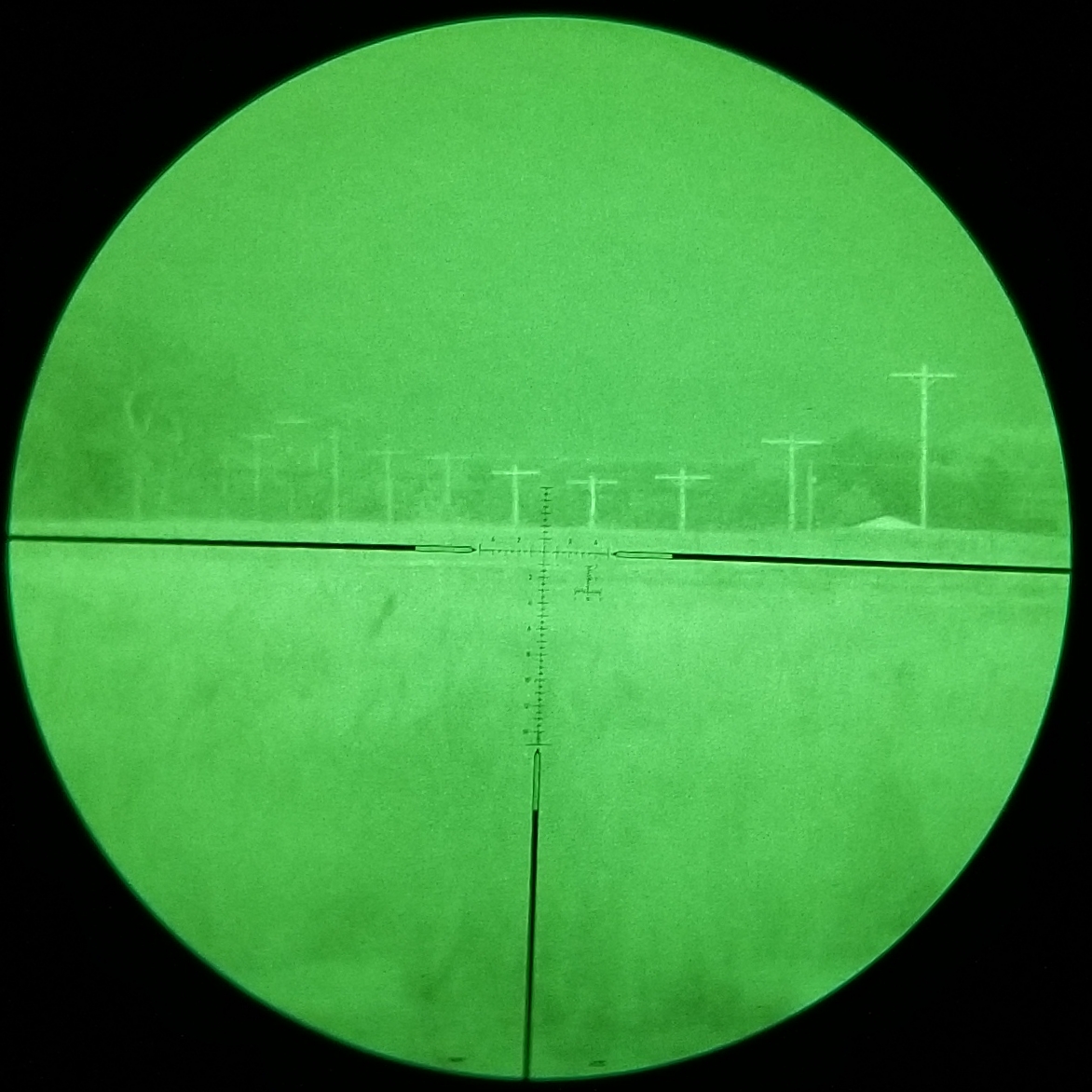

Mike, ATACR was set on 4x, this was taken an hour after sunset, so just entering Astro Twilight. Clear sky, plenty of stars and moon at 20%.
I'd have to range that "can" you see on the right, but I'd say it's between 1100 and 1200
