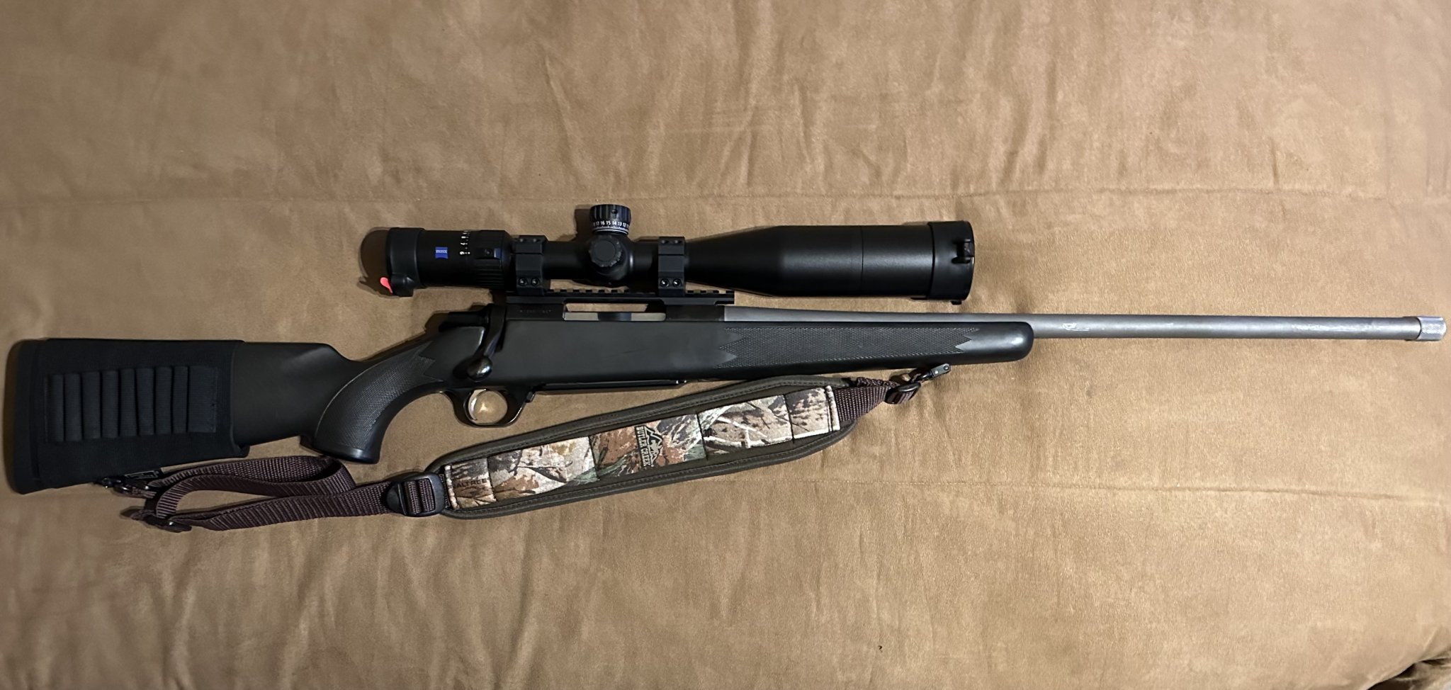

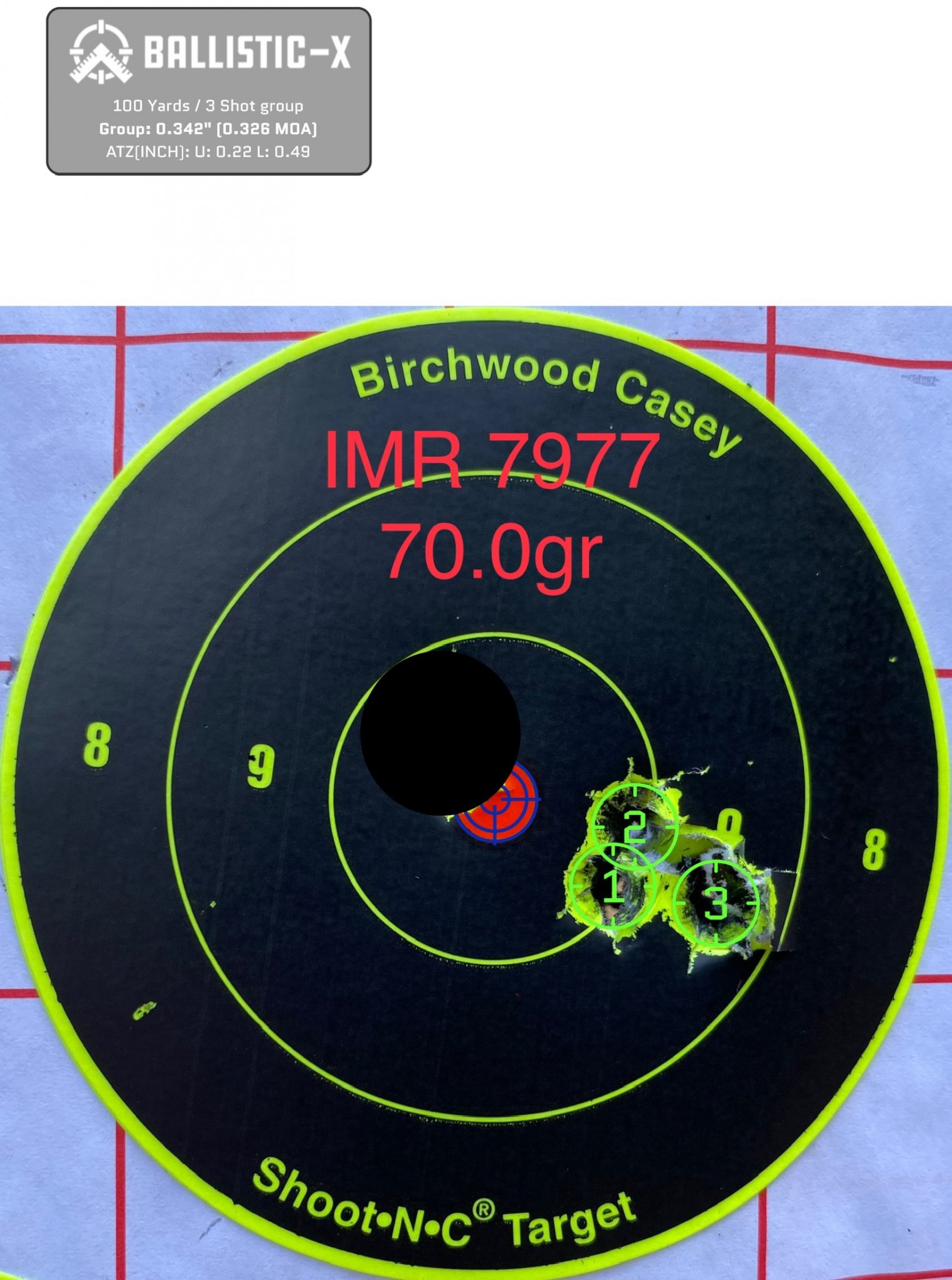

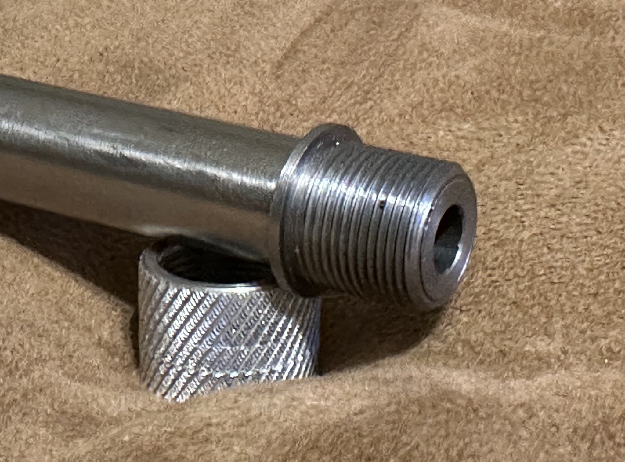

I have a custom A-Bolt II 7mm RemMag I had built. Factory tube shot ~1 MOA, then one day at the range it shit the bed and randomly started shooting 2 MOA groups with the same load that was shooting 1 MOA.
So I had my smith borescope it, and it was toast, so I had him put on a 26” 9.25 twist stainless barrel (which I later had cut down to 22” and threaded for a suppressor), and blueprint everything. He cleaned everything up, but said the runout and tolerances were very nice for a factory rifle. Now it puts down 1/3 MOA groups on average with my Berger 168 VLD load.
Ballistic-X-Export-2022-05-21 16:24:48.445141.jpeg

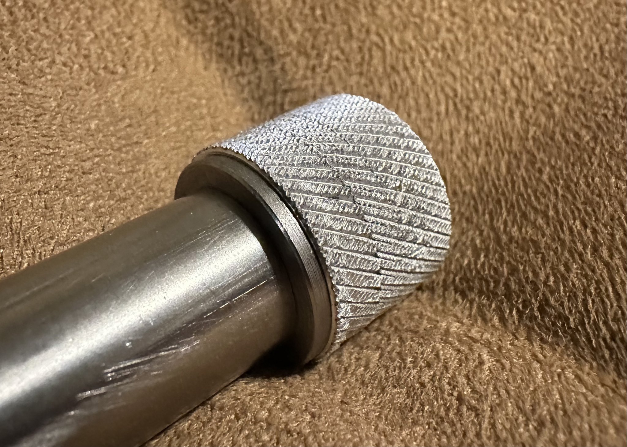

Nice. Based on Browning Tech, the barrel is not thick enough to be threaded. Seeing as there are no issues at this time I have to really weigh the pros and cons of making the same mods. The consensus seems to be to keep it as is. With that in mind, I will just start focusing more on a new rifle. Thank you all for the input.
Even light sporter contour barrels can be threaded for a muzzle device.
With minimal shoulder, an adapter can be fixed in place with rocksett or loctite then machined/threaded concentric to the bore- or you can select a brake or can that will index off the flat muzzle instead of a shoulder.
Thanks. I recently came across an Ultimate Reloader YouTube video on "Threading a THIN Sporter Barrel for..." and it gets pretty detailed. It is pretty much what you describe above. Unfortunately, that modification is far beyond where I will take this. I will keep the WSM as is and move forward to purchasing a new rifle. I think it will cost about the same, only I will have two rifles. The original 7mm WSM and a 7mm PRC. With that in mind I am looking at the X-BOLT Speed (24" Threaded Barrel), X-Bolt Speed SR (20" Threaded Barrel) or the X-Bolt Speed LR (26" Threaded Barrel) I like the 24" Barrel, but the Muzzel Threading "M13 - 0.75" is throwing me off a little. If anyone can clue me in on this Muzzle Thread "M13 - 0.75" it would be helpful. There seems to be an adapter that I can use to mount a standard threaded (5/8 - 24) muzzle device.
