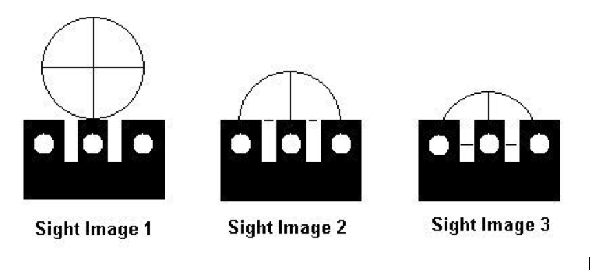

For the Sig's their sight picture adage is "float the FRONT SIGHT dot, break the shot"......Sight Picture # 3 for Sigs.

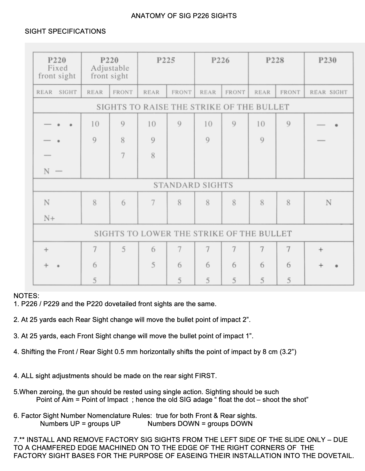

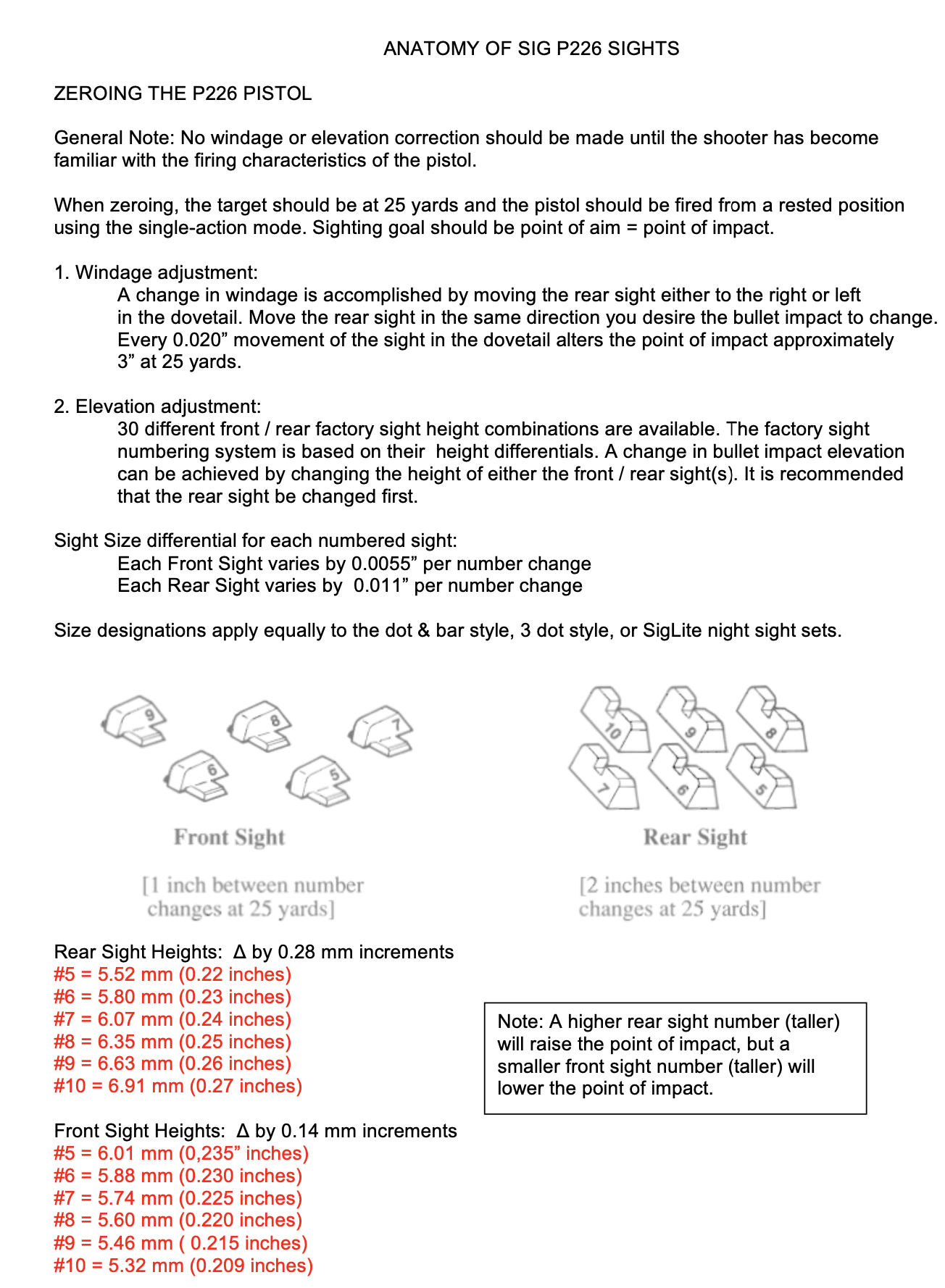

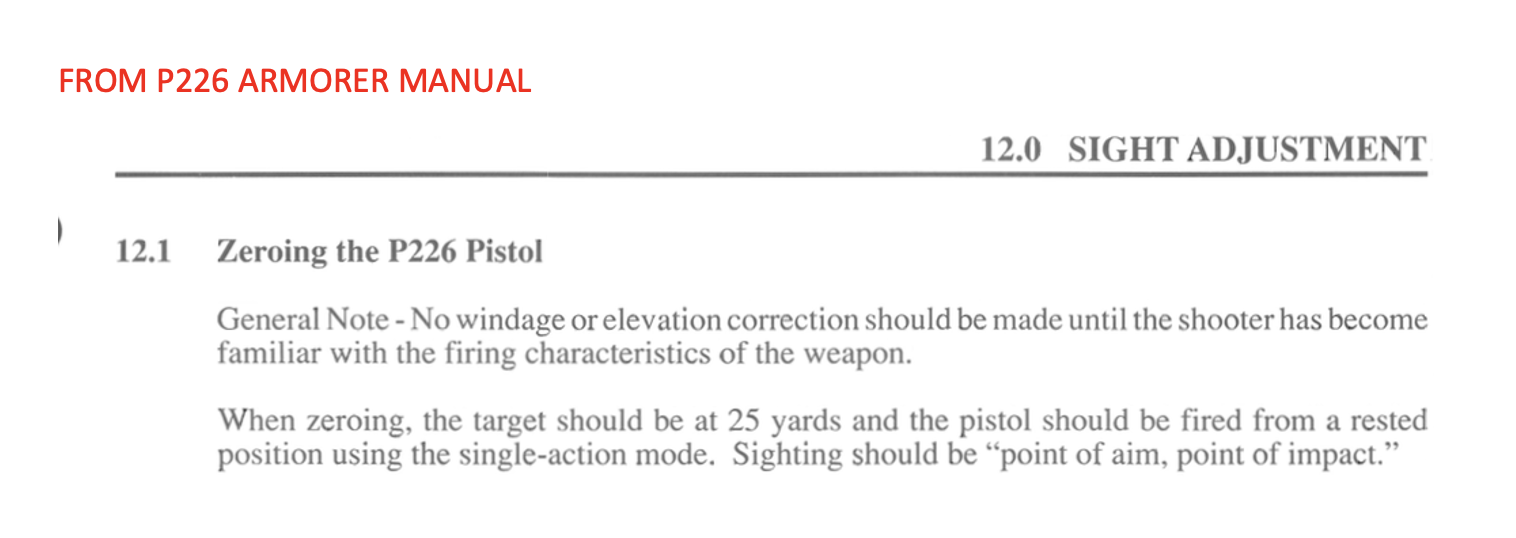

Any adjustment of sight #'s, the rear sight is changed FIRST.
The P226 / P229 ; every 0.007", i.e. 0.2 millimeters, ( the thickness of an index card) height increment changes Point of Impact ~ 1" @ 25 yards.
The same is true for rear sight windage adjustments.
