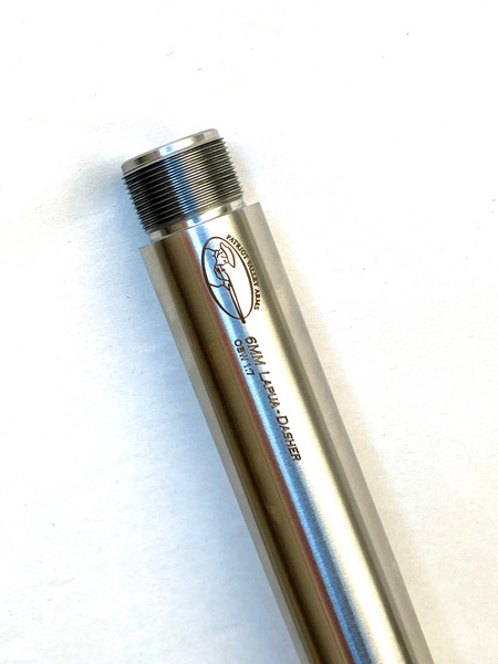

I'll take the opportunity and toot my horn a little here:
I started the Tikka prefit industry, first as barrel nut installs and then as shouldered prefits.
We are the experts in the field.
We can make you whatever you'd like. Stainless, fluted, carbon, cerakote, no cerakote... anything from 16.5-28" long and I have blanks on hand in any contour from a pencil (we make the cores for our own carbon blanks) up to 1.16" dead straight.

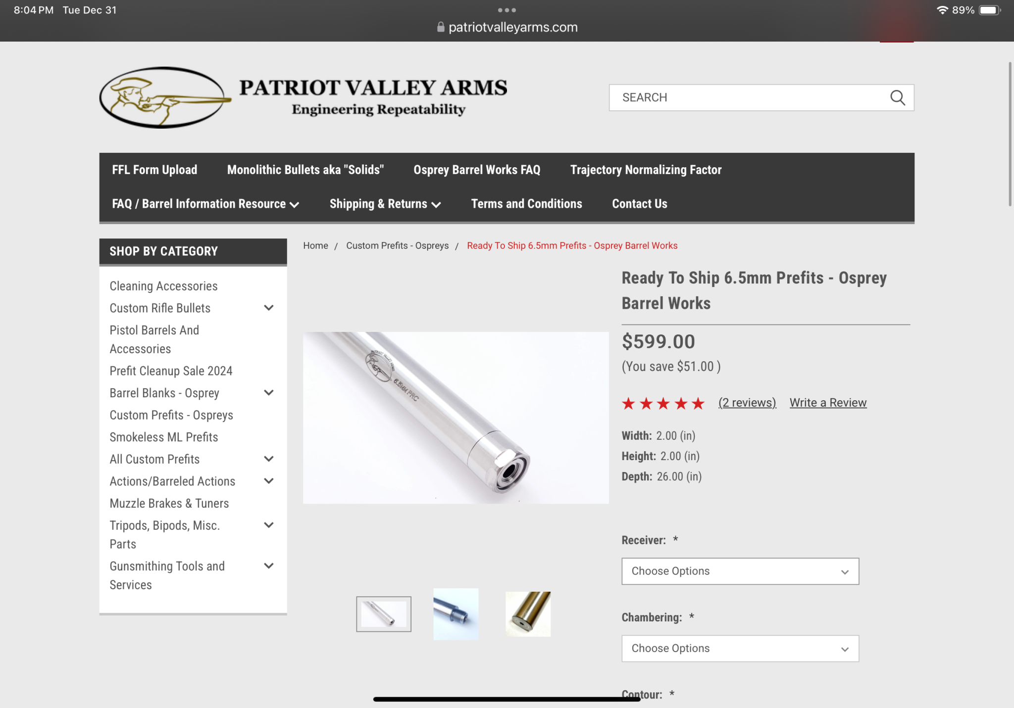

Is there a reason I can't send you a PM? Tried but not working. Have a few questions. Would consider PVA - have heard nothing but good things.

Ospreys are comparable to the cream of the crop, top shelf blanks out there. We regularly hear feedback from customers (hunters, competitive shooters, and just regular enthusiasts alike) that the Ospreys are among the most repeatable and accurate rifle barrels that they've owned.
The Osprey is our own product.
We make them here, we know what our production schedule is and our lead time had dropped while our on-time delivery has increased substantially since 2021.
If someone is waiting for a $599 button rifled Rock Creek prefit to come back it's going to be a long, long wait as there are no plans to resurrect 2018 pricing with a blank we no longer purchase.
I stopped incoming PM's because people couldn't handle the rule "no order changes will be honored through anything except PVA emails. We will not do it via voicemail, facebook, or forum messages".
office (at) patriotvalleyarms.com is a perfect way to get ahold of us. Either Ben or I respond within 1 business day.

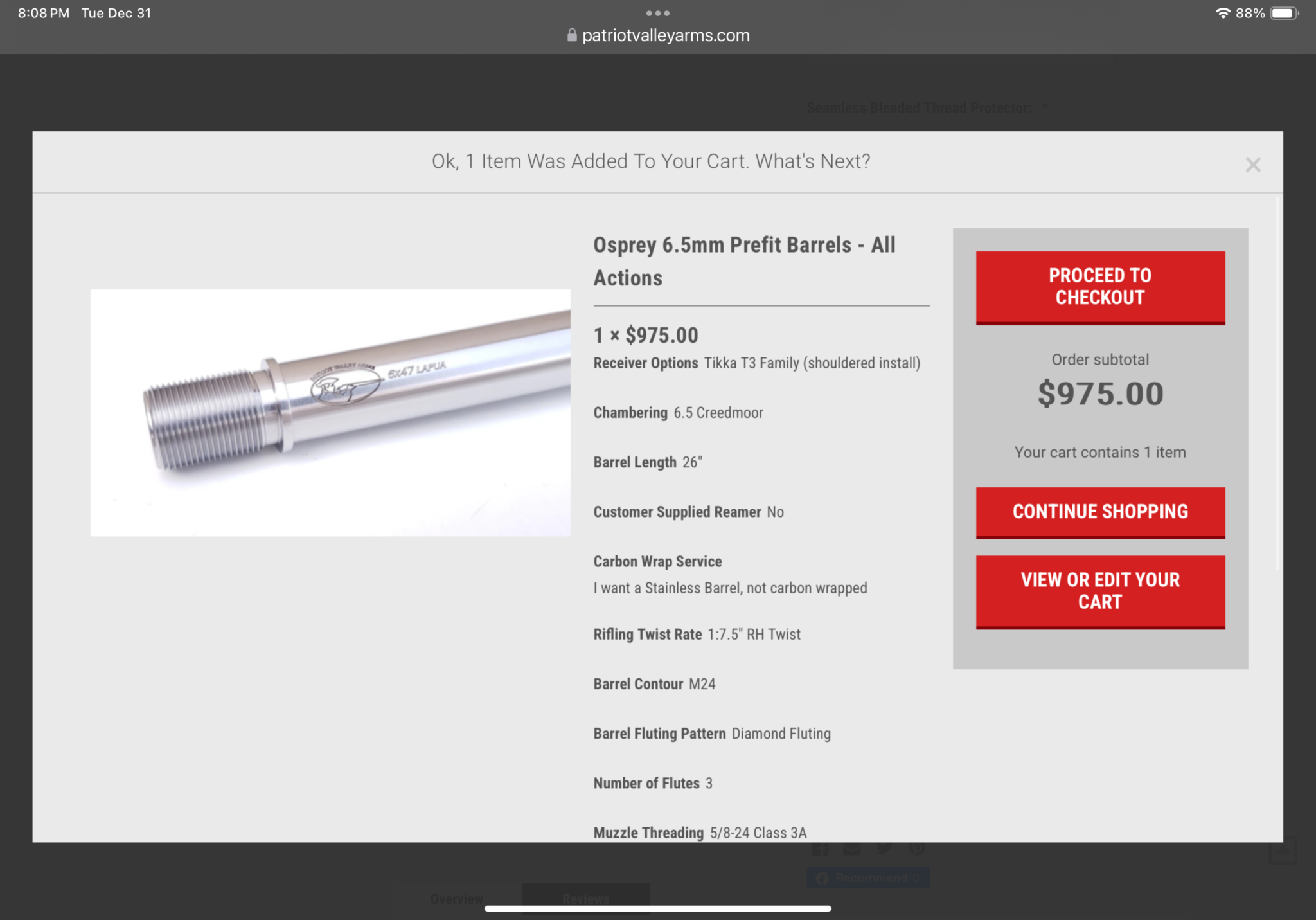

You said you wanted a fluted, cerakoted, threaded barrel. That's what makes it more expensive than a plain prefit.
Yeah I gotta have it threaded
I’d be fine if it’s blued instead of cerakoted if that saves money. Don’t want a raw steel barrel anymore. Can live without flutes
But none of those changes take it from 500 to 1300. They take it from 1000 to 1300. Relatively small changes

Thanks for the reply.
Someone above had posted to get a $600 prefit. I didn’t make it up that in my head.
I’m not looking for a Mercedes. Just trying to figure out the option that makes sense.
When PVA has them in stock.
And if you want a custom Barrel, that’s fluted, threaded and cerakoted

I don't have any reviews on Osprey - are they up there with the Bartleins of the world?
From what Ive read the Ospreys are up there with the Bartlein, Proof, Kreigers, Benchmark, etc.. Cut rifled SS hand lapped

There are reviews on the website for each barrel, click on "Reviews" in the product description area to see them.
