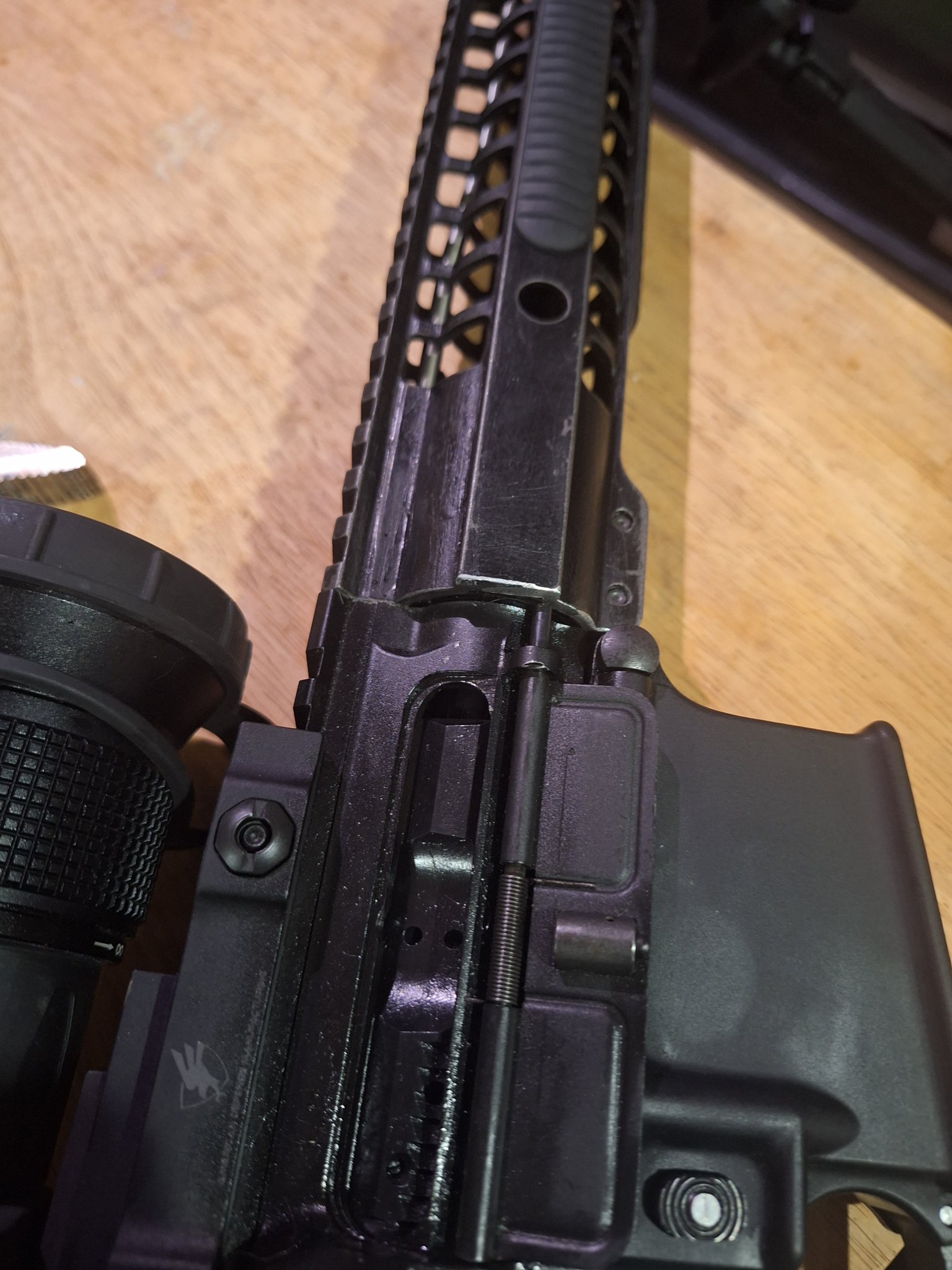

My current build is acting up big time with 62 grain FMJ. It will chamber the round but the BCG has a hard time closing all the way forward. Once chambered it is really hard to pull the charging handle and extract. I have to bash on the CH with a mag to open the bolt.

I've been messing with this build quite a bit so I can't remember if this upper receiver has given me problems, but i don't know if its even possible for strictly an upper receiver to cause issues like this.
Has anyone had an upper receiver cause problems with certain ammo?

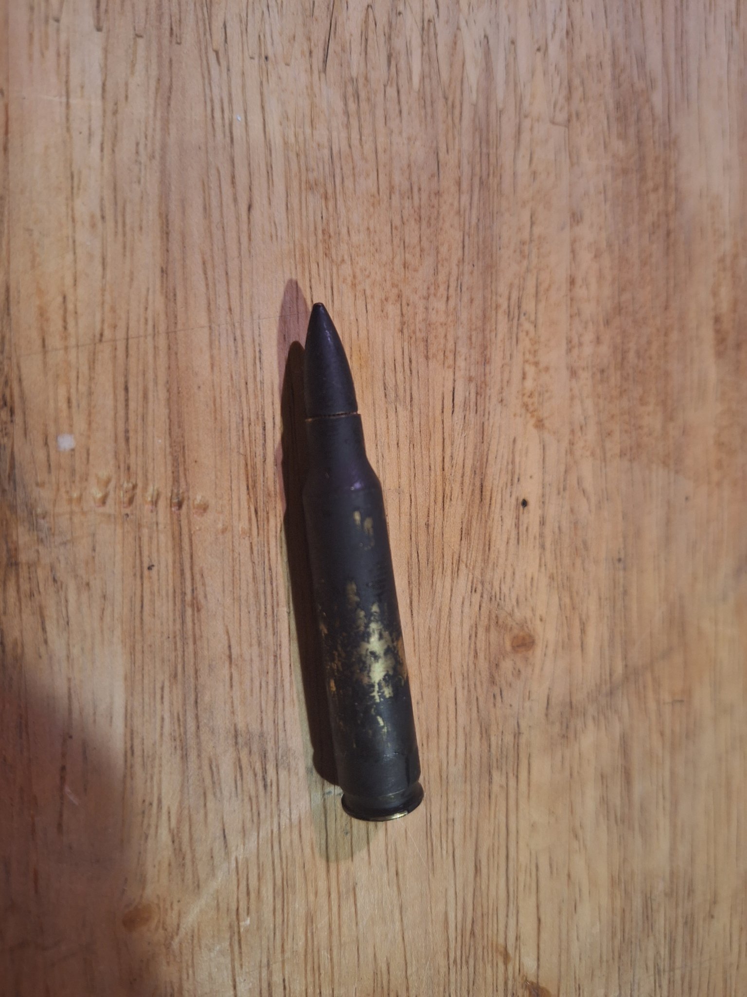

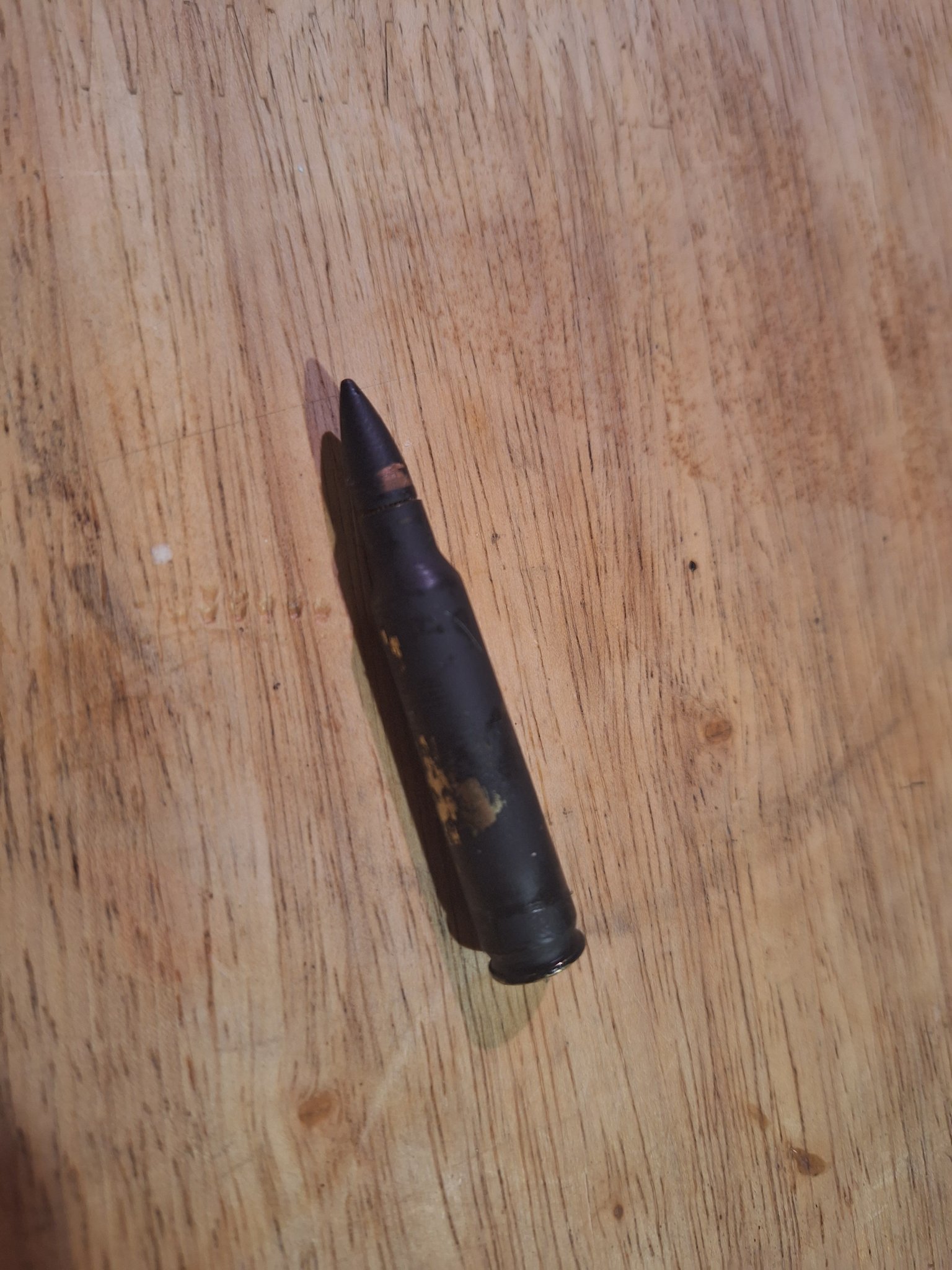

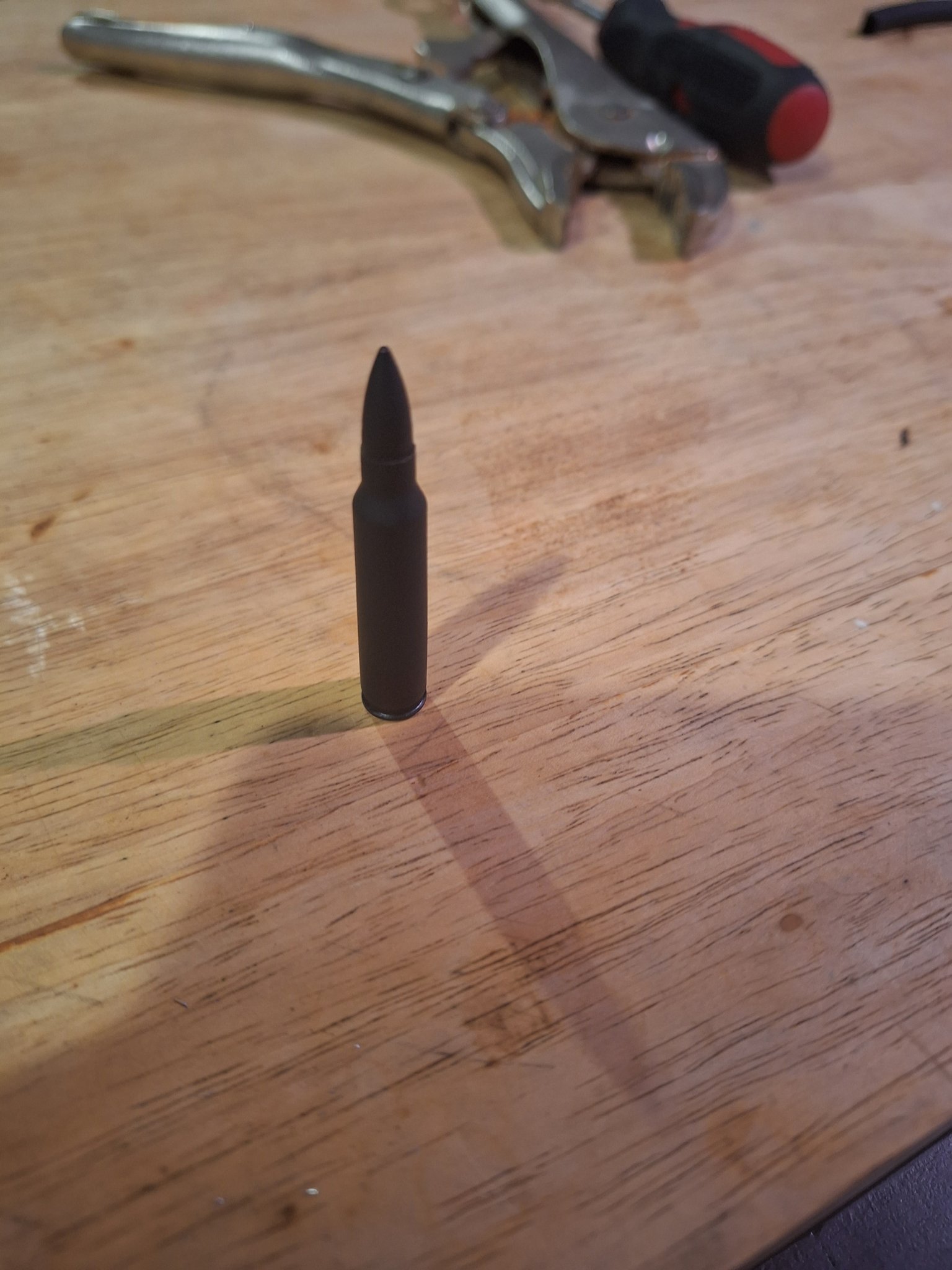

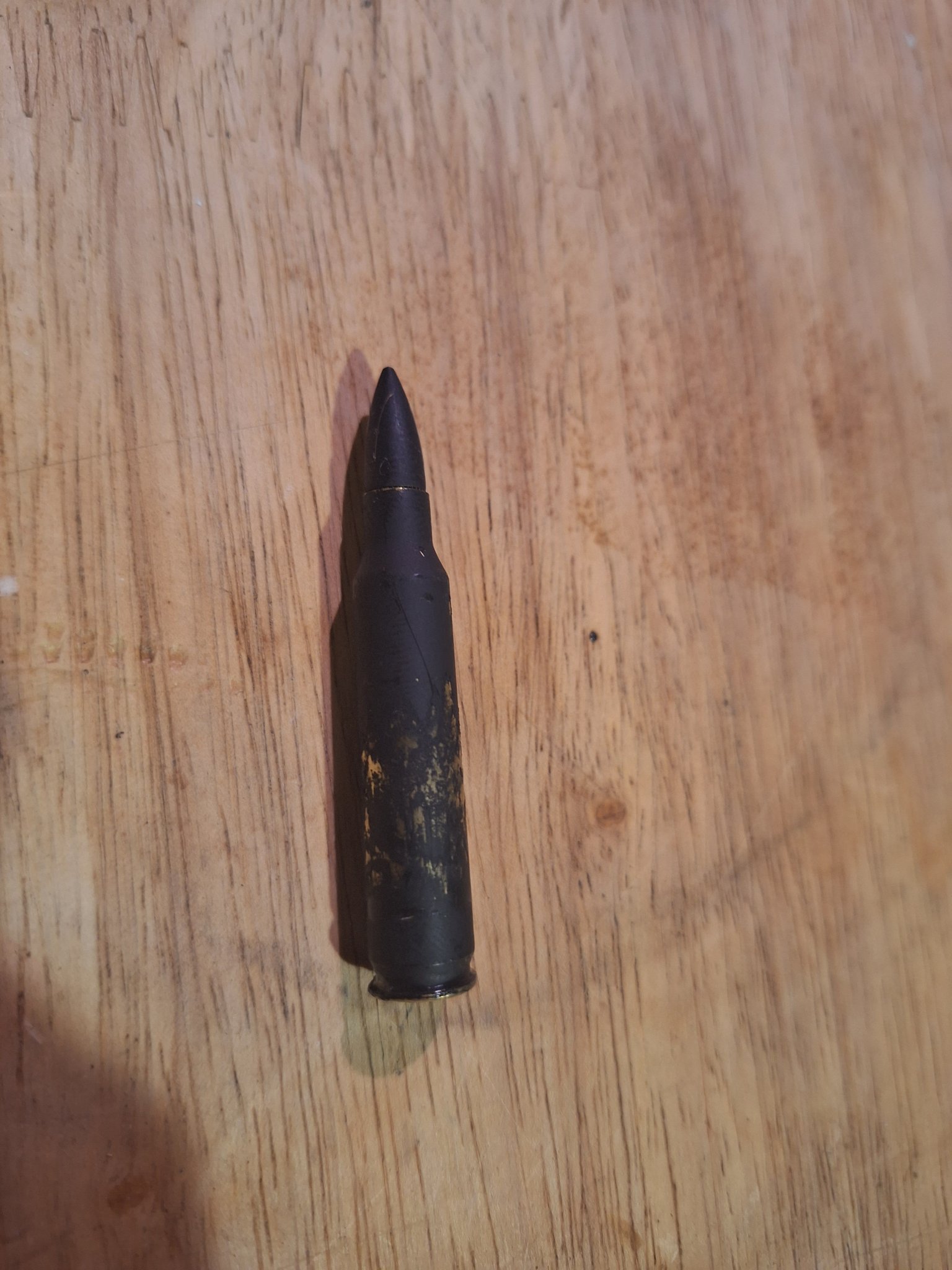

I didn't have a sharpie so I lightly coated the cartridge in spray paint, let it dry, and chambered the round. BCG did not fully seat. Was harder to pull CH back than anytime before. Must be a tight chamber? Paint was rubbed off on brass and bullet.
Pics below. Ammo is SAA 62 gr "new."

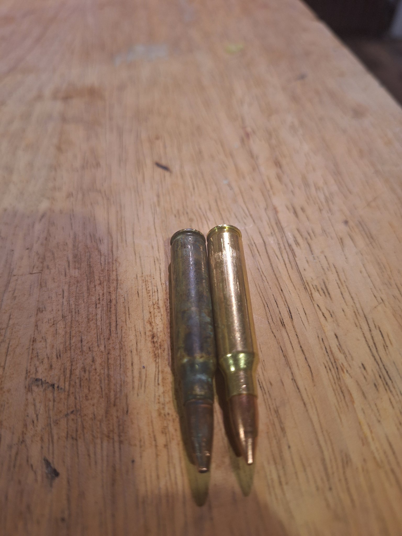

62 gr problematic ammo on right, old oxidized 55 gr on left. Both of these were chambered and the 62gr stuck. It appears that the brass shine is being rubbed off. There is a distinct line at the end of the shiny brass that the crappy dark brass doesnt have.
I would contact the manufacturer and send them the pic and explain the situation. It probably could be cleaned up my hand with a true 556 reamer for the chamber, but I would let them deal with it.

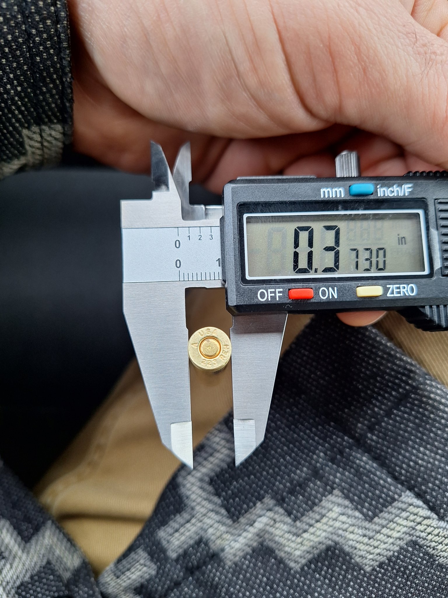

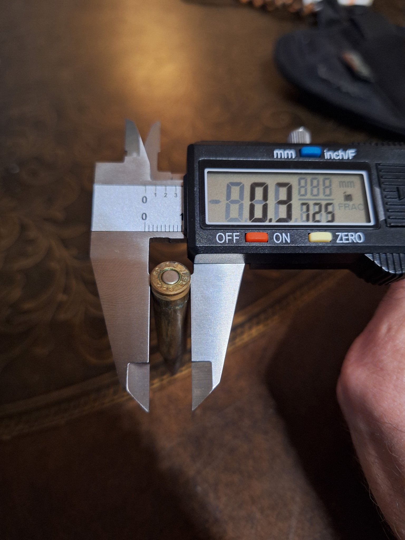

Okay dude, looking at that pic with the oxidized 55gr and the other 62gr, I would continue with the fact that this is the ammo. If you don't have calipers, get some. You can even do the Harbor Freight 6" deals that are like 8.00. Once you get them, measure this portion of your cases (where I circled in the pic). I've seen this issue a few times now, where cases are not sized adequately throughout the entire case. In fact, I just had it with two recent rifles.
Obviously, the cases are laid down, but they appear to be fairly "even" in their positioning. From this vantage point, it appears the shoulder on the 62gr have been bumped adequately. However, the scraping that's occurring as you get closer to the rim, to me, indicates that the case is getting wider the closer to the rim it gets.
If this is the issue, you're options are much simpler: ditch that 62gr ammo and go with something else that is not that.
