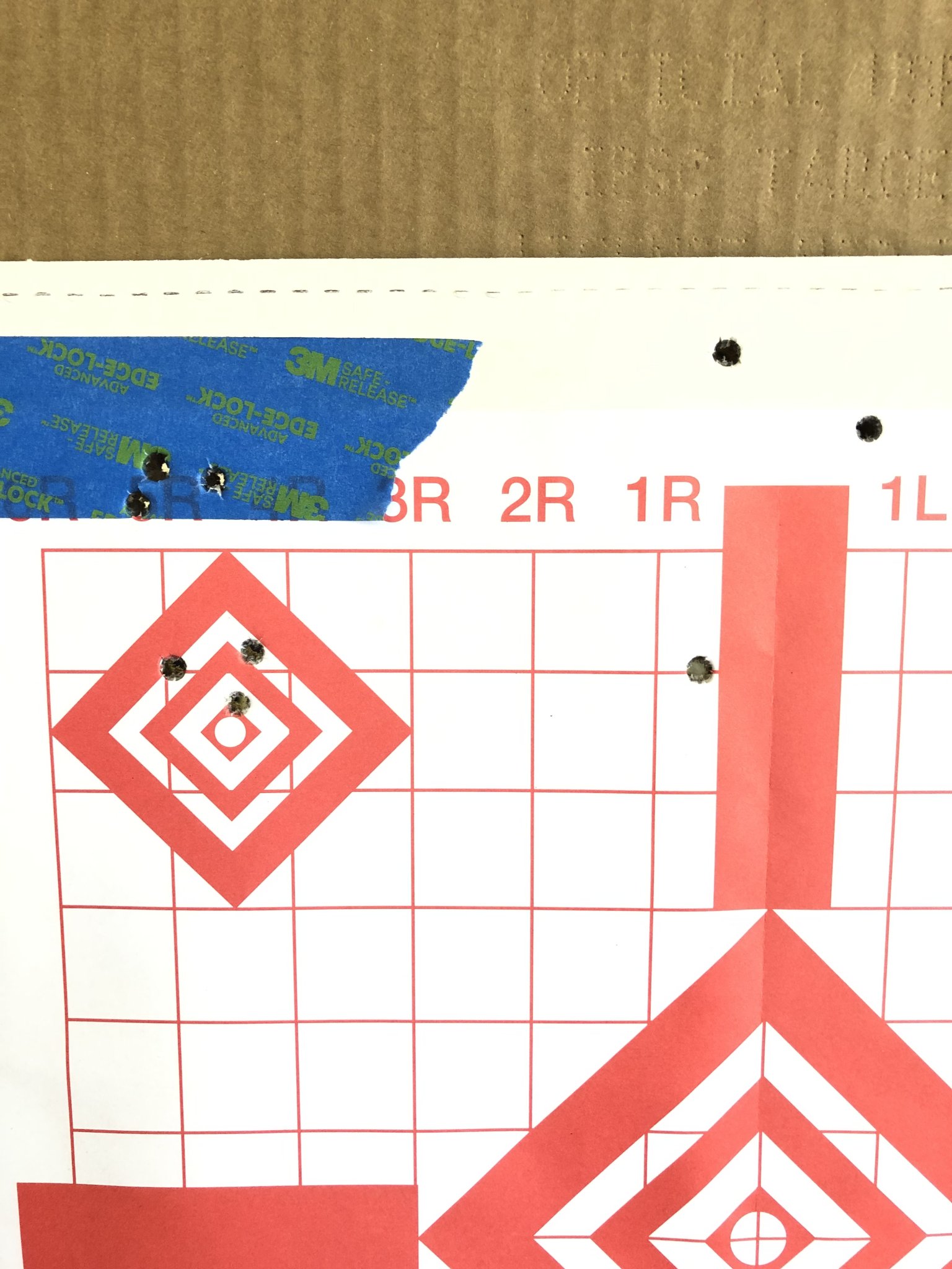

    Heres a pic of my varmint load of H335 and Nosler 50gr. bullets (2 groups) compared to the original Plinking loads. Keep in mind, with the Dillon Powder measure and H335, I can easily keep powder drops to within +/-0.1gr of powder. All seated on a Forster Micrometer Seater. Some combos barrels just don't like. don't start ripping apart your gun and spending money on shit you don't need yet.
    100yds, shot one after the other.
