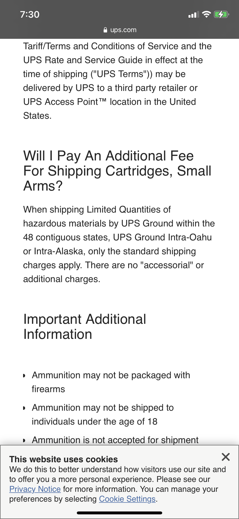

Also note the below...

UPS rules state that a person can ship ammunition, providing it is not incindiary, .50 cal, etc. it must be well packaged. It must have the “Limited Quantity” label attached. No more ORM-D. Sounds fine. I copied and pasted to get a free label. Packed a bunch of .30-30 for some poor dude in Indiana, who was willing to go on guncheater and pay $365 for 6 boxes of 25 year old Remington 175gr Softpoints, 20 6.5 x 55mm surplus rounds, and a dozen empty once-fired brass. I felt sorry for him, so put some Rimfire ammo in the box. Only one problem: when I filled out the form, the rules said that I could not ship via the local access point, which is my neighborhood CVS. I called them, and the manager said bring it in, we don’t care. Fine, except it needed to be insured, which means I have to claim it for what it is, which means CVS man doesn’t know his rules. When asked, I get crickets and a stutter. So, I tell the program to set up a UPS driver to pick it up on my front porch. Nice! I get to set a date and a time range for the pick-up. Everything good, until I get to the Item Description. The rules state that my shipment, via Ground, is ok per UPS regulations. When I plug in the Item Description of Remington .30-30 Rifle Cartridges, the ole algorithm tells me that my product is illegal to ship, even though the regulations say I am good. So, I reverted to my W.Va. talk, and told it that I was shipping boxes of Remington .30-30 Shells. Perfecto! Algorithm, meet hillbilly. Sat the box on my front door table behind my lil birdhouse, and it was picked up on time, and listed as shipped, delivery next Tuesday. After my package arrives, I will contact UPS and ask why their algorithm can’t be corrected to allow me to insert proper descriptions in their software. The law of Unintended Consequences is alive at UPS. Now I know why they want me to drive 40 miles to the Hub. But the Hub ain’t open till 3pm. If this didn’t convince me that we have joined the 3rd World, the D.C. shitstorm sure did.
