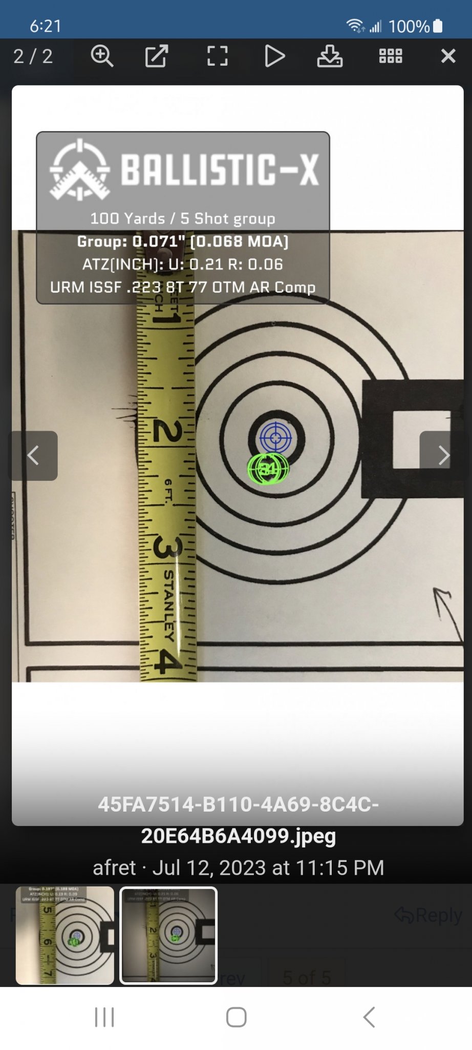

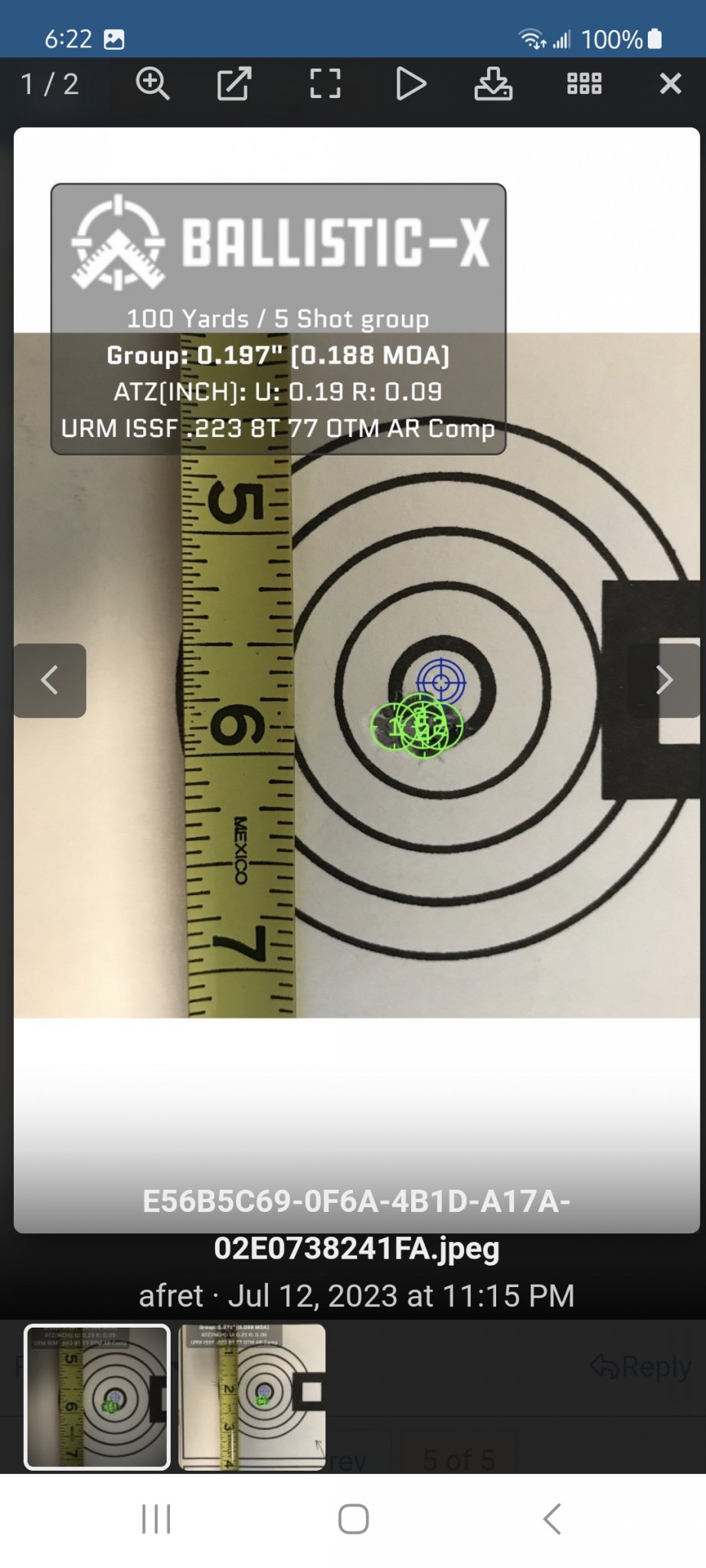

    Yeah, the Urbanrifleman barrels are a bargain. I installed his 8T ISSF chamber .223 barrel on my Zermatt action back in the winter and finally took it out about a month ago to zero the scope and shoot some 5 shot groups at 100 yards off a bench. The barrel shot pretty well with Berger 77 OTMs and AR Comp.
    View attachment 8181683View attachment 8181694View attachment 8181695
    I had to send that one to the owner of Wilson. He said he'll try harder to get them all in one hole haha
