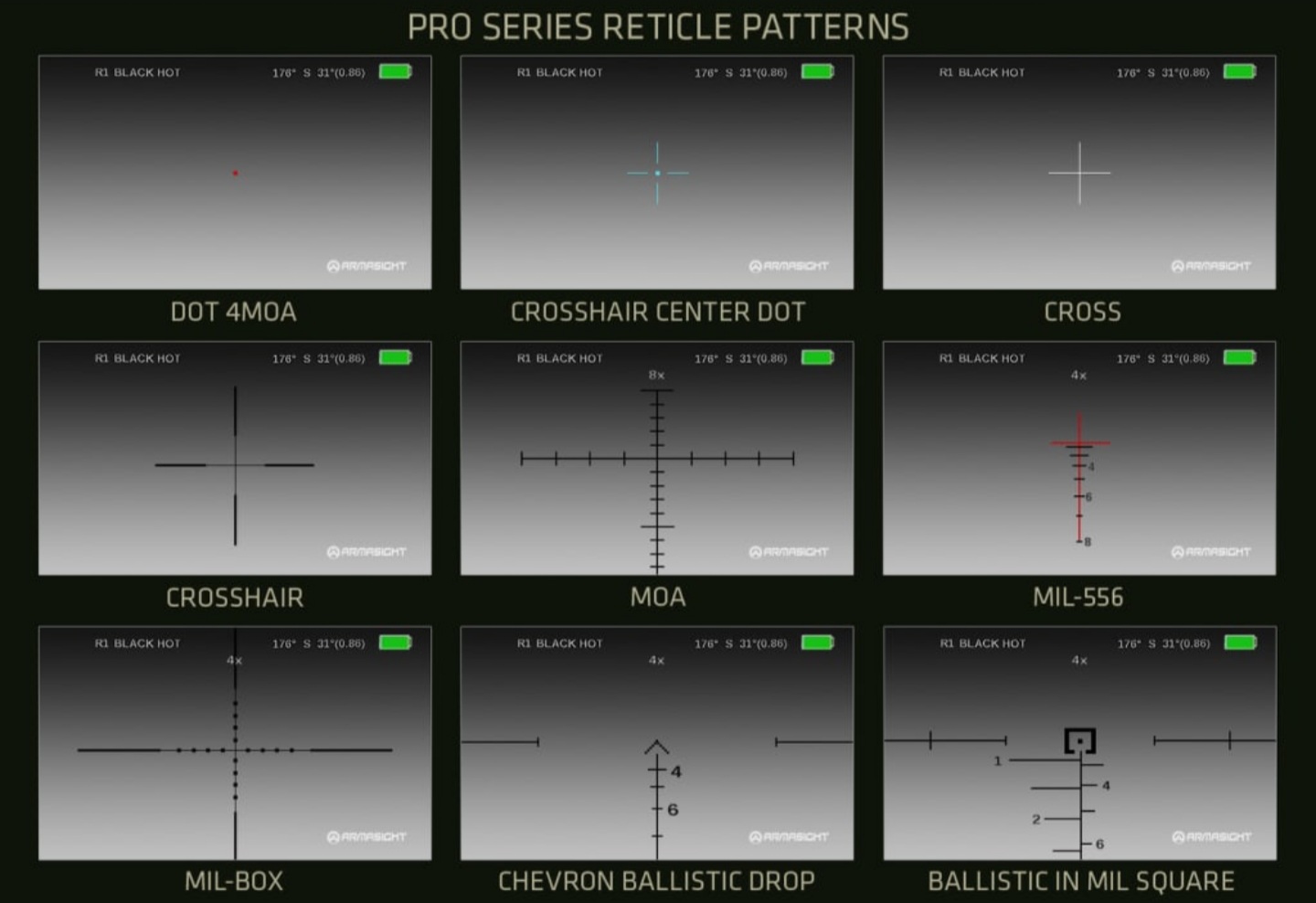

Armasight got right to work trying to help me. Got a RMA in 2 days. Requested a fix of the AR coating and possibly add missing reticles (MIL/MOA). Thermal arrived at repair dept December 13th. I just got it back today January 9th. Took about 17 working days. 23 or so days total. Not bad.
They reused my bubble wrapping around the case and scope. Exactly how I sent it. All my worries dissolving the more I observe. Great care they took of trivial matters. I hear guys get scopes back from UPS worse than before and often blame the manufacturer. Armasight knows this keeps it calibrated and aligned. Often overlooked and extremely serious.
They replaced the 100mm objective lens, updated the firmware to version ZHSC1604230748 and software version to 1080.
I see the lens is rebuilt with new parts. My RMA said they replaced internal components and external parts but didn't say what. And I cant confirm this, but I swear my display looks better than 640 now. It looks widescreen HD. Its better than it was for sure. The display is bigger and clearer. The grainy lines are gone. They used lens tightening rings that I notice are different. They have calibration notches in the rings that I've read elsewhere you should take a photo of to reference if ever it comes loose or out of alignment in a pinch. Before it was a solid sealed ring. They upgraded the HELL out of this thing and im trying to find out what they did.
Im ecstatic! It's like Christmas again! Violent Night!
In addition it was electronically aligned, re-calibrated, tested, cleaned and default operation re-verified by GG in RMA dept.
Best of all I got MIL and MOA reticles! Hell yea! Now I have reference to point of impact. Dude do you know how much new life just got breathed into this Zeus Pro?
