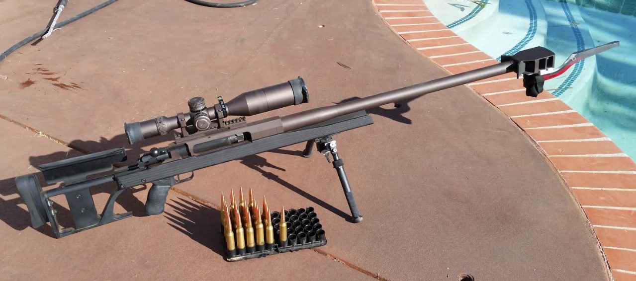

Awesome! It would be cool to see pics and get more details. I've wondered if the Armalite AR50A1 was a viable starting point for a wildcatted ELR rifle and would be interested to hear about any accurizing work done on the action, etc.
here she is...
and here is what I did to her...
Blueprinted action (just like a rem 700)
Pinned the recoil lug
Tig welded up the bolt, made it a 2 peace with a floating face/ locking lugs
Modified the cocking ramps, took about .100 out of the takeup
K&P SS match barrel 32" 1:10, polished chamber, 11 degree crown
Salt nitrite treated the bore
Blueprinted break (it was .060 out of round from Armalite) and took about 2 lbs off it
New Barrett "Match" chamber, cut and threaded on CNC Lathe (by "Improved" I ran it short by about .05 to tighten up the body and decrease the capacity, technically that would be de-improved???).
Timney trigger set at 12-14 OZ
Titanium firing pin guide rod (the stock one was a heavy bitch, lock time feels faster)
Vortex Bronze Cerakote,

I like the idea of the TI firing pin guide rod, when I find time I'll have to turn one out. Making the bolt a 2 piece is a great idea too, too many parts flopping around otherwise. You are not the only one seeing the off-center bore of the Armalite brake, I run a K&P brake on mine, that solved that problem. If the Armalite wasn't so heavy I'd be chambering it for the 416 reamer I designed, since KO2M is going to 45, then 40lbs I'll using my light weight shell holder action. I'll keep the Armalite I built in 50 form.

The safety mechanism also seems heavy and way over done, I was thinking about gutting it or making out of TI. Welding up the bolt made a huge difference with extraction, totally agree too many parts flopping around. The action was very strait and true, you would not have thought that based on the rough finish, but it was on the money. The rest of it... needed a little love.
Did not get in KO2M this year, hopefully next year! I believe you can get it down to 40 lbs, take a little off the end of the chassis, make a new butt-pad adapter to the chassis and go to a more traditional brake. But at that point... not much Armalite left.
I would like to hear more about your custom .416 reamer, I'm working on another build now and need to get back in the machine shop to test a few ideas to increase the case pressure before I commit.
