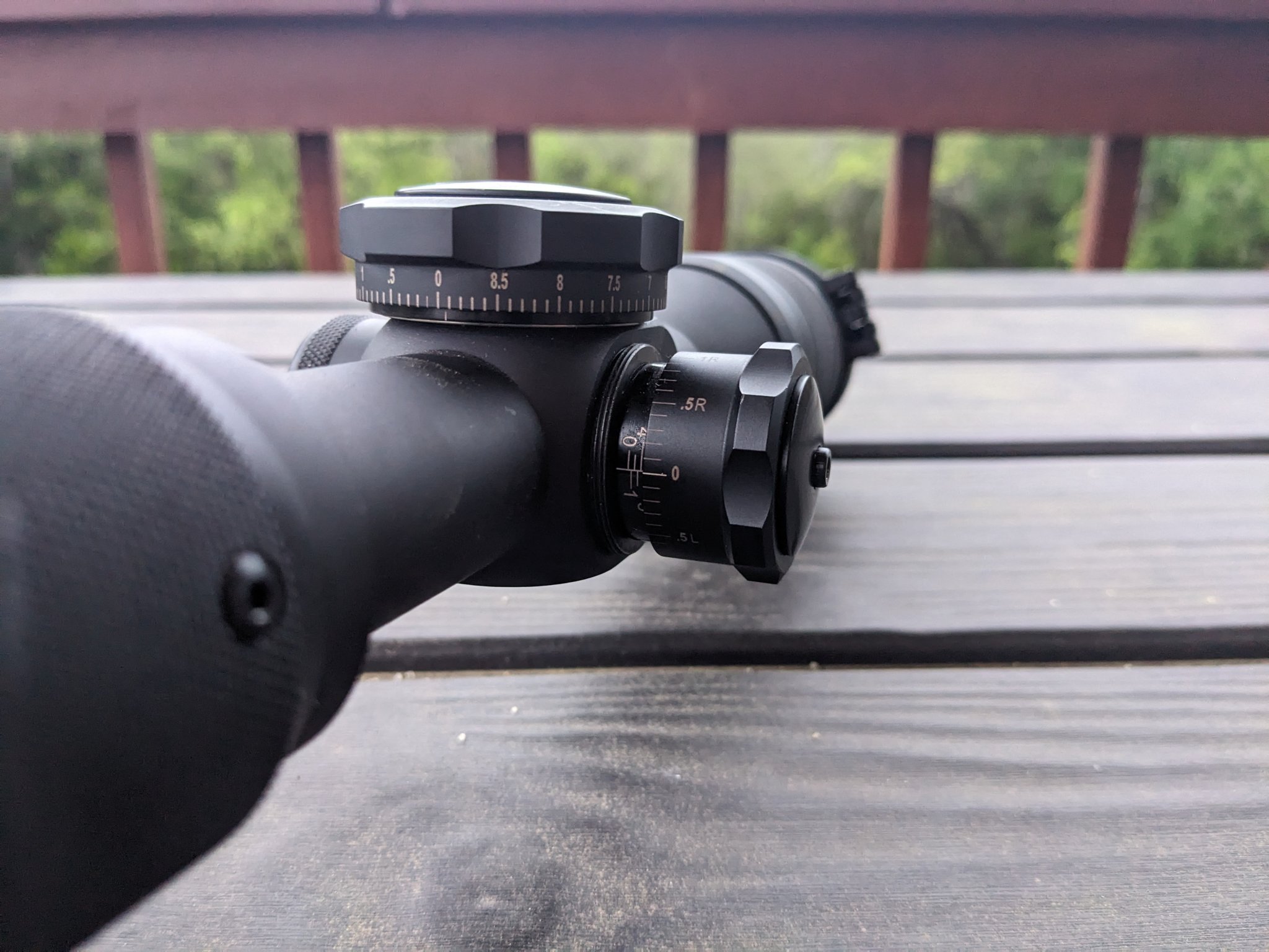

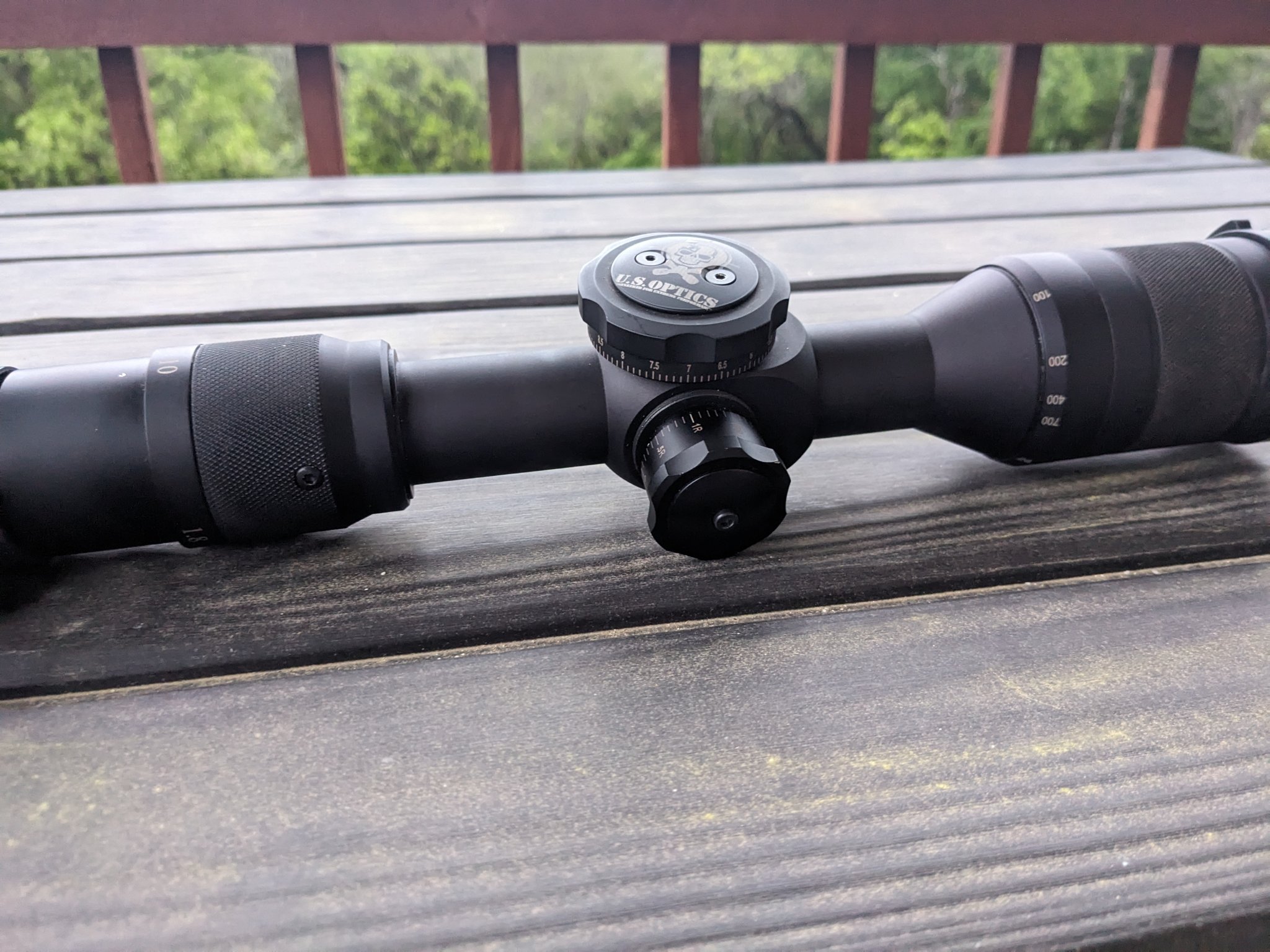

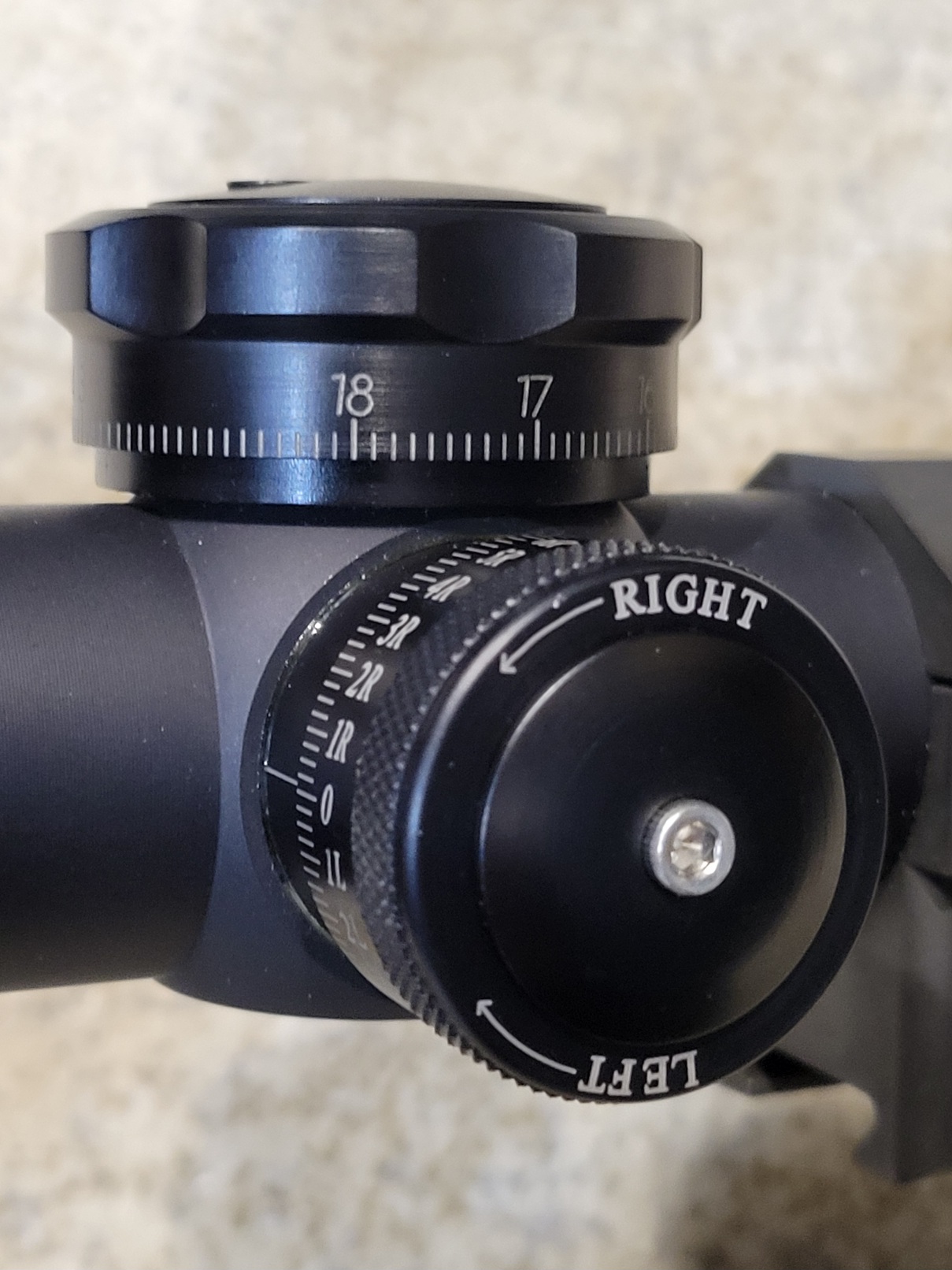

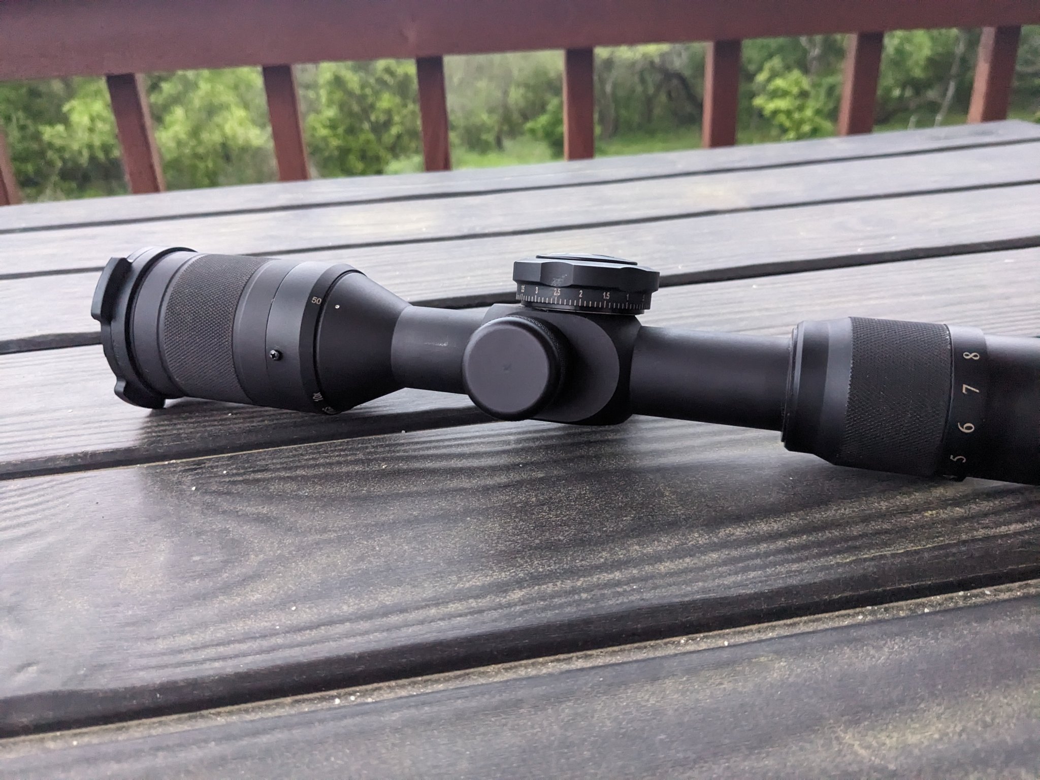

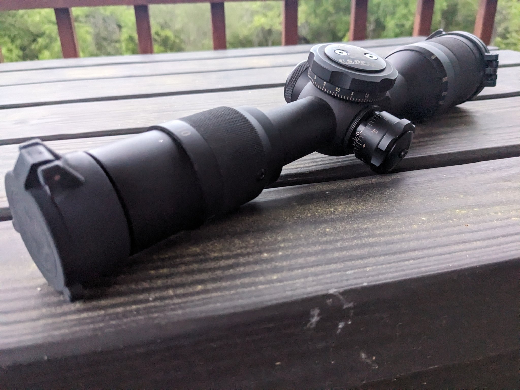

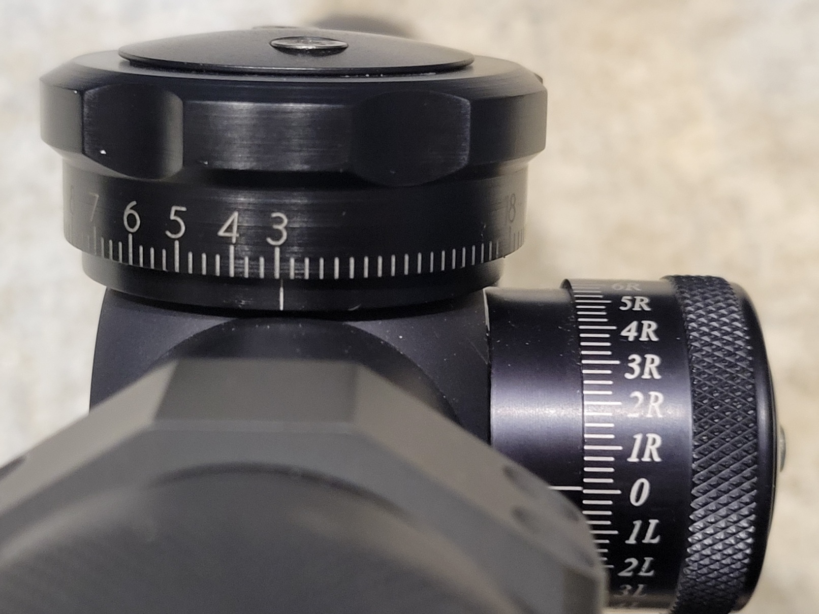

I built that scope with the very first dual detent elevation knob, which we patented. The dual detent, or Multiple Tactile Click (MTC), knobs were later seen on Schmidt Bender and Premier Reticles scopes used on the M40’s and other sniper weapons.
At that point, an EREK knob had never been put on a 1.8-10X. In order to get the click value to be .5MOA, I had to shorten the ocular end of the tube about .1” to get the erector fulcrum to knob spacing correct. You can see where I cut the forward edge of the magnification ring for fitment as evidenced by the raw aluminum. The elevation knob was simply marked with .5MOA tick marks and yardages out to 1000 yards. The BDC was the same as the Unertl values.
The Windage knob was also a first for USO. The clicks were .5MOA and the knob had a stop to limit travel in either direction. If I remember correctly, it went 10MOA in both directions. It was basically a Unertl windage knob made of modern materials, etc.
When the RFP finally came out, the Corps wanted more than 10X magnification, but not more than 15X. So, we adapted the elevation knob to the 3.2-17X44, laser engraved the scopes as 3.5-15X44 and sent them. It was kinda funny because the 3.2-17X was closer to 19X in reality….

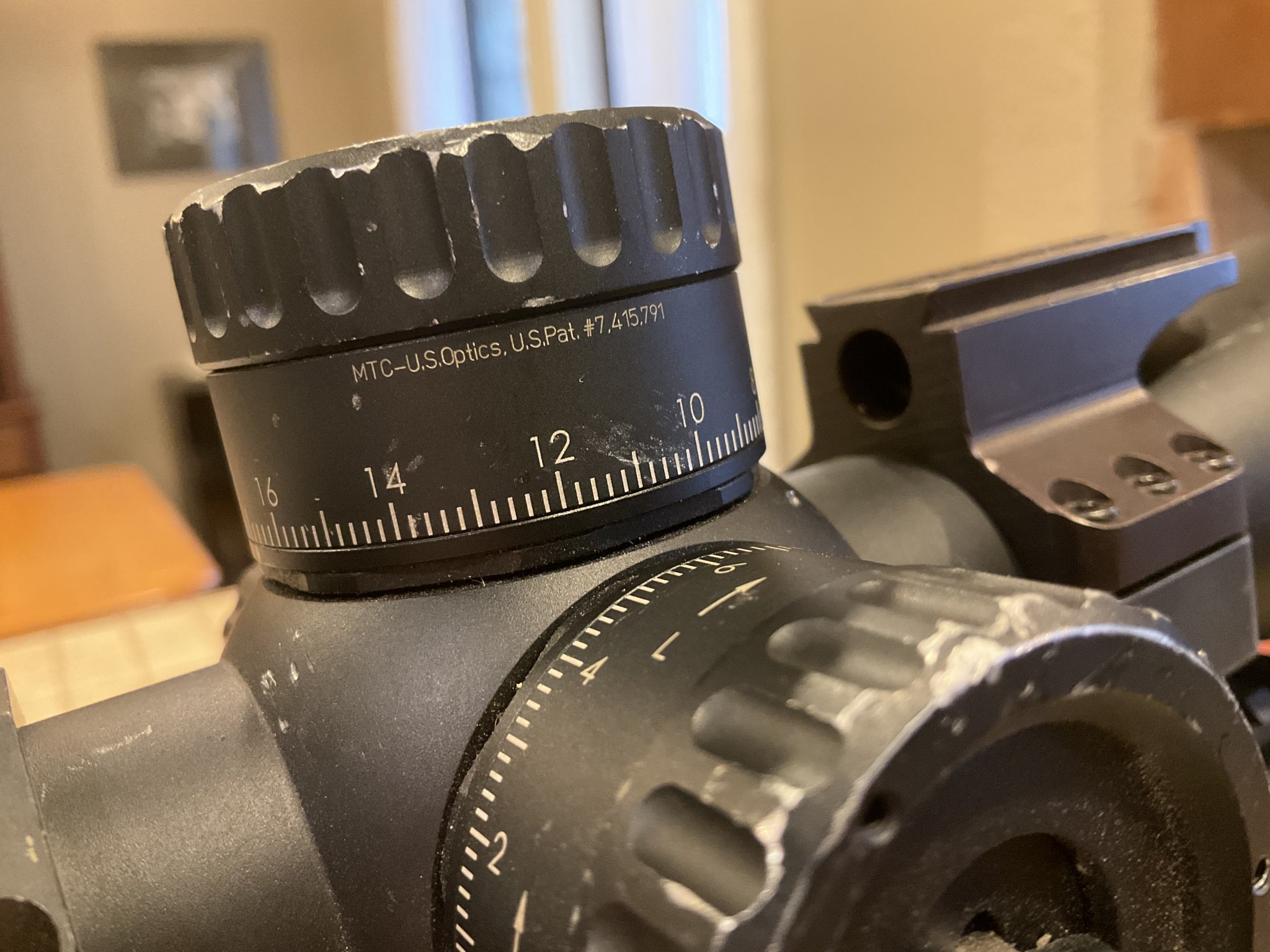

Jezuz....15yrs I've owned this thing and never noticed the US Optics patent.🤦

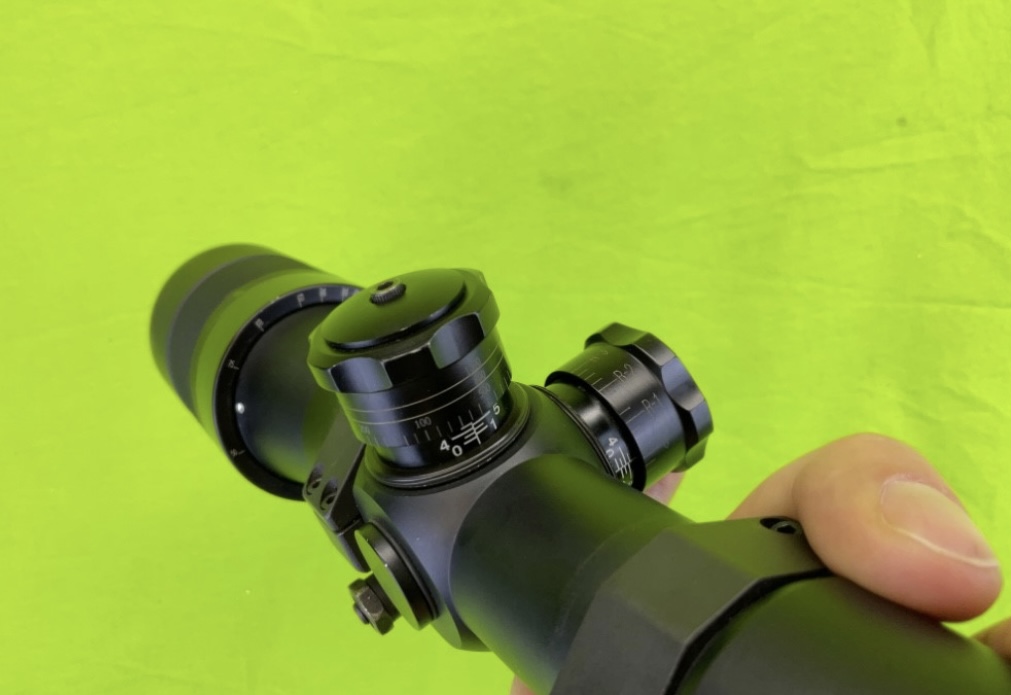

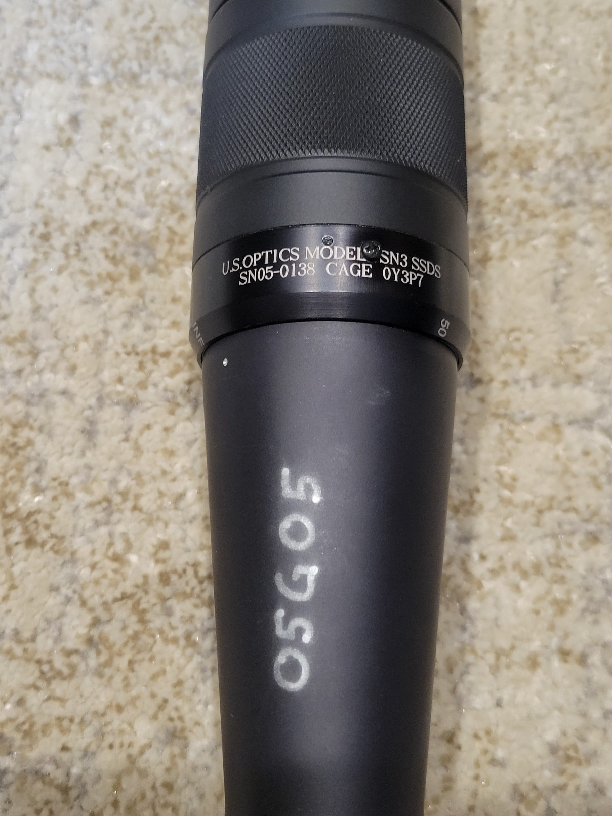

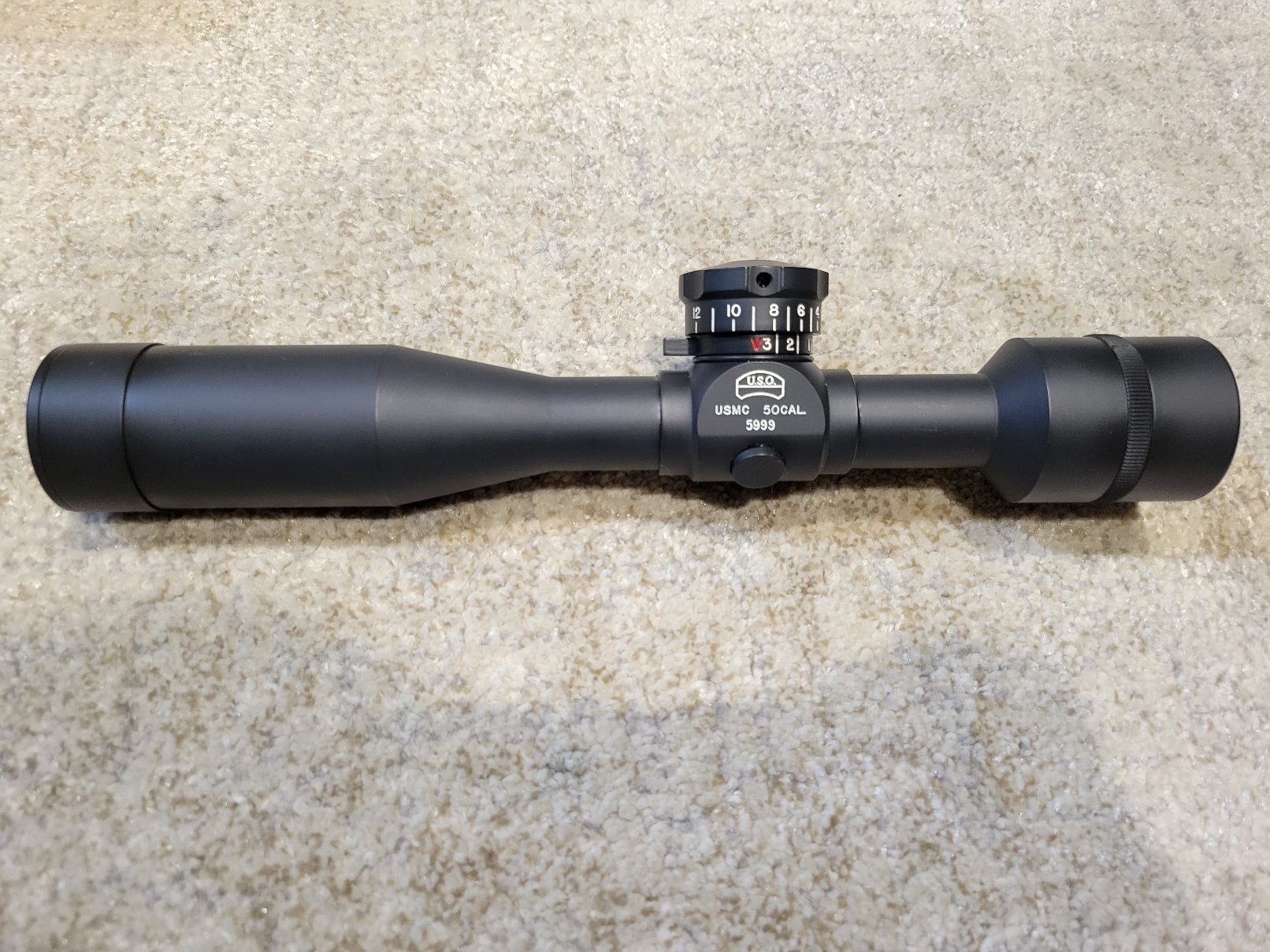

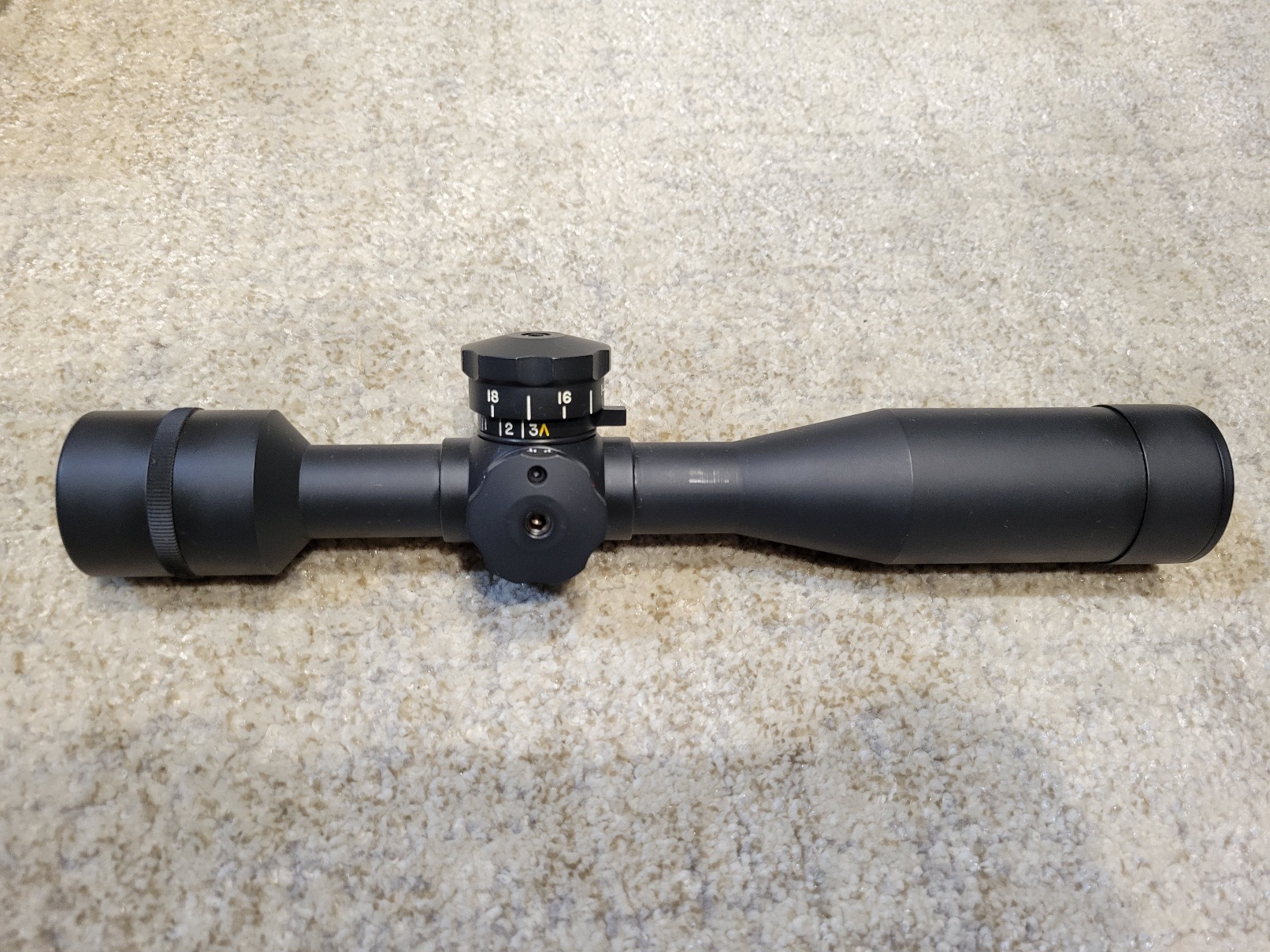

USO made three 7.62x51mm scopes (M40A3) and three .50BMG scopes (M107) in 2005. These 6 prototype scopes were tested by the USMC and were in competition for the SSDS contract that Premier Reticle won. Premier Reticle submitted their gen 2 duplex mil-dot reticle equipped S&B 3-12x scopes, and they got the USMC contract, not S&B. All of the USMC S&B M8541 scopes were shipped in pieces (down to the individual screws) to Premier Reticle, who then built each scope for the Corps. I'm only aware of 1 USO 7.62x51mm scope that still exists, and 2 USO .50BMG scopes that still exist from this contract submission. So, half of the 6 test scopes are either lost/broken, or in collections somewhere.
I actually have 1 of the 3 USO .50BMG test scopes that was made in 2005 and was in the running to be the Corps new SSDS. The scope is 3.5-15x, it has a BDC elevation knob for the Mk211 ammo (300 yard zero to 1,800 yards, 55MOA of total travel), and it has 10MOA each direction for the windage. I also have the original (not a copy) of the USO paperwork for this scope, notice the customer name in the lower right-hand corner. The provenance doesn't get better than this!

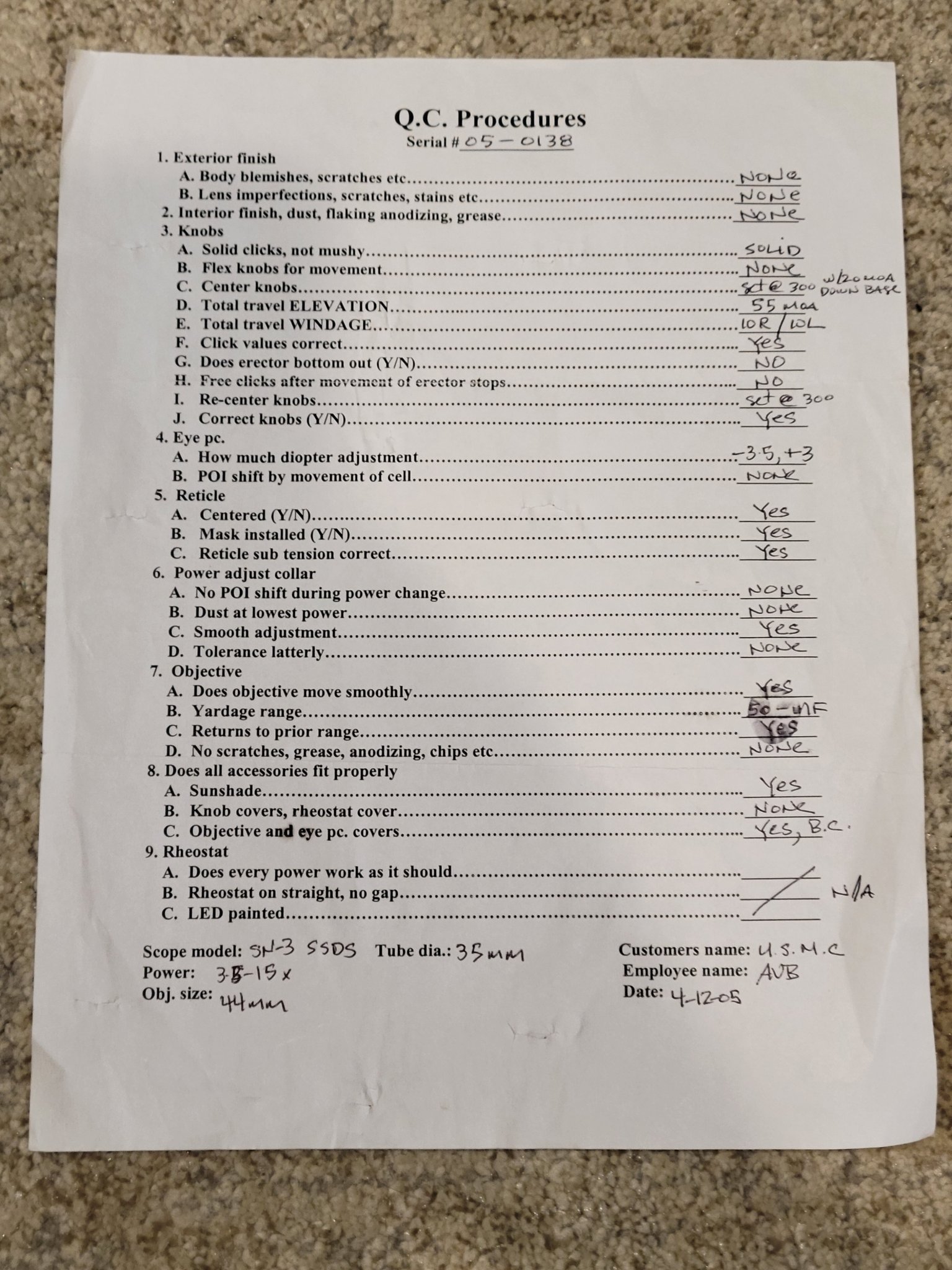

Here's another extraordinary piece of USMC/USO history that has never been shown publicly before (I acquired this scope a few years ago, and the previous owner purchased it directly from the CEO/President of USO John Williams). This is 1 of 3 prototype USO MST-150 scopes that were made to show the Corps that USO could build new MST-150 scopes from scratch. These 3 scopes didn't just show off USO's technical prowess and optical capabilities, the scopes went through a rigorous physical test and evaluation (T&E). Even though the prototype USO MST-150's went through this intense testing, they passed the Corps' high standards. However, even after passing the T&E, the Marines decided that they would save lot of money by just having USO refurbish and convert their 7.62x51mm MST-100's to .50BMG MST-150's. Since the Marines went with the refurbished and converted option, no more USO MST-150's were ever made! This is the highest serial number MST-150 ever made, serial number 5999, and the very last MST-150 ever made!
This scope and document is important in documenting what the Corps differ with their .50BMG scopes for their Barrett rifles. There's a lot of speculation as to what .50BMG Unertl scopes were first issued on the Barrett M82A1's, but the history is now known. The USMC Gulf War M82A1 rifles used Unertl MST-100's that were taken off M40A1's (or possibly provided as new scopes by Unertl). That's right, the Gulf War issued scopes that were used on the .50BMG M82A1 rifles were in fact 7.62x51 BDC MST-100 scopes!
This is a fact that has been established: by talking to the Marines who were issued these rifles, and talking to Marines (after the Gulf War) about how they worked with the Scout Sniper school houses to determine the Mk211 .50BMG dope that could be used as a BDC for the Unertl MST-150 scopes that would be made years later in the mid-1990's. When the Corps needed more of these scopes, USO had already taken over the contract for the MST-100/MST-150, and made the 3 prototype MST-150's to show the Corps their capabilities. Instead of spending money on new scopes, the Corps had USO refurbish and modify some of their MST-100 7.62x51mm scopes and turn them into MST-150 .50BMG scopes.
So, the Barrett M82A1 .50BMG rifles were first issued with the 7.62x51 MST-100's, then with .50BMG MST-150's, then finally with 7.62x51 MST-100's that were converted by USO to .50BMG MST-150's. Many people assume (wrongly) that the Gulf War M82A1's were issued with .50BMG MST-150's (either new .50BMG from Unertl or converted 7.62x51 scopes), but we now know that the Marines used 7.62x51 MST-100's during that war.
This is a pretty unique piece of USMC history, and who knows where the other 2 of the 3 scopes are right now. Maybe in collections somewhere? Maybe the Corps kept them? Maybe the CMP sold them? I have no idea.

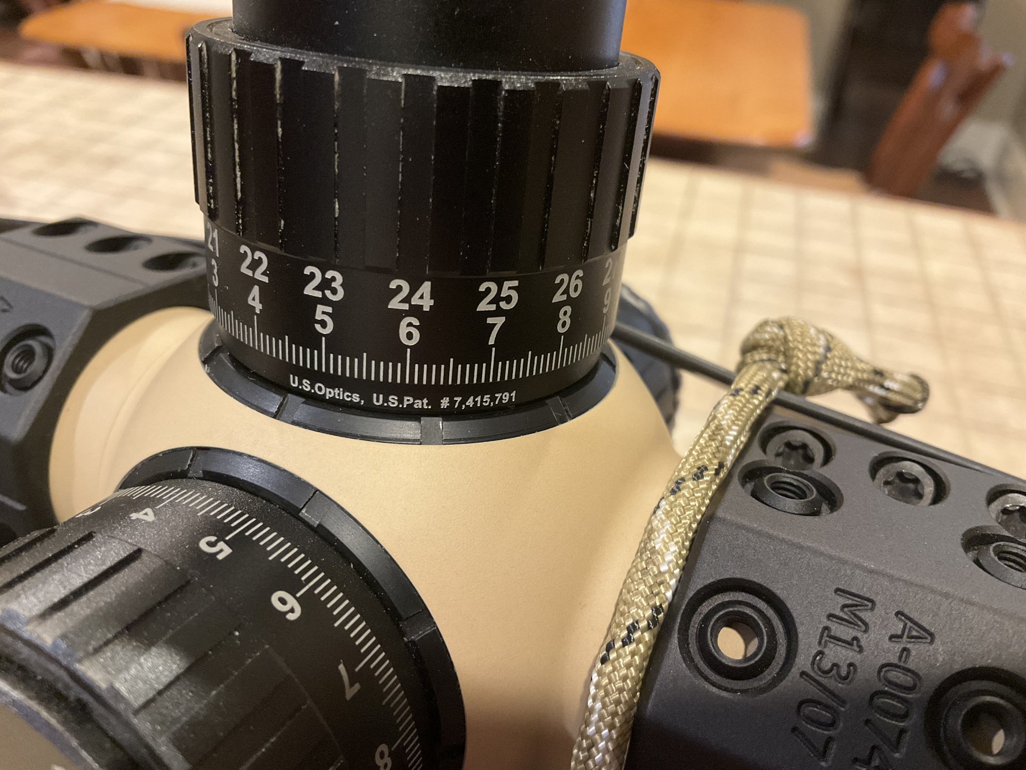

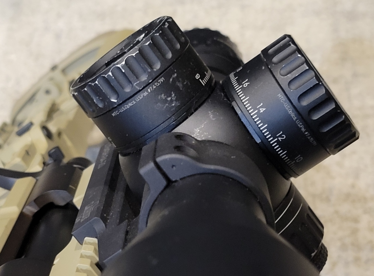

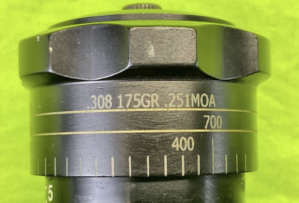

And for the previous discussion about the USO patent information being engraved on turrets, here is my original& DRMO USMC M8541 SSDS on my M40A6:
The information in this post should be correct, but I'll defer to @Skunk for the final word on anything USO related. He's easily the expert in this area!

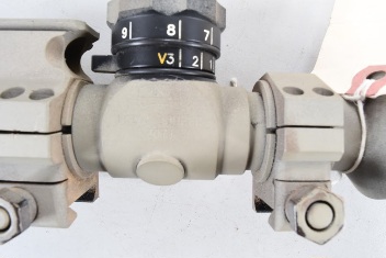

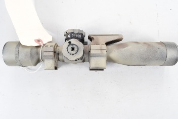

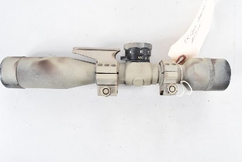

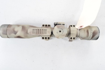

This USO MST-100 that was sold on the CMP auction site back in 2018 fits the theme of this thread:
https://cmpauction.thecmp.org/detail.asp?id=4526&n=USMC-US-Optics-MST-100-Sniper-Telescope-3077
This scope is serial number 3077, which doesn't fit into the USMC 7.62x51mm 1xxx serial number range, the FBI/Navy 2xxx serial number range, and the USMC .50BMG 5xxx serial number range.
Here's photos of the military USO MST-100 serial number 3077, but the scope's serial number really can't be seen due to the thin layer of rattle-can tan paint obscuring it:

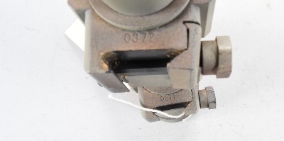

The CMP sold two of the USO 3xxx series scopes. The other was 3123.
Those two scopes, plus USO 3449 that has been posted here before, are the only three with USMC ownership that I have seen.
I had understood that when USO received a scope from the USMC that could not be repaired, they were authorized to replace it with a USO scope.

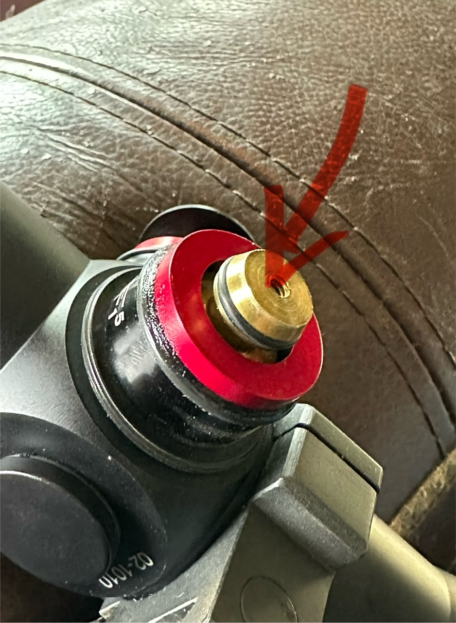

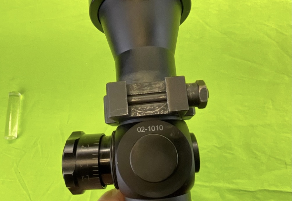

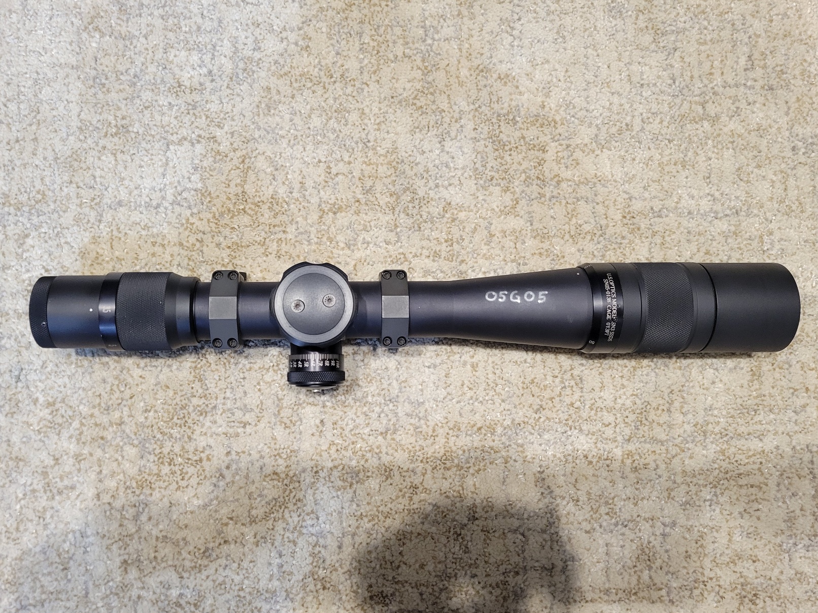

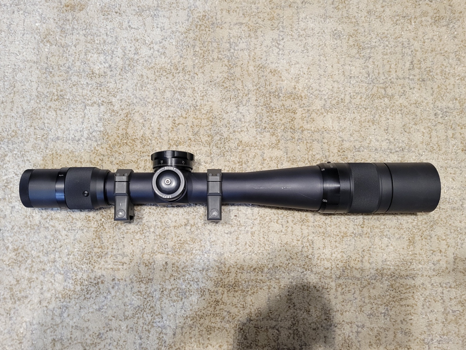

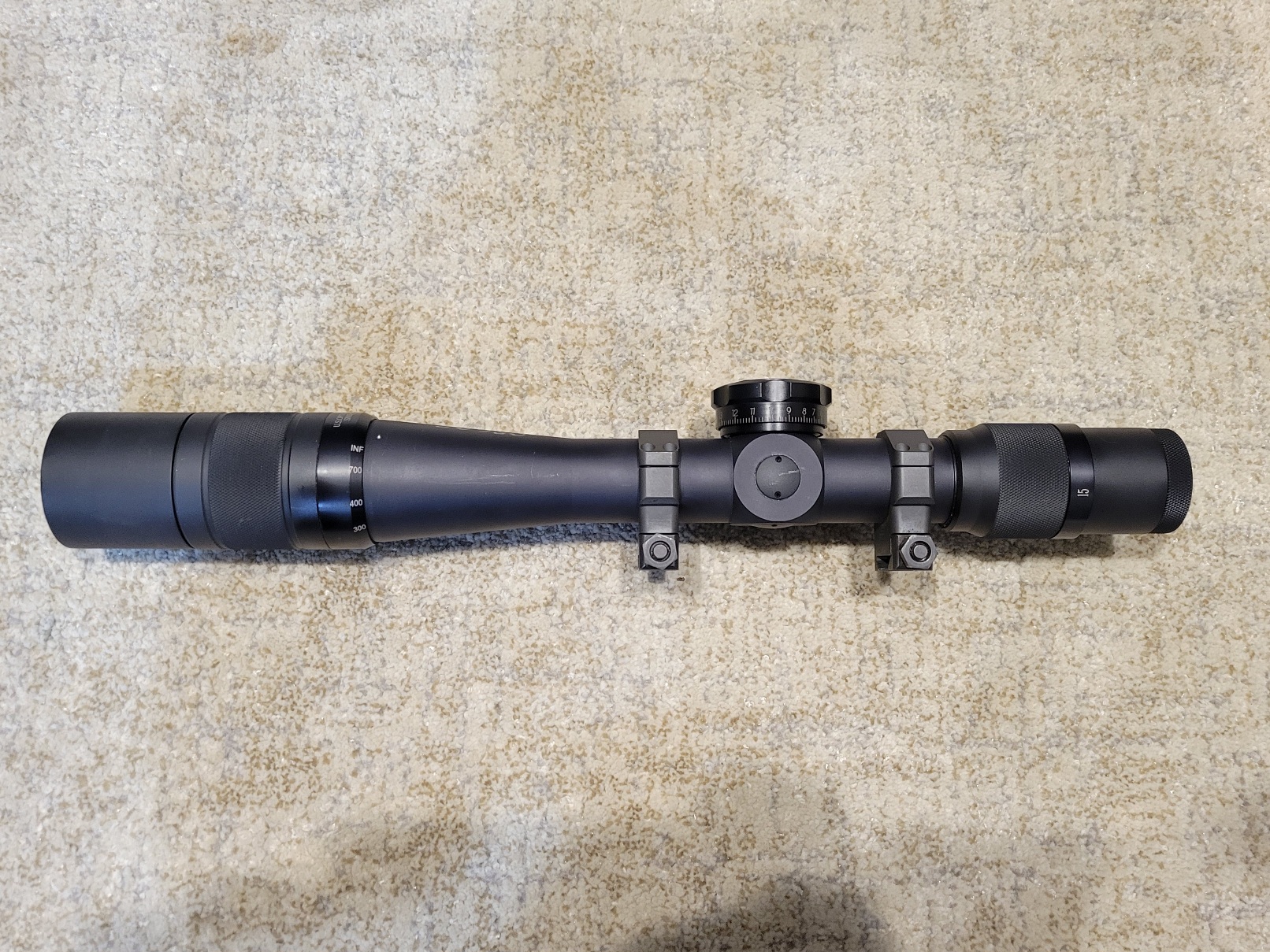

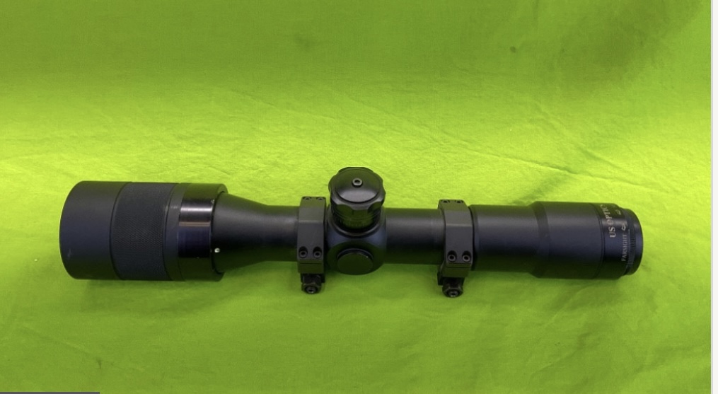

I snagged it with a minimum bid. Buy it now was def. overpriced, but noone else bid and I got it for a decent price.
It's definitely a neat early one. There's some issue with the turret knobs. They are either bent or have warped. So have a 'wobble' on them. I'll get a vernier on it. Glass is great. Nice set of Badger-type rings, but not Badger, I don't think. The reticle is a dot (might be a football-dot. The 'dots' sure look elongated with careful scrutiny. I thought that was a USMC thing. ) Reticle also has ranging stadia. And fitted with a nice compensating knob for 175gr. M118, I assume. Someone knew what they wanted when they ordered this!
I'll write USO and see what they have on it. They are always great about looking up the old files!
Thanks for the lead. I have a really nice LWRC .308 match AR-10 that this is going on. Be perfect for it!
Cheers, Sirhr
Cheers, Sirhr

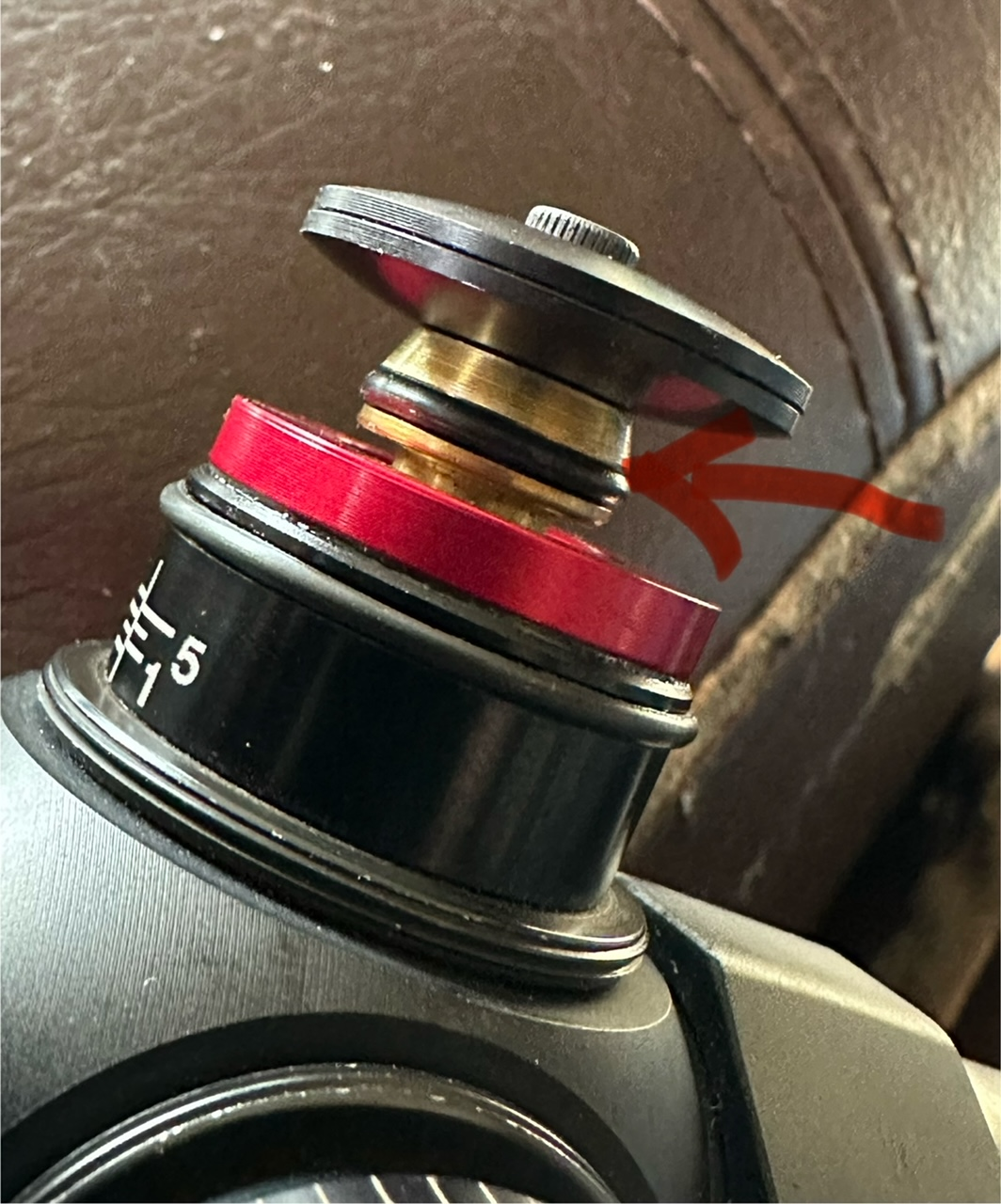

Do both knobs wobble when you turn them?
If/when you remove the adjustment/float screw in each knob, the knob cover (marked portion with script) will come off the brass knob armature. Those are pretty stout and I would be exceedingly surprised if one or both of them are bent.
The knob covers are probably just on there a little cockeyed and not seated properly on the tapered portion of the brass armature.
Cheers, Sirhr
Congrats, that's a cool scope! The 02 portion of the serial number is the year it was produced, so a nice old one! Don't you have a USO SN-9 too? I'd love to find one of those scopes with the highest magnification and the 80mm objective lens, or whatever it was. USO used to make some really awesome stuff, I just wish I had bought some of their scopes long ago.
Yes, both have a wobble. I jus t didn’t get time yesterday to pull the screws and see if there is a seating problem or if the knobs are bents/warped. Almost certainly the axle/shaft that they bolt to is straight. It feels perfect.
I’ll explore tonite and post findings! I suspect you are right that it’s a seating issue.
More to follow!
Cheers!
Sirhr
Ps package inbound!
Well, good news and bad news....
The knobs aren't warped. That's the good news. They are totally true. great shape. Measure out to tenths.
The bad news is that the brass erector posts are both bent. They have a wobble in them. Must be that someone used this scope to replicate the "We parked a HMMWV on it" test. Because both of the brass posts (arrows) wobble.
I also tested them by putting the knobs on 'loosely' so they would turn on the tapers. They were true. And removed the O-rings to see if they were causing hang-ups. Nope. Rings turned smoothly until tightened on the brass erector posts.
This was my final test. Needed to create a 'knob' with no skirt. So screwed the top washers on the brass piece. When I rotated, they wobbled like plates on a stick during a juggling act. Bummer!
But I e-mailed the mother ship and I'll send it in and have it fixed up. Probably get a couple of knob covers and a shade while I'm at it. And Clean/lube. It's a super cool scope so worth restoring right and I don't do optics!

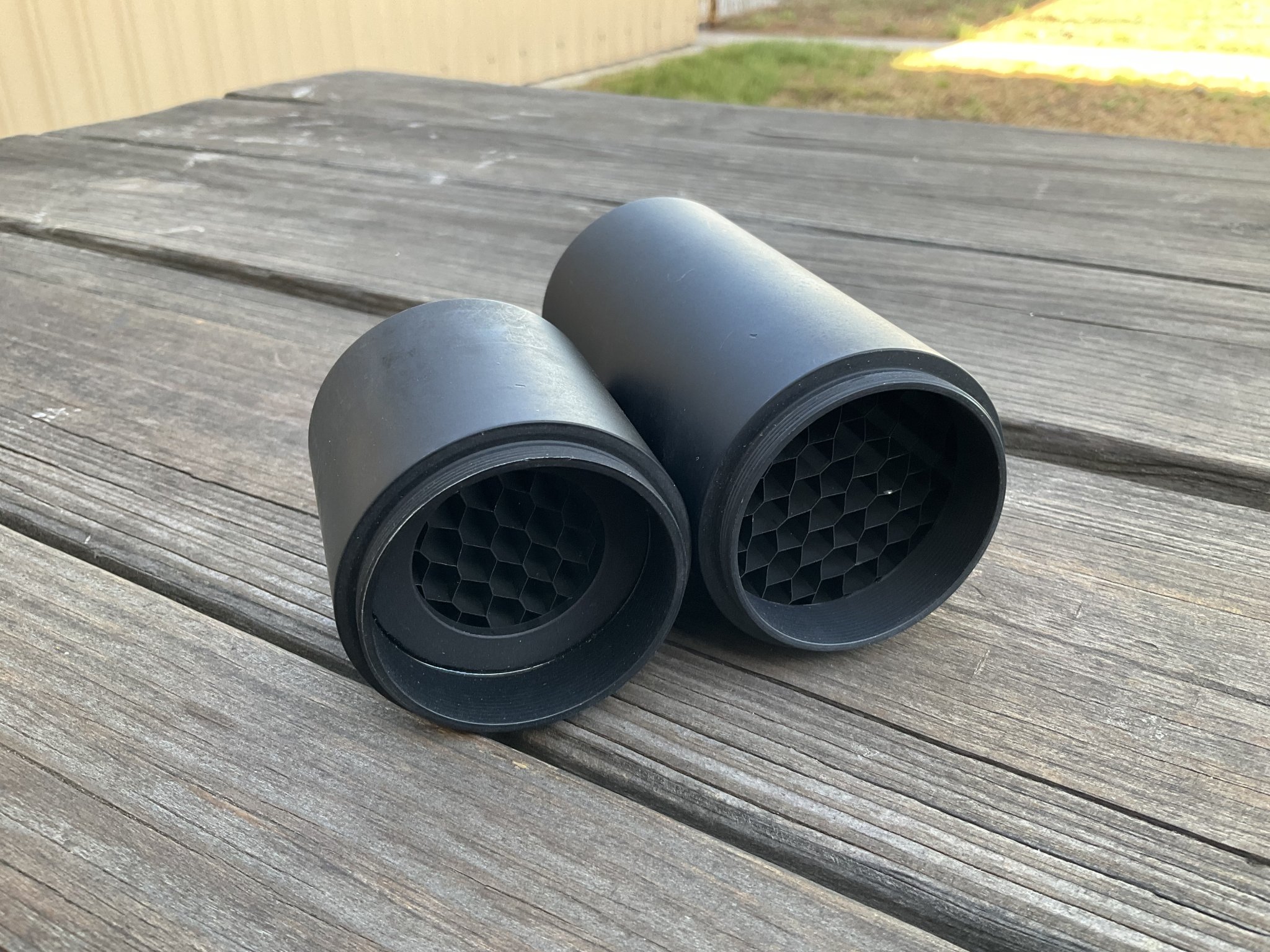

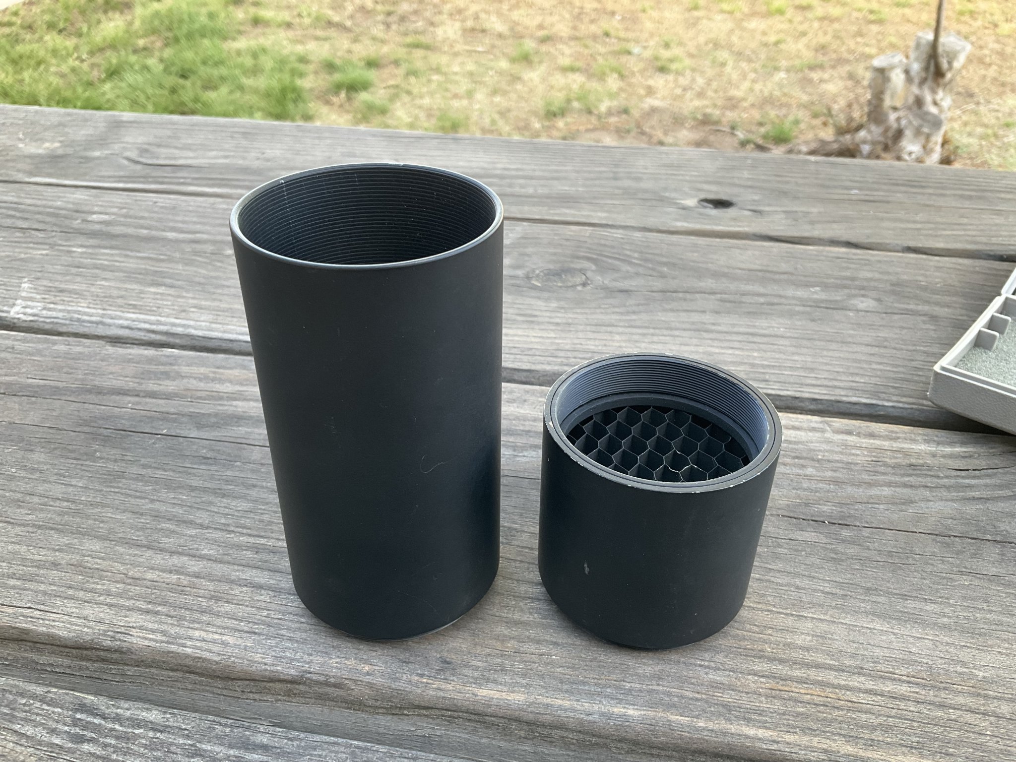

Think these will do? I don’t exactly remember if these are for a 44mm ERGO objective (like what you have) or a T-Pal, but I want to say the thread pitch/shades were the same. They show some use, but if you want them they’re yours.
I have enough USO's that I know I have stuff they'll fit!!! Probably including ST10 Awesome!
Cheers!
Reactions: Skunk
