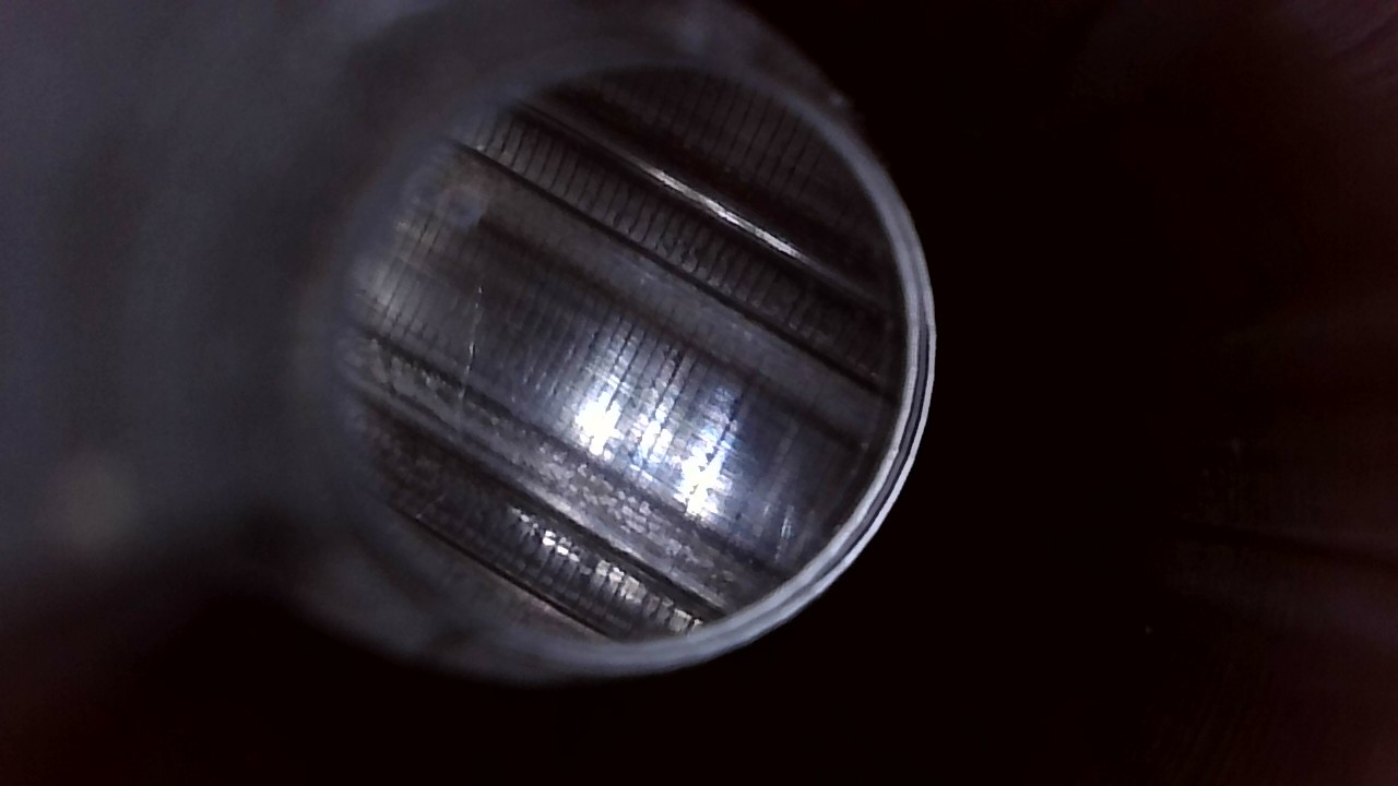

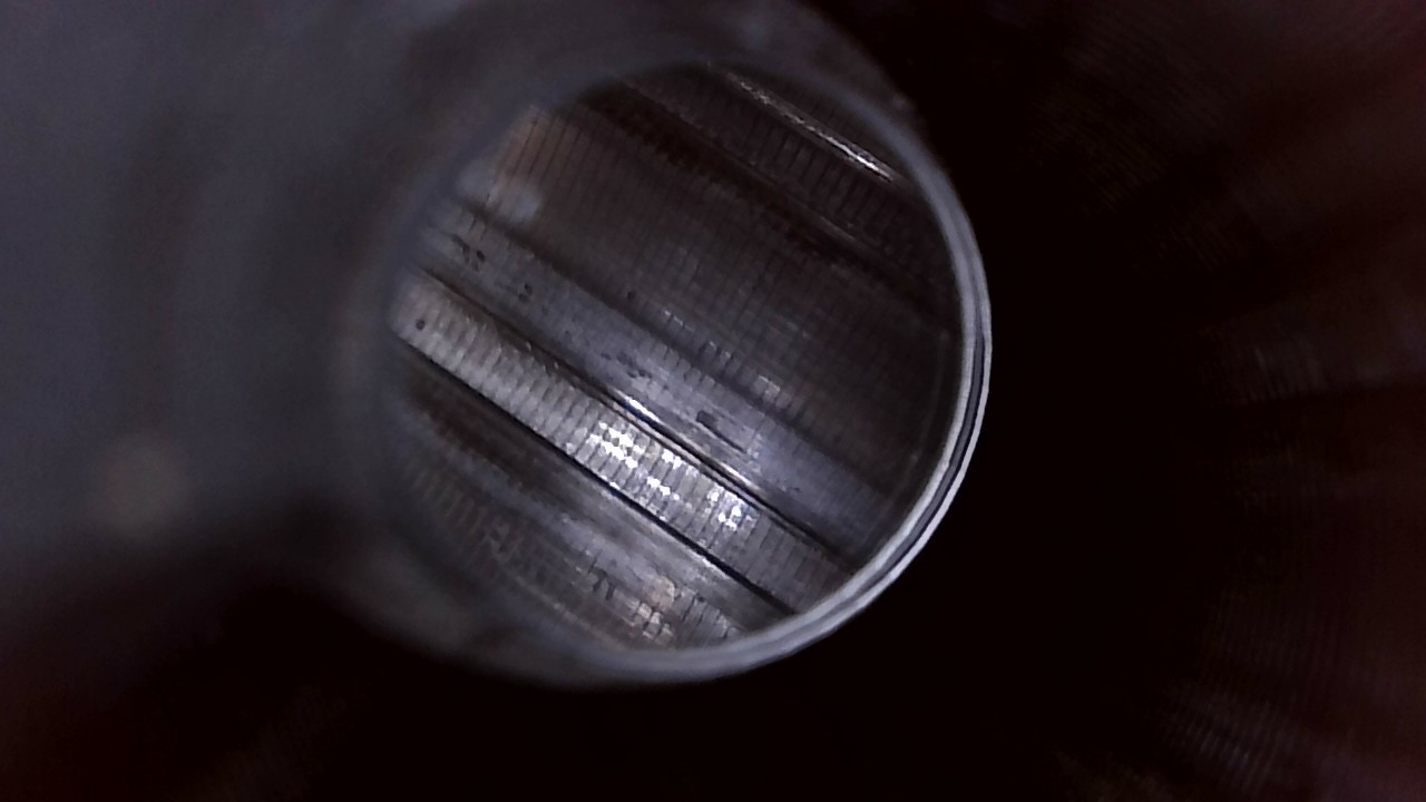

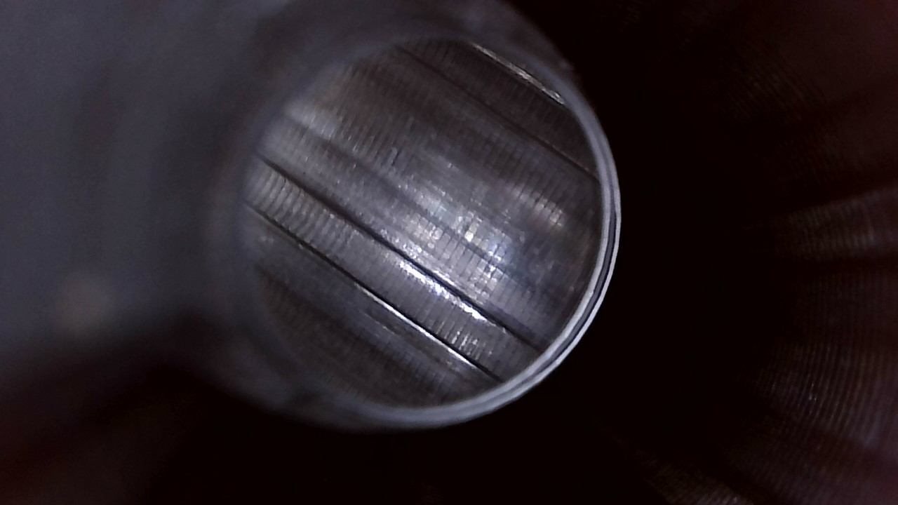

I just picked up this used Savage F/TR .308 and decided to take a couple of pix. I want your review of the condition of this barrel.

Most of what I see is chatter from the button rifling process. I'd shoot it before I condemned it...it just looks like most factory button rifled barrels. I have a couple that look like that and they shoot just fine.
well...what is it aside from a big nothing burger ....shoot itIf he has, if that going to change what it is?

sometimes bore scopes are like a boat ....2 happiest days are the first when ya bought it the 2nd when ya sell itThose are tool marks from the bore reamer; it's normal.
