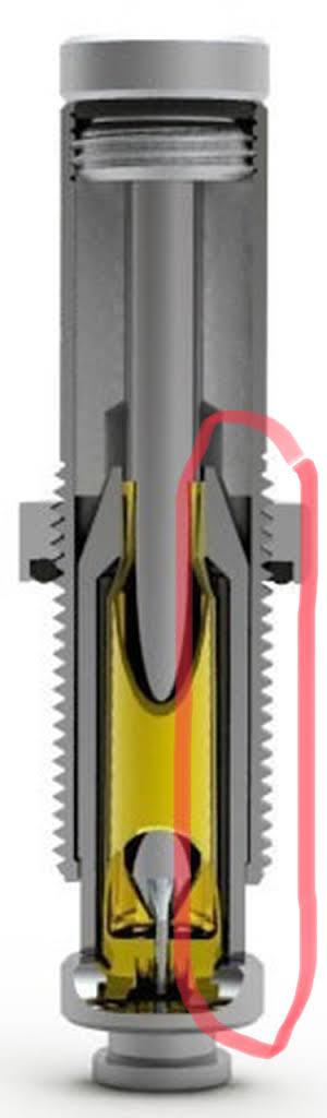

Using a lee collet die for a mandrel
Disfunctional_Engineer
Jul 27, 2020
307
372
Anyone ever done this? The pin floats in the die so what I'm thinking is just put the die up some so that it doesn't use the collet on the neck. The order I'm thinking about right now is:
-Universal decapper (flash hole check)
-resize (no expander)
-size neck (collet die as mandrel)
-Charge (probably a home brewed charging die)
-seating
I may eliminate the universal decapper by eliminating the expansion function (use a 223 expander or turn it off) of a standard sizing die. The other thing is that this setup would be compatible with my LNL AP as a "one shot" system where I wouldn't need to use the press twice. I'd just throw deprimed/cleaned/pocked prepped brass in and run.
The only consideration I have that could significantly alter this is that I wouldn't have trimmed and I think I need to do that after the case is in its final shape. (e.g. between neck sizing and charging.) If that's the case then I may take the first steps and have another setup for the last two steps (3 if FCD is used) and I would probably end up on my Dillon 550.
Am I going up the wrong tree here? If the shape of the collet die's pin is a bit suboptimal that's not much of a concern as I'll just chuck er up in the lathe and do what I need to.

That's interesting and it doesn't sound altogether different from what I'm proposing to do. Where do you trim your brass at if you don't mind me asking? It also sounds as if you're pretty well eschewing cleaning as well?
I have been doing this method for years.
Full length size, no expander.
Mica the necks
Push casing up lee collet mandrel 2 times.

Push down too hard on a collet die and you can collapse the neck and shoulder completely.
That is not at all how collet dies work. Push down too hard and you can stick a case yes, but you cannot collapse the shoulder with an in spec die.
You're absolutely right, I stand corrected. I have collapsed the odd case years when I started out using the collet die, but this was down to the case neck not entering the neck area of the die properly. A small amount of imperial lube fixes this problem.

Dont know how accurate I could remove .001, have done it on expander buttons .
Lee shows a PN for a .3035 pin but not a .305 one in their under sized mandrels. According to their web site the standard mandrel is .3055
You may be able to do something like that with a shear tool in a lathe (after annealing then re-hardening when you're done cutting unless you were using carbide) but I would think you'd be talking about a piece of ground rod honestly.
First of all as usual I was thinking backwards, so I removed the last stupid sentance from my post.
I measured the pin in the collet die again and got .305 but my calipers only go to .0005 so that's ok.
With fc gmm brass the result from the fls die is .003 nt. I was wanting to get to the magic .002 nt to get an extra 500 yards out of it.

FL sizing without expander followed by Lee collet would work but you will also be working your brass more than you want to. I use a Redding body die to bump 2-3thou then Lee collet for 1.5-2thou neck tension with great results.

I believe the object was to remove expander in fl die.
Remove collet from collet neck sizing die and leave the epanding mandrell in that.
Or I am lost again.
Well mandrell then.
Wanting intent not tiny details.
Not tring to argue.
So for the moment my mandrell and expander are the same size.
Will I still get a benefit from the separate process due to the free floating?
I do the Collet die & then Body die. I don't think it makes much difference, but I do know that my Remington Custom Shop 40XBKS likes this. Not much difference in my 700 Hart barrel using bushing dies or collet dies, but it shows up in the 40XBKS. I wrote this down years ago on which to use first. I can't remember where I read it , I don't know if it was German Salizar's articles or what, but I do have a note in my die box reminding me which to use first.
Runout is low. I did buy a separate undersized mandrel to use depending on the brass. I was fortunate to have a lifetime supply of free, once fired brass from Police bolt guns. Federal, Winchester and Hornady. One of the perks in the job.

Are you guys using a different size full length die? Like using a 308 FL die with no expander to size 7-08? If so what basis do you use for choosing the correct incorrect FL die?
Or only using something like the redding body only die for that caliber? And then using the collet die?
Or using a normal FL sizing die with no expander that will shrink the neck way down and then using the lee collet die to open it back up because it does something better than the ball?
I'm lost trying to understand what the process and benefit here is sorry... Someone catch the slow kid up please lol
The most common practice most in this thread are using and recommending is first use a Redding body die and second use a Lee collet neck die.
I don't personally use this process since I get no more than .0015" max indicated run out on loaded ammo using a Redding Type S FL Bushing die but I also turn my necks from the start.
You can send 2 fireformed cases and bullets of your choice to Lee, they can custom a Collet Dies for you. $70.00
you can also request the mandrel size.
$70.00 is a small price to pay for Lee custom collet die
