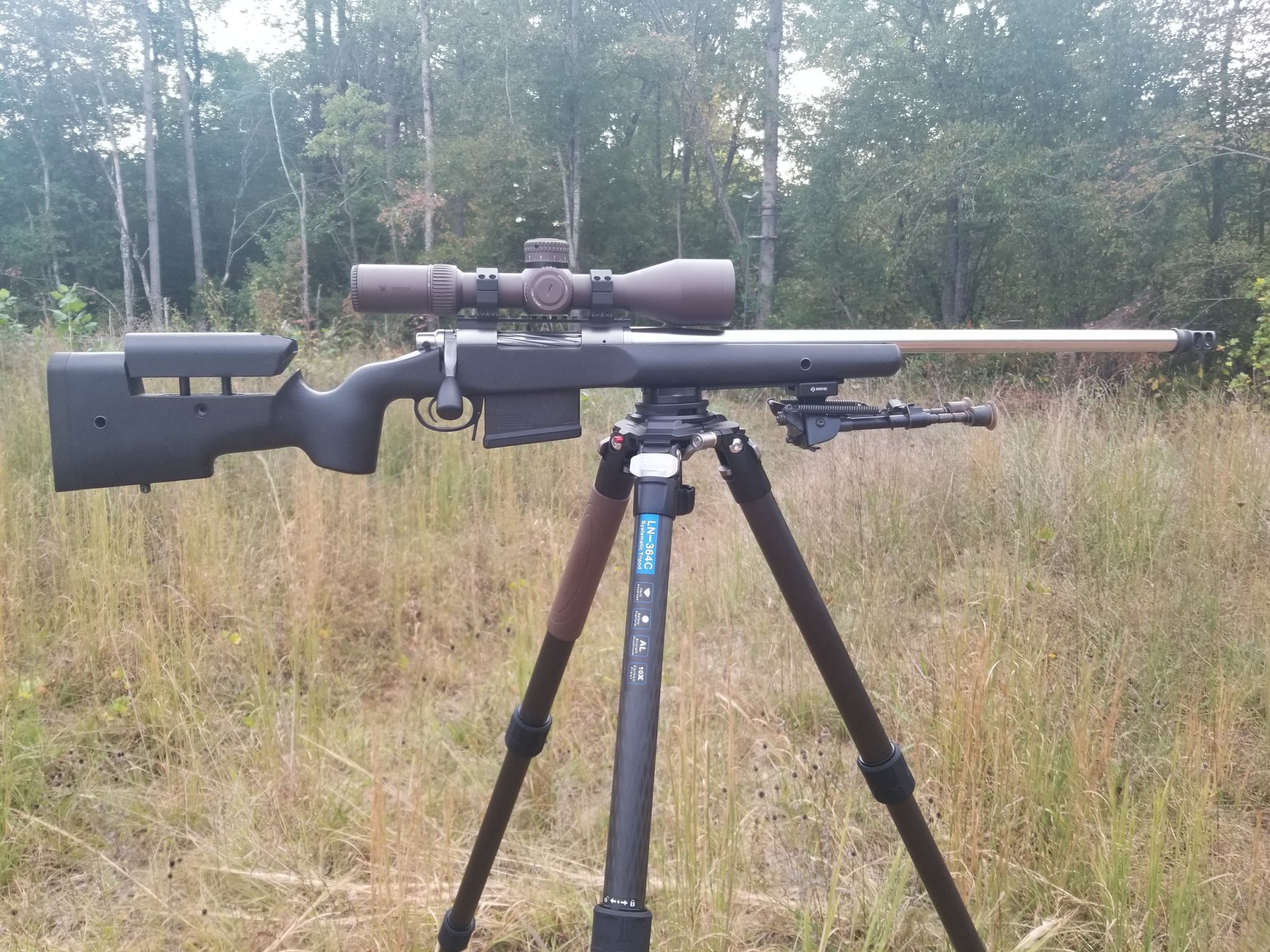

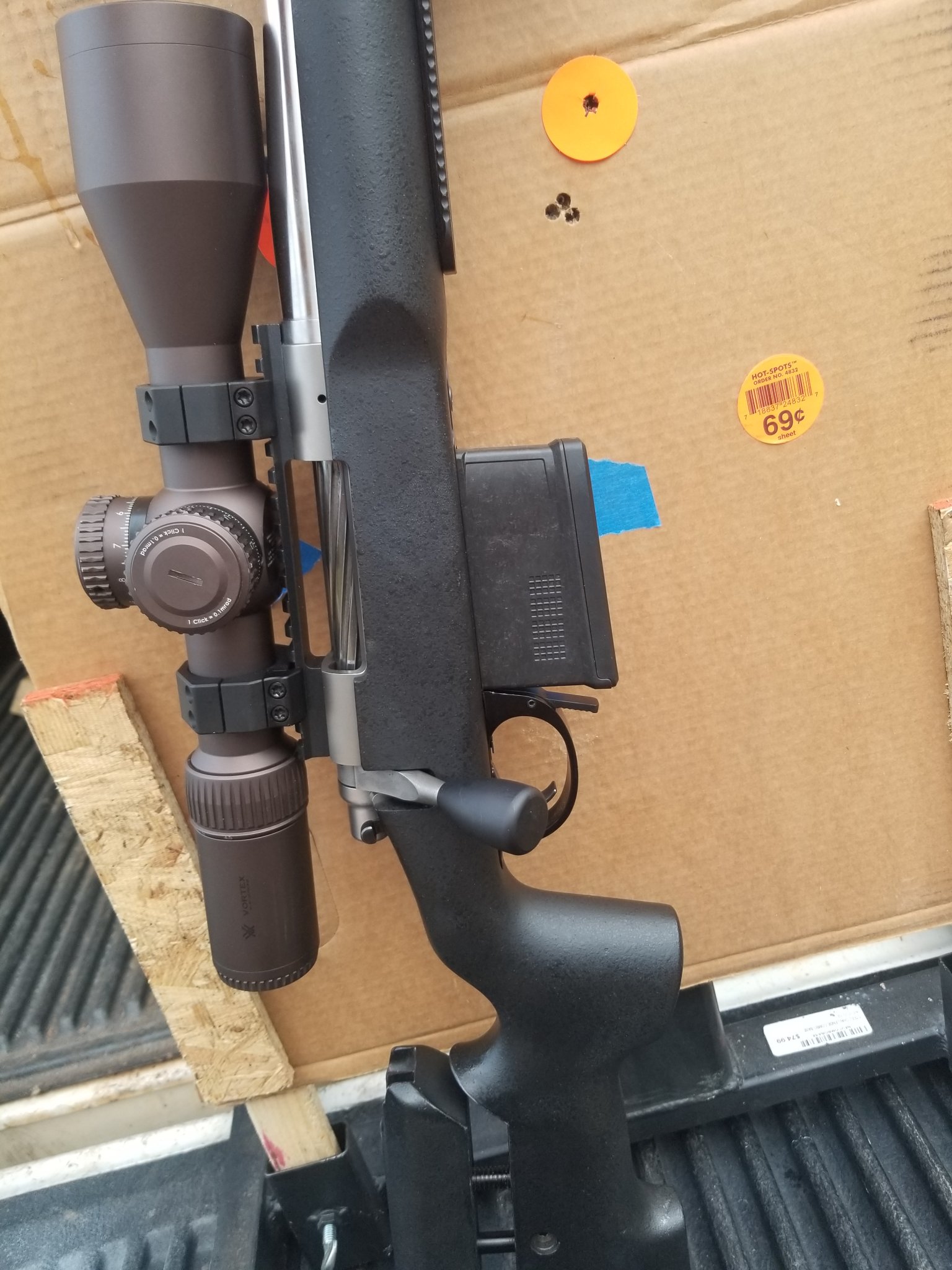

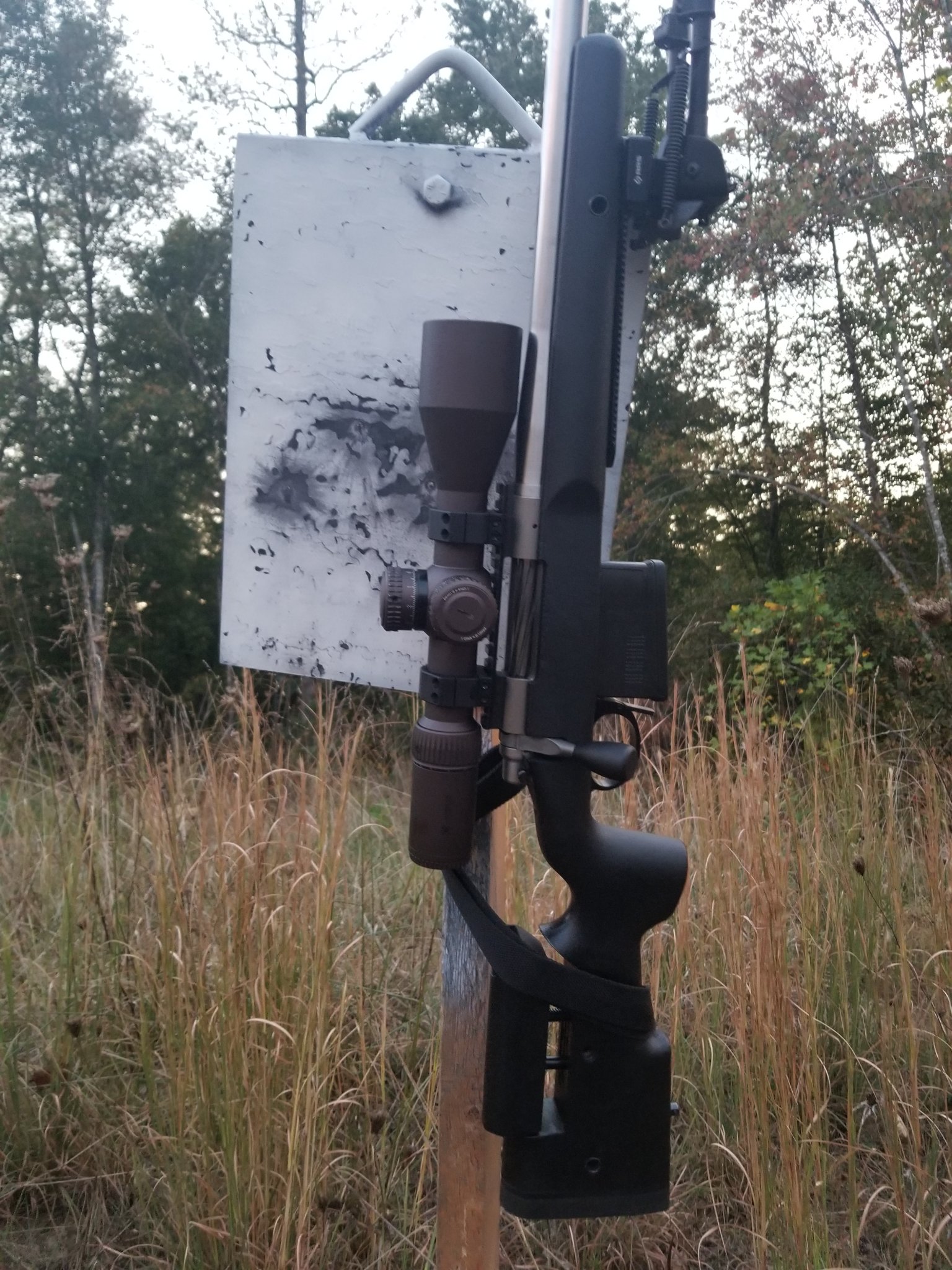

I attempted it. 6.5 SAUM, 700 Long Action. Magpul AICS mags. Worked really well.
