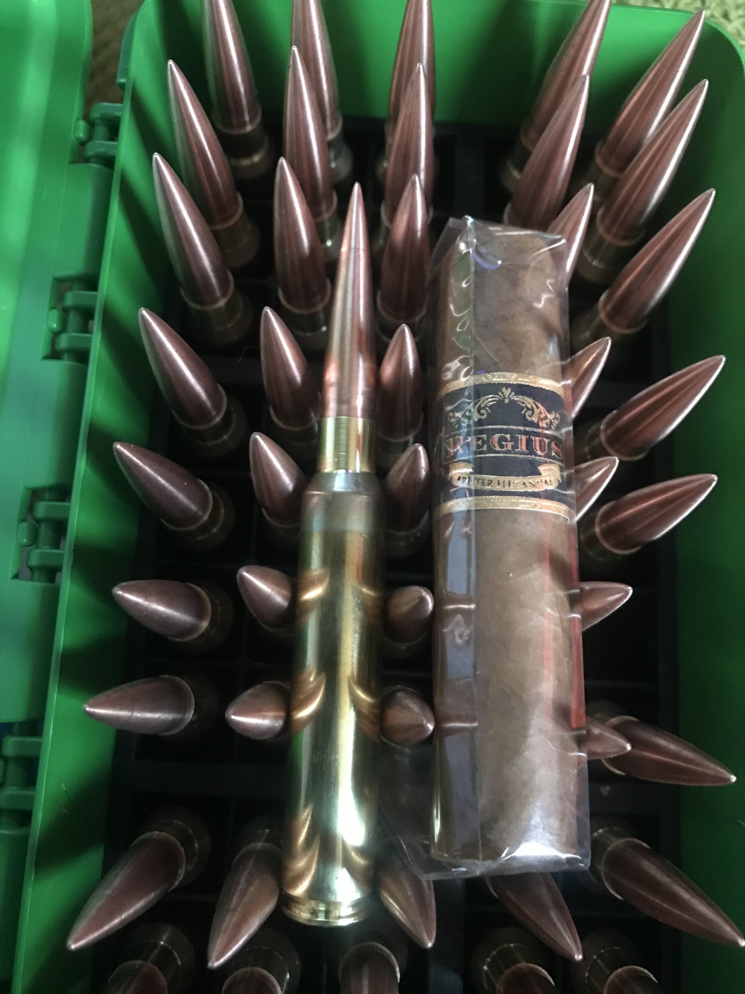

When you get everything settled in and are actually pushing for the 2000m range, you'd have a much easier time using these:
Not that your 300gr Lapua Sencar projectiles won't work, but the above ones are specifically designed for ELR shooting and have much better ballistics.
However you MUST pay attention to what the twist rate on your barrel is and check the projectile listing to see what the minimum twist rate on each of the bullets is, as if your barrel is not fast enough the rounds will be unstable. They have ones for 1:10 minimum, 1:9 minimum and the heaviest ones need 1:8 minimum.
