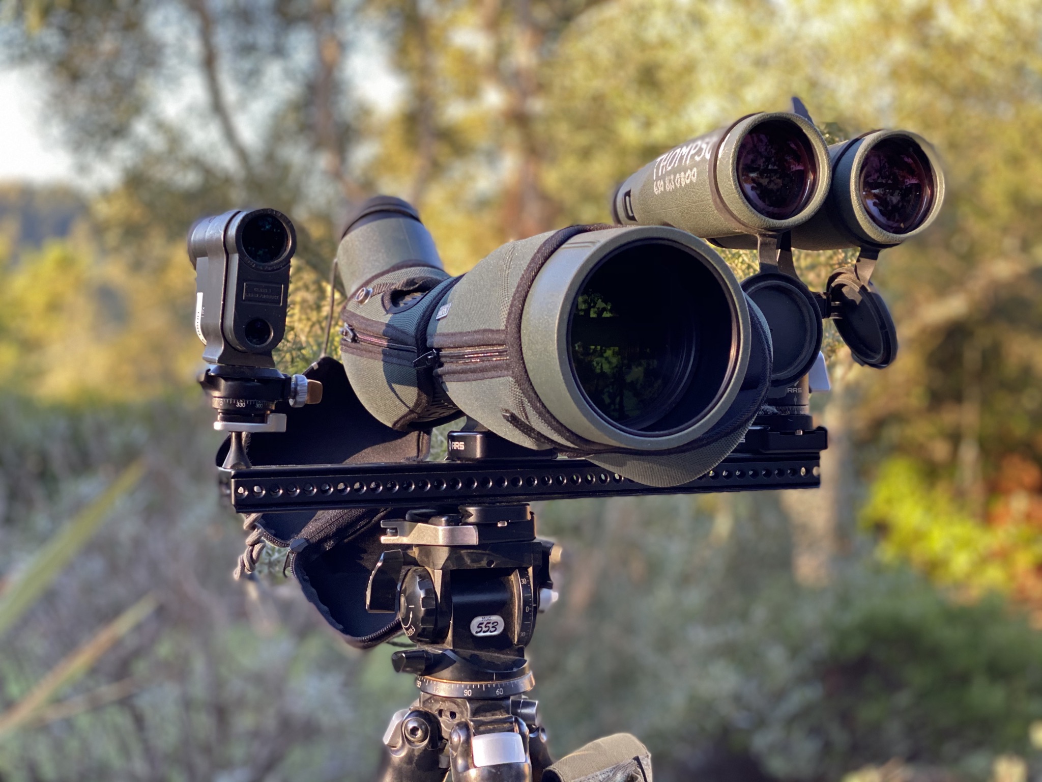

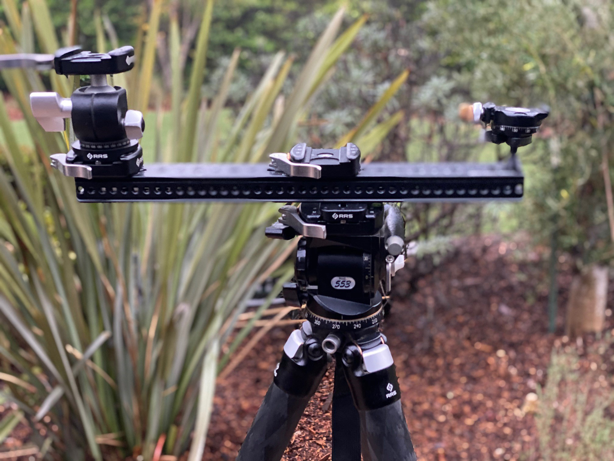

I have a Berlebach 553 pan/tilt head which I bought for a spotting scope setup like this (not mine, but I copied most of this setup).
Since I owned the head I figured I’d try it with a gun.
The only downside is you need to level it or as you pan your rifle cants, sometimes quite a bit. But as a vid guy you know that and you have a leveling base to speed leveling. Still, if you need speed to get lead on a fleshy target, flopping the sticks out and slapping the gun on a ballhead (with or without a bag) is way faster even than a pan/tilt head + leveling base (for me).
Btw I added a leveling base soon after. I use the setup to scope cam the hits…my LRF binos are co-witnessed to the spotter. Pretty fast.
The head’s arm can be a pain when using with a rifle, and when I took the arm off then it was sort of hard to adjust the head into position if the gun wasn’t on it. A minor thing, but mention for noobs who are thinking about it…not the OP.
For ballheads, I like the original Arca B1 ballhead and its asymmetrical ball, which slows down as it approaches its angle limit. Reduces “flop” damage.
Most like the RRS Anvil 30, but I dunno, I never got on with that well as I like separate tension for panning and tilting as I do a LOT of panning when varmint shooting. If you shoot immobile targets, yeah, the Anvil would be good.
Edit: I don’t know about your head, but my setup with the RRS leveling base gets the gun up pretty darn high, which is less stable. I imagine you have a typical sunken 75mm/100mm video bowl so the gun would be much lower.
