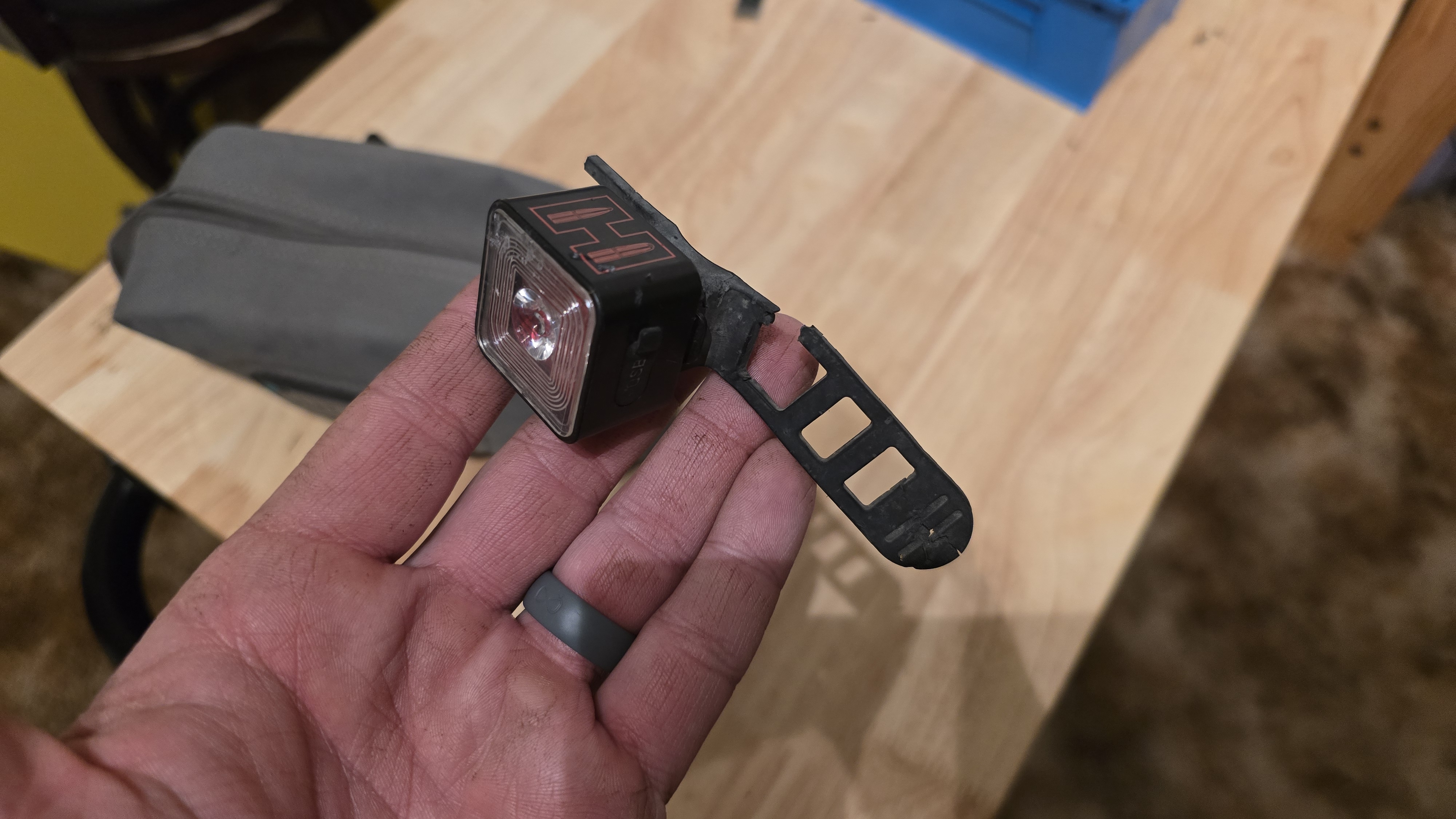

The rubber strap that comes with it

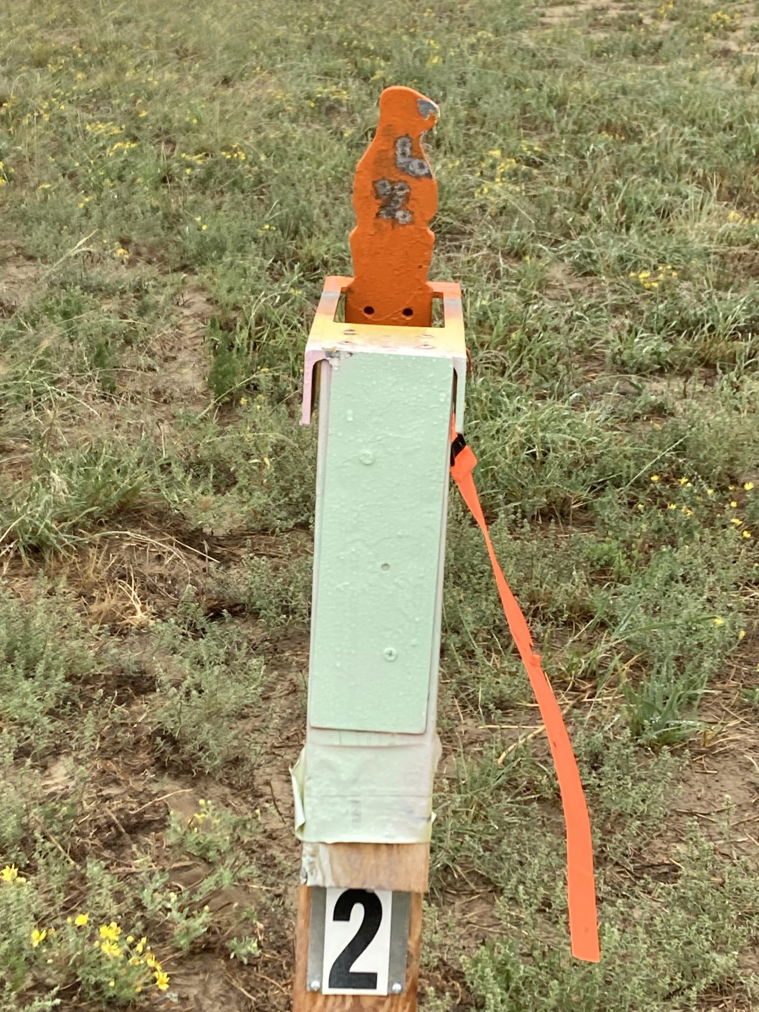

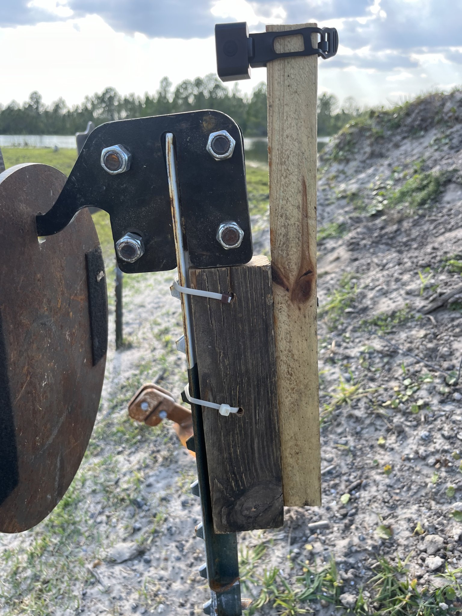

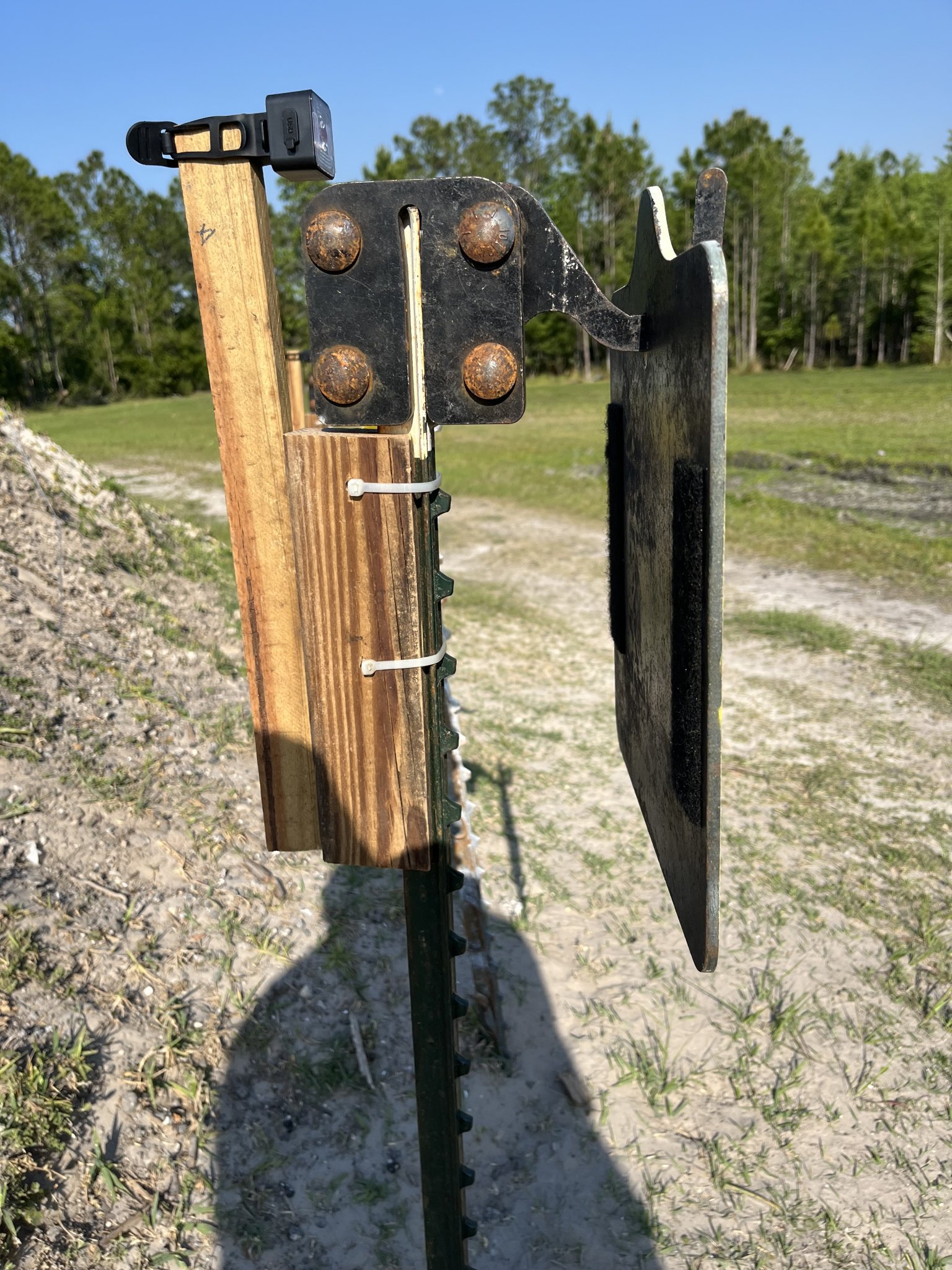

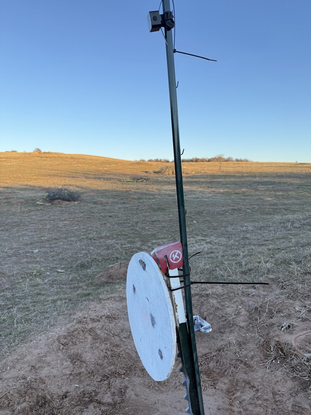

I run PRS22 matches and my friend runs centerfire. We use T-posts to hang most targets. Strapping it the the t post is a sure way to have it shot off before the match is over. I used an offset wooden piece to try and avoid spall and lost 4 of 5 to being shot off.

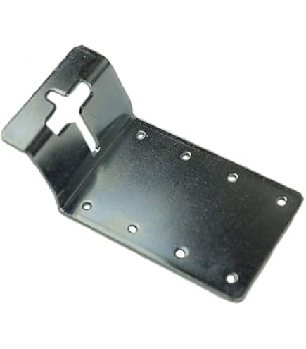

Here’s what I did:
The above were the first version. I made them taller for the last match and had worse luck.

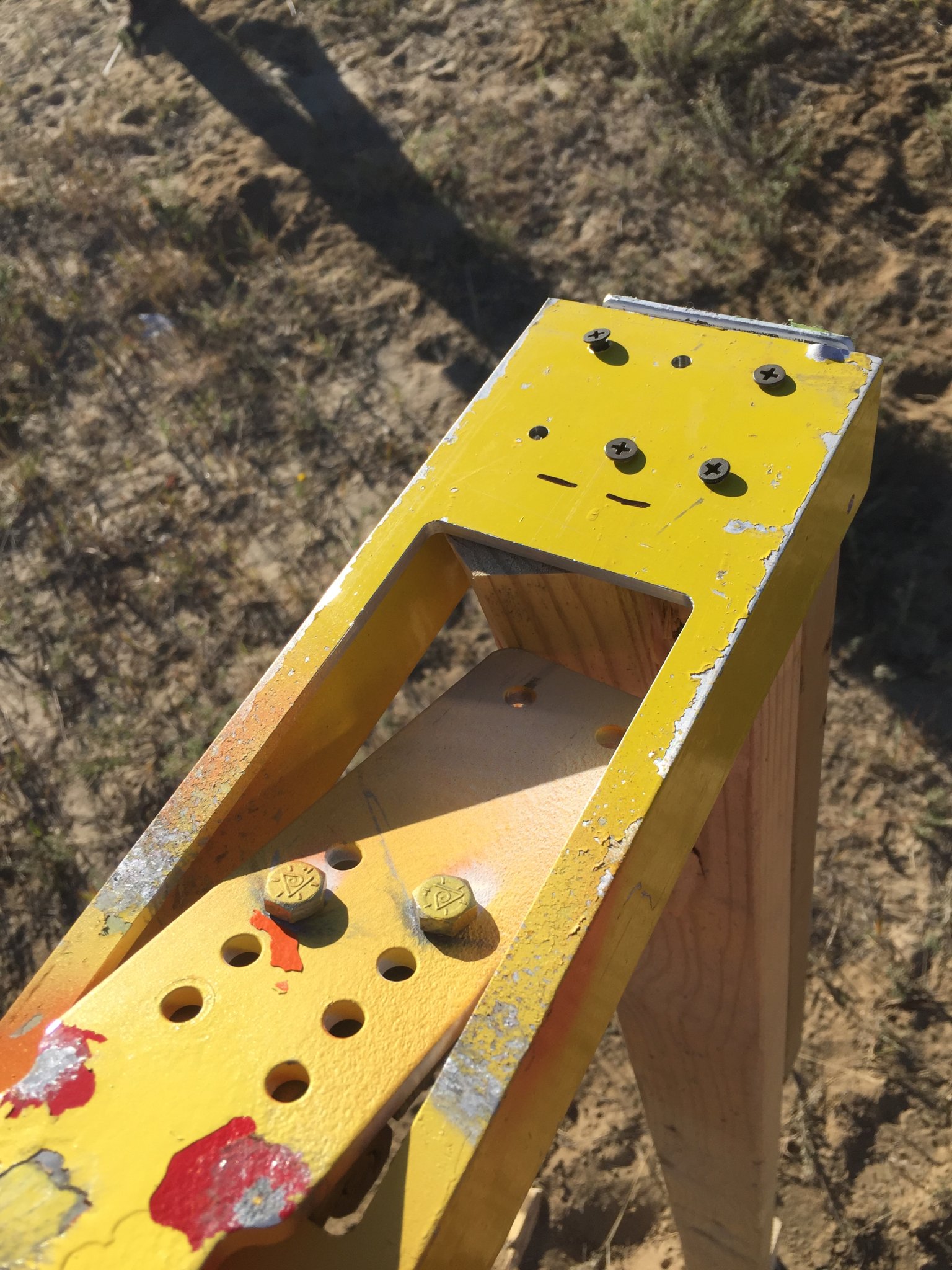

I like these indicators but they are way too sensitive. They indicate when a competitor hits the post instead of the steel target. Also, if you have a multiple array of targets hanging off a common shaft, hitting one target sets off the others on that array.

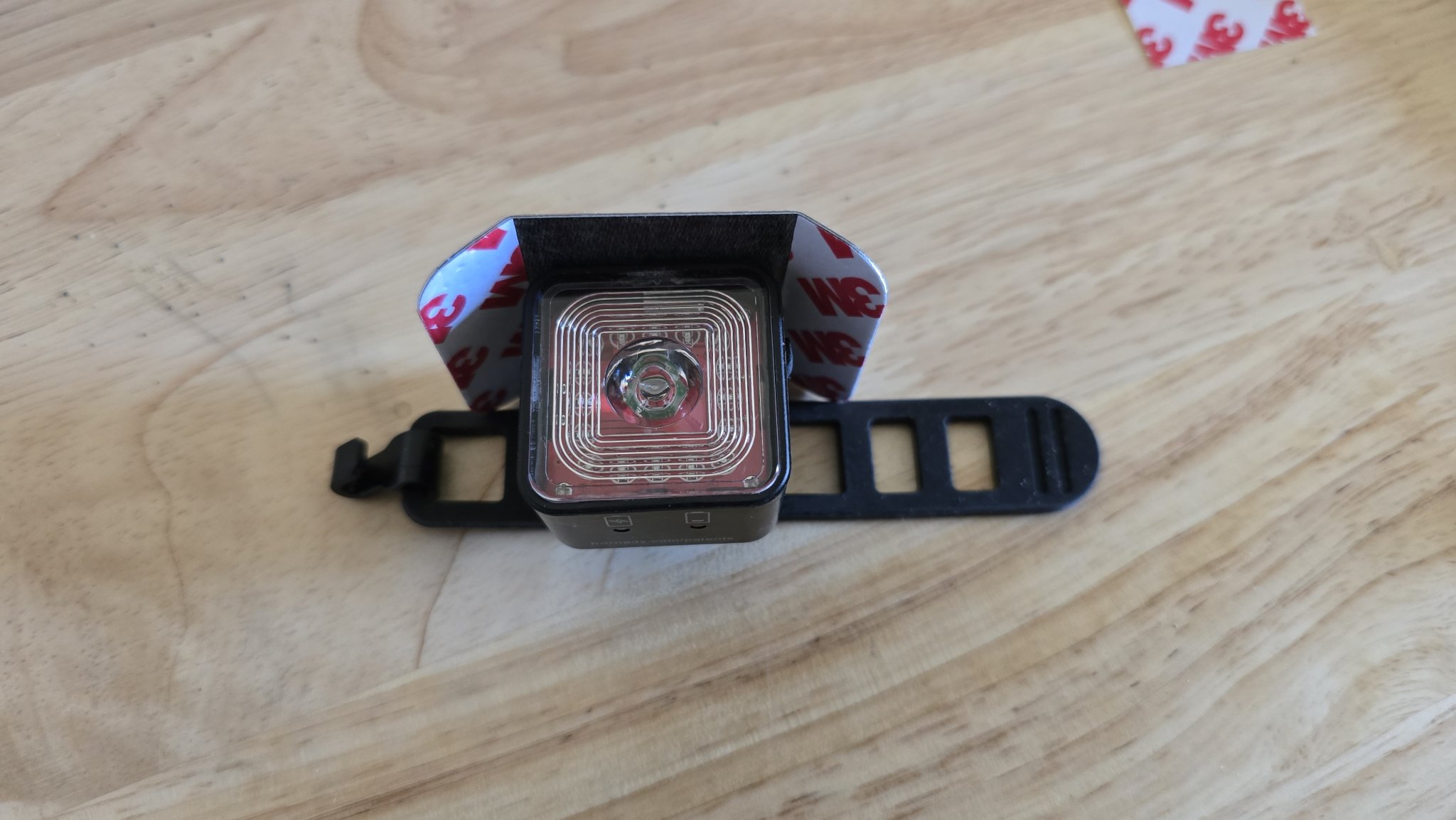

As to physically mounting them on the steel itself I drilled two holes in the target and mounted a peice of conduit about 12” and mounted the indicator on that. Conduit sticks out 7” at 2 oclock.

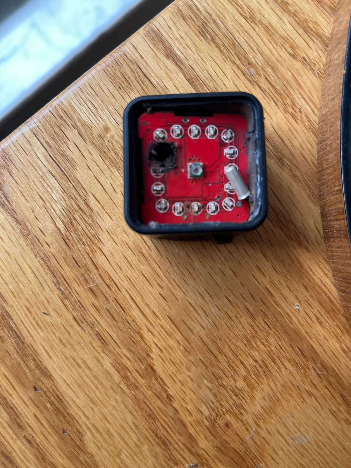

Has anyone tried taking one apart or modifying it?

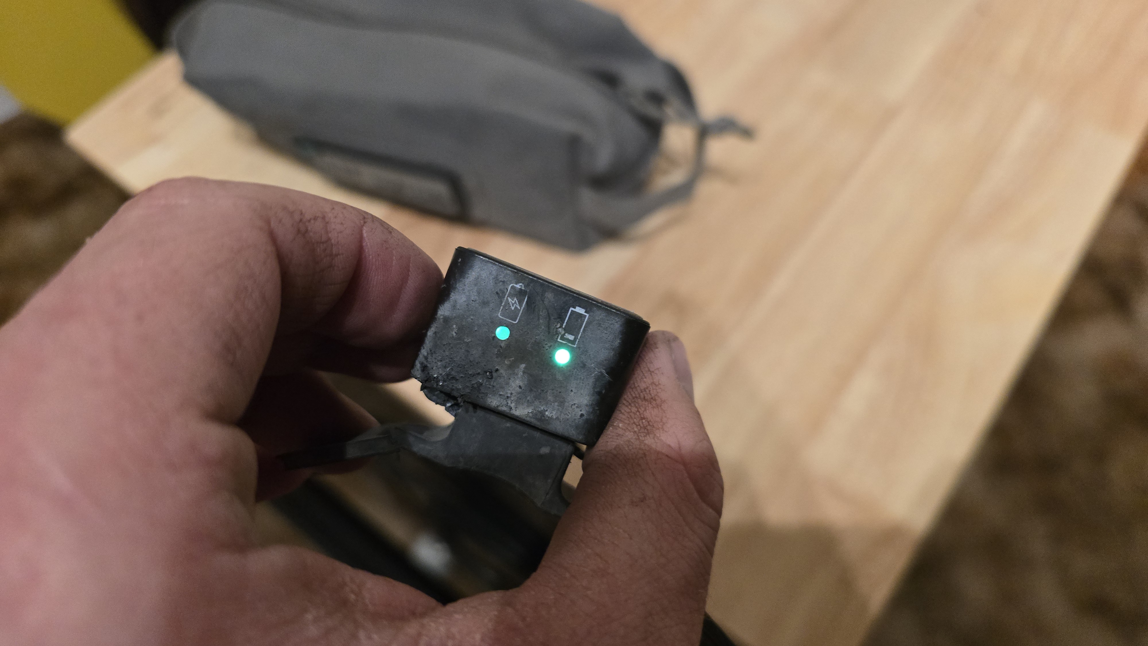

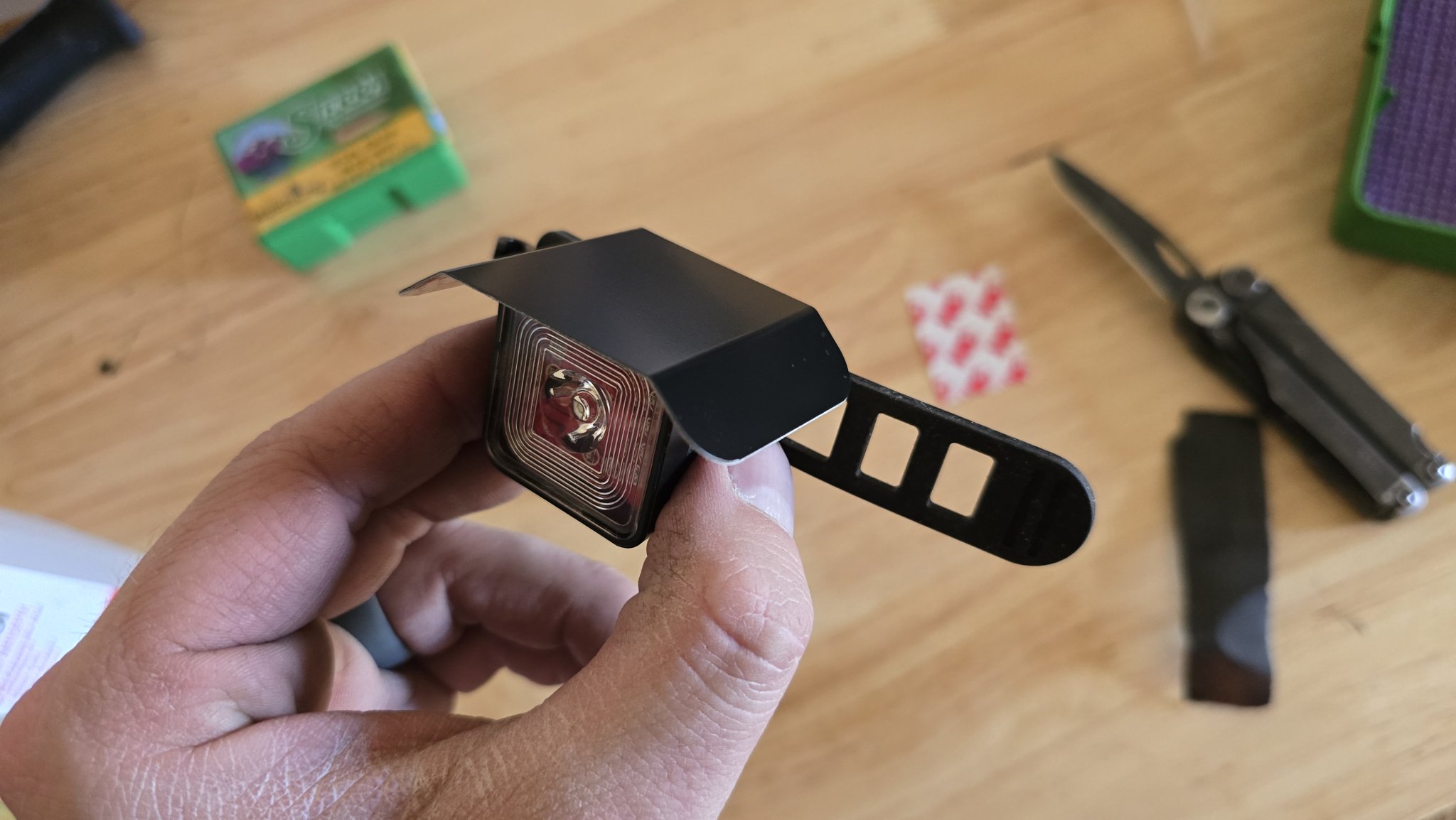

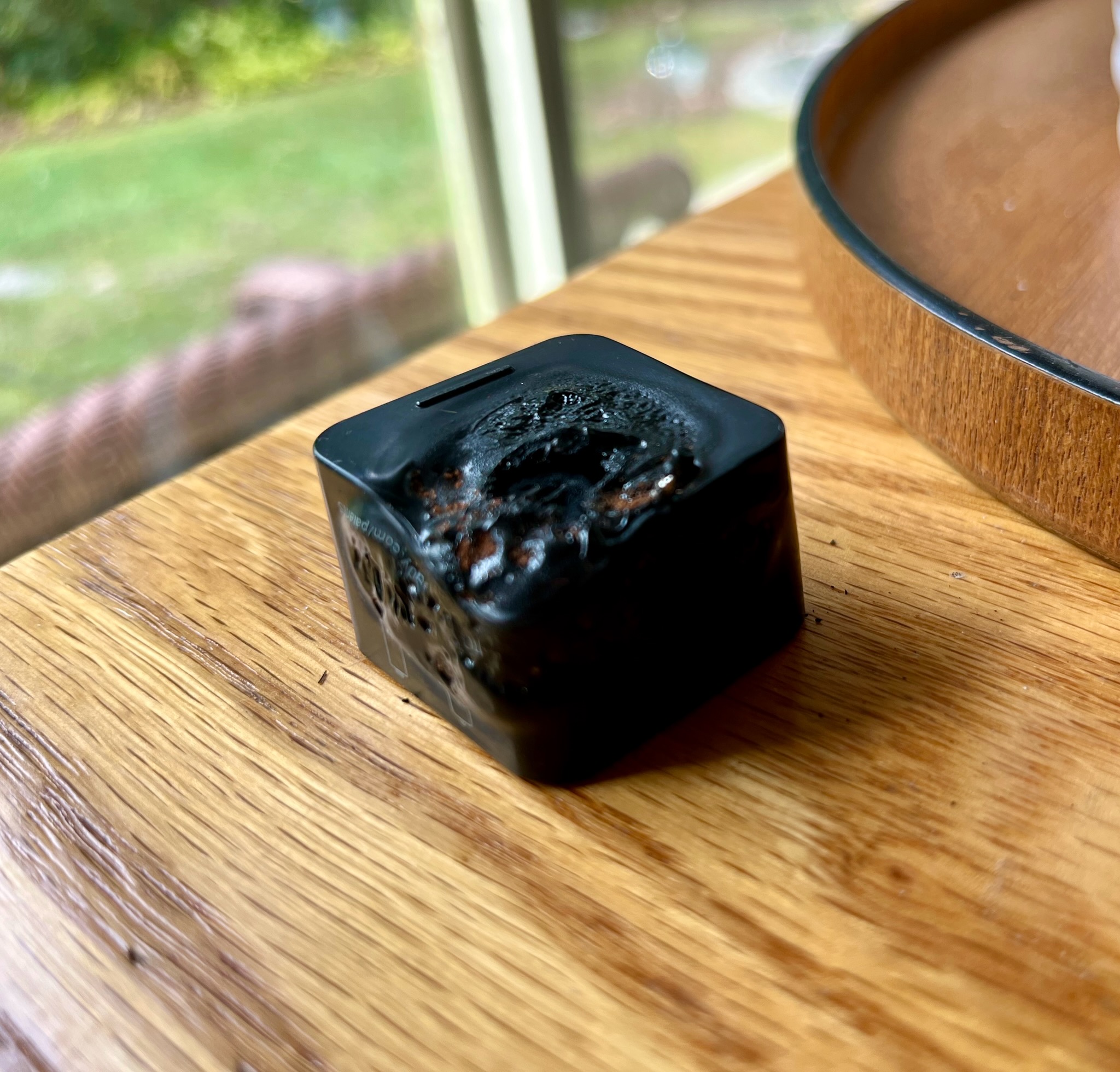

I gave up on these hornady indicators. They work great for long range centerfire targets mounted on a t post, but close in targets for rimfire they didn’t work out well for my match ( my targets are mounted on 2x4 posts that slide into 4” diameter plastic conduit holes buried 2’ in the ground. Too many competitors hit the posts and the hornady indicator erroneously counts those as a hit).
I’ve switched to the caldwell “flash bang” indicators instead. They cost $31 each, but go on sale occasionally and I have not had the false positives when the posts are hit instead of the target. They are considerably cheaper than the magnetospeeds as they are charging $200 each now. In addition, I like the green LEDs better and there are a lot of them on the caldwell with a better flashing pattern, plus they have a on/off switch.
The downside is the LEDs are exposed to bullet hits, but I mount them around 1-2 o clock on the target and haven’t had a hit yet for half a season. At 31$ I wouldn’t worry about it.

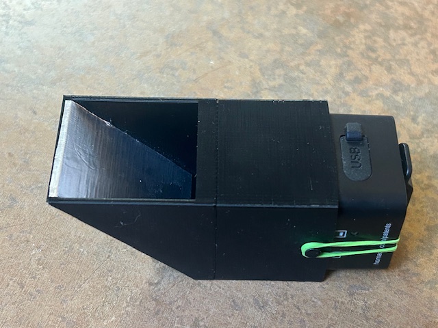

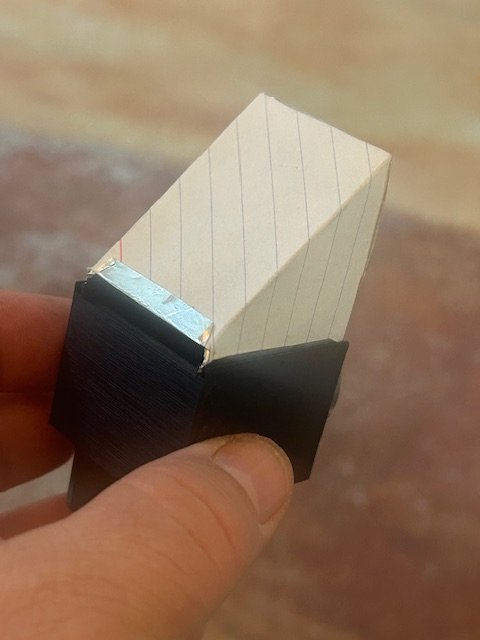

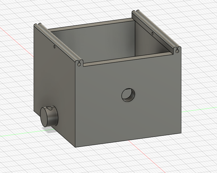

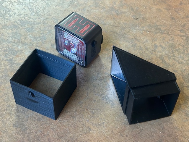

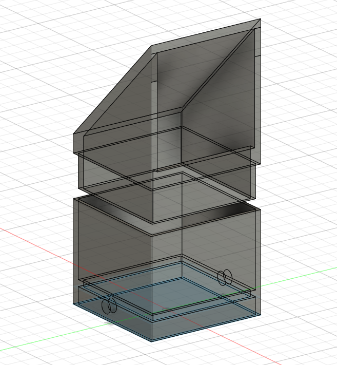

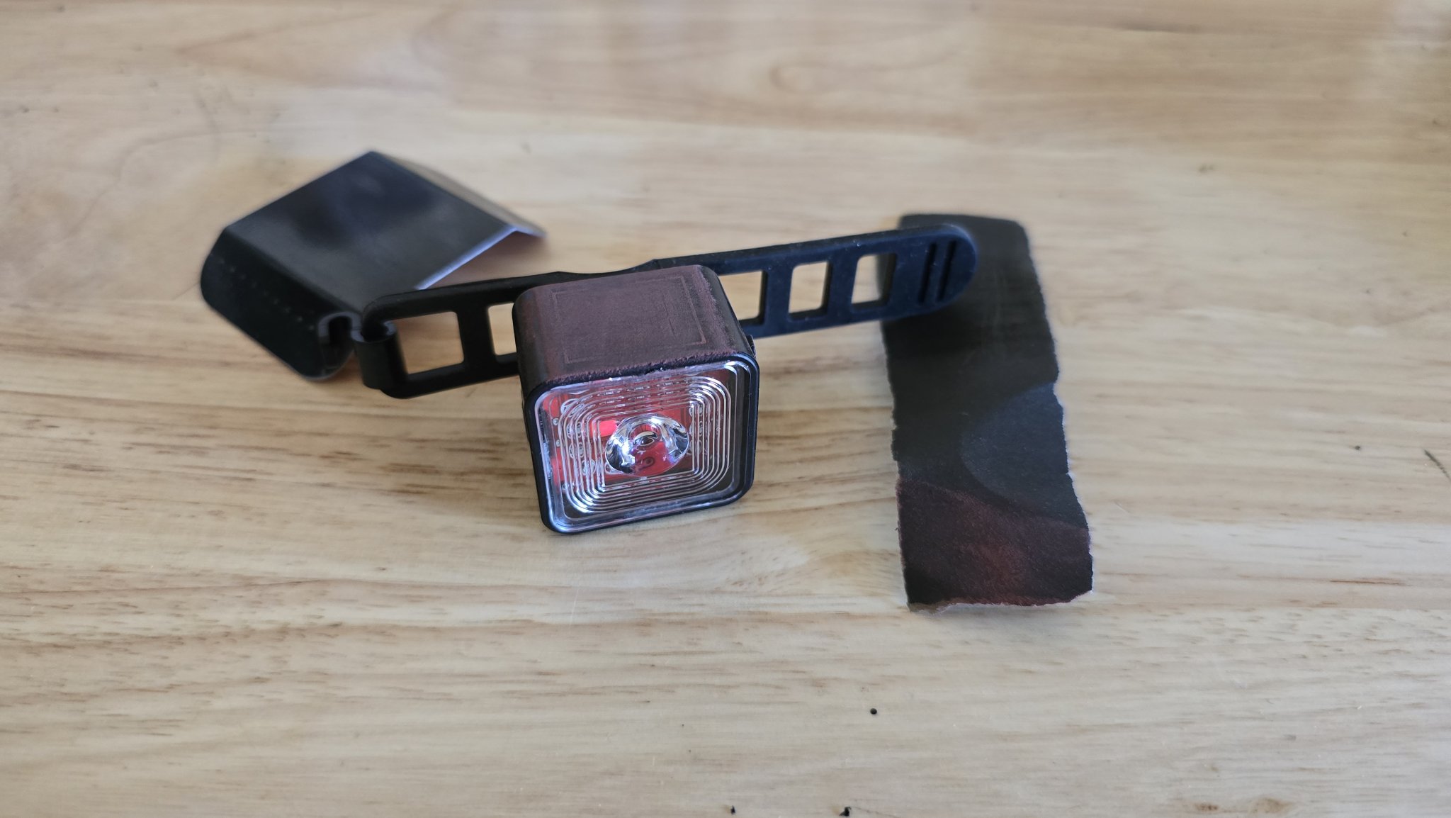

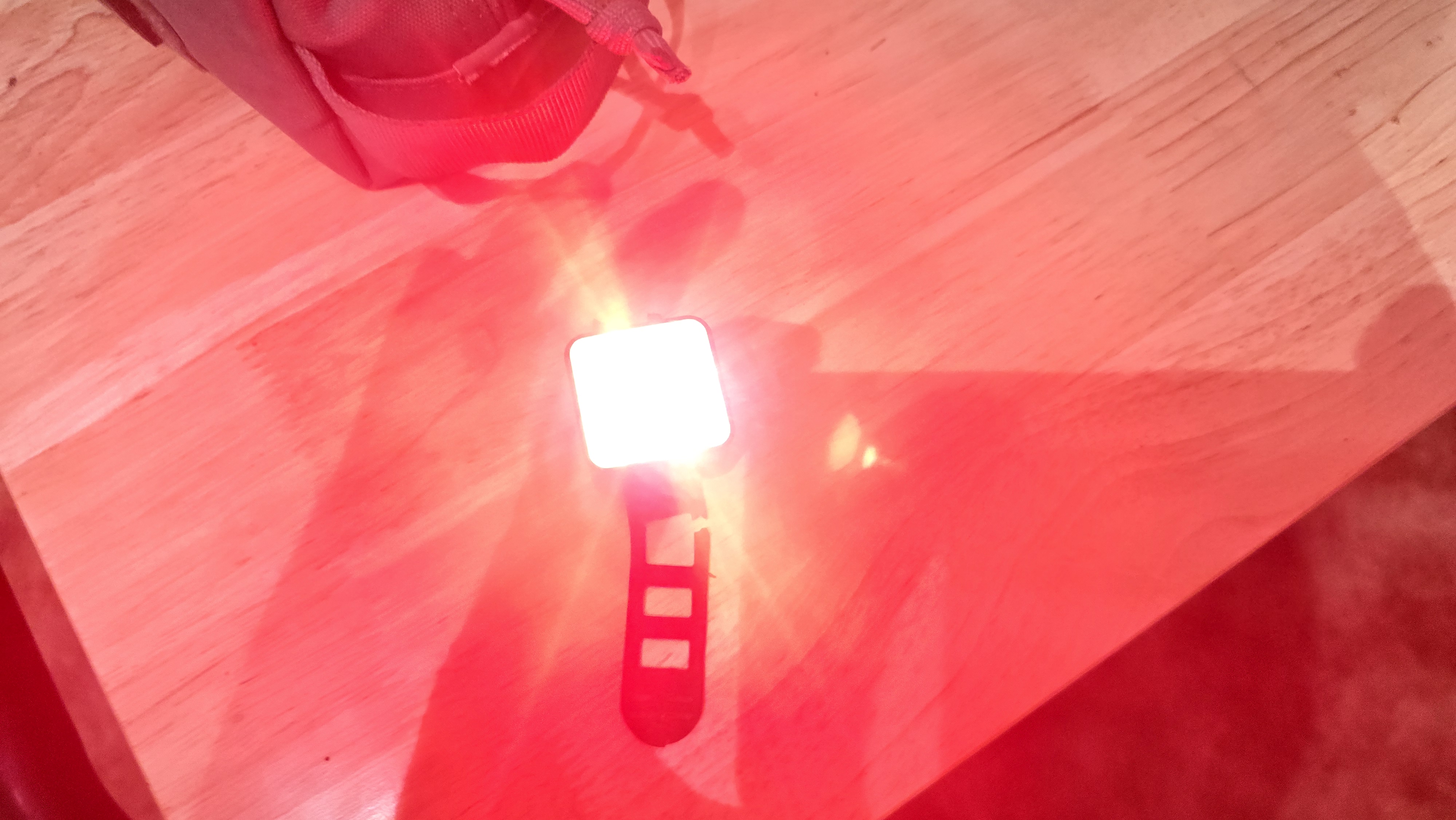

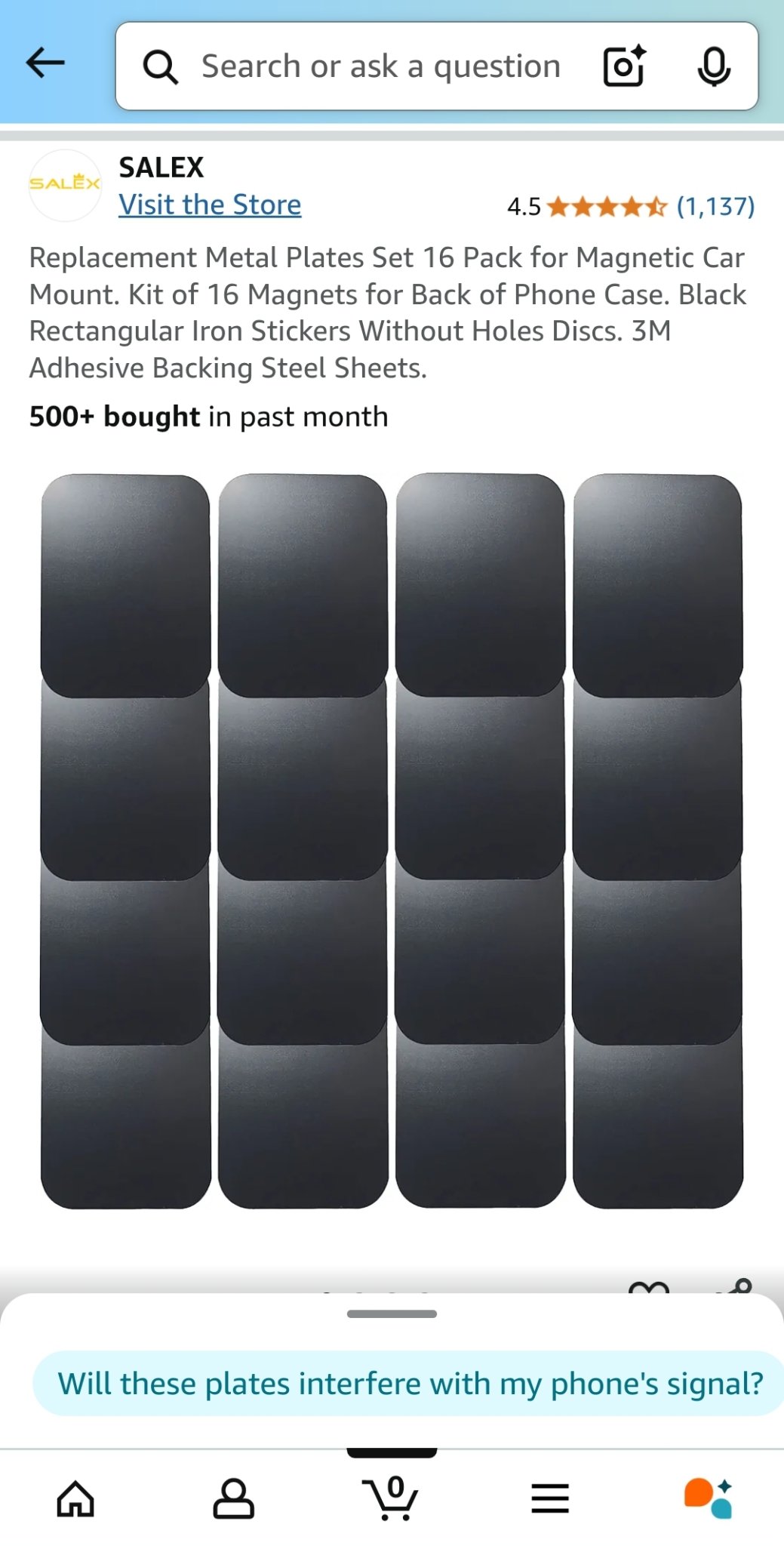

Decided to get off my butt and design what I was thinking about previously. 3d printed parts, glue a magnet on the one side, and it should stay on the back of a steel target for 22LR pretty easy. Not sure how it would handle centerfire, might need a different mounting option, maybe some padding to not transfer as much energy to the indicator. (Walls are not super thick, could stand to be thickened after some testing, this was a quick prototype)
The reflective part just slip fits into the tube holding the indicator, and I glued a piece of alum foil on the 45degree angle to reflect the light better. Small knobs on the side to retain a rubber band going around back of the indicator.
If the reflective part gets hit, pull it off and slide a new one in. Could have a few with ya, and with a 3d printer we are looking at about a grand total of $.50 worth of plastic.

I think the real test here will be how it reacts when shot. If it just pokes a hole you've got a winner.
If it shatters or drags then knocks it off the mount you still have down time.
Another idea is to make the reflector a "flap" out of foil furnace tape or perhaps even the entire angled hood.
Would still be a dirt cheap sacrificial part and perhaps be able to withstand a match worth of abuse.
I bought 30 of these for my match in Spring of 2024, down to 20 or so now.
I mount them to the T post 3-4 feet below the target and normally lose one per match to a bad spall hit or on rare occasions a really bad shot.
They work incredibly well, but will activate if someone shoots the post, or in very hard rain. (We still use spotters, I hope everyone does).
Long story short, I love them. Easy to use, cheap to replace. Anything downrange will die eventually.

That's not a bad play there. I think if I printed it out of TPU the bullets might do a clean pass through, but just gluing down some foil on some cardstock and folding it to be the entire hood would be a cheap and easy way to keep it going. Will have to see if I can come up with a good mount for that! (I have an idea already.)

I was thinking of making a metal top hat to protect it from spall when the HIT is mounted below the target. Might try a generic t post target hanger and bend it to work or make one out of piece of scrap tin, etc.
Good idea to make the reflector a cheap consumable. I reprinted the base unit, thicker, with a hole to mount a strong magnet to it, better rubberband mount points, and the top so that a piece of cardstock could have foil glued to it and folded to fit. Looks to work fine, will need to go try it.
