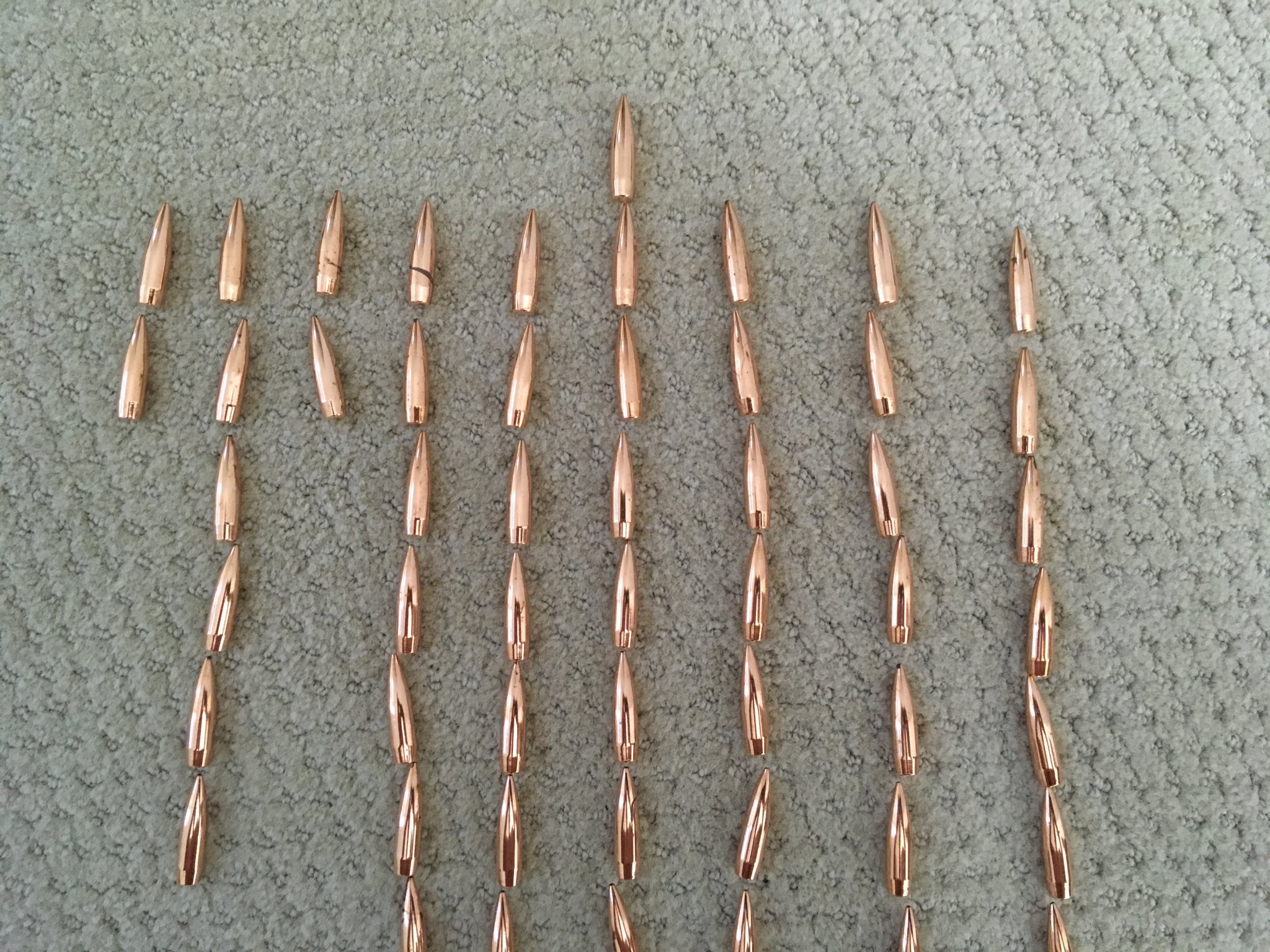

A lot of the time the length variance is too great so one way to do it is to sort all your bullets by length and use the middle length to set your COAL. Then your shorter bullets will be predictably shorter and vice versa. The middle length will typically be the one with the greatest number of identical projectiles.

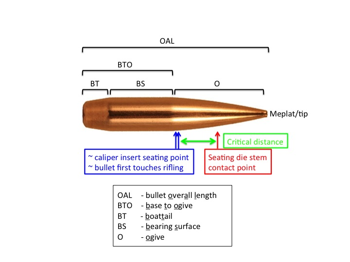

Why use the comparator case? So you know roughly where your lands are. You can figure out where the lands are with lots of different approaches, the Hornady tool is one of them. I would say knowing where your lands are is a pretty fundamental reloading requirement. Avoids jamming the bullet into lands (bolt wont close, or overpressure, or a bullet sticks in the rifling and pulls out and dumps gunpowder everywhere when you extract a live round), and also lets you set seating depth reasonably close to the lands (more case capacity, generally will be better accuracy).
Why measure the ogive of a bullet? Consistency and repeatability. First it lets you accurately measure how consistent your loading process really is. If seating depth is varying by 0.005 between rounds that's something you can go investigate what is causing that. Problem with seating die, maybe a seating stem cracked? Neck tension causing inconsistencies? Making sure each round is the same is one more step towards accuracy. Probably your die and workflow is just fine making consistent loads and no action is needed... you just won't know that by measuring base to tip.
Second reason is repeatability. Measuring off ogive allows you to recreate the same load exactly when you change dies and set them back up again. Base to tip will only get you in the ballpark, which may or may not shoot the same as last time.
A set of comparators to measure headspace, measure ogive of bullet, and some sort of approach to measure the lands is pretty much reloading 101 in my book, if you are shooting precision rifle.

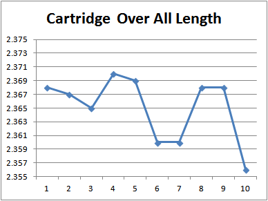

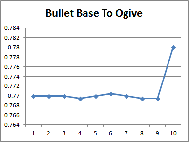

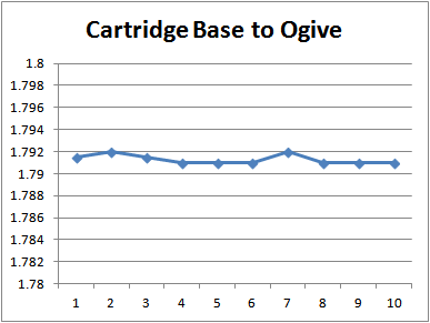

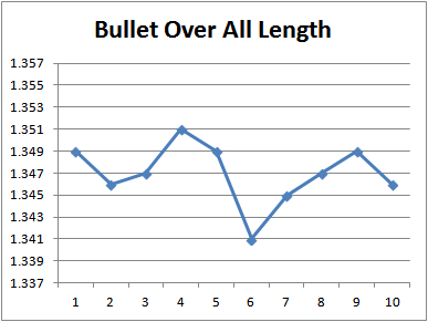

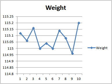

Im loading a seating depth test tonight so Im not going to load a huge sample of the same exact thing but I will load up 10 rounds in which I log the individual bullet length and ogive length and then the loaded length and ogives for the same bullets.
Here are the results from my sample of 10.
One of these- the one that most closely matches where the bullet will actually engage with the ramped lands of the rifling- is much more consistent that all of the others, wouldnt you say?
Bullet #Bullet Over All LengthBullet Base To OgiveCartridge Over All LengthCartridge Base to OgiveWeight

(All length graphs have an axis range of .020" in .002 increments so the variation should be comparable by sight)

View attachment 7093951View attachment 7093957
View attachment 7093954View attachment 7093966

In either case, the COAL measurements are much wider and less accurate than the CBTO. (10x as much variance with a range of .01 vs .001)

They are more accurate and easier to achieve, if you sort your bullets. These took a few minutes.
I really dont see how this is even debatable.
The variance in measurements are pretty clearly all in the tip of the bullet.
The relationship of the barrel and the bullet is between the lands and the bearing surface of the bullet; not the tip which just floats freely in empty space.
