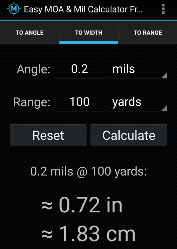

I use the zero offset feature in my Kestrel to do this. Just measure the offset in mils with your reticle, convert to inches or cm with this app, and enter that into the Kestrel.

Thanks for the info! I'm assuming that app is for Android. Know of any good, cheap ones for iPhone? I'm using the Kestrel apps for everything else. Too bad they don't include this feature.
