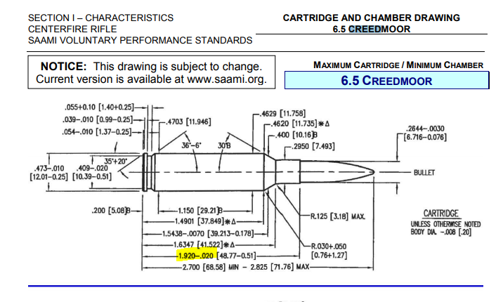

But the actual spec is 1.900-1.920.
Your necks were within spec.

Good question Mainer. My chambers are SAAMI spec. I go by the published spec in Hornady's 10th Ed. (6.5CM) 1.920 is max, and I try to not trim any more than necessary, so I have ended up with two trim lengths. 1.918 and 1.916. This is a mix of mostly Hornady and some Federal, Win, Nosler. & Now I have Lapua which at 1.90-ish needs no trimming at all.
