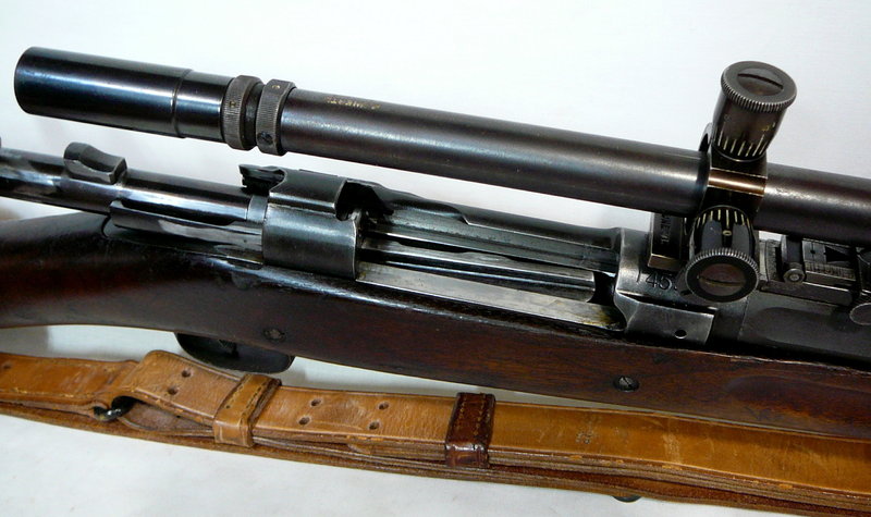

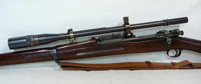

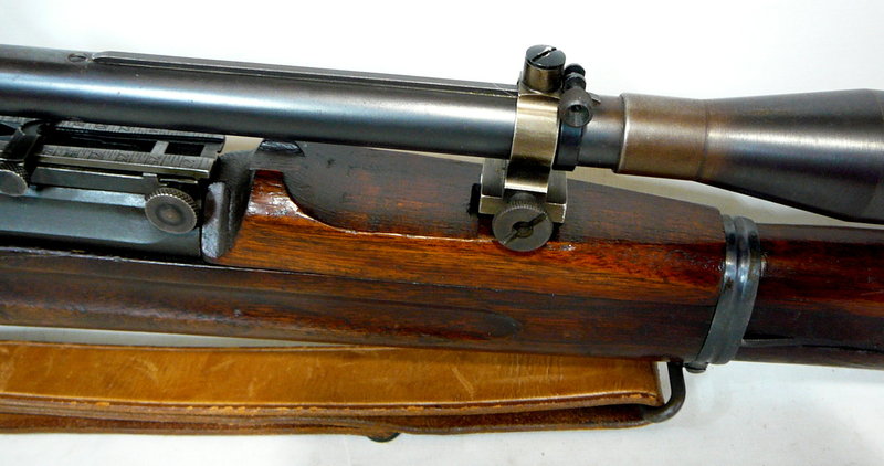

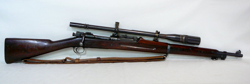

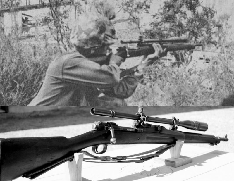

I've never really shown this over here. But I was sort of bored today, and thought it might spark some discussion. And maybe kick up some original rifles that I'm not aware of yet. I keep a log of all known rifles, so if you have one, contact me. :)
This rifle was original a National Match 1903A1 made in 1935 or 1936. Even though I believe the rifle is most likely a 1935, It's really hard to tell for certain which year as the Marines replaced the barrel with a SA 4/38 barrel. At the same time they drilled the hatcher hole and enlarged the gas hole in the bolt. The Marines did receive National Match 03's in 1935 and 1936, so it really could have been in either shipment. It's just hard to know for certain since it doesn't have it's original barrel.
The Marines only received National Match 1903's in Certain years, and all were used by the Marine Active and Reserve teams at the National Matches. At the end of the season all rifles were returned to the Philly Depot and the ones with worn barrels, had their barrels replaced with standard barrels. The rifles then became known as Special Targets, which were NM rifles rebarreled by the Marines.
These Marine Special Targets were no longer used by the Marine Teams in the National Matches, but were used in Marine Divisional competitions such as the Elliot Cup. Since the Fleet Marine Corps did not want the Army C stock till they absolutely had to order some in 1942, there are orders for Special Targets to be stocked in a Straight stock like the one below. Probably just because that is what the normal Marine who was using the rifle in Divisional Competition were used to.
It is easy to tell if a stock was on a Marine Team NM or Special Target, as the stocks were modifed by the Marines in a way that is easily identified.
In January 1943, the Marines started to mount the 8X Unertl Scopes on the Marine NM team rifles and the Special Targets, and by Febuary they started to ship to the Pacific.
Here is a Marine NM, rebuilt into a Special Target, then had the Unetl scope mounted by the Marines. I suspect the way the documents read, this one probably had the scope mountned in early 1943. I only wish this rifle could talk, as the overall condition appears to be of one that was actually fielded at one time.

Oh by the way, I just wanted to see what it would actually group. I have only fired 5 rounds out of it, but with surplus 1957 Lake City at a 100 yards, it grouped at 1 3/8''. I have not tried Match ammo out of it. But plan to try it soon.
So, what separates this from the M1941?
Nothing but the name. I dont believe the M1941 was actually an offical name. Just attached by fans of the rifle.
That rifle, and its clones, dominate the CMP Vintage Sniper matches, followed by the M1903A4, difference being 6/8 power ver. the 2.5 of the A4.

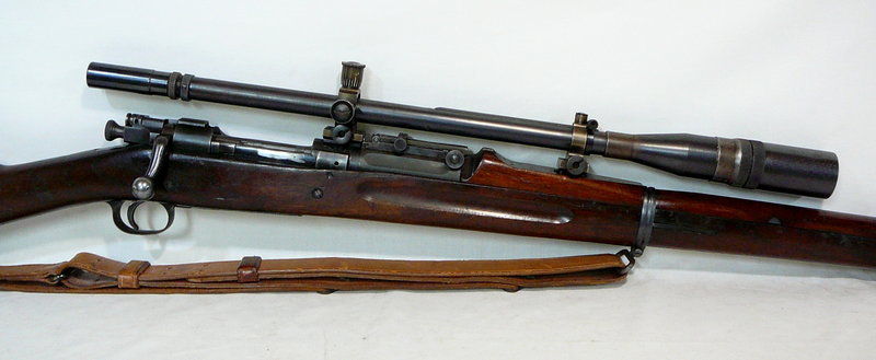

[h=2]Rifle (Sniper’s) Caliber .30 M1903A1, W/Telescope, Sighting, Unertl 8X[/h]
Cplnorton: I've seen a heck of a lot of M1903A1 sniper versions, but Sir, that I believe is the best one I remember seeing.
Mine is sort of beat up compared to some of them. There are some really nice ones out there. Nicer condition wise than mine. I keep a log of them, by serial numbers and detailed pics of each rifle.

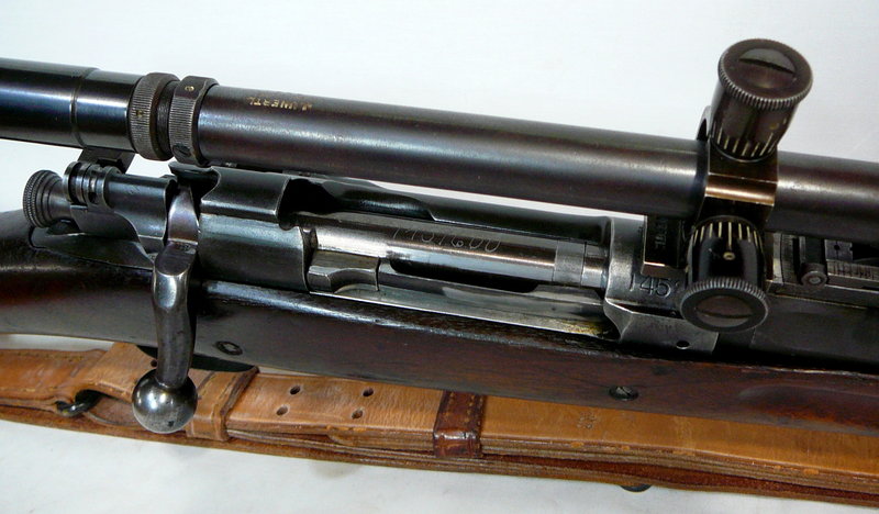

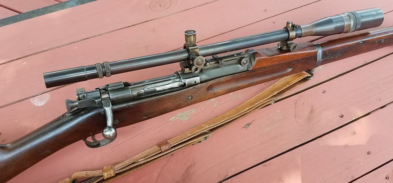

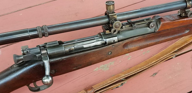

I did take some pics of my rifle outside today. Inside under the photo lights, it looks a little nicer than it does in person. It's actually sort of salty. But I like them that way. I want one that was used, not sat in storage somewhere.

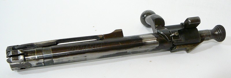

By the way because I know people will look at this. That bolt is fully blued. But when it gets in light outside, the finish almost becomes transparent. It's so funky how it reacts to light. But that I think is because they were NM polished bolts that were hot tank blued. It makes the finish almost a watery finish.
In fact it's interesting when you look at WWII pics. Look at the bolt handle, they always appear in the white. But then look at the bolt bodies, they are always dark. I can recreate this type of photo with mine in black and white. Excuse the kids picnic bench it was accesible and adapted for use. :)
I've included a pic of the bolt too, so you can see it's fully blued. Even on the handle.

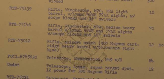

But there is an issue with this. In late 1944, the Marines authorized 371 Model 70's to be sold. Which it's those 373 from 1942, but I'm guessing someone "Acquired" two in between 1942 and 1944. Now there could have been an order later to stop this later. But usually when something is approved like this, they generally didn't stop it.
Here is the order.
See WRA pretty much shut down production on the Model 70 for the war and the only real rifles sold in 1942 were for the military. The commercial 70 guys tell me that WRA picked back up with them at wars end and basically completed a lot of the receivers serialed in 1942. So you could have 1942 serials sold in say 1945. But I am relying on them for this. I don't study the commercial model 70.

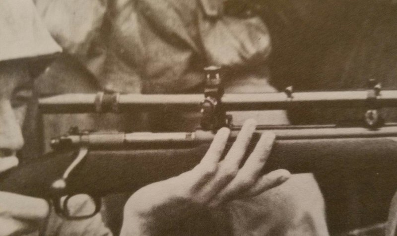

This is the only other New evidence I can deliver. This is from Andrew Stolinksi. This is the complete rifle team counts for the move from the Philly Depot to Albany in 1954. When Philly closed the RTE shop was moved to Albany. This is the inventory list of all the RTE stuff being move. So this is ALL the Model 70's the rifle team had at that time. So the 373 above, even if they didn't sell them, it seems the rifle team never got a lot of them.. The .300 magnums would have been new, as you can't rebarrel a 30:06 into .300 magnum. I think it reguires new bolts and everything else. Also that NRA light, I think that is a NM model 70. Which those were only sold post WWII, like in the late 40's.
So if anyone can add or make more sense of these, pleast do so. The one intriguing thing, I do have a team model 70 picture with rifles that have heavy barrels in the white and marksman stocks taken in 1954 or 55 or something. I imagine those are the rifles below. How they morphed into what we see in Nam, no clue. And all the details that you can clearly see in the Nam photos, those rifles are like 1942 or earlier. They have early features like the bolt safety, or the reciever tang, or even the sporter stock, that were discontinued after WWII.
So yeah I would love to know, but all I have is speculation and these two new docs to offer up. That maybe someone can add to them.

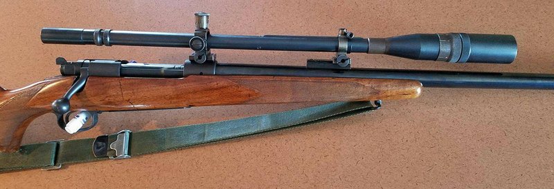

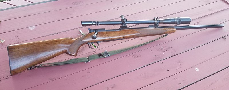

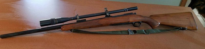

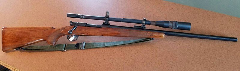

I have a M70. It came from a famous Marine Colonel who supposively got it in 1971. He would have had the ability to get one I believe. The only thing I don't know. The reciever if it was a real USMC receiver, or say he got a commercial rifle and had USMC parts put on a commercial receiver for him at the RTE shop.
The rifle though is exactly what I would think a USMC M70 would be, and I really don't doubt all the parts on it are USMC. I'm just not sure on the receiver. But the serial is in the 50,xxx range. The bolt is a mismatch and like a 41,xxx. The barrel is a WRA and dated 56 on the underside. The stock is heavily sanded and looks like lots of coats of handrubbed linseed oil. All the metal has been refinished. The bolt/receiver/trigger group is all black oxide. The barrel is a reblue.

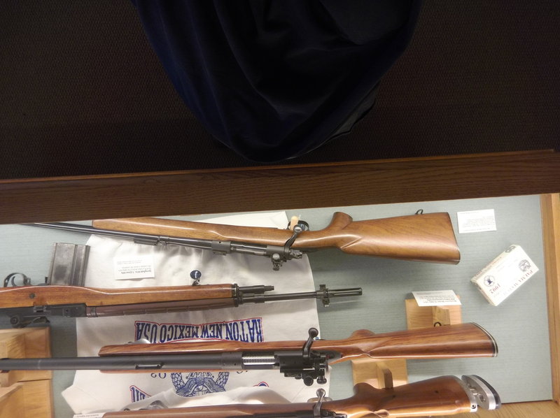

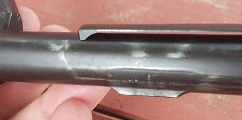

I had put this collage together when I was trying to study finishes. I was trying to see if I thought the NAM rifles had been refinished. But this is a good comparison shots of the Safety's. Every pic I can really distinguish in the NAM pics seems to have this type of safety I believe.
Here is the barrel channel on the stock. The top pic is what it would have been originally. And the bottom pic is my stock. It's not Glass Bedded, but I have a report written by Colonel William Dickman who ran the Reserve Sniper School and he said none of his rilfes were glass bedded. So I even wonder if all of the ones used in Nam were glass bedded is true.

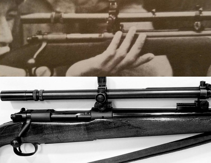

This is interesting. I'm not sure when this might have changed, but my safeties on all Win 70's was on the right rear of the bolt. Both pre and post '64's.IMG_20170521_124622716.jpg
[IMG2=JSON]{"data-align":"none","data-size":"full","src":"https:\/\/www.snipershide.com\/shooting\/core\/image\/gif;base64,R0lGODlhAQABAPABAP\/\/\/wAAACH5BAEKAAAALAAAAAABAAEAAAICRAEAOw=="}[/IMG2]
Save
Save
I have the Roger Rule book on Model 70's which is considered the bible by Commercial Model 70 collectors.
There are 3 variations of safeties. It says the type I is the safety like mine above.
The type II came out in Feb 1943, but wasn't fully instituted till 1947. I'm not seeing the changeover to a Type III. But the type III is the most common seen, and the type II was not around very long. I know like all the US Property model 70's from the 50's have the type III.
I alway look for the safety type in model 70 photos as it's easy to spot and dates the rifle to at least pre 47. The bolt I should say.
I think even Senich or maybe Senich and Poyer even cover the safety types in their sniper books. If I get time I will look and see what they say, but I remember a reference to them even in their books.

About 1950 the USMC rewrote their specifications for a sniper's rifle. At that time they proposed two main objectives shift the basic type of rifle to the M1 a
nd 2. drop the target scope which had been problematic in combat.
Ultimately they came up with the MC 1952. Which was basically the USMC version of the M1C. In the early drafts of the specs the new scope was identified as the "Stith Bearcub". The final version was the Stith-Kollmorgen 4XD. This scope with a modified version of the Griffen and Howe double lever side mount was adopted as the MC-1.
In 1958 Kollmorgen optical was aquired by Redfield of Denver, CO.
The next time the USMC would consider a major change of rifles and scopes was during Vietnam when they adopted the Remington 700 with a Redfield 3x9 Variable
The M1952 Snipers are the ones that confuse me the most. I have the trials on them, and my first real mention of a completed rifle is Oct 8th 1953. But then I have mentions that they weren't getting them till late 1954, or early 1955. So it doesn't make any sense. If you go by the serials of the 1st style Kollmorgen scope, it appears they had almost a 1000 of those Kollmorgen scopes. And that doesn't figure in the 2nd batch of Kollmorgen scopes that don't have the MC serial. But the Army was trialing the USMC Style Kollmogen as well on the M14. They bought from Kollmorgen the regular Bear Cub, and then also the USMC style with the Audible clicks. So the Army had the USMC style Kollmorgen too. So I can prove now that Audible Click USMC Kollmorgen wasn't just USMC any longer.
But it really doesn't appear they ever had that many M1C's. See in peactime they usually only averaged 60 per Division for snipers. In Wartime they say a 100 per Division. That isn't many rifles.
But it seems the M1952 snipers seem to disapear before the Vietnam War. I know the Marines did ship some M1C's to SA in the early 60's. Like 1963 or 1964. And my buddy is good friends with Jim Land and he asked if he ever saw a C in Nam, and he said no.
Then to really muddy up the mix, I have a American Rifleman article from 1965 that had a really great sniper history article. And their info is extremely accurate on the 1903's. But they say the M1952 sniper was experimental. It makes it sound like they were never used.
I don't know. A documented M1C from the Marines is at the top of my want list. The Gold standard on them is the ones from the Quantico Museum around 1970. But just knowing how Museums acquire stuff, I'm a little leary of those.
If anyone has anything to add on them, please do so. The M1952 sniper is one that other than test reports and a few pics. I don't have much info on them.
Oh something I forgot the Dept of the Navy did ship a little over a 100 M1C's to Vietnam Early for the Military Assistance Program. And I wondered if possibly those might have been Marine. But who knows. The Navy might have had some M1C's as well.
We have dug deep in the Archives looking for info on these and they are a ghost. This is that 1965 American Rifleman article below. It makes them sound like they were only experimental.
As accurate as the article is on everything else. Which it's HIGHLY accurate. It makes me wonder if it was the program we think it was. I mean they didn't really have a active sniper program between Korea and Vietnam. And you see that as Vietnam started. They didn't have hardly anything set up.
Heck I just wrote a article on the M1C for the Garand Journal that will be coming up. The M1C was sort of a failure from the start. The M1D was considered a much better design even in 1944 before the M1C went into production. The decision for the M1C seems political honeslty.
So maybe it never became the program we think it did. And to further add info, I have documents from 1951 that the Marines were having a horrible time acquiring M1C's from the Army. They couldn't get them.
So I don't know. Something doesn't add up.
