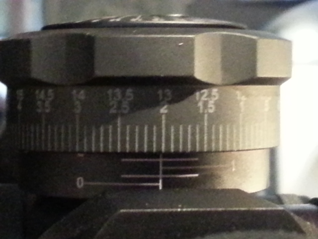

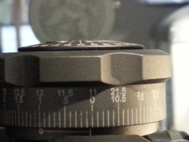

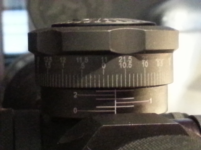

I thought I had this thing dialed last week at the range. I just realized I only have 13 mils of actual reticle movement. The allen screw on top will not rotate CCW anymore ( I believe this is what moves the erector? ) The EREK knob will keep turning of course, however, when looking in the scope while doing so I can see the reticle stop when I hit 13 mils.
First question, is this typical? I was under the impression I could get 25 or so mils of elevation. Maybe I have this thing way out of whack?!?!

did you see the instructions on their website?
U.S. OPTICS - Instructions
I had problems with their 1-6 w/erek knob when i first got it too. I didn't know about how the internals worked (especially when comparing to setting and adjusting other scopes). but after seeing this vid, and adjusting it properly...it works well. Good luck
I watched the video a few times. It says to bottom the erector screw by turning it CCW while holding the EREK knob. Then to bottom the knob all the way. I had this applied and had to come up lots to find zero.
As the scope sits, I can't move the top screw CCW anymore - it is maxed out. I have a 100 meter zero right now. So, in theory I should be able to dial up some elevation with the EREK knob, then bring the reticle back down by turning the top screw CW. This should shift the position of the erector relative to the reticle, giving me more elevation, correct? But then won't my EREK knob index be out of whack in relation to the index scribed on the scope body?
Ignore the engraving under the knob. It is only for reference. What base are you using? Flat? 20 MOA? 30 MOA?
As it is right now, does the knob stop at your 100M zero, or will it keep going down past it?
The EREK system will not give you anymore elevation or defy the laws of physics. What it does is allows the erector assembly to move independently of the elevation knob. If you have your 100yd Zero and you have 13mils of elevation travel; that is what you have. No amount of fiddling with the knob or allen screw will change that. If you want to reclaim more of the travel to elevation then you need a higher canted base. Simple as that.
