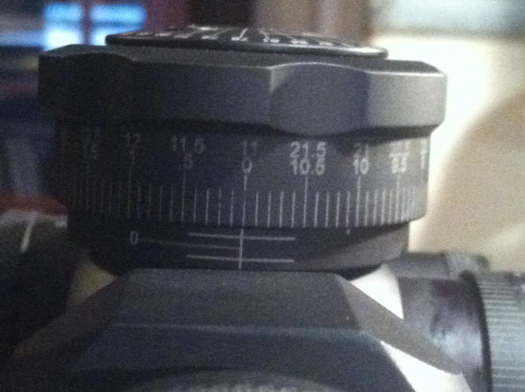

Scope is NIB, mounted, zeroed @ 100 yards. After achieving zero, I noticed that my turret knob is considerably higher than the zero index on the scope.

See image below.
I guess my concern here is I must be losing a bit of elevation out of the EREK knob with it set up this way. What changes ( if any ) can I try to have my true zero match the zero index on the scope? Right now I must be 70 clicks above the zero line on the scope, this is my true zero at 100 yards.

70 clicks is less than one rotation of the turret.
My new ER25 just came in yesterday and looks a little high as well. I'm not too concerned as USO hasn't been putting horizontal index lines on for long and I need to determine the relevance of the markings once I zero Friday.
USO has historically sent scopes boresighted assuming a 20moa base so you should have plenty of up left if its in the ballpark.
I always turn mine all the way down until they stop, click up a mil, set turret to zero, then boresight and fine tune the zero with the center socket head only, holding the turret in place. Has always worked for me.
