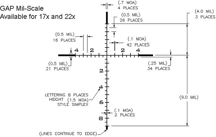

MDMOA is based on 1 line = 1 inch per hundred yards instead of 1 MRad.
ETA: If you just want lines instead of dots then you'll want something like the GAP reticle, which is still based on MRAD.
Re: USO Reticle
So on the GAP reticle is 2 equal to 1 mil(on a standard mil-dot reticle)?? Which would make each subtension 1/4 of a mil??
And if so then how many mil's are one line on the MDMOA equal to?? Or does it not interpolate??
I am basically looking for an easier way to estimate the amount of mils on a target. Tom.

<div class="ubbcode-block"><div class="ubbcode-header">Originally Posted By: JRose</div><div class="ubbcode-body">Each subtension on a gap reticle is .5 mil </div></div>
That seems to me like it would make estimating the number of mils that a target is tall--much easier than the dots?? Just an opinion.
So by your explanation then the #2 on the down crosshair represents 2 mils?? Thanks, Tom.
Re: USO Reticle
In 17x, you can also get the Canadian Mil Scale, which is pretty much just a mil dot reticle with hashes instead of dots. On the top and right it's broken down into .2 mil hashes.
If you wanted to convert the MDMOA reticle into mils, then each hash would be approximately .28 mil.

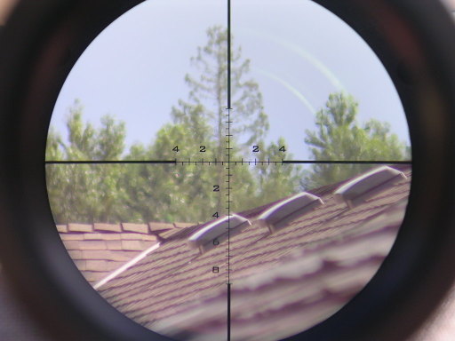

Hi,
Does anyone have a photo of what the mil or moa reticles look like on a 17 or 22 power? The figures on the USO site all look like they come from a low mag. scope (they show a high number of moas/mils on their axis).
Looking towards a ST22 but can't decide on the reticle type.

Re: USO Reticle
<div class="ubbcode-block"><div class="ubbcode-header">Originally Posted By: Flying Dutchman</div><div class="ubbcode-body">Hi,
Thanks!
BTW: Sorry Hogghead, don't mean to hijack your topic. </div></div>
try here.... http://www.snipershide.com/forum/ubbthreads.php?ubb=showflat&Number=136130
in the future, try using this... Snipers Hide Search Engine

Oops, yeah, sorry, thinking of the PCMOA. regardless it ain't mils.
Consider a Gen II mildot. It has 0.2 diameter dots and a line at the 0.5 MRAD position.
So..
0.1 MRAD is half a dot
0.2 MRAD is a whole dot
0.3 MRAD is center of dot to halfway between top of dot and line
0.4 MRAD is top of dot to line
0.5 MRAD is center of dot to line
0.6 MRAD is bottom of dot to line
0.7 MRAD is center of dot to halfway above line and next dot
0.8 MRAD is top of dot to bottom of next dot
0.9 MRAD is center of dot to bottom of next dot
1.0 MRAD is center of dot to center of next dot
This way the only thing you have to subtend with your eye is the 0.3 and 0.7, and all that requires is that you're able to envision halfway between the hash and the top of the dot. Pretty easy, all things considered.
