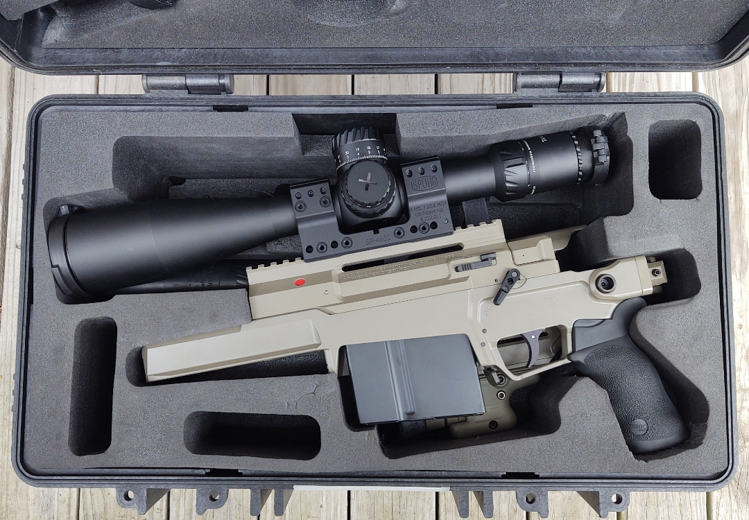

    Voere X3 could likely fit into that set of requirements with minimal mods. As its a Cheytac sized action that converts down to .308win and is close to required weight specs.
    Otherwise DT HTI with some mods and bolts for 300NM is most likely to fit the bill.
    But you know Desert Tech seems to be out of favor for defense contracts due to whole polygamous mormon sect funding thing ,sect that plead guilty to 1.1billion fraud scheme.

    Most likely, Sig has developed a Cross that fits this spec and they’re gonna slide in and be the sole submission. Seems their whores are better than Reed Knights whores these days…
    I think its going to be Barretts to Lose. Makes too much sense since they already run the Mk22.
    Bassically change out the caliber and put a shorter/thinner barrel on it. Something like a 33 or 37 XC to keep recoil down. They share the same bolt head with the 300nm, which is going to be a requirement anyway.

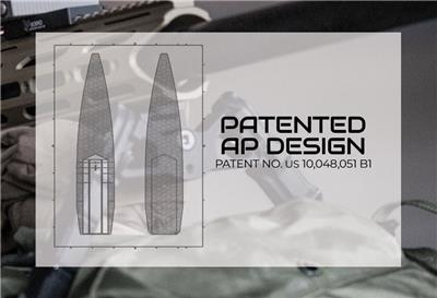

    Cutting Edge seems proud of their patent, with some dubious claims, which even claims that it is an advantage: "When the projectile strikes armor plate, the projectile body, starting at the tip of the front end, hits the plate and begins to disintegrate creating heat. The projectile body material completely disintegrates which softens the plate surface slightly and makes it easier for the hardened internal core to penetrate the plate."
    Regardless of what is written in the preliminary part of the patent, what is relevant in a patent is only the "claims", and in the case of US 10,048,051 the only patented part is the linear grooves inside the cavity devoted to allow air to exit when inserting the core.
    Otherwise, they'd just tried to patent the 8 mm AP bullet a century after it's invention.
    This goes contrary to most AP designs where lenght of the penetrator is in direct correlation to penetration performance, lets just say i have some doubt in disintegrating jacket anealing thel armor plate let alone ceramics or composites
