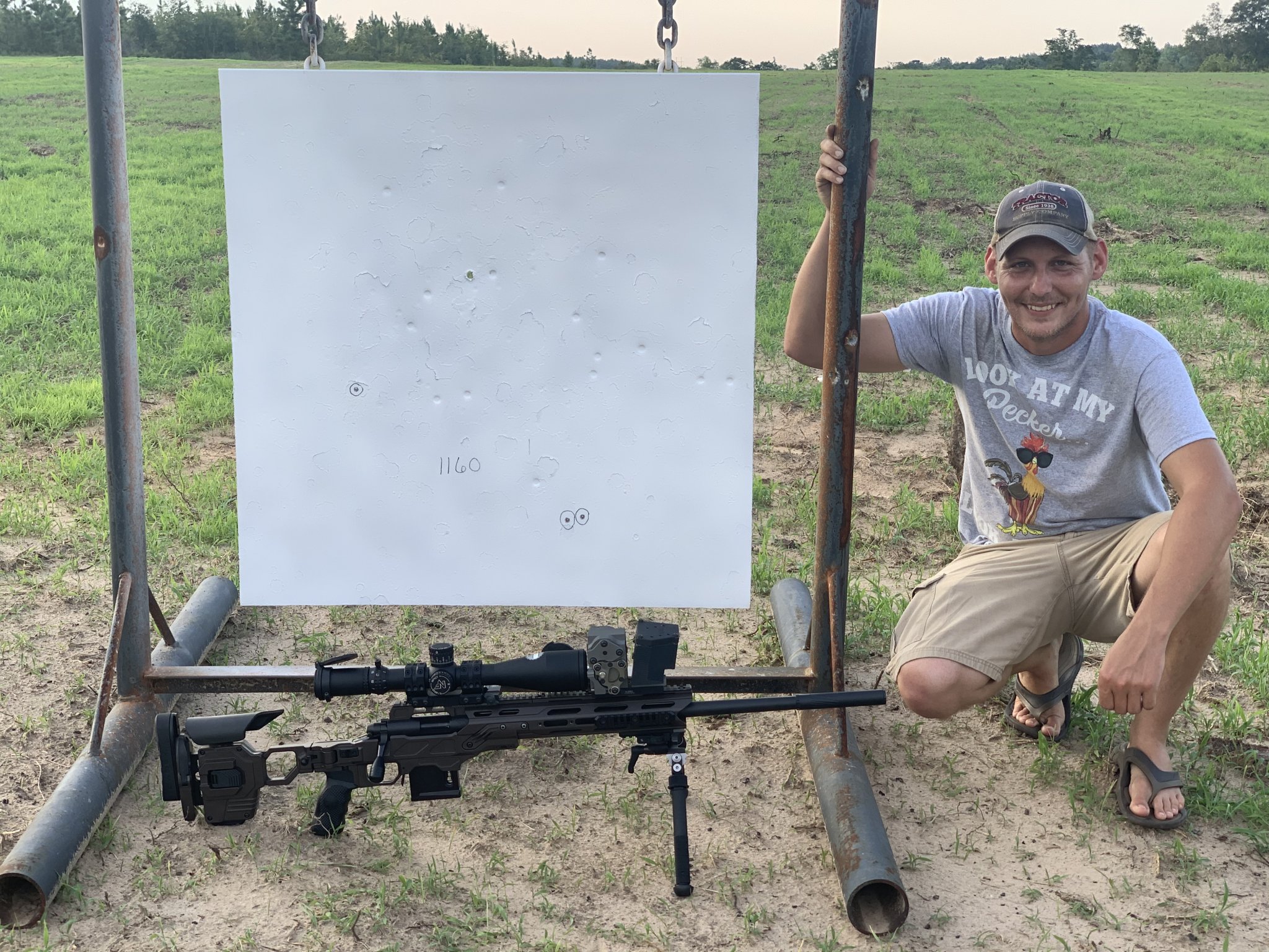

Managed to get the ol vudoo to 1160yds today!
I changed ammo from when I shot to 1004 a few months back and we had basically zero data for the new stuff so it took a little work to get it on at 1160, actually way overshot the target initially. As for spottting misses, there was forward observers helping look for them but I could actually see the splashes through the scope, once we figured out what was going on I managed to get three rounds on target from the second mag.

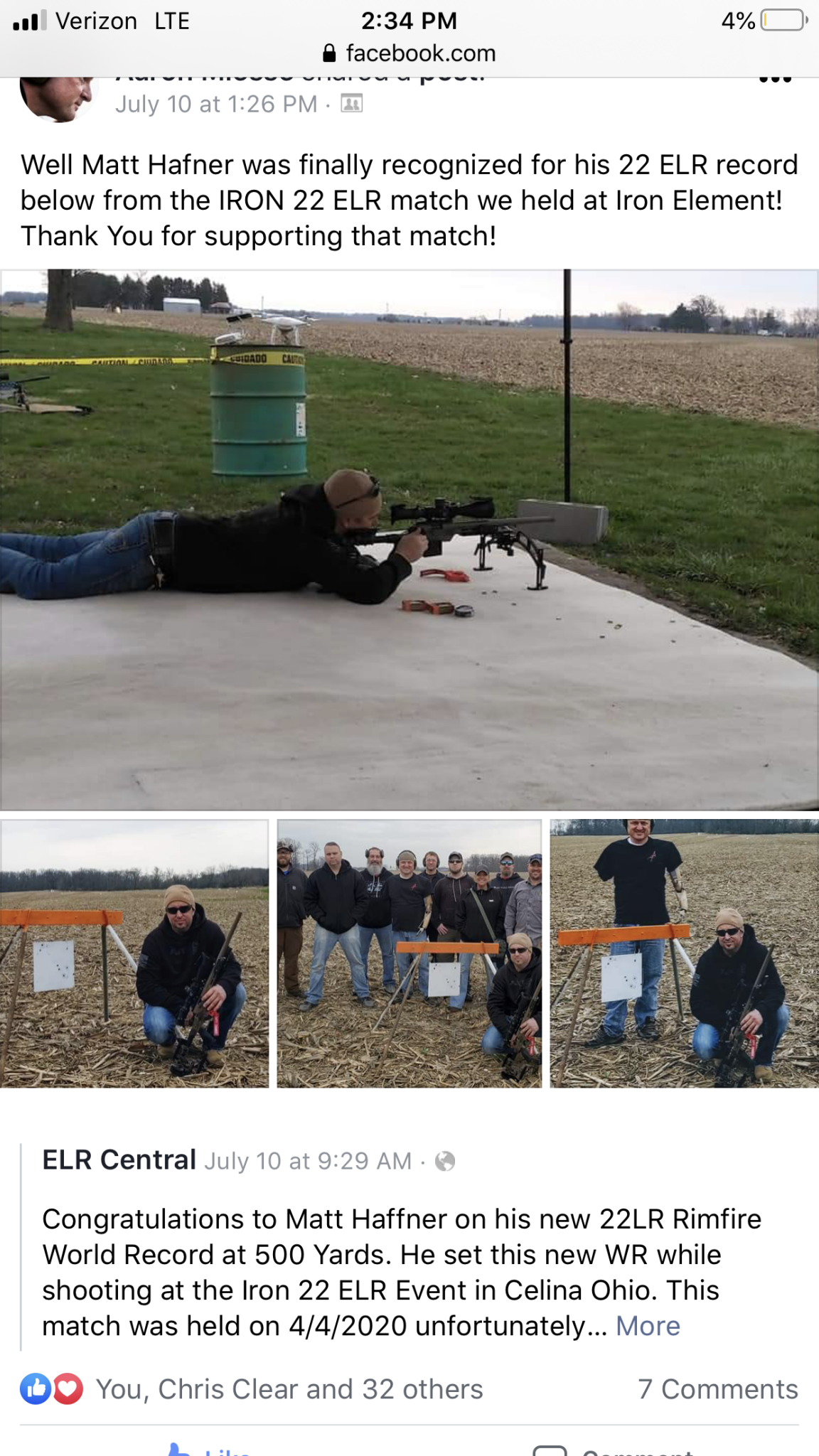

440 Yards
Congratulations to Micheal Chang on his new 22LR Rimfire World Record at 440 Yards. He set this new WR while shooting at the Desert Sportsman's Rifle & Pistol Club's 22 ELR Event.
The New Rimfire World Record now sits at... - Applied ...
www.facebook.com › AppliedBallisticsLLC › posts › th...
so not even 600 yards lol while the pcp air rifle's record is like 1400 + yards lol while other people like the guy who made this post have shot further mark and sam had a video somewhere in the 1k range there shots were not entered into the world record books not sure how that all works .
well then call the people who do the records and get your name in the books , records are meant to be broken maybe it will be your time to shine .good luck you can do it .

Yeah I actually went to 1004 and have it on video just after mark and Sam made theirs. Went 4 out of 10 that day and first impact on third shot.
