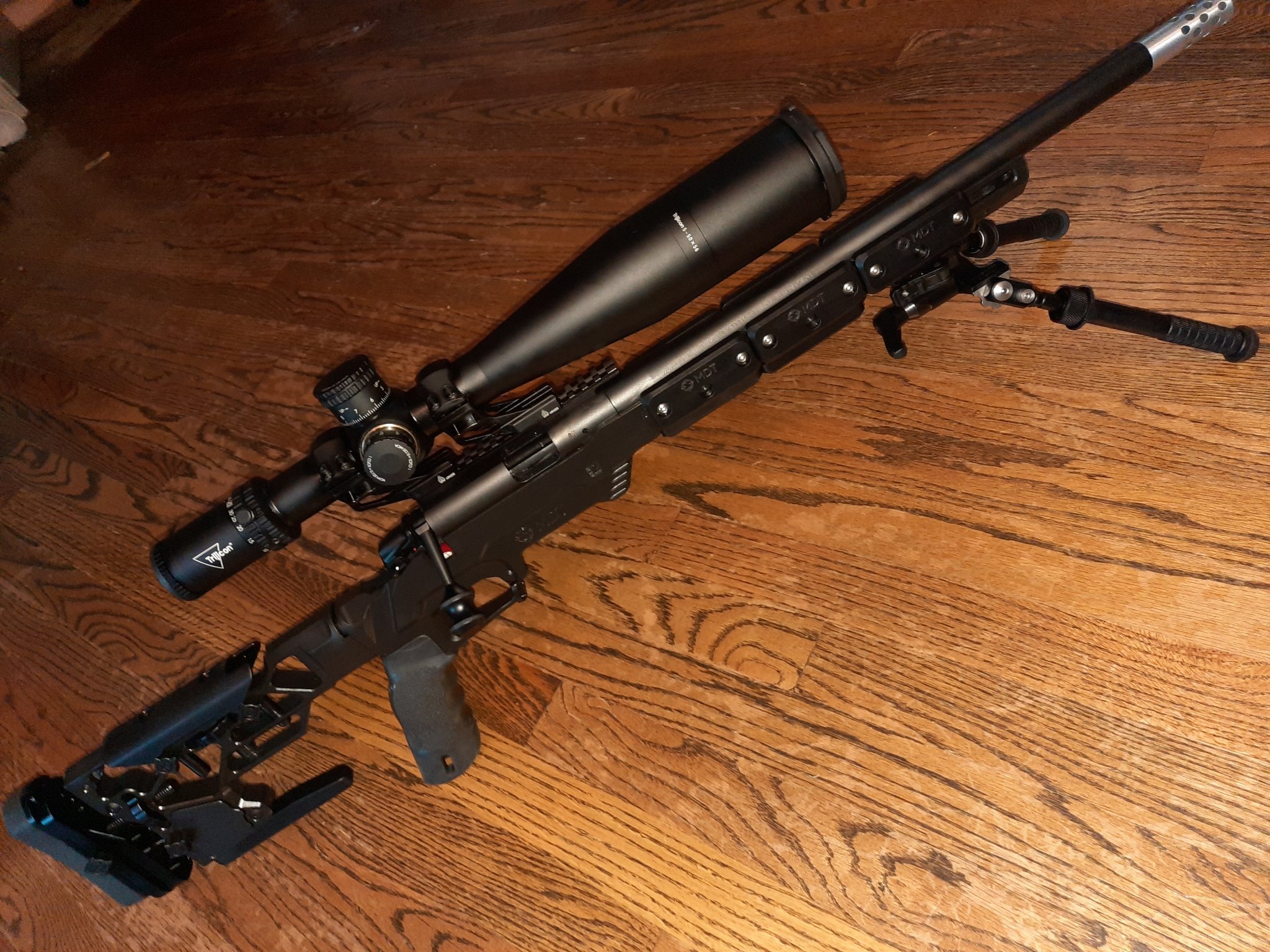

I went with the RimX because of adjustable magazine catches. This makes it really easy to get good feeding from your gun no matter what chassis you choose.
I am really happy with my choice but I don't think there is any way to go wrong with either option.

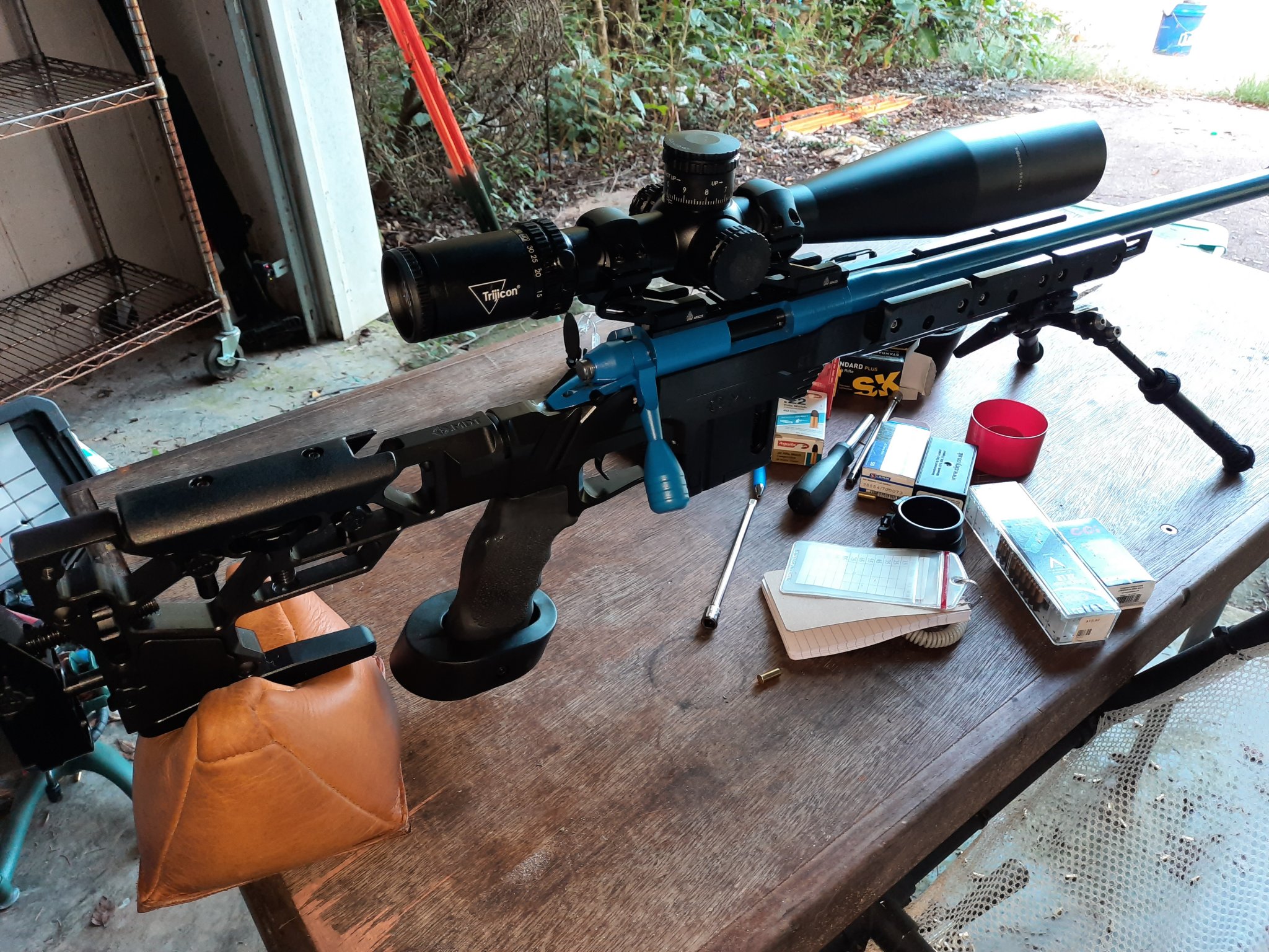

I own three V-22s - two that I barreled myself with Krieger blanks, and another that I purchased as a bbl'd action with a Bartlein in Kukri contour. I used a PTG EPS reamer on the two Kriegers, while VGW presumably used Mike Bush's Ravage reamer on the Bartlein Kukri. Based on how the Bartlein Kukri shoots compared to these two Kriegers and one on a converted 40XB - all chambered with the same EPS reamer - I'd like to have my own Ravage reamer.
Since I have no desire to own a chassis, these four rifles are all bedded in Manners stocks, and I've had no need for an adjustable mag latch - they all feed very smoothly, with absolutely no marks on the bullet noses or driving bands after chambering. Have been using the V-22 poly magazines since late 2016 when I had Jonathan Elrod convert a couple of CMP Rem 40X actions to use those mags, and have seen no wear on the feed lips, nor have I had any other issues with them. For $33 (when purchased in 3-mag paks), it's a little painful to spend $125 on RimX mags. I did buy one Vudoo 15rd aluminum mag (only because we have a match director who loves to throw stages that require more than 10rds per position at us), but due to COVID-19, haven't had a chance to use it in a match yet. If you want a plug-and-play system that requires no tinkering, and comes from the maker set up to shoot really well with SK/Lapua ammo, I'd say a V-22 is the easy choice. And as has been mentioned, the customer support at VGW is 2nd to none - I've enjoyed working with Mike, Paul, and Jill very much - it's always a pleasure to call and order something from them, or on a rare occasion when I need advice, to ask for help.
I also own five CF rifles I built on Bighorn & Zermatt TL2 & TL3 actions, and have had excellent experience with both the original Bighorn & later Zermatt customer support. The positive reports on Zermatt's RimX don't surprise me in the least - I'd have expected nothing less from them, based on the experience with my CF rifles.

I jyst bought two aluminum mags from Vudoo.
They are works of art !! I will however shoot my poly mags most of the time bc they are a
20200919_090052.jpg bit smoother. The Vudoo 500 round ammo box is very nice as well. I can nit pick any product but the V22 has been really well thought out. That doesn't mean that the Duece and RimX aren't , but I don't have one in hand to compare yet. I did just pick up a B14r and it is a very nice gun as well and well worth the 890.00$. I did hiwever swap the bolt knob out with a EGW Bergara knob. It is the same as the V22 except it has m6 threads. Super smooth and comfortable.

HI Jbell,
That is a great picture of the Center X and the Benjamin!
HI Jbell,
The black one is the Bergara and the blue one is my Vudoo in the B14R stock. The factory trigger is heavy but breaks clean. I put my Trigger Tech Diamond in the B14R and it works great. The Vudoo is slated to get a Bix & Andy with the free trigger shoe or a Jewell trigger. Any thoughts? The Benjamin was to give the photo some scale for a friend of mine. She has no idea of what two cases looks like. Small when you see it...
