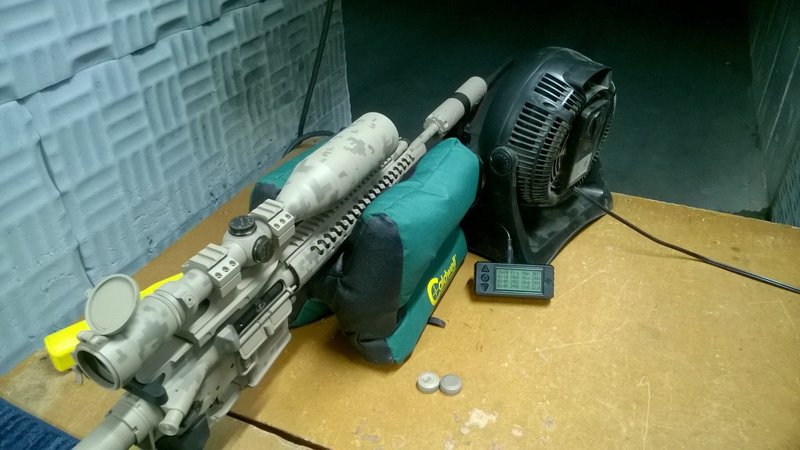

Has anyone used a Labradar on a multi-lane (maybe from center lanes) indoor range and had success?
I owned both, used them both for a few months and ended up selling the V3 due to the POI shift issues described above. Both of them, showed similar numbers and results and once I learned how to use the Radar, Ive had no problems. (Okay, getting it to register the subsonic Eley ammo on a 22 was a bit of a chore, but it eventually worked great)
I have also used them in an indoor range, right next to other pistols without an issue. Ive also used it right next to another radar. This did cause some initial issues, until we resolved the "channels" used by both were the same. After making the needed change, it worked well.
I especially liked using it for pistols, ironically, on an indoor range as it was otherwise very difficult to measure Powder Factors and set up more traditional equipment.
Just to describe the indoor rifle range a bit more where I heard of others not being able to get the Labradar to work:
It's just three lanes wide and has bare concrete on all 4 sides the entire 100 yard length. From floor to ceiling in front of the benches is maybe only 6 feet and probably less than 20 feet across. It's basically a rectangular concrete tube. I can see radar bouncing like crazy off of that. I think if the walls and celling were lined with foam or something, that would help. On wider and shorter indoor pistol ranges, I would expect it to work better.
Maybe the two guys that couldn't get them to work were just not knowledgeable about "tuning" them, but I wasn't going to spend $560 only to find out I can't make it work either.

I got my labradar to work in the indoor range to test my target 22 ammo. I ran it in Doppler mode near the ground shooting prone. It took a little time to find the right spot placement and what have ya but it wasn't anything that took more than 10 minutes of playing to figure out. Now it's easy to repeat. The eley and Sk ammo I was shooting measured right close to 1080 fps so I took the numbers as good reads. I was measuring Sd and Es anyhow.
The indoor range I shoot at is 8 lanes wide and 10 meters deep. Ceiling is about 8-10 feet tall.
