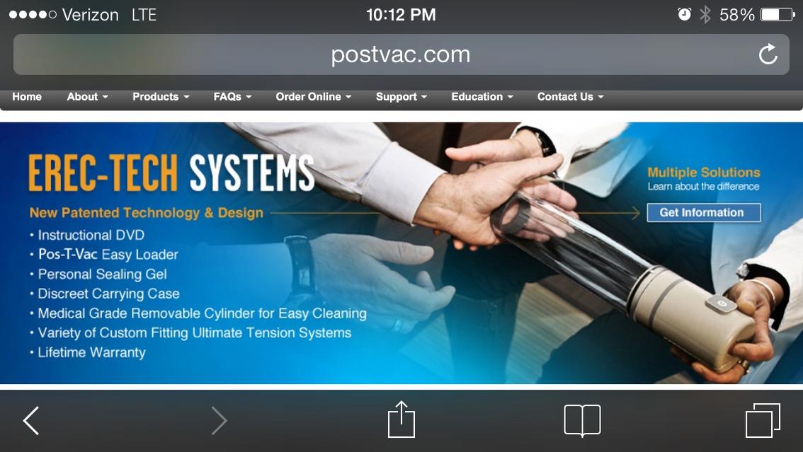

    Pos-T-Vac has what your looking for Chad. Looks like it even has a discreet carrying case
