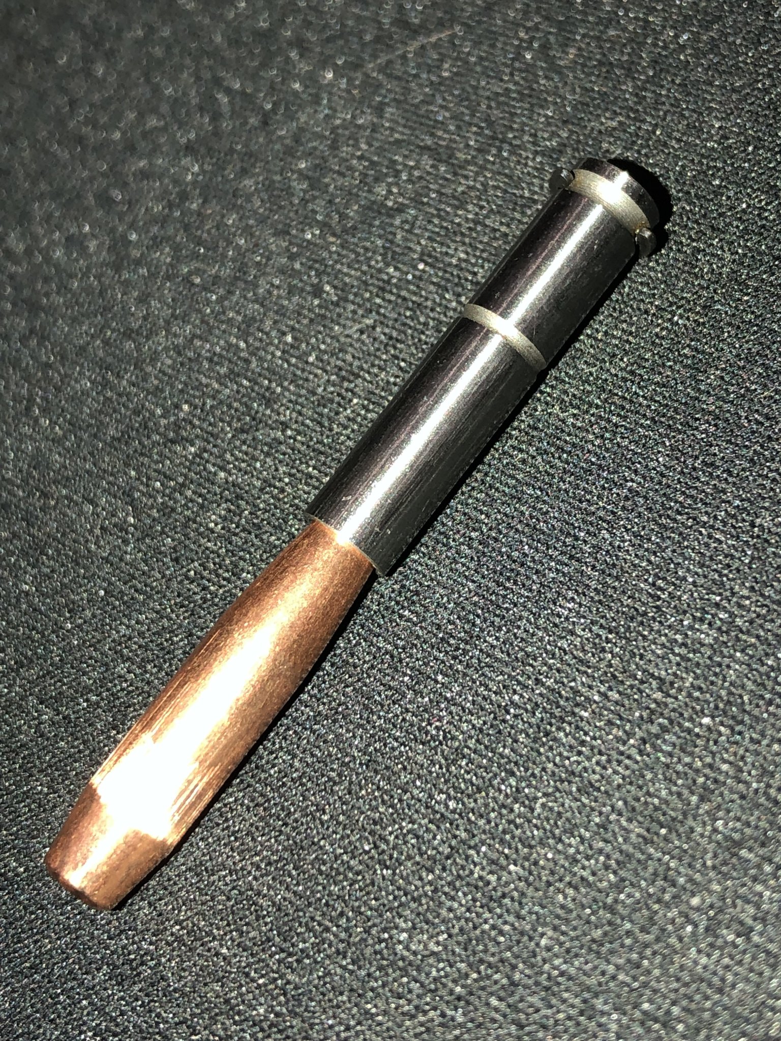

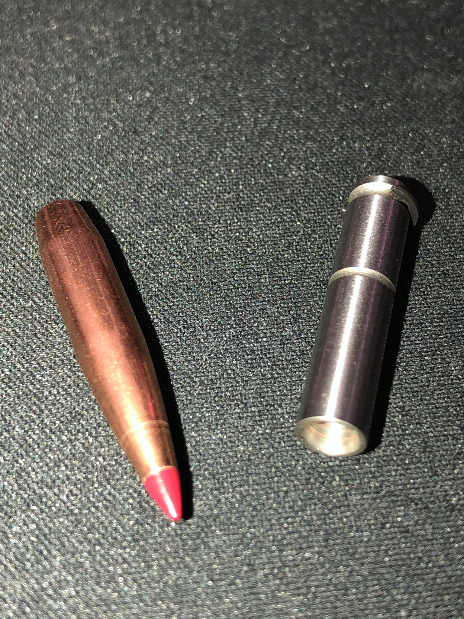

    I'll load some more in a little while, and take some pictures.
    Yes, this setup with the .249 bushing and VLD seating stem worked without issue last batch.
    Necks all chamfered and deburred with Lyman VLD chamfer tools.
    The bullets I extracted from the seating stem seemed to have no damage, whereas the original seating stem would press a very obvious ring into the bullet between the ogive and tip and would actually elongate the bullet. I'm seating just within mag length and these bullets would elongate to the point of not working in the mag. Pic:
    Ouch
    That's some ugly bullets :)
    Reflections probably make them look worse than they really are.
    You might end up sending a couple off and getting a 'Custom' seating Stem.
    I'm using a Hornady AMAX seating stem and still get a little imprint on the bullet.
    I size with a Redding body die and neck with a Lee collet die.
    I was just making another attempt to load these 88s after swabing out the inside of the seating stem. One loaded OK, one loaded but took multiple attempts, then this was the third one. The mark on the bullet cannot be felt and can only barely be seen by the naked eye. The camera and flash made it show up a lot better. I wouldn't consider it a significant issue, especially compared to the damage done by the old seating stem.

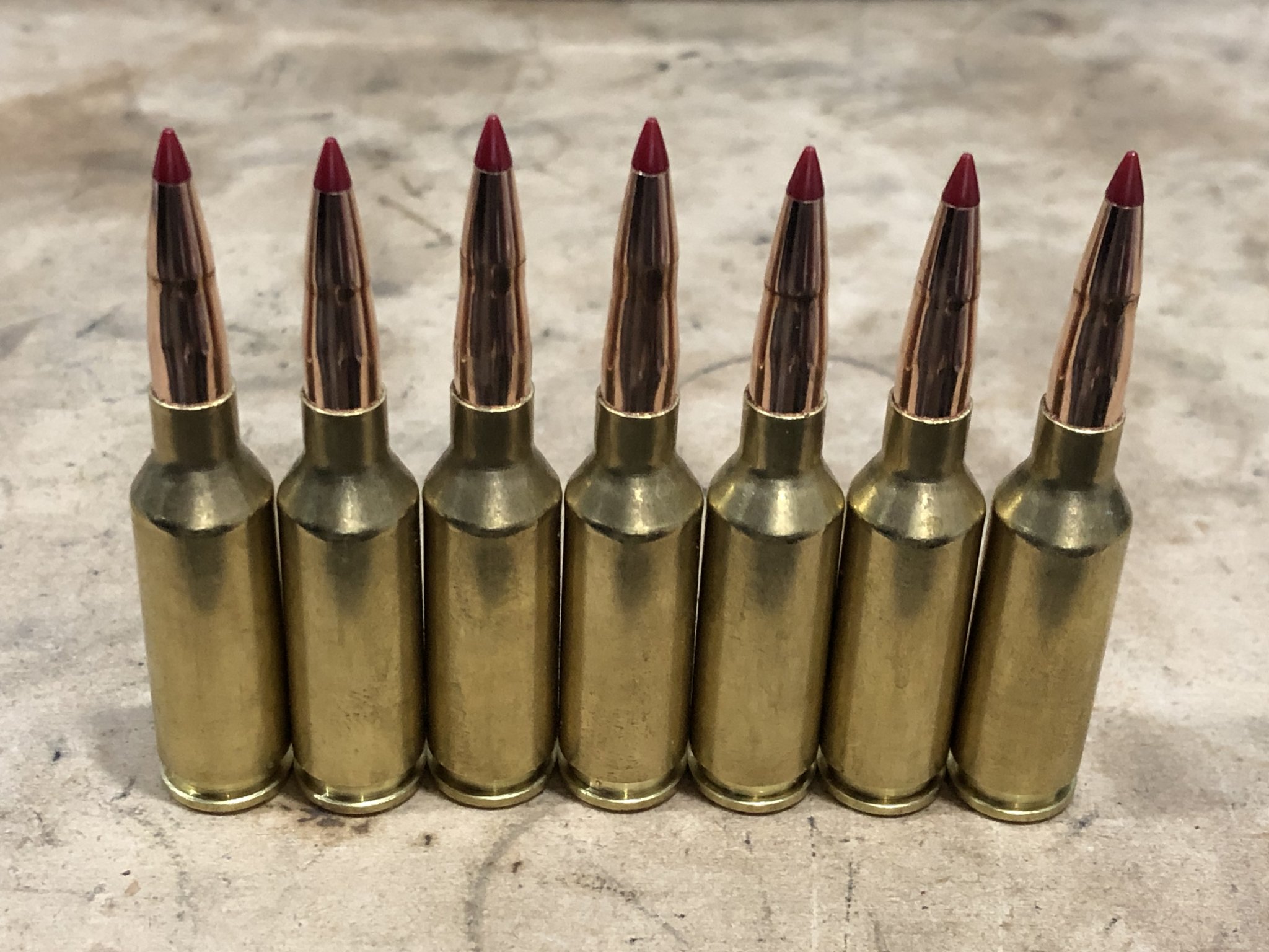

    What is the outside diameter of a loaded round?
    Does a bullet pass freely though the seating stem sleeve?
    Can you measure the inside diameter of the seating sleeve with the pointy part of your calipers? To see if it is enough or if you will have an interference fit with your round inside the sleeve.
    I have a hard time thinking that your bushing being .001 too small, alone, is enough to create a difference in force that you’re getting these issues. Take the die apart and try the individual components in them to see if there is any hanging up.
    0.252"
    Yes.

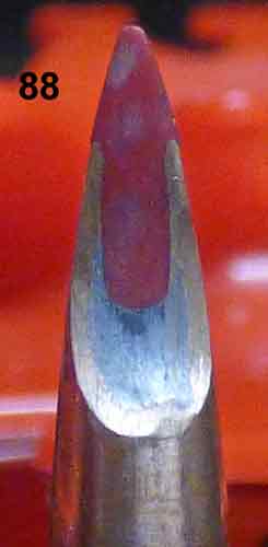

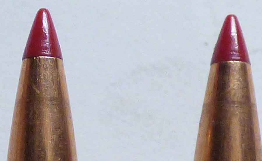

    Based on the photos it appears as though the bullets are deformed. It would take a lot of force to deform those bullets. If down-stroke seating force is low, at what point in the cycle do you apply the force that deforms the bullets? Or - perhaps I misinterpreted the photo and the bullets aren't deformed. Could that be true?
    Light marks on the ogive that causes small variations in seating depth is one thing. Distorting bullets and significant OAL variations can be caused also by compressed charges or case donuts. If changing to the Bergers eliminates the problem then it just might be a mismatched stem.
    Reactions: Changed
    You may be referring to the photo from the too-tight bushing that made too much neck tension, rather than the nearly unmarked bullet stuck in the seating stem. I've already ordered a larger bushing to fix the seating pressure deformation problem, now I'm only concerned with why this seating stem and this bullet are sticking together so badly. Thankfully, switching bullets let me move forward.
    OK, thanks for clarifying the distorted bullets.
