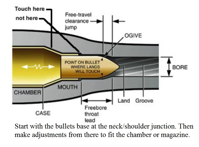

Trying to find my jam point so I can start testing seating depths.
The loctite method didn't work for me. Could barely close the bolt! And I don't own the Hornady tool.
So what I decided to do was start with the loctite measurements and seat the bullet deeper until the cartridge did not "stick" in the chamber.
Basically I would push the rd into the chamber with my finger and then tip the rifle up. If the rd stuck, I'd remove it and seat it deeper until it fell out freely.
My thoughts process was if it was stuck, it was in the lands. Once it fell out on its own, it wasn't.
Loctite measurements were 2.335 base to ogive.
"Finger method 🤣" was 2.292 BTO
Is this method complet horse shit???
Am I just wasting time, or does this seem reasonable?
147gr ELD
Lapua SRP case trimmed to 1.910
Sized shoulder to 1.554 from 1.557 fire formed
Tikka t3 varmint 6.5CM 26 in barrel

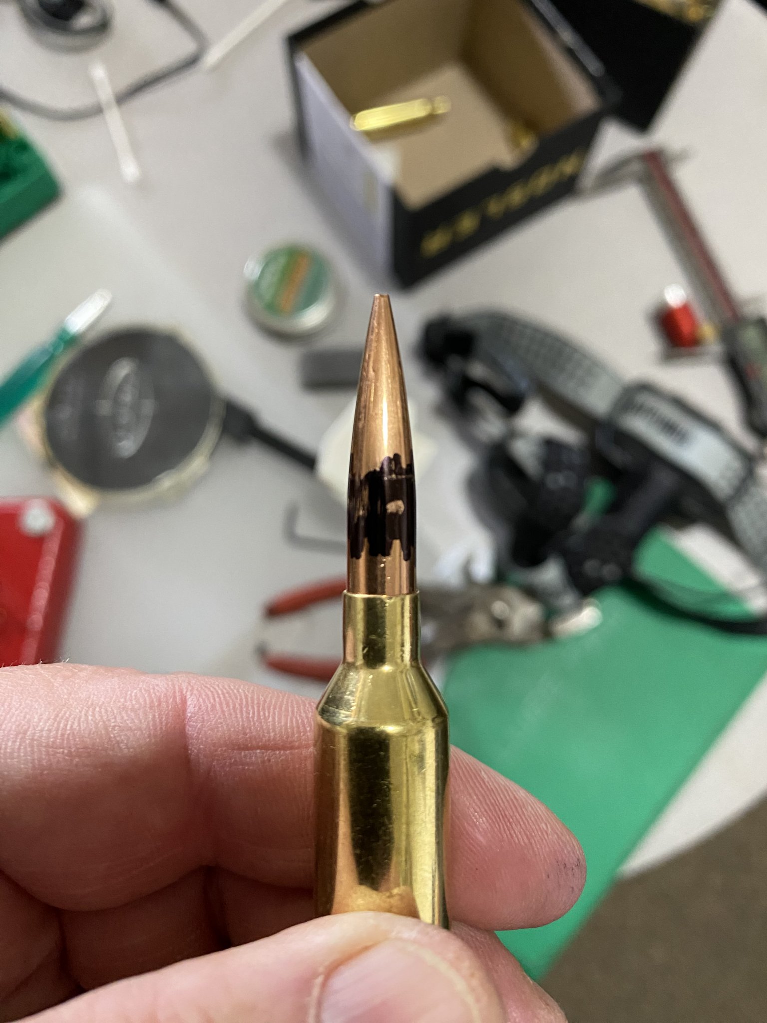

Here is another method for when you can't go get the right tools:
Start by seating the bullet and measuring that seating depth. Then "blacken" the bullet...I was taught by an old man about 5 decades ago to use candle soot but graduated to using dry erase marker. Any color will work. Chamber this round and pull it back out. Look for signs of the rifling on your soot/marker. Seat deeper until you no longer see the marks.
But....just go buy the tool.

Steal a black Sharpie from work.
Prep a few pieces of brass but do not prime.
Seat a bullet to max mag length OR longer than you think you should.
Mark up the bullet with the Sharpie.
Chamber the cartridge.
Does the bolt close? If not, extract. You might need to pop the bullet out of the chamber with a cleaning rod. No biggie. Seat a bit deeper.
Extract the cartridge and look for engraving marks.
You want this:
Land marks square, or a bit rectangular along the horizontal axis. Just kissing the lands but not jammed enough to worry about a bullet getting stuck.
Measure the OAL, comparator is preferred. This is your rifle’s max for that bullet.
Just one way to do it but it’s worked for me for years. I did this a couple of weeks ago for my brother’s new 6.5 PRC and 156 EOL.
I’d say it worked.

The ogive is what hits the lands and what measurements are taken from.
To me it doesn't matter what bullet or style is used the ogive is a zero place, aka a datum.
Everything else moves, the nose and bullet base, the case base (bto) and the lands erode.
But to me the ogive is the datum zero point, it's always zero.
If I measure carefully 3 different styles of bullets should all give the same dimension to the lands.
