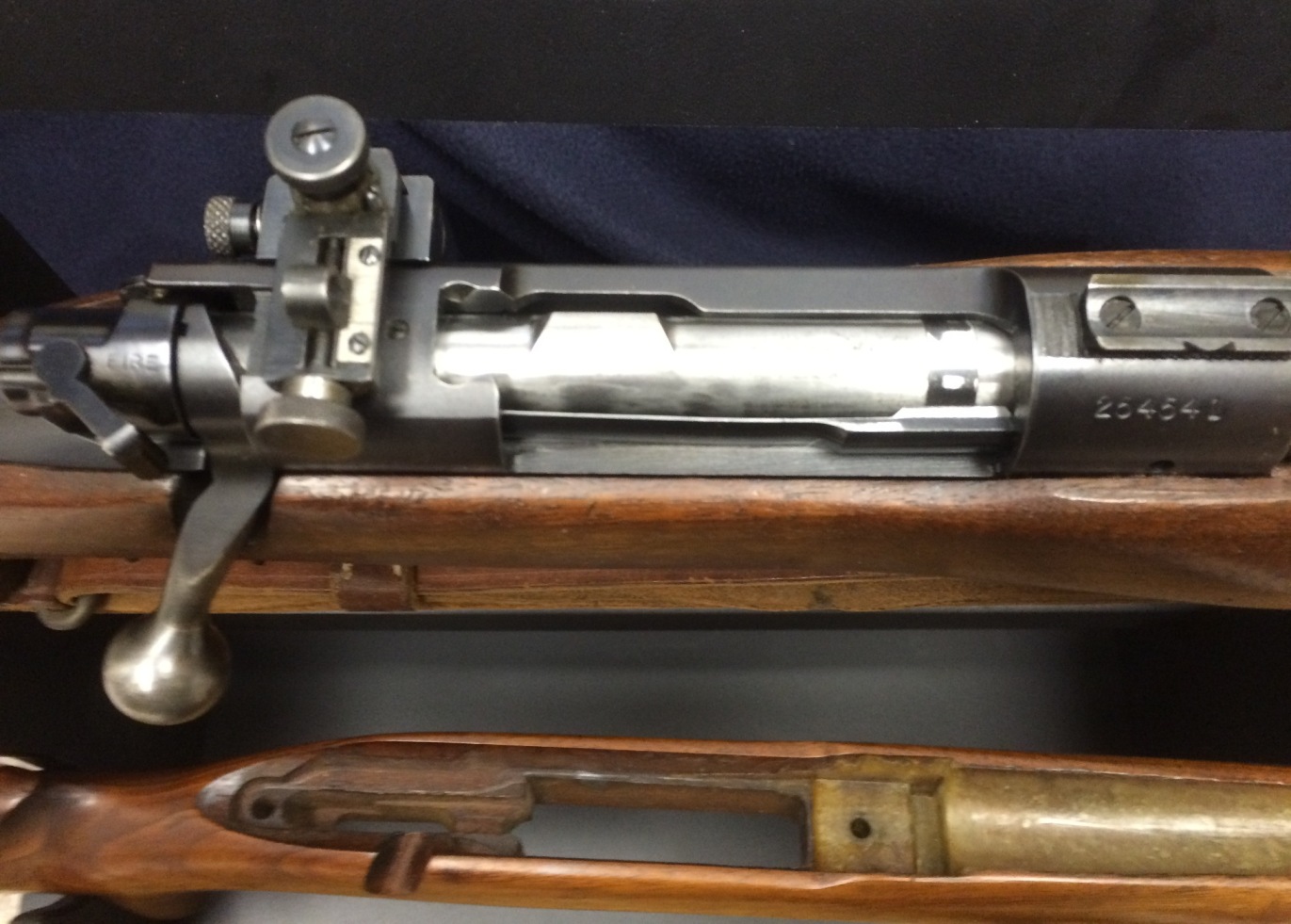

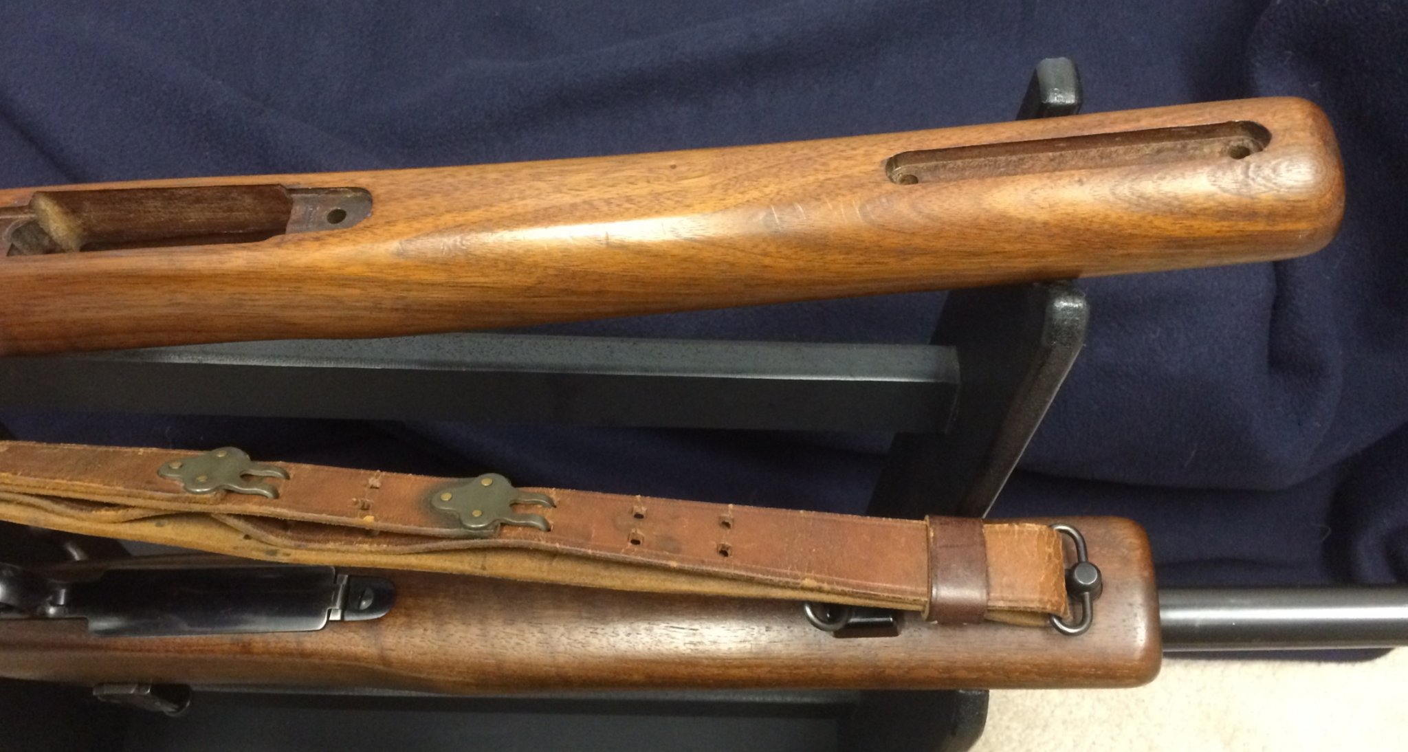

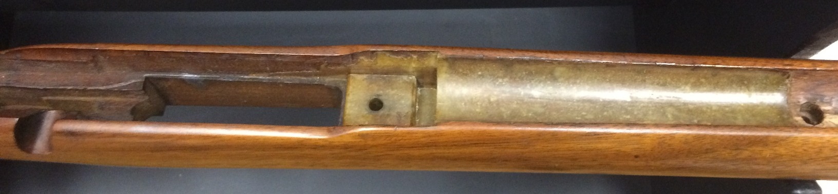

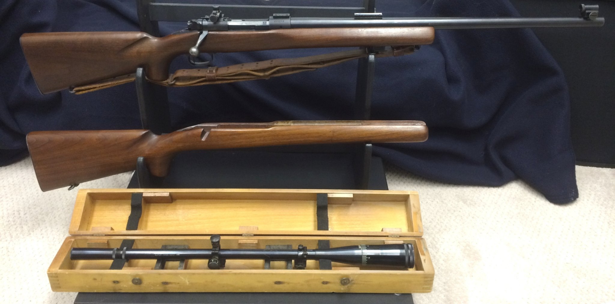

I don't have first hand experience re Van Orden's with Sporter stocks, but I am familiar with the Marksman stocked version. Attached are pics of a Van Orden sold in August 1953. It came to me with two Marksman stocks that were reportedly both original Van Orden parts. One was full dimension (on rifle) and the other was loose. The loose stock had vintage bedding that was expertly done, and interestingly, it had been sanded on the sides to reduce the overall width/profile by about an inch. That might have been done bring the rifle under the 10 lb weight limit that was in place in the early 1950s re service rifles. (The rifle w/ fat Marksman stock along with the medium heavy barrel was a little over 10 lbs). I believe this is the type of bedding was done by Evaluators, and the barrel was free-floated in front of the bedding. My local gunsmith looked at the stock and said it was the old clear "Accu-glass' type bedding from the 1950s. That's all I know. (I subsequently used that spare Marksman stock for a M70 sniper replica build w/ a 10x Unertl scope).

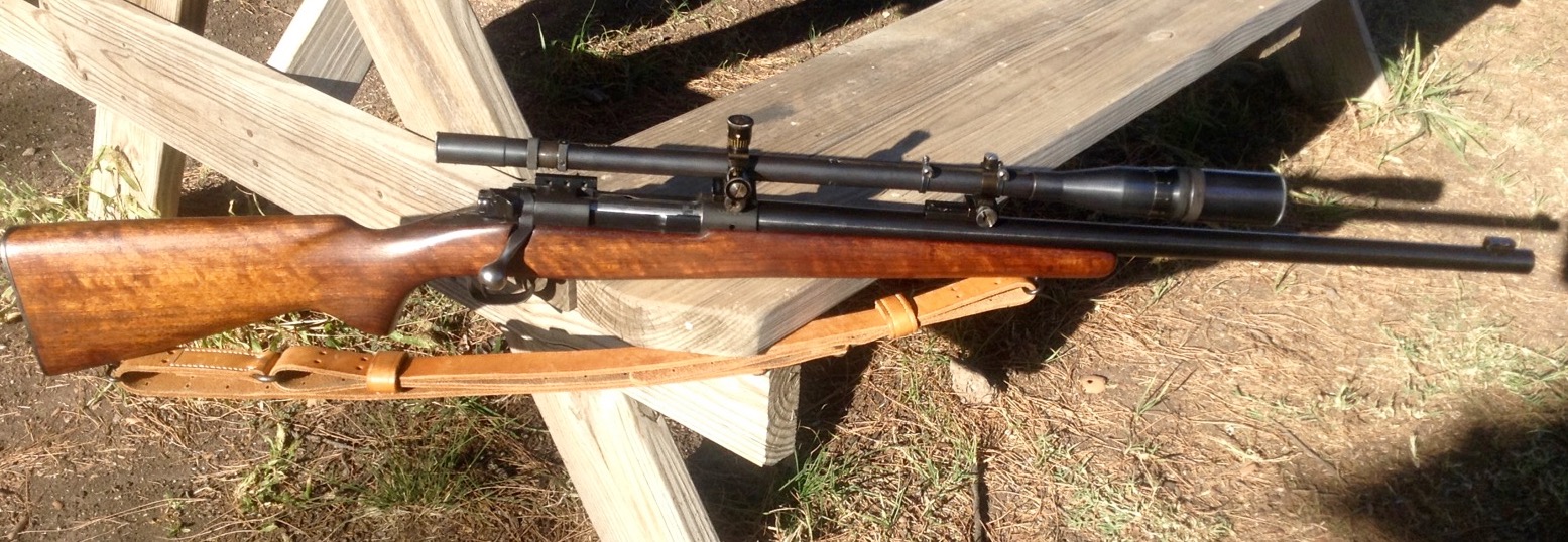

Story...? Well, I bought this gun off of GunBroker back in 2006. It was up for auction and I was deployed to Fallujah at the time. Saw it once when I had a couple mins to get online. Tax-free money burning a hole in my pocket, I thought the rifle looked good, had never seen one before, and decided I had to have it. Probably paid too much, but whatever. Maybe put a hundred rounds through it in all this time. Shoots pretty damn good. Will do no-shit MOA with old Lake City ball.
Came with a 16X Lyman Super Targetspot, box and all. Still have that but think the rifle looks better with the USMC Unertl.
Think I'm going to introduce this rifle to a deer this year. Maybe Saturday...
