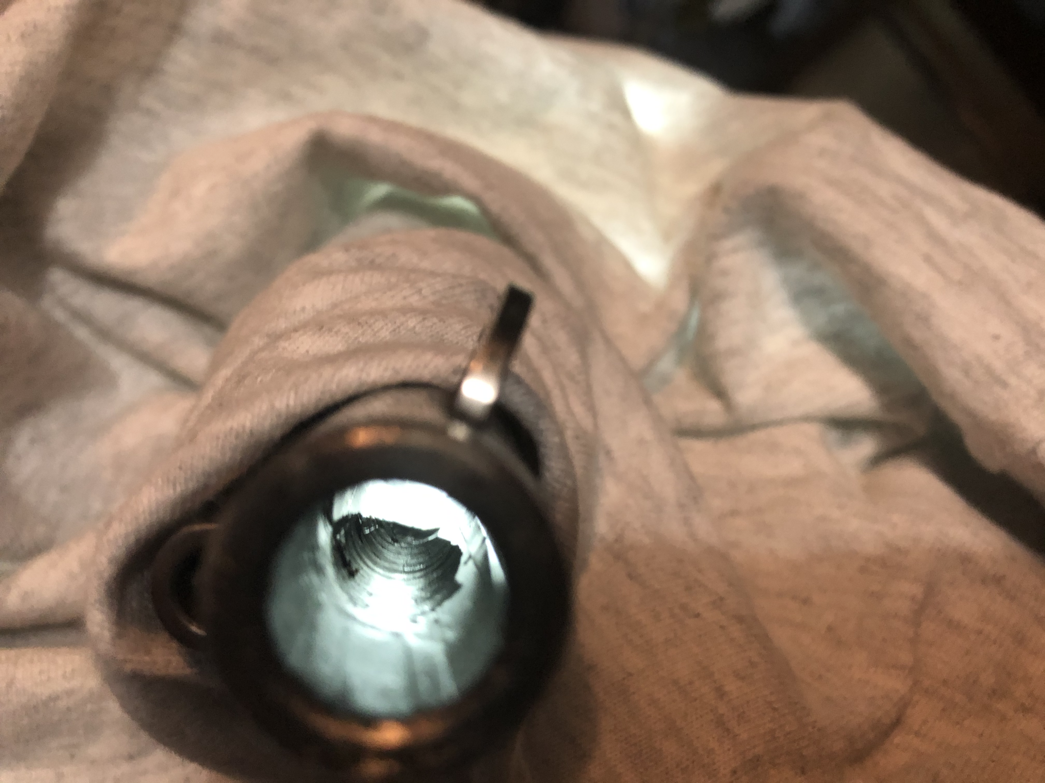

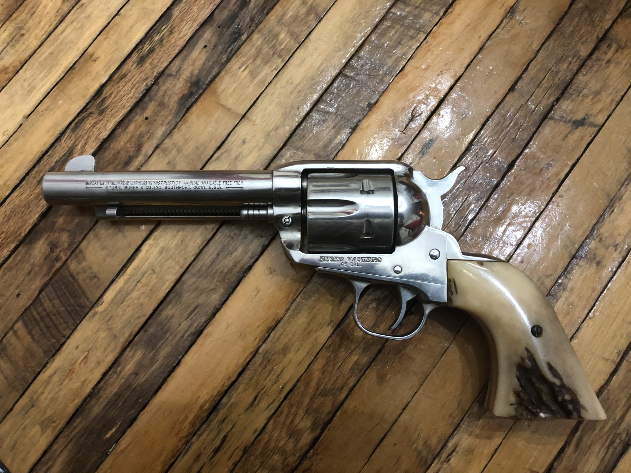

I have acquired an old style Vaquero that had a bullet stuck in the barrel or (squib)
And instead of me being patient & bringing it to a smith I tried getting it out myself, I'm an idiot and I ruined the barrel.
I can't find anyone local that can find a barrel replacement and apparently Ruger doesn't replace them or so I've been told.
It's a stainless barrel but I would be willing to go with any color or size just to get it working again.
I see some specialty barrels online but they all seem to be more than the price of another Vaquero.
Any help would be appreciated.
If all else fail's would it be safe to have someone cut the barrel down, It's a 5.5" barrel and I screwed it up about an inch or so in from the front so it would have to be around 4"

What does a job like that cost?? Tell us the truth if you can. Talk about throwing good money after bad.
I'm so mad at myself for butchering this revolver like this.
T
he back side if the gouge is right at 1.5"
What did you try do? Drill it out. I still say a recessed crown would be the cost effective way to salvage it. Contact Chad. He probably do it without taking the barrel out of the frame.
As long as the gouge doesn't obstruct the bore and you think it's safe to shoot I would try it before doing anything else. I had a damaged S&W 357 that a guy gouged the barrel just like you and we shot it and we couldn't tell a difference, it shot fine.
Yeah,
It would have worked fine but the damn drill bit broke off, Thats when it all went south.
Nothing is obstructed but the gouge is pretty deep. I'm thinking half way through the barrel.
So I thought it might blow out the bottom of the barrel.
Guess I could put it in a vise and get back about 20' with a string to pull the trigger, let one go to see what happens

Paid $180.00 for the new barrel & $80.00 for labor.
Probably have it back in another week or two.
Only stipulation they have is that they put back the same barrel length, color Etc. Which is what I wanted. But they still tell you that.
And any changes to the revolver would be put back to factory original.
