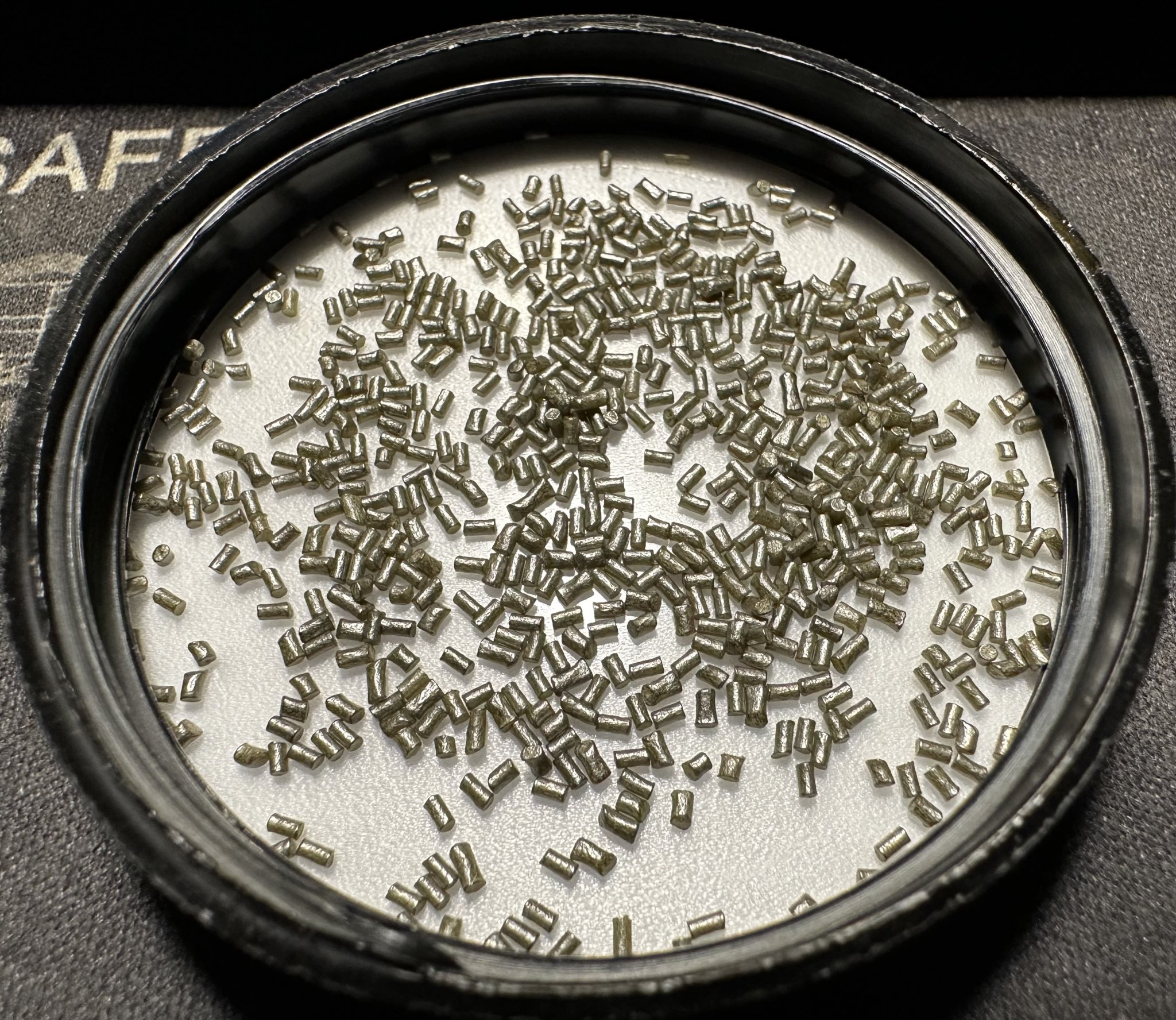

Varget kernels
flysolo
Sep 9, 2007
44
36
MN

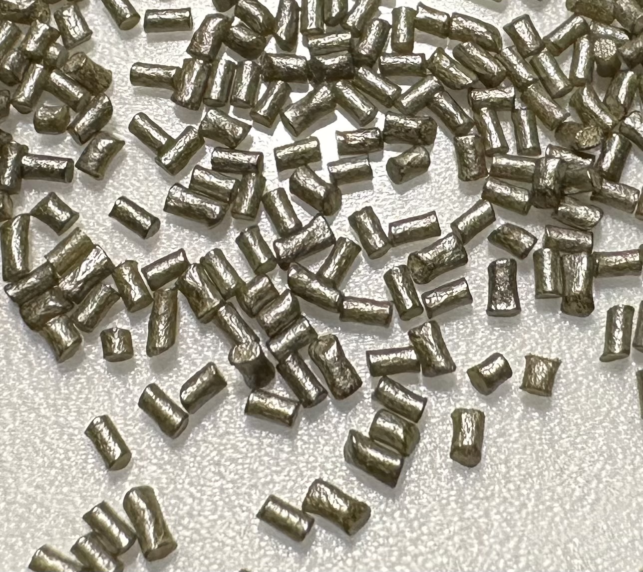

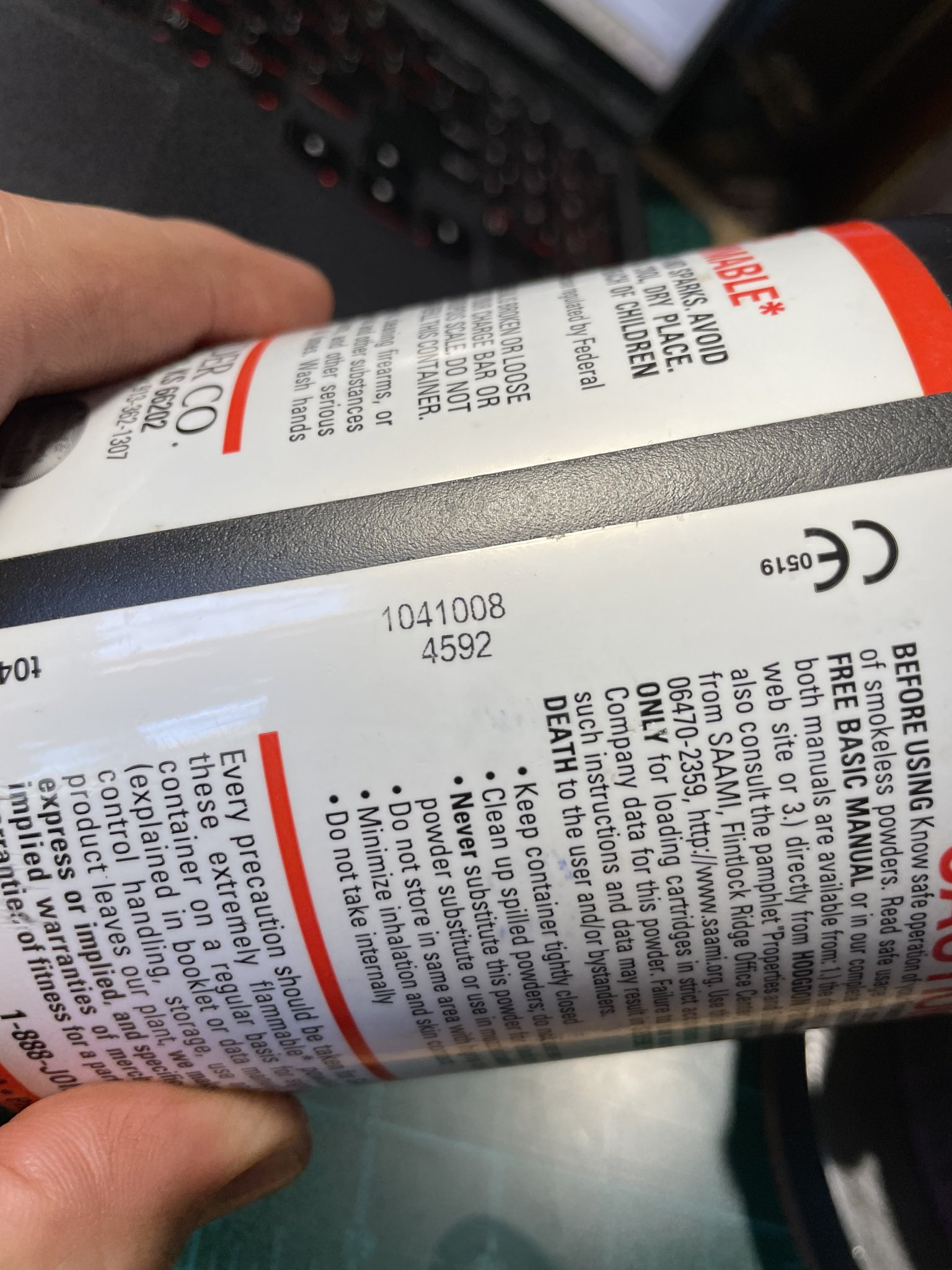

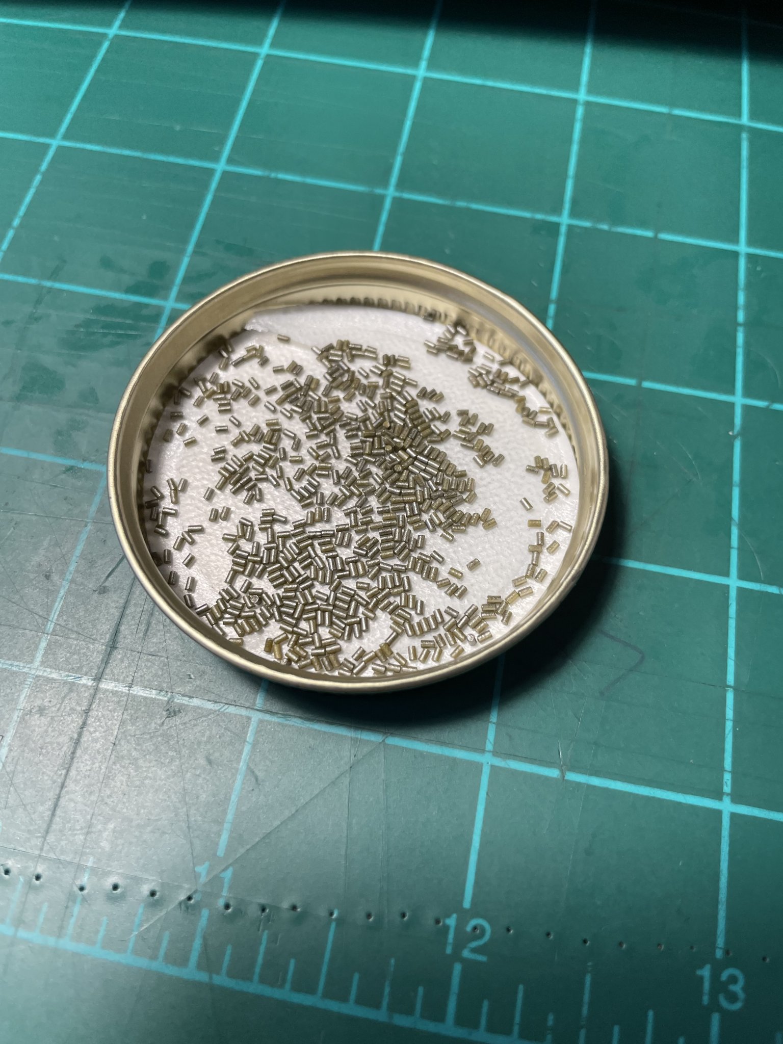

Used up all my older Varget and cracked a new 8lb the other day and the kernel shape and length are all over the place.
Contacted Hodgdon, said they use a new process to cut the powder and that this was normal and beneficial to the burn.
Maybe I’ve been under a rock?

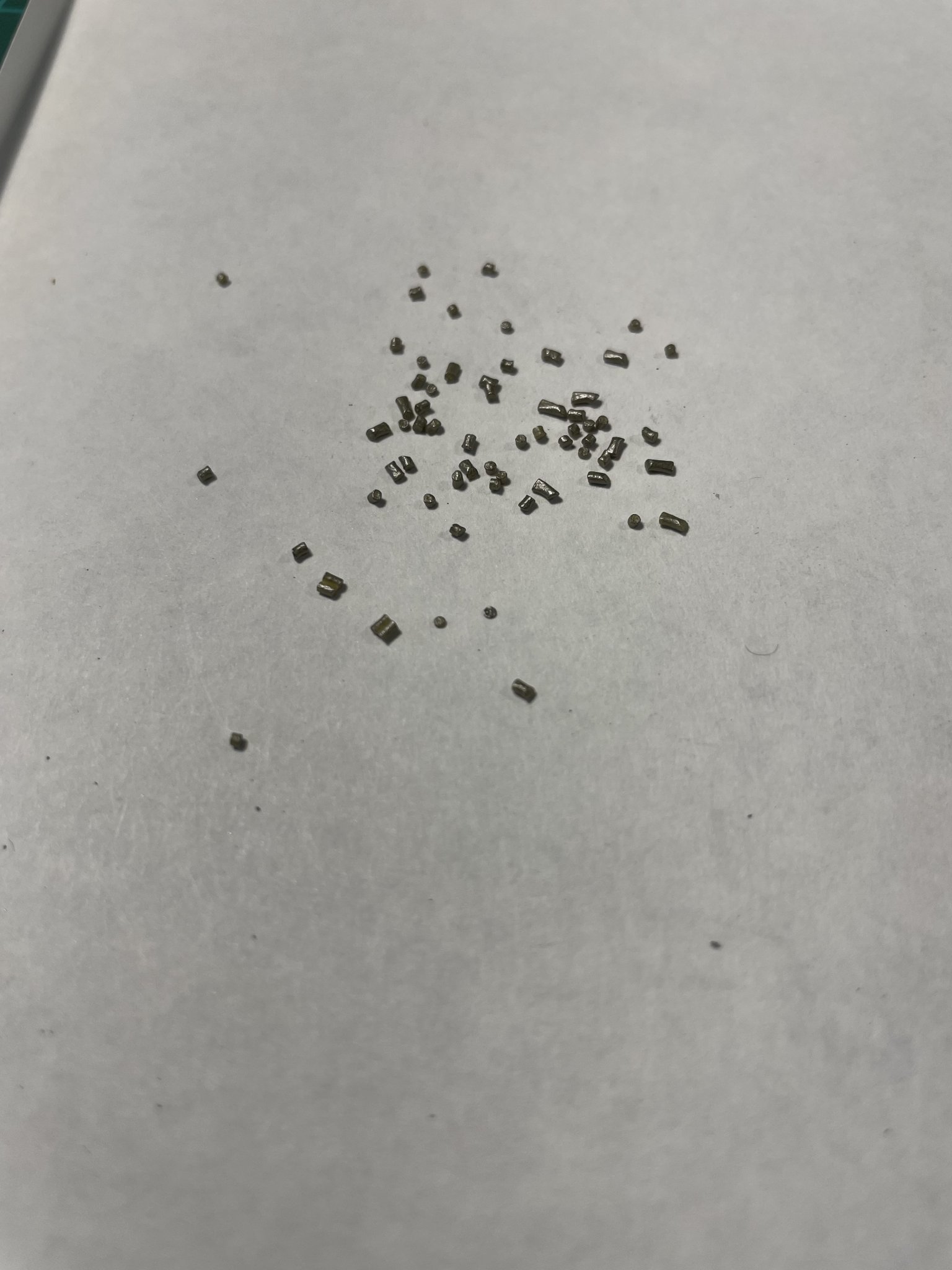

This is maybe half the oddballs from a single 24g drop.
I don’t believe that it’s beneficial to burn.
If they have mixed size kernels like that I would expect them to say “shake well before use”.
I would expect those different sizes kernels will settle/separate from larger kernels.
Now I gotta go check my stash…
Reactions: DIBBS and flysolo
Doesn’t kernel size relate to pressure at different points in the barrel?
Maybe they mean smaller “grains” present more surface area and contribute to a more even steady burn with the same or better pressure? Same powder charge by weight, but more individual pieces with more surface area?
I’m a legal retard so maybe I’m having a moment?

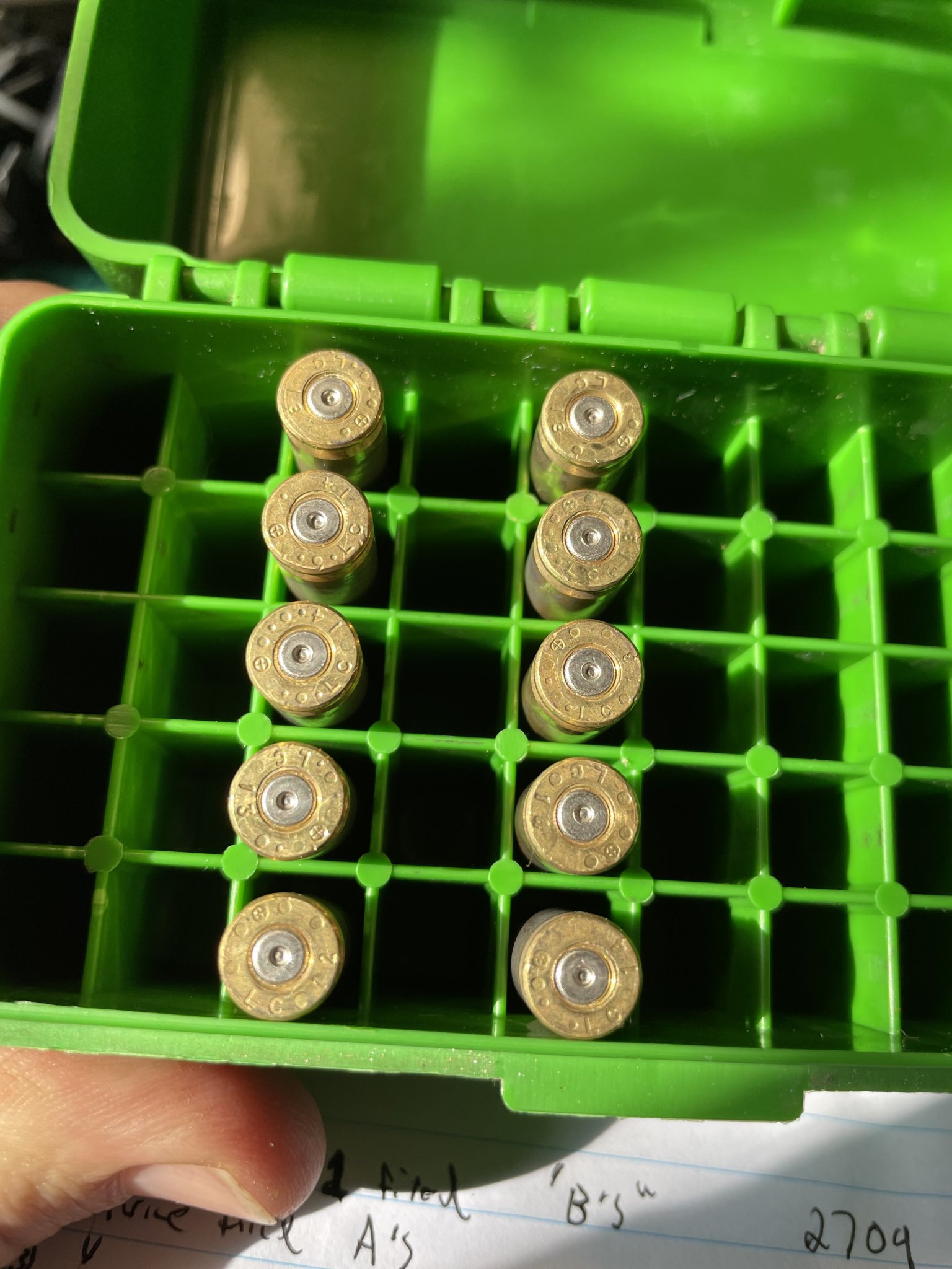

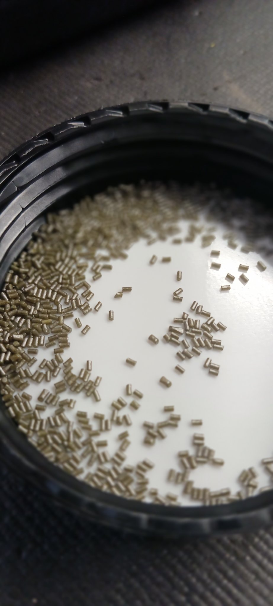

I gave an example of the same powder in two different size kernels and it has same velocity and prints same on target. IMO as long as the powder is completely/mostly burnt before it leaves the barrel it doesn't care what the size of the kernel was.
Definitely going to shoot it.
The settling/even distribution argument makes sense to me. How could that not cause variation? Bottom of the container could be 90% small kernels. That would be a hell of a lot more surface area exposed.

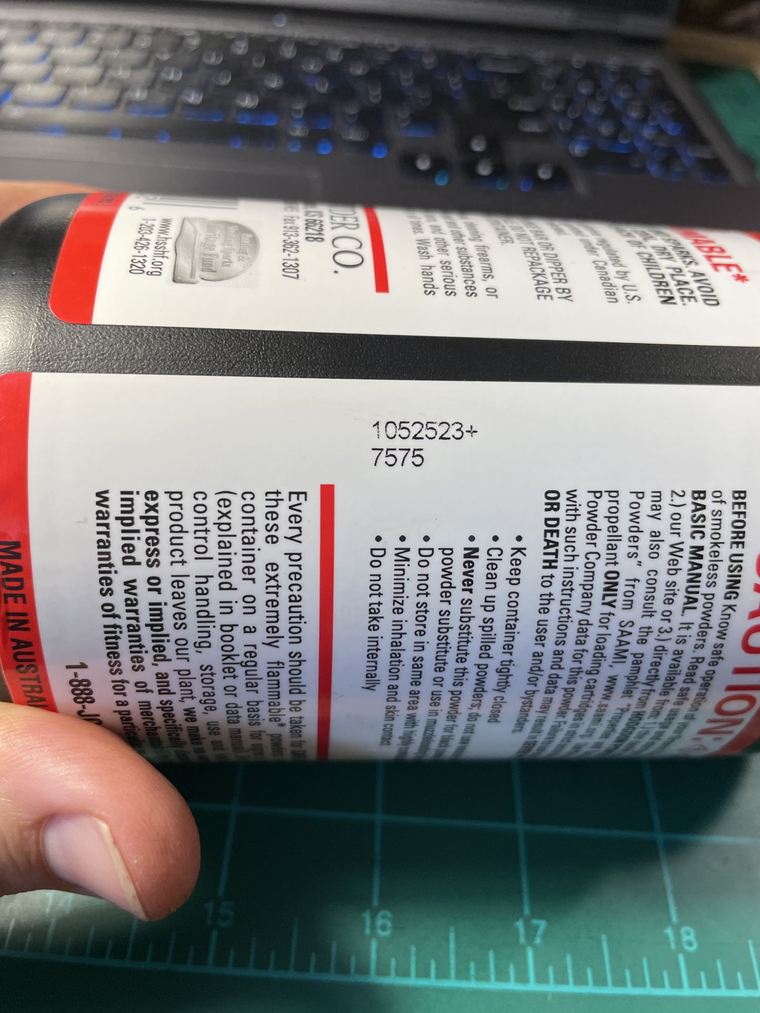

Varget and a bunch of other different Hodgdon powders are actually produced in Australia by Thales - Australian Defense Industries.
A number of years ago ADI built another powder line to replace the original, older line that I am assuming needed replacing or would have been kept in-place as one of two production lines.
My understanding (from Ozzies) was the second line was coming along nicely but had some bugs -- nothing insurmountable but still not corrected. Some bean counter exec made the decision to close the original line to reduce cost-debt before all the bugs in the new line had been worked out.
The new line caught fire with extensive damage at about the same time as the Wu-Flu and the West Coast port stoppages -- why there was and is a shortage of Varget, Retumbo, H-1000, and IMR 8208 BR to this day. They only ship to the states once or twice a year.
For education and entertainment:

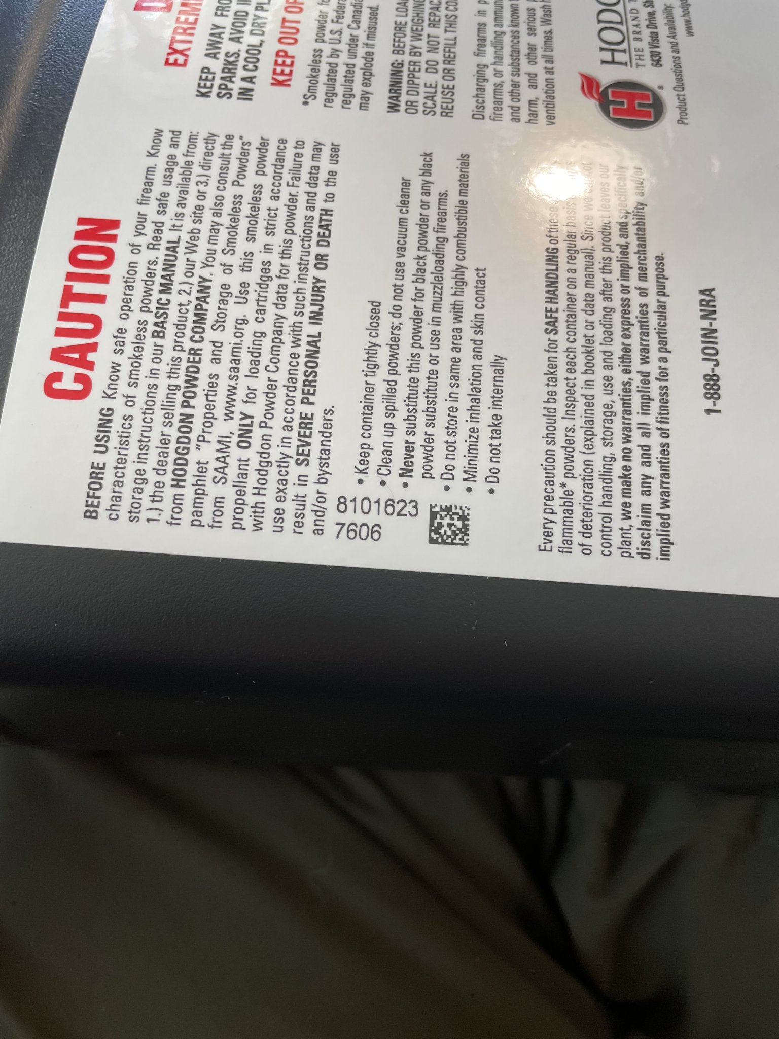

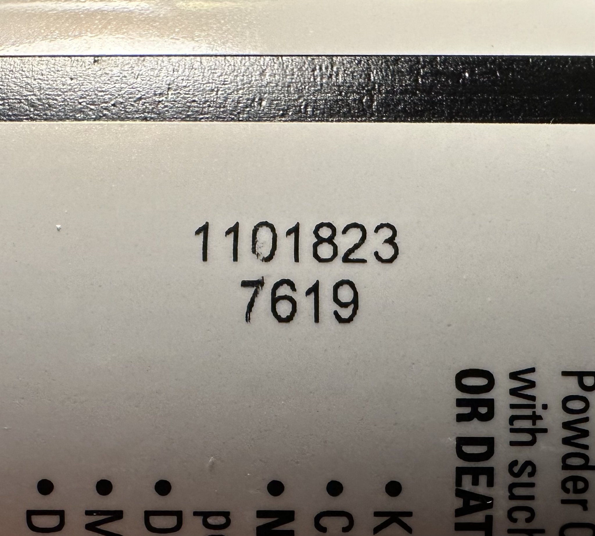

I have an 8-pound jug of Varget purchased October 2022. Its kernels look like OP's photo, albeit with fewer of the really small ones. I'm only about halfway through that jug. I would expect larger kernels to work their way to the top as the container is handled, so it may well be the proportion of small kernels will increase.

Just an update on this post. This powder lot yielded a loss of 75 fps and increased SD's by over 200%. I've tested it well. Hodgdon politely told me to go pound sand, I didn't expect any different. I've had to make adjustments for lot changes, but this is pretty much back to the drawing board.
Noveske stainless 18.5
LC 12-14
CCI 400
Hornady 75 hpbtm
24.0 varget
COAL- 2.260
AVG SD- 9.0
AVG V- 2705fps
.5 MOA @ 100y, held MOA out to 600y
current results with the identical set up:
AVG SD- 22.0
AVG V- 2630fps
.8 MOA@ 100y, 2 MOA at 600y
Loaded 5 each of the new powder at 24.5g (left) and 25.0g (right) both of which would have shown some pressure signs previously. Nothing to see here.
24.5g- 2667fps SD- 21.5
25.0g- 2744fps SD-21.7
both grouped over an inch
Here's the lot #
Reactions: RegionRat
I'm a little surprised they didn't ask you to return at least a sample of what you reported. Did they at least look at your photos?
They did initially ask for pics, at the time I hadn’t tested any so I sent the irregular grain pics and lot number.
I replied to them with these results after testing and they blamed it on moisture content of the powder.
Well, to be fair, moisture content does have a correlation to burn rate. That has been measurably established.
It has also been shown that powder stored inside with a low humidity will eventually stabilize at that humidity level, even in a closed container.
Reactions: flysolo
Absolutely, showcasing a lack of QC on Hodgdon's part.
Just checked the most recent 10 lbs. crate of Varget I ordered late last year, and the lot number looks to be after your's, if you go by the last 4 digit code. Also, none of mine have the digital code scan thing on them... So, not sure if it was made before yours, or what's going on. Here's a few pics of the kernels from this lot number, and they look like all the Varget I've used before, but overall they maybe slightly smaller in size, which will be nice to fit in smaller cases like the 6 ARC, where room is extremely limited.
I see. So then that suggests the next move would be to get that powder spread open and exposed to near 50% RH and see if there is any improvement?
I find it hard to explain the shift you reported up above, but that would move the gameboard forward and tend to either support or refute the water content issue.
Your average went from 2705 to 2630 and that is a lot to explain for what is supposed to be a temp stable powder. You would have to have exposed it to a fairly humid condition to slow it down that far, but it isn't out of the realm of possibilities. It also doesn't explain what appears to be "crumbs" of powder instead of uniform kernels does it?

Here's the previous lot that I was working with. Thought I used them all, gladly I was wrong. It is fresh (within the last year) sealed, stored well, which should negate any possibility of human error on my part. Uniform kernels that we've all seen a million times.

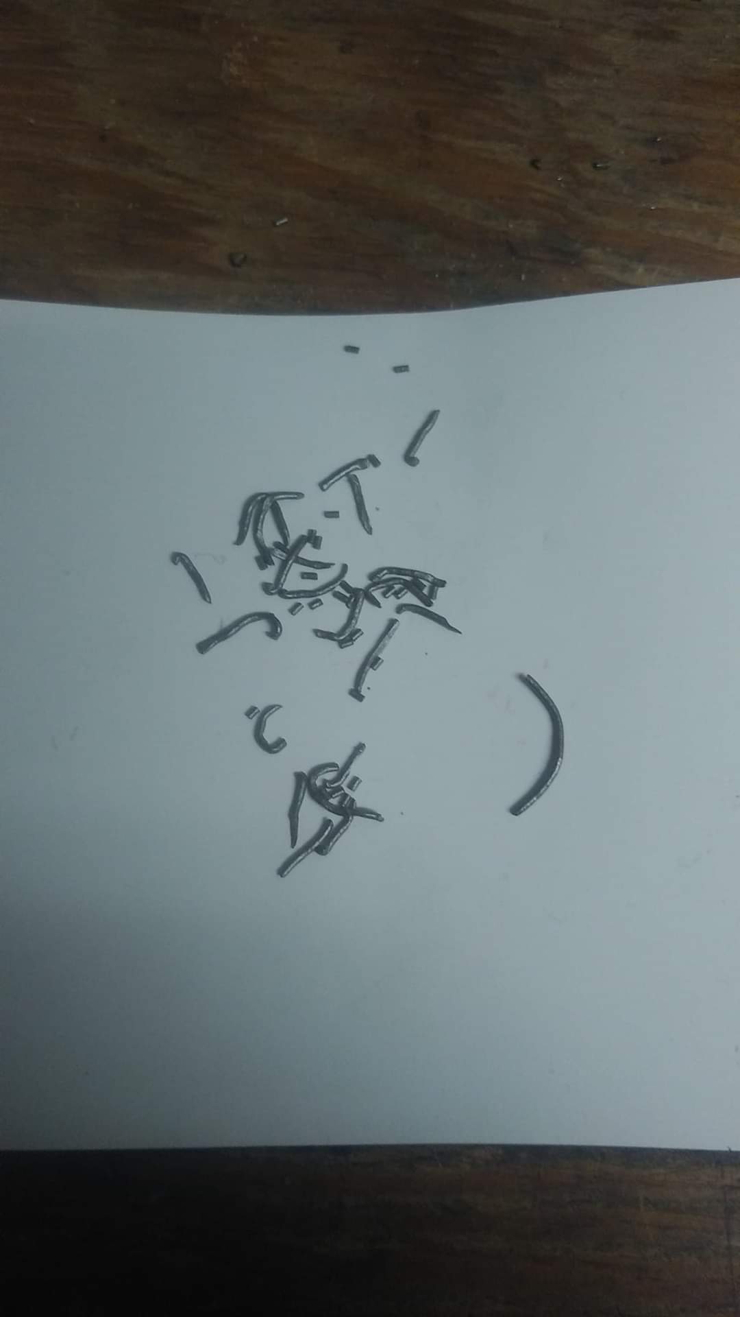

Here's a little metal capped blast from the past. Been open for at least 14 years, probably more like 18, moved across the country a few times. I'll load a few up and see how they compare.
FuhQ those are damn good photos, is that your phone?
