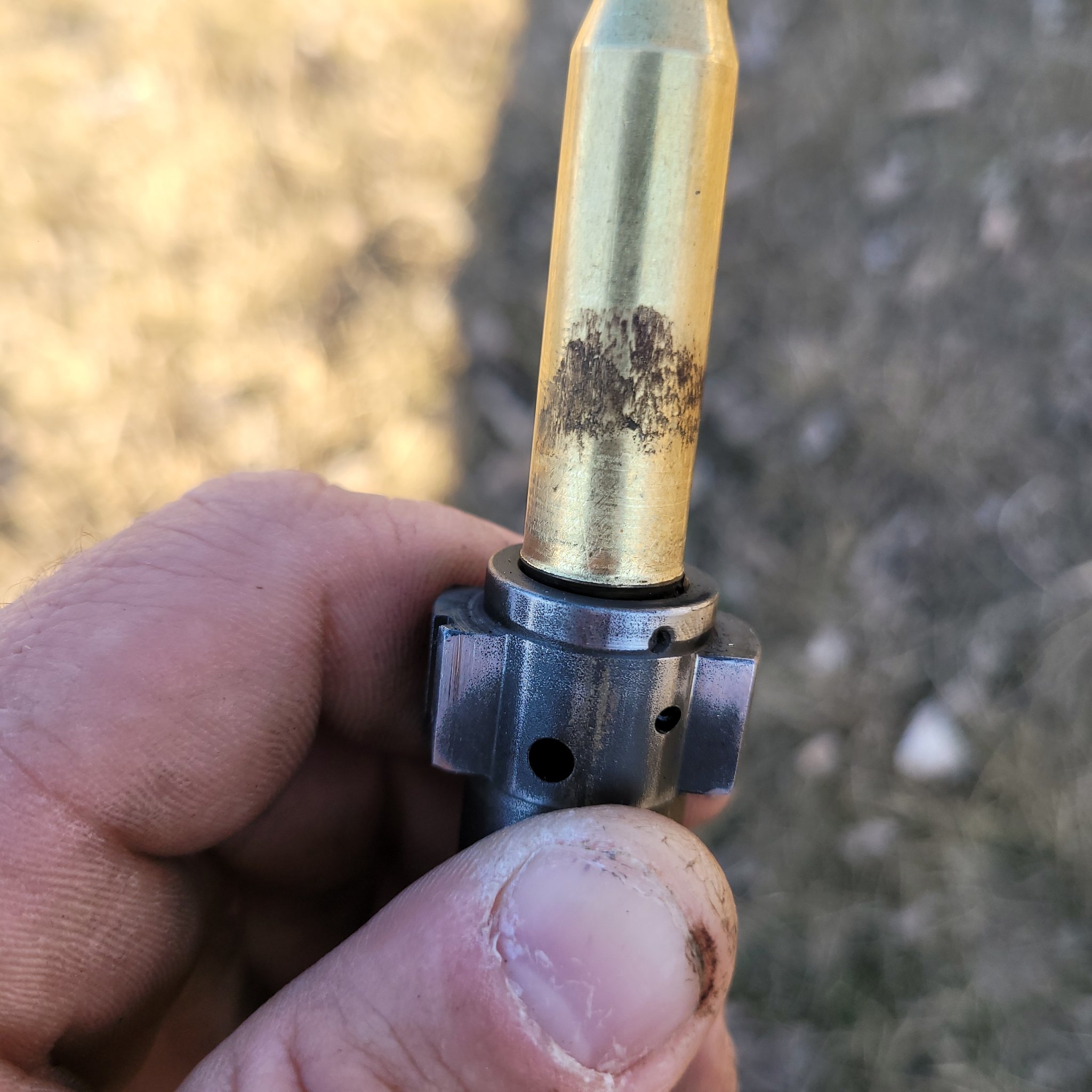

First you need to learn about the relationship between case weight, volume, and pressure.
You should not use data developed in lightweight brass with your heavy brass without first reducing the starting charge.
In your case you went way over pressure with 44.8grs in Federal brass. You should not go above 43.5grs in that case.
I would redo your load development starting at 41.5 grains.

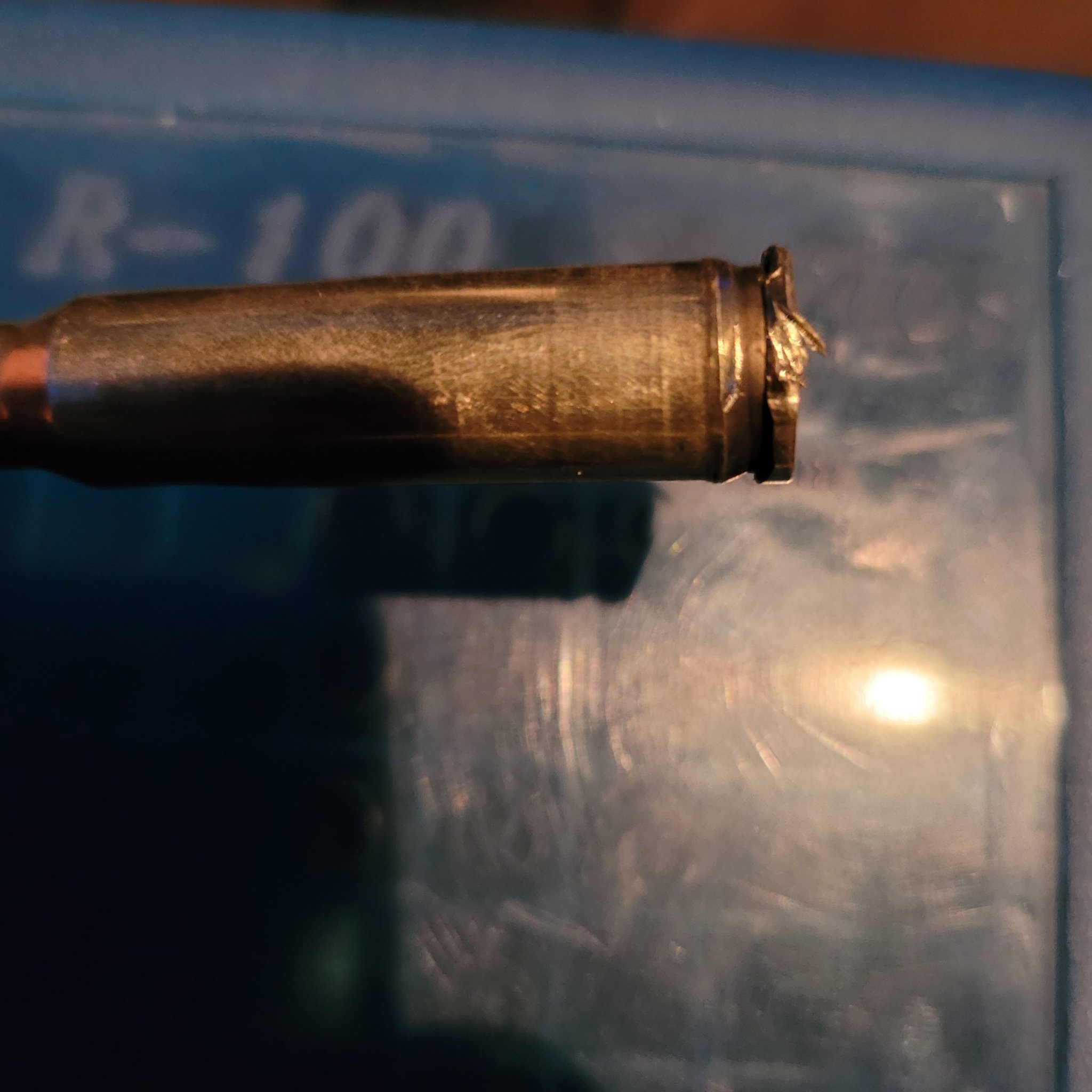

He prolly meant bad in terms of primer pocket expansion. Leaking primers, blown primers, etc.

Thanks! I just fooled around on federal reloading data on their website and their max for their 165 is 44. But it’s 46 on Hodgdon with the same weight. Luckily I didn’t go any heavier! Thanks again for the knowledge.
Damn, how bad? Anything I should be checking on my rifle? My brass didn’t have any pressure signs. How/where do you find data specific to heavier brass?

I didn’t have any pressure signs shown immediately. I’ll report back once I get them cleaned and deprimed . But I’ll still err on the side of caution, as evidenced there’s plenty I don’t know that I don’t know. 😅 I’ll look into it, thanks for the rec!
