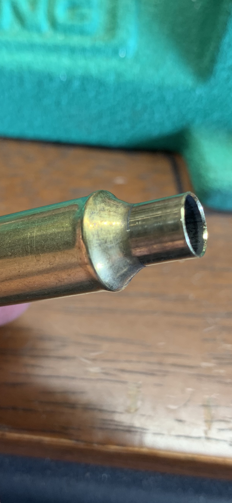

I got to use my expander today for the first time. Bumped the shoulder a little... looked kinda like a mushroom after that. Caught on to raising the die up higher.
