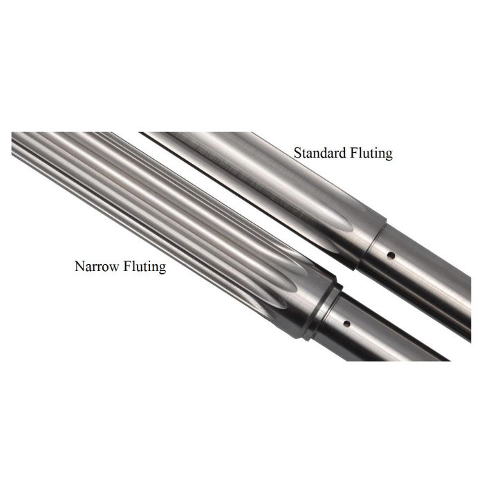

2. Barrel fluting - White Oak does standard (wide) flutes and narrow flutes. I was thinking narrow flutes to help cool the barrel since you can put a lot of pills down range when dogging. I do, however, tend to fire slow(er) as I'm anal about not wanting to thrash the rifling in my barrels (I'm not a mag dumper). It also lightens the gun, which isn't necessarily a plus for long range shots. For those who do a lot of p-doggin do you like / dislike fluted AR barrels? Do they actually help with thermal management or is the dissipation offset by the loss of thermal mass? As far as "looking cool" I couldn't care less. If it's not functional, I'll save the money it costs to flute.

For everyone else looking... here is the different fluting

While flutes look really cool, most of it will be under the hand guard on an AR. I'd save the money...

If it were just looks, I wouldn't even consider them. I'm trying to figure out if the increased surface area will provide an appreciable benefit in cooling.

Unless you know you're going to be doing high volume shooting where the time for the barrel to cool off quickly is important I would skip the fluting and just go with a heavy barrel. If you're shooting off a bench or prone I'd go 22 - 24" for the velocity.

From experience, fluting a barrel only reduces the weight. The loss of barrel mass can be described as "yes they cool faster, but they also heat faster" since there is less mass to absorb the heat.
If weight is a concern, get the fluted. If not, skip it and save the $$'s BTW, highly recommend WOA. On the cheap side, I stumbled into an AR Stoner 18" fluted and it ended up being a 1/2 MOA shooter..... much to my surprise! At the time, ER Shaw was the manufacture. 5R and Wilde chamber with 1:8 twist. For what it is, no complaints at all.
