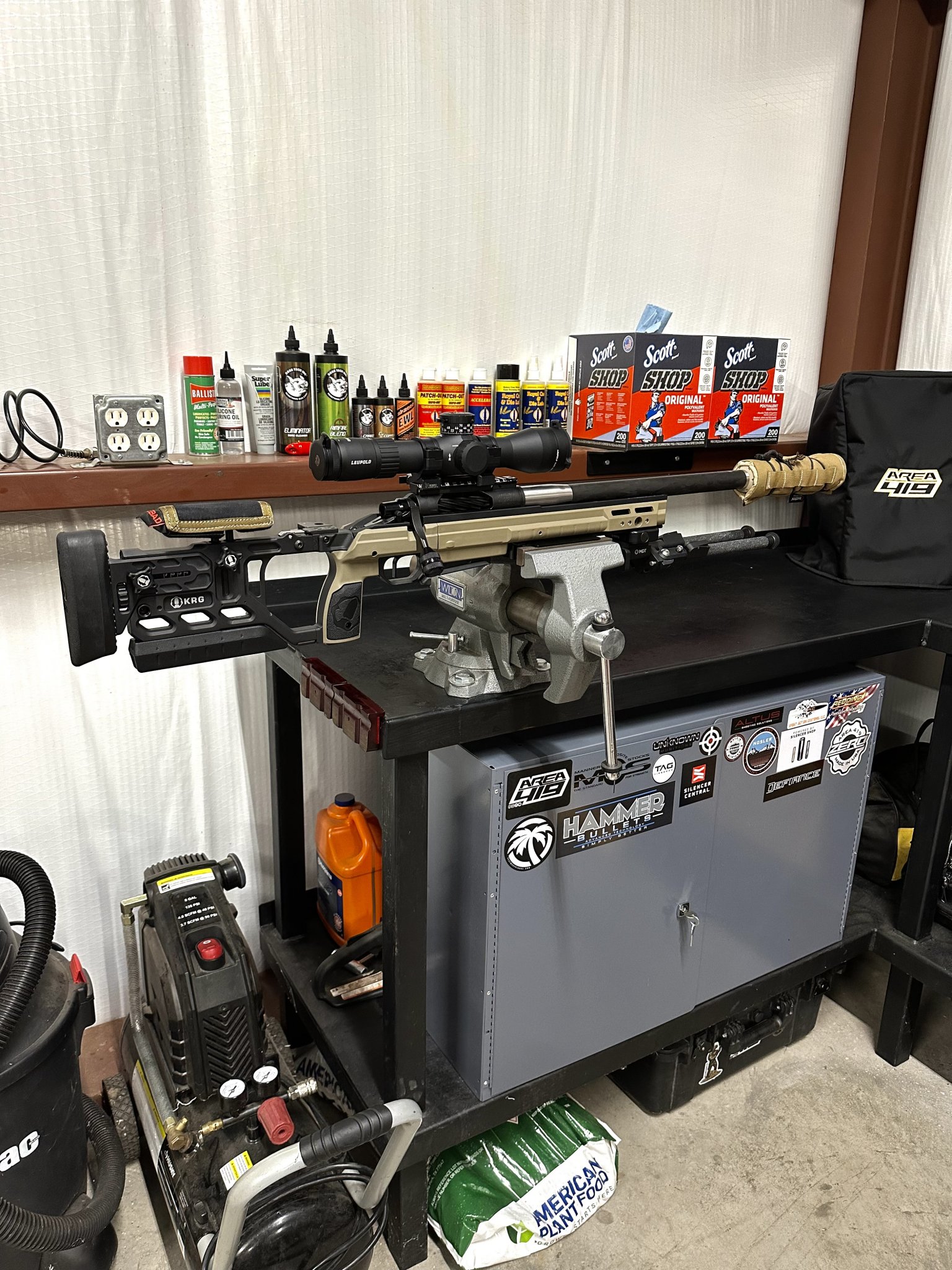

    No sir it is the TCS PRS. The night stalker is not available yet. I’ve recently sold the TCS and switched to a KRG Whiskey 3
    Yeah I’ve seen them on the manners page to order but didn’t know if anyone had received them yet, the butt of the stock in your pic just looked a little short to be the tcs prs, good looking rig anyways. I’ve got a 18” 22 creedmoor in a t4a just looking to change it up a bit.

    Thanks. TCS is an amazing chassis but not the best to hunt out of. Think I’m going to like adjustability of the KRG and it lost a little weight.
    nice, yeah I did a 6.5 prc on a manners lrh for my hunting setup, my match rifle is a prs1 I really the manners stocks. The chassis guns do offer more adjustment for sure though just haven’t brought myself to make the switch lol
