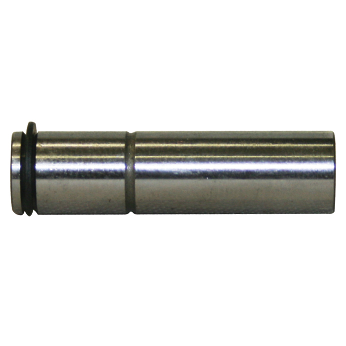

If you are seating VLD bullets without using a VLD seating stem, that alone will have a negative impact on your consistency, IMO.
I am going nuts looking for a VLD seating stem that fits a standard RCBS seating die. Where could I find one that I could replace my current one with?
Wow, just looked and I don't see them offering this anywhere. I use Redding dies and they make seating stems that are longer for VLD bullets including my humble Berger 140 Hybrid Targets. Doesn't look like RCBS offers a similar item that I could find.
I do note that if you google "RCBS vld seating stem" there are posts on different forums on this subject and it seems the answer is to contact RCBS customer service. Apparently they can make you one....or something? I would def contact them, tell them caliber/bullet you are using, and ask if they have a VLD stem (though they might call it a seating plug??)
Redding looks like a very different design than RCBS. This is the Redding seating stem. If you put a bullet pointy end down in a standard stem and it bottoms out and cocks to the side, then you need the VLD stem that will allow contact at the ogive and not the meplat.
Best of luck and give RCBS a ring/email and ask them is all I can offer.
Reaching out to RCBS worked out. Thank you for that suggestion!
Here is what they said verbatim:
To create a custom plug, we’ll need 3 sample bullets, the diameter of the seater stem, and the caliber. We make seater plugs in 1/4 x 28 and 1/2 x 20. If you need a 7mm or .30 caliber Matchmaster seat plug for your Matchmaster die set, please specify the length of your seat plug so we ensure we make the correct plug for you. Without this information, we cannot start the plug and your order will be delayed. Please include your name, address, and telephone number as well as the type of plug you need (1/4 x 28 seat plugs thread into the die from the bottom and 1/2 x 20 seat plugs thread into the die from the top) in your package.
The cost for the custom plug is $19.95 and $7.50 for shipping, plus applicable sales tax. If you have a Gold Medal seat die or Matchmaster seat die seat plug, the price is $27.95, plus shipping and sales tax. We will contact you for your Visa card or Mastercard details. For expediency, please do not include a check with your package, as we no longer process them. Please ship your package to the following address:

While I’m very glad they have an answer for you, I’m sort of appalled that the don’t make VLD plugs in various calibers as does Redding and, I would suspect, others. Without needing you sample bullets, etc.
I’m not familiar with RCBS dies but VLD bullets are quite common and having them bottom out in your seating due is bad juju. Just baffling to me.
