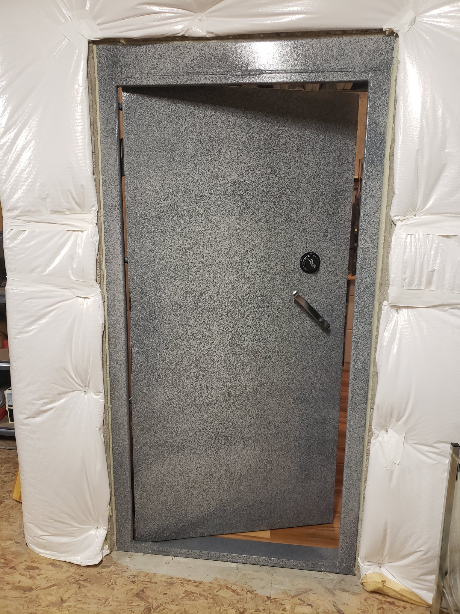

Went through the same thing 6 years ago when I built my house. Concrete walls and ceiling. Drop extra Rebar in the walls. I went with "Sturdy Safe Door"
They build to your dimensions. Any thickness AR plate. Very reasonable. Do an in swing door if your doing a walk in vault/ safe room. I'd do the same in a heartbeat.
