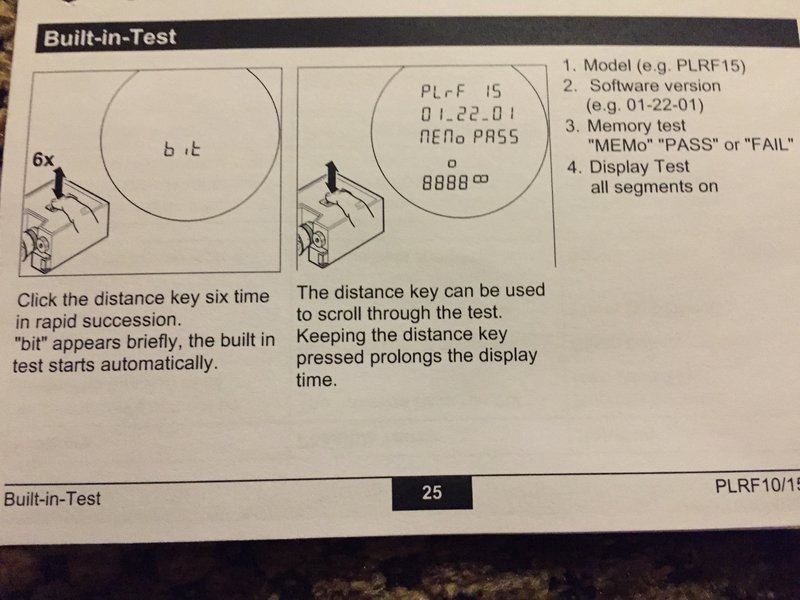

    For function test:

    To do an internal test:
    hit the distance key 6 times in rapid succession
    "bit" should appear in the screen
    you can then use the distance key to scroll through the test

    So yesterday,I headed over to the "Pawn Shop" armed w/ a PLRF 15C user's manual (compliments of bogeybrown) & attempted a functions check. It didn't go nearly as well as I'd hoped.
    I followed the required steps per the manual - I pressed the distance key 6 X rapidly and all I got was " - - - -."
    I also tried to press the distance key once to bring up the red square (which brings up the distance the laser ranges), then press the distance key 6X. No anything except for the red square.
    I tried several variations of rapidly pressing the distance key and pressing the distance key once, slight pause and rapidly pressing 3X would bring up " c or E."
    The shop owner and I took the unit outside to range objects of varying distance. At first, it accurately read a slew of objects accurately. Then it stopped ranging objects altogether. The shop owner seems to think the batteries are weak ans didn't have a fresh set on hand. I learned from reading the manual that a low battery indicator is "LobA" and I never this code.
    I told the shop owner I'd come back during the week & we'd give this another look.
    Thoughts?
