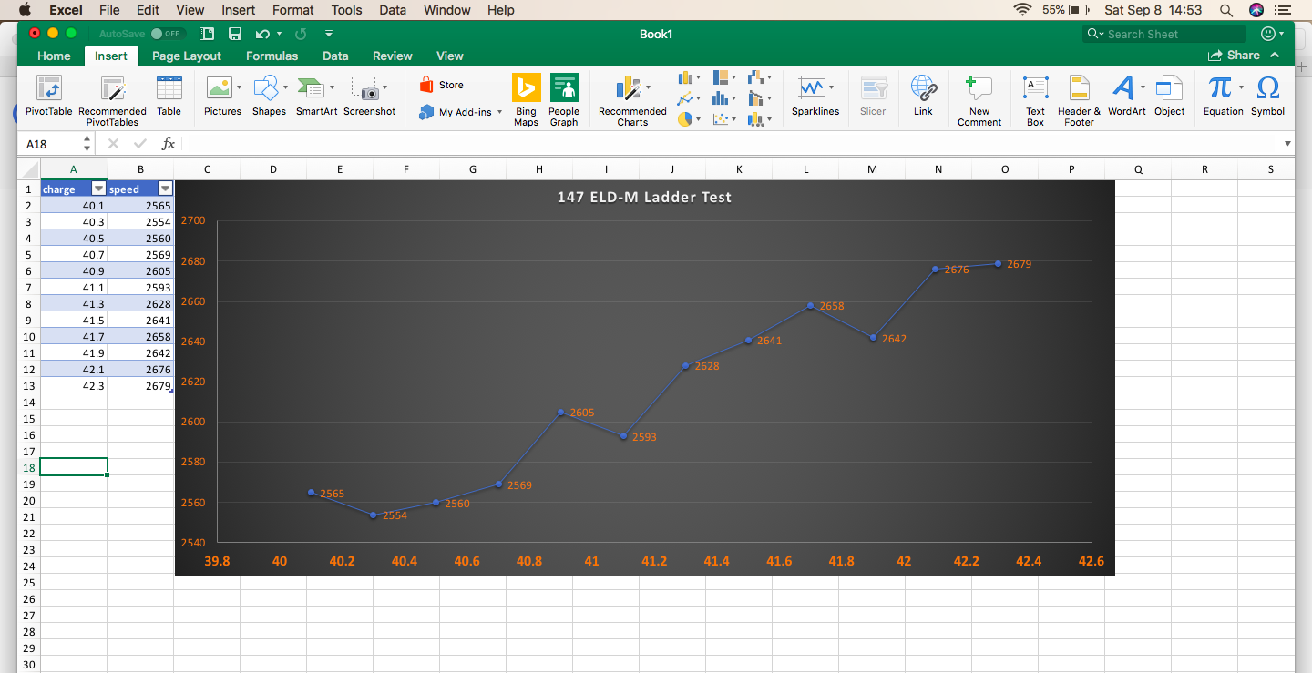

Velocities decrease with higher charge sometimes...why?
parkerg31
Jun 3, 2018
92
26
Why do speeds seem to drop sometime with a higher charge? I have wondered this for a while but have always attributed it to me being a inexpireicned reloader using not the best equipment so it was my fault. But, this ladder today was done with 147 gr ELD-M and H4350 and I took the upmost care in making sure that I did everything correct. I have all new reloading equipment that is not hornady anymore and I am experienced enough now to at least eliminate rookie mistakes. I made sure to take all human error out of this test, yet still the velocities sometimes drop with a higher charge. Can anyone drop some knowledge bombs as to why this is? Below is the chart for the shots.
Side note. Rifle is a RPR with a stock barrel. I have a load with the 140s that shoot one hole groups with a 2.3 S.D so I don't attribute this to the rifle.
My theory.....where you have your accuracy nodes you will find things kind of flat line.
Id expect still a rise in velocity just maybe not as much that occurs where rounds are scattered.
Now the node also has to play with the frequency of the barrel and where it exits the bore in the whip timing.
So I dont know the physics of it but did it look like at those two points your POI was flat/consistent?
Thank you for posting so I could posit on this drawing assumptions out of my ass.
Edit Add------If you see a stock chart doing that buy when its at its drop from the high ;)
If that is one shot per charge, I'd disregard it.
this right here^^^....its a ladder test...you have a decent node at 40.3 to 40.7 and another at 42.1-42.3...id shoot 42.5 just to see if it stayed in that flat spot and go from there.
as far as causes...could be several things...neck tension and or case capacity are the first two that come to mind....variances in seating depth if your close to the lands.
is this virgin brass you shot this ladder test with?
