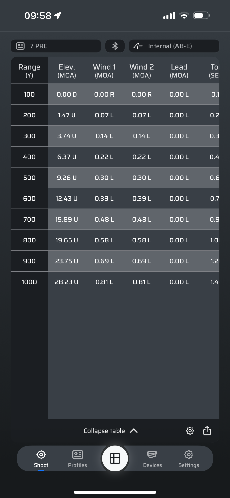

These two are 80fps different. Moa+ after 600
