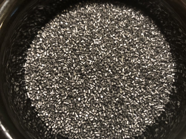

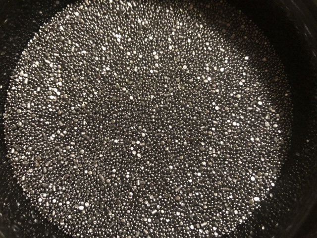

Here are photos of the powder I poured out of two different lots of Hornady Precision Hunter 6.5PRC. Notice anything? Hornady is trash lot to lot.
