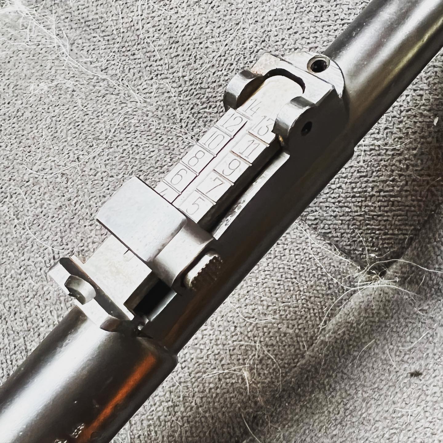

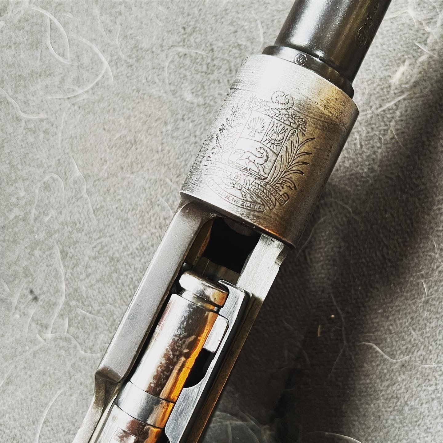

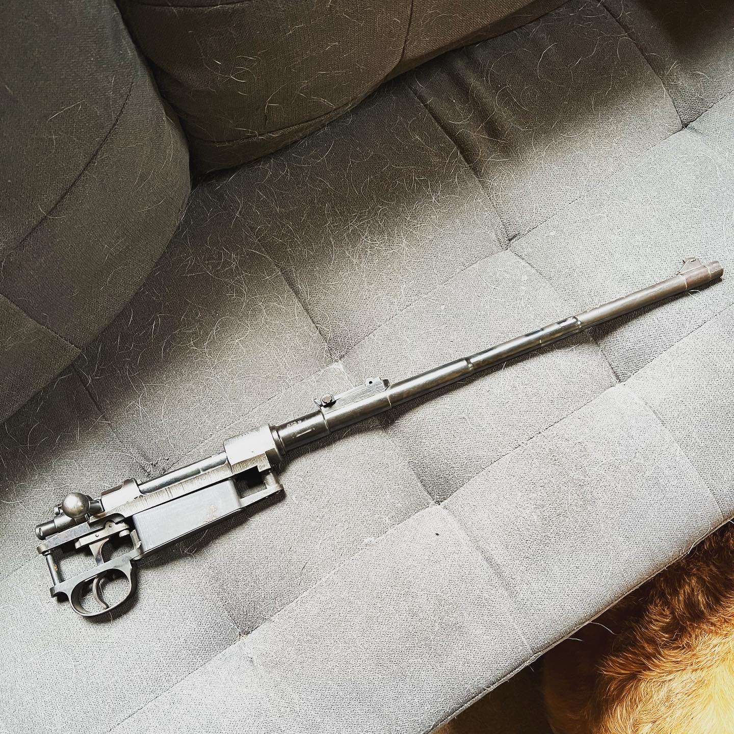

Hi, not really a sniper rifle but certainly vintage.. figure here is as good a place any to find what I need.
I was given a Venezuelan mauser barreled action. Not in a condition to be collectible but should make a good shooter and that’s my intention.
I just need to know what stock will fit it? Is it pretty much a standard mauser 98?
From what I’ve been able to find it is a postwar carbine, barrel is under 17”. The bolt doesn’t match and from I understand should have a curved handle.
Caliber should be 7x57 mauser.
So any info any one has would be helpful, but mostly I’m trying to find what stock it will fit? Does anyone know is it a standard 98 action?
Thanks, Justin

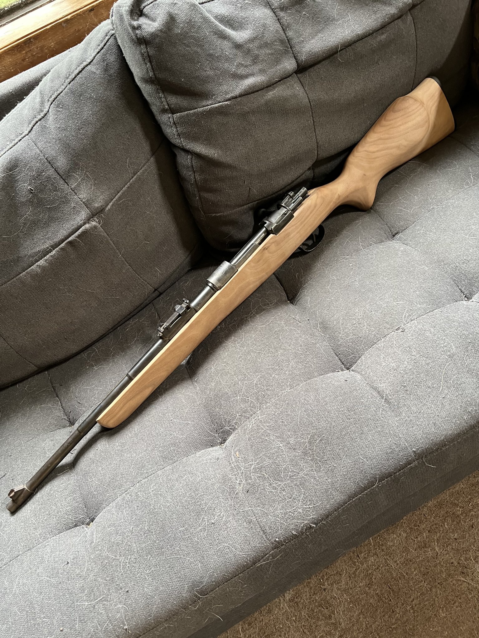

Thanks for the responses!
For any who find themselves with a Venezuelan barreled action in the future, here is what I found.
The Venezuelan action is the standard large ring mauser 98. I ordered a stock off eBay for a Mauser 98 and it fit up nicely. Actually it required a bit of work with a chisel and dremel, but I’m guessing that’s due to the stock not being made precisely, and that a better quality stock would have fit right off the bat. Get what you pay for and all…
Thanks again, I appreciate it!

Boyds makes some pretty nice stocks. And, when they do them, they are pretty much drop in. Agree with the above it's an FN -30 which is a year not a caliber/cartridge. And, yes, 7x57. It should take a standard model 98 stock. NOT an intermediate stock like a YUGO M48. I've heard people get confused on this before. Just because the barrel is short doesn't mean the action is short. They are full length Mausers. I won't hurt to give Boyd's a call and verify.
Another stockmaker is Richards microfit. They typically require more handfitting to get the action to seat right. But, I like their styles. It's not hard if you take your time and use some stock inletting black. Kind of like dykem blue for machinists. Coat the bottom of the action and remove where black on the high spots in the action recess of the stock.
