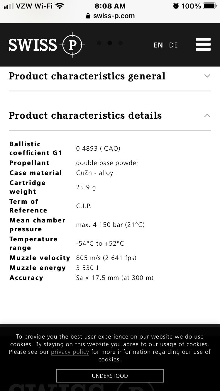

This is the only info I have on the bullet. The scope base and rings are tight.
